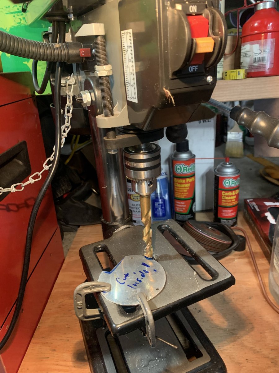

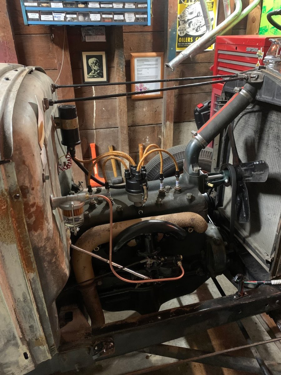

    So, with the brakes done for the time being, I was able to reward myself by working on what may very well be the most exciting aspect of the build—hopping up the engine. Even though it was a pretty long weekend of wrenching on the car, I couldn't help but keep going.
    It was a stormy one in San Francisco on Monday night. With a staccato of raindrops hitting the garage roof and the usual water leaking in, I started tearing things down. I'll admit that it was a little bit strange undoing some of my own work from this past summer. Off with the exhaust, which I sprayed with high-temp barbecue paint out on Turk Street late one night. I remember having to shake the can sparingly so I didn't wake the neighbors. Off with the carb that I rebuilt a handful of times and the steel fuel line that I painted copper within the first few weeks of having this thing. I carried the pieces up the stairs to the back portion of the garage.

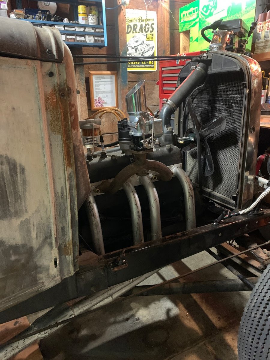

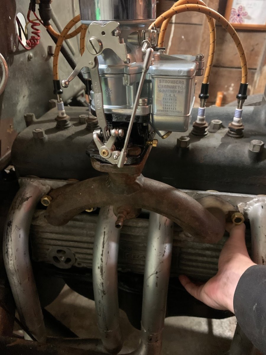

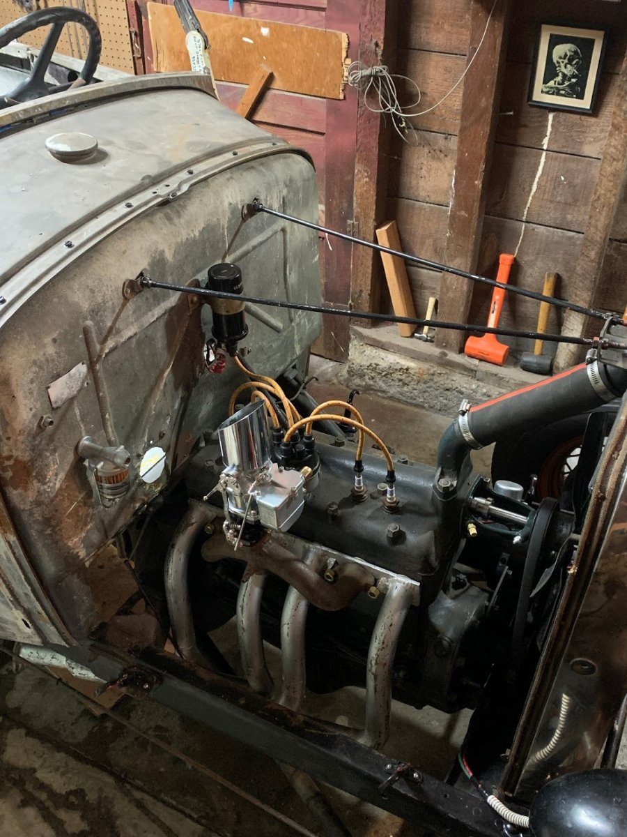

    Then the fun began. Header. Intake. Carb. Velocity stack. Yes!
    IMG_3008.jpg First impression: I love it. All this stuff looks way better on the car than it did hanging on my wall/sitting on a shelf/acting as a very stylish paperweight on my desk. Other thoughts: I need to buy new intake/exhaust studs, which I plan to order tomorrow.

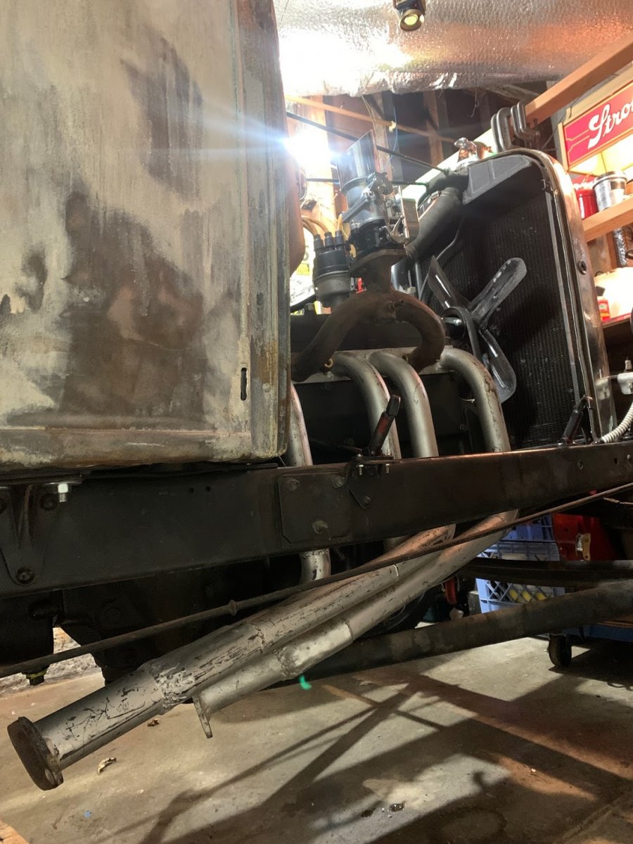

    One thing that took me by surprise is how low the header dumps. At first I asked myself why they did it that way. Then I realized that it's just about as close to the frame as they could make it and still work around all the stock Model A items. It clears the front wishbone, rear engine mount and brake stuff with room to spare. If it were any higher, a pipe running straight back wouldn't clear the rear wishbone. I'm thinking that if my A had full fenders/splash aprons, the collector would be just barely visible underneath. It's kinda funky and not perfect, but I think it'll be great for what I'm trying to do here.

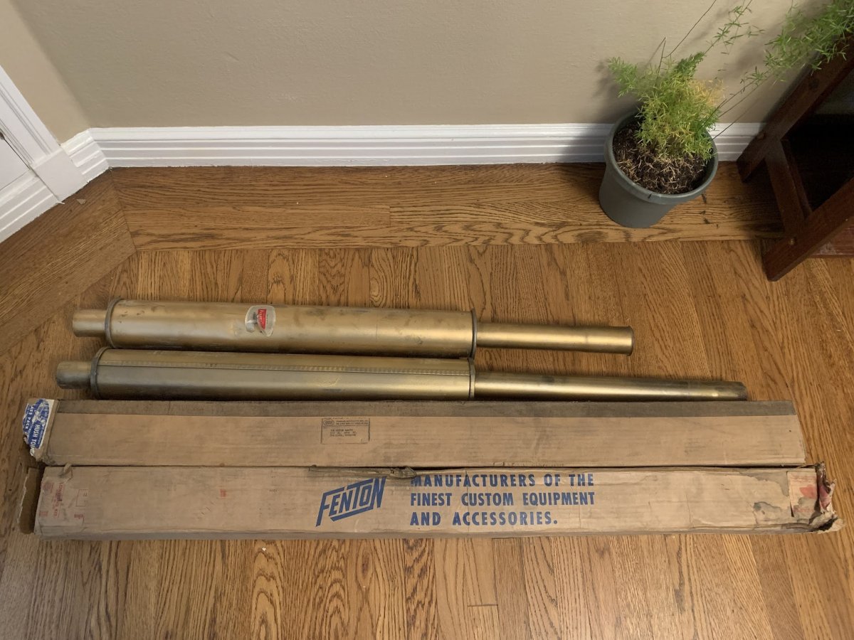

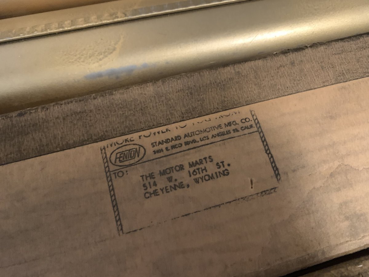

    Also, I got a killer pair of NOS Fenton gl***packs that are most definitely of the era.
    You know I already looked it up.

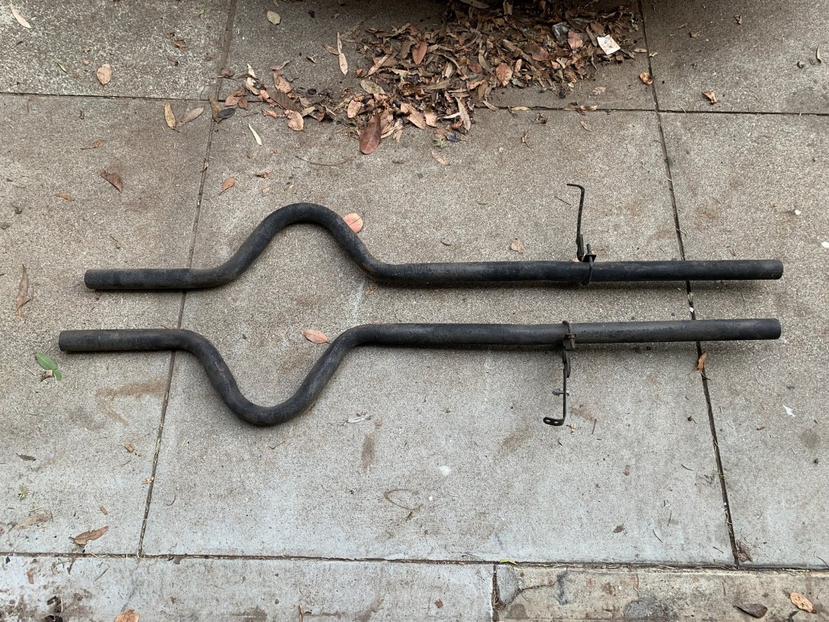

    And some perfect pipes from David off a flathead-powered '39 Ford. Dig the exhaust hangers.

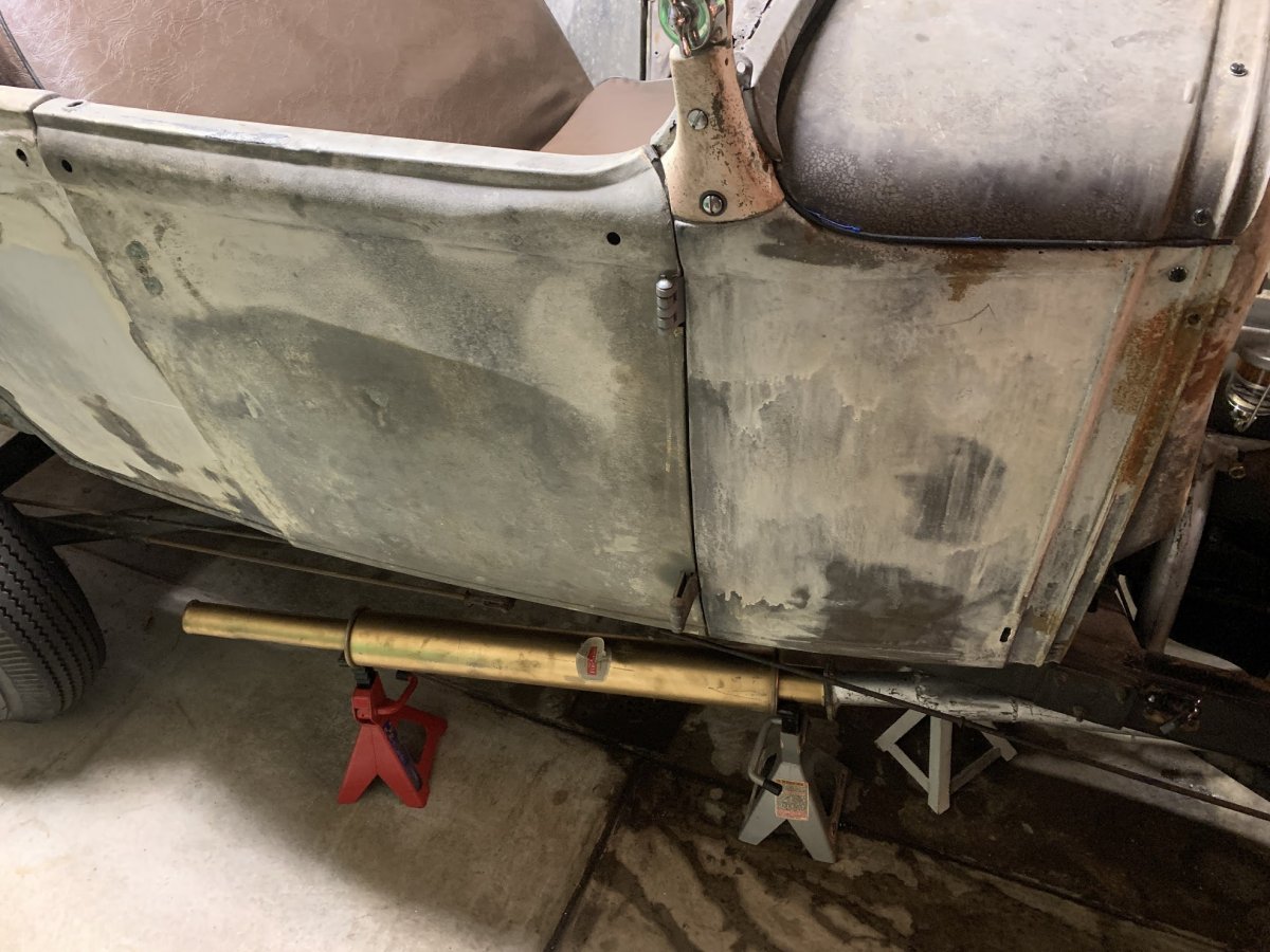

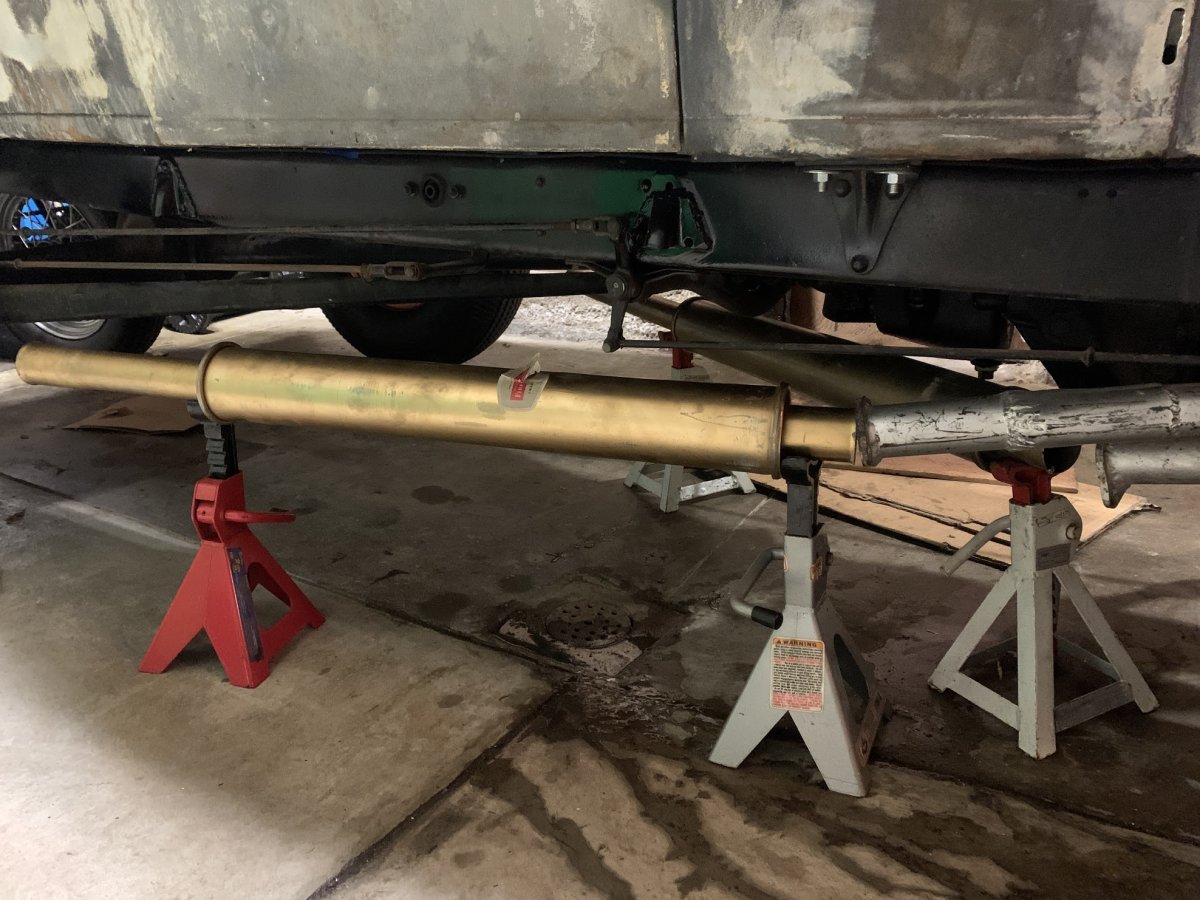

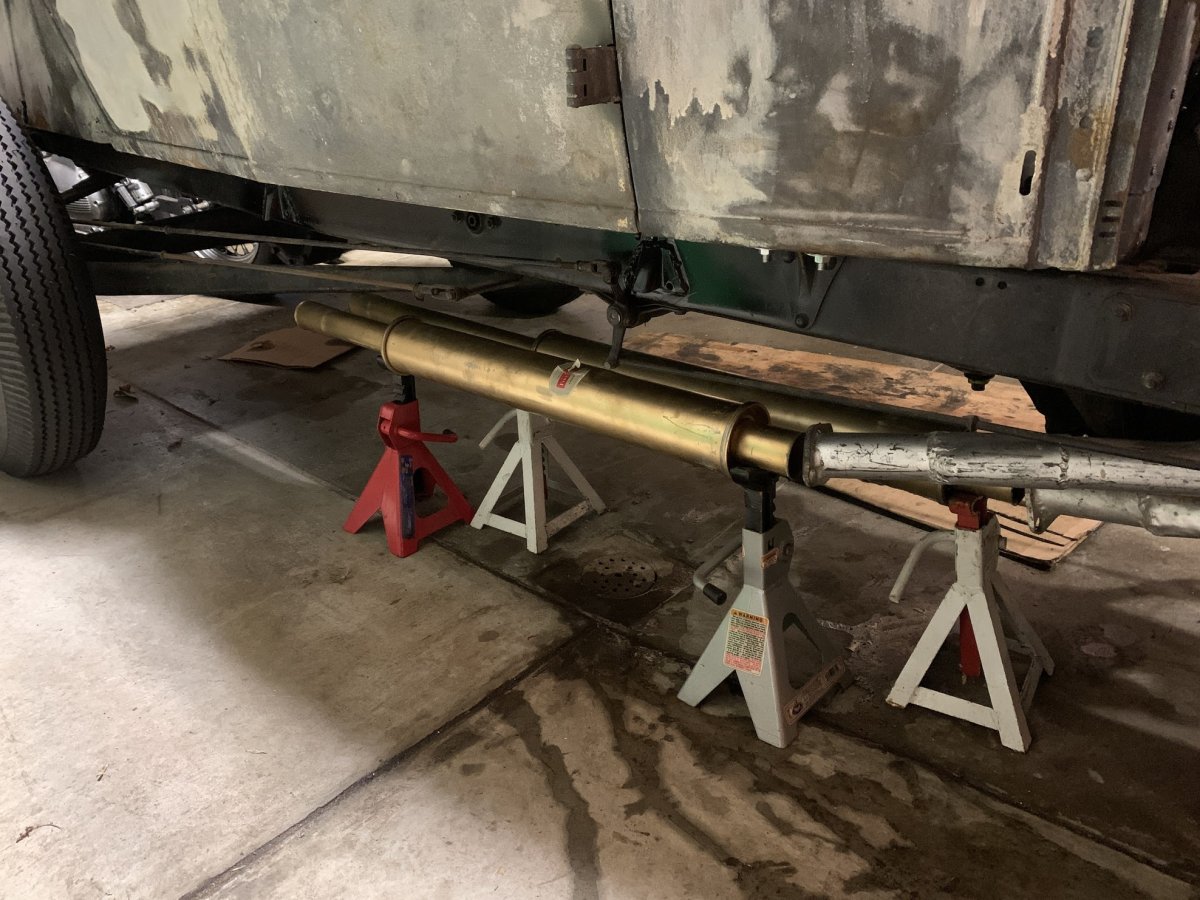

    I spent the final part of last night's garage session playing with exhaust configurations. I really want both pipes to exit out the back underneath the license plate. I do have somewhat of a plan. Here are some fun initial mock-ups.
    I'm leaning towards this. Also, I'm stoked that I own this many jack stands. Thank you Craigslist and NextDoor!
    I'm thinking that this is how the builder intended for the pipes to be set up. It's really straightforward and would add some visual interest to the driver's side. The only drawback for me is that—unless I capped them—it would get pretty complex for me to make them exit out the rear. Yama is going to teach me how to TIG weld in the coming weeks, and he and I are going to try making this system ourselves. I know he has the skills, but for my own sake I say the simpler the better! Besides, stuff like this can always change.

    Watch out for that ankle / calf burning exhaust gettin' in and out..

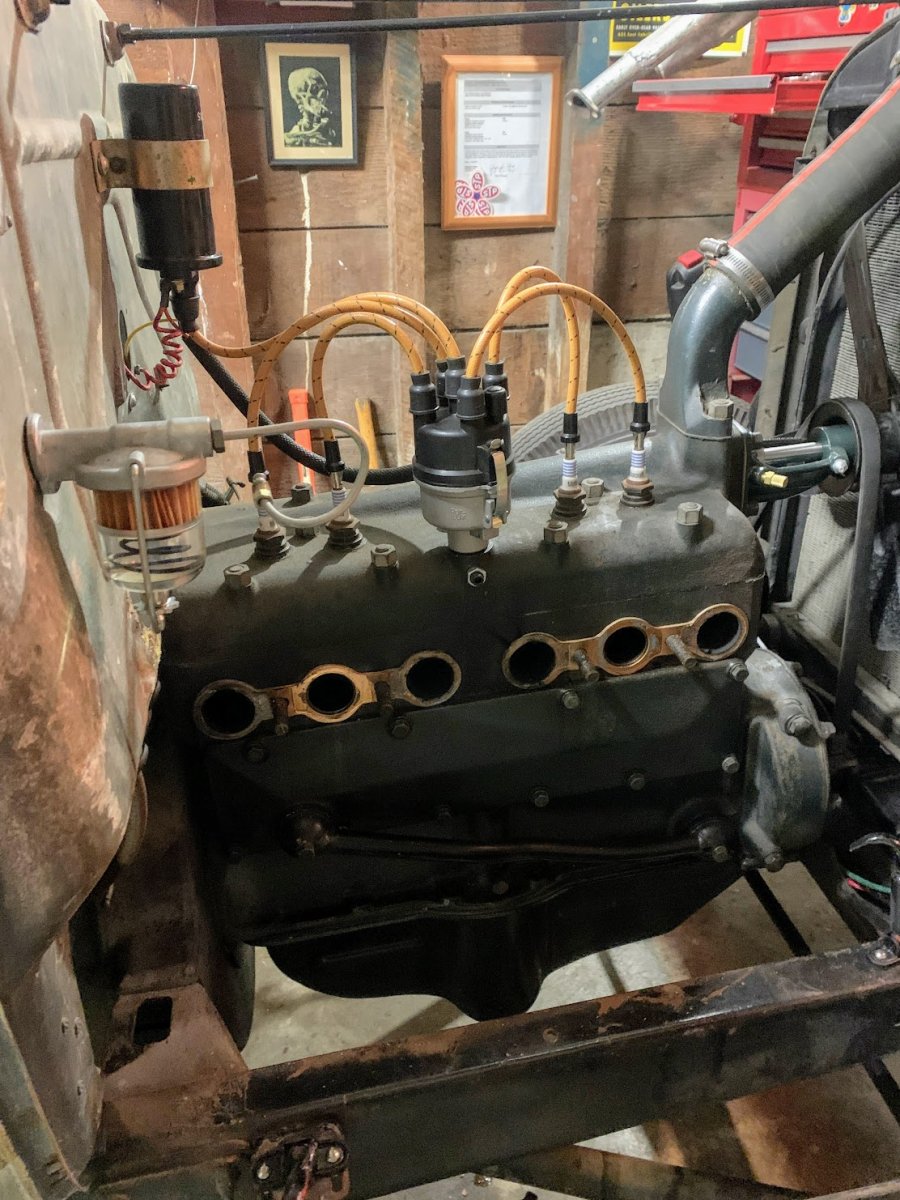

    See how cool that cover looks? :cool:

    I'd go with a light blast on that cover. No need to remove the original character and make it show quality perfect if you aren't doing polished SS exhaust and other over the top modern details.
    Also, just a thought, hand paint the firewall, like a broke kid in the 30s.

    I am a big fan of soaking aluminum and carbs in lemon pine sol and water, rather than blast. It gets them clean without damaging parts.

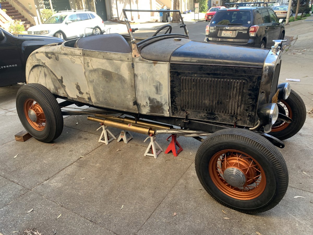

    Yesterday the sun was shining and I was itching to see how the car looked out in the driveway with all its speed equipment. So, I rolled it out of the garage and took a few photos. I'm liking the way it's coming together. You'll note that it has the DeLuxe windsheild frame back on it; the chromed one is with David in Petaluma. He's taking a look at it to determine the best way forward. I trust his judgement 100%.
    I apologize in advance for the less-than-picturesque background. Just trying to make the best with what I have!
    YOM plate in position. I never really noticed how it almost matches the plug wires.
    I'm a big fan of the header. The "Bologna Slicer" stack came from @Pat Pryor of Muroc Manufacturing.
    Hot rod stuff.
    Mocking up the taillight and license plate. Jacket on ground for insurance.

    Lastly, I wanted to see it with the hood in place and the mufflers closer to position. With the chopped windshield back on, this is going to be the look! That being said, I'll probably run it without a hood as I work out the bugs of the new system. IMG_3065.jpg

    Weld some nuts on the backside on the header flange to make it easier to disconnect one side of the exhaust pipe for a gain of at least 10 HP.

    When I owned an exhaust shop back in the eighties, I learned that once the headers are on, to work from the back forward with the exhaust system. The part that really counts is what you see, in the style you want . BUT even more important is that the tail pipes clear everything . i.e get the tail pipes where you want them, make some hangers and hang them properly ......finished . Then make the rest of the largely unseen system to join the front to the back.
    If it were me I would just make a couple of turnouts and bolt them on to the header...no muffler, no tail pipe , but then I am an old hoon.

    On Saturday, I was able to finish a smaller project that I had started a few days ago. Remember that gaping hole in the firewall where the heater pipe once ran thorough? Well, at last weekend's estate sale, I managed to score a free circle of polished stainless steel. (I believe it was once used as a part of a mobile or other folk art piece.) Anyways, with a little m***aging I made it work as a patch on the firewall. It's home-brewed, but I think it fits the overall theme of the car just fine.
    Working the drill press.
    It's the little things.
