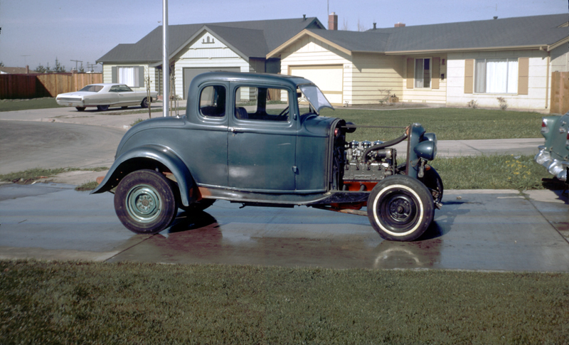

    Carl, that car is amazing. Great shot of Bay Area life from back in the day. I wonder if it's still out there?
