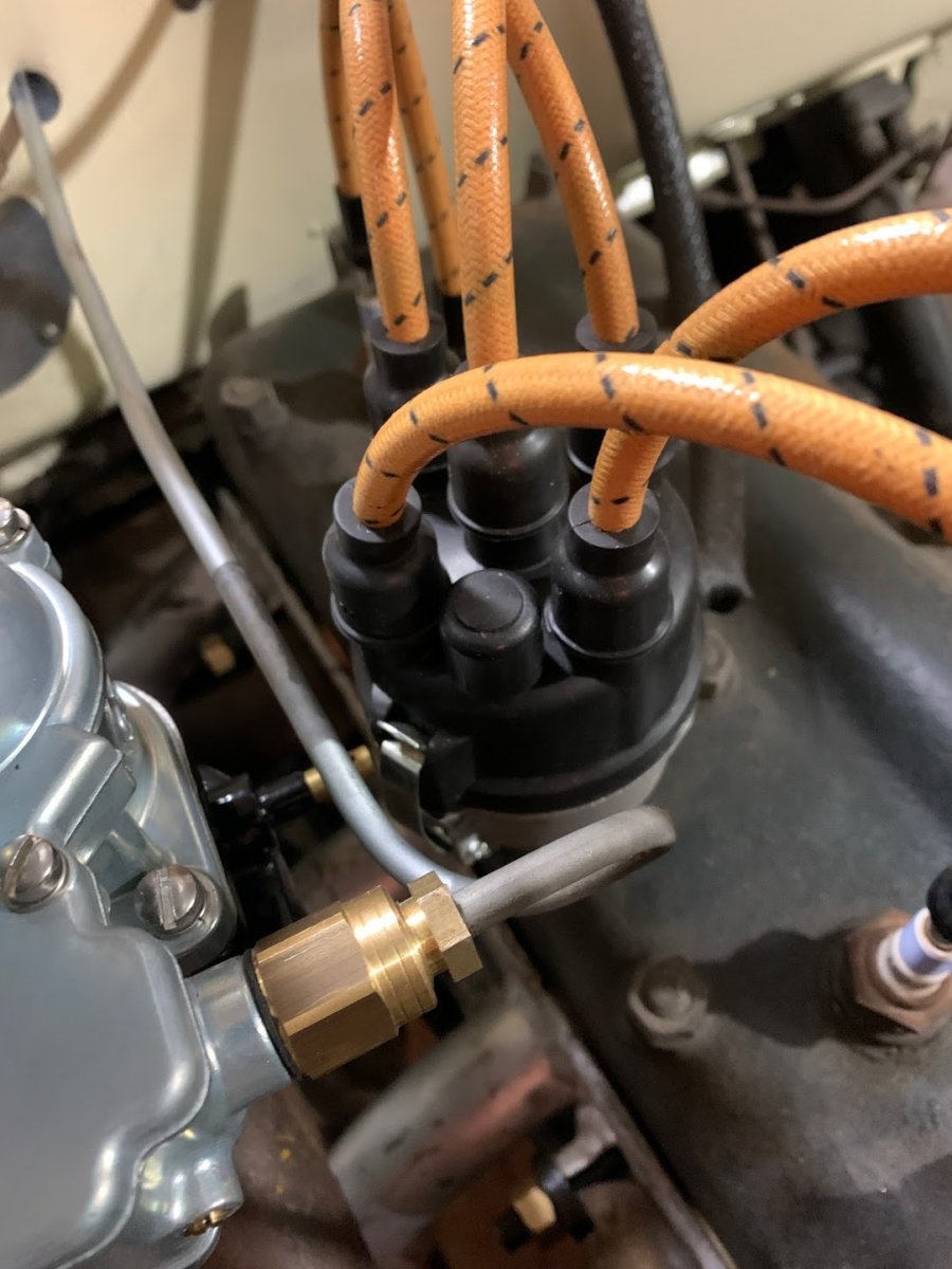

    Today's project was an exciting one: prepare and install my Cragar valve cover, compliments of @Six Ball. Although future plans call for a proper polish, I gave it a little bit of attention with the compounds I had on hand. Out in the sun, the fins and the CRAGAR portion have just the right amount of shine to fit with the overall ethos of the car.
    I just so happened to have a fresh gasket on hand, so I put it into service. IMG_3544.jpg
    Interestingly enough, the hole for the oil attachment bolt was slightly oversized. Upon further inspection, I discovered that it had been tapped one size up. Rather than hitting the hardware store right away, I figured I would wander to the back of the garage and see what I had in the Midland Multi-Pack. Lo and behold, I found the perfect bolt with the perfect finish in the perfect size.
    IMG_3543.jpg To make things even better, I had the right size copper washer. I modified the oil tube, applied some anti-seize and put everything back in place. I'm loving how this engine is coming together! I plan to paint the intake either VHT silver like the header or black to match the bottom of the carb. We'll see how the repair goes first.

    I've been jumping back and forth on whether to run the Holley regulator or not. Of all the folks I've asked, it's been close to a 50/50 split. Even the tech expert at Holley said he'd just try it without it at first. I've had plenty of overflowing carbs on bikes. It's annoying. Although it's not era correct by any stretch of the imagination, I'm leaning towards using it. I want this car to be functional.
    That being said, I decided that I'm just going to run the regulator up on the firewall in true function-over-form fashion. Plus, I do have a pretty neat Made in USA Stewart-Warner pressure gauge that I can put into play. After sketching up a plan, I hit the hardware store and shopped for the correct NPT fittings. I found some. I'll be getting the rest through McMaster-Carr.
    Last but not least, I started laying out the final section of fuel line. As I'm sure you're well aware, it's much more fun working with the 1/4-inch line opposed to the 3/8ths. I will finalize the shape/routing once the regulator is in place.
    Ignore the fact that it's going through the firewall. It'll be trimmed to fit and connected to the rest of the car via a small piece of clamped rubber hose.
