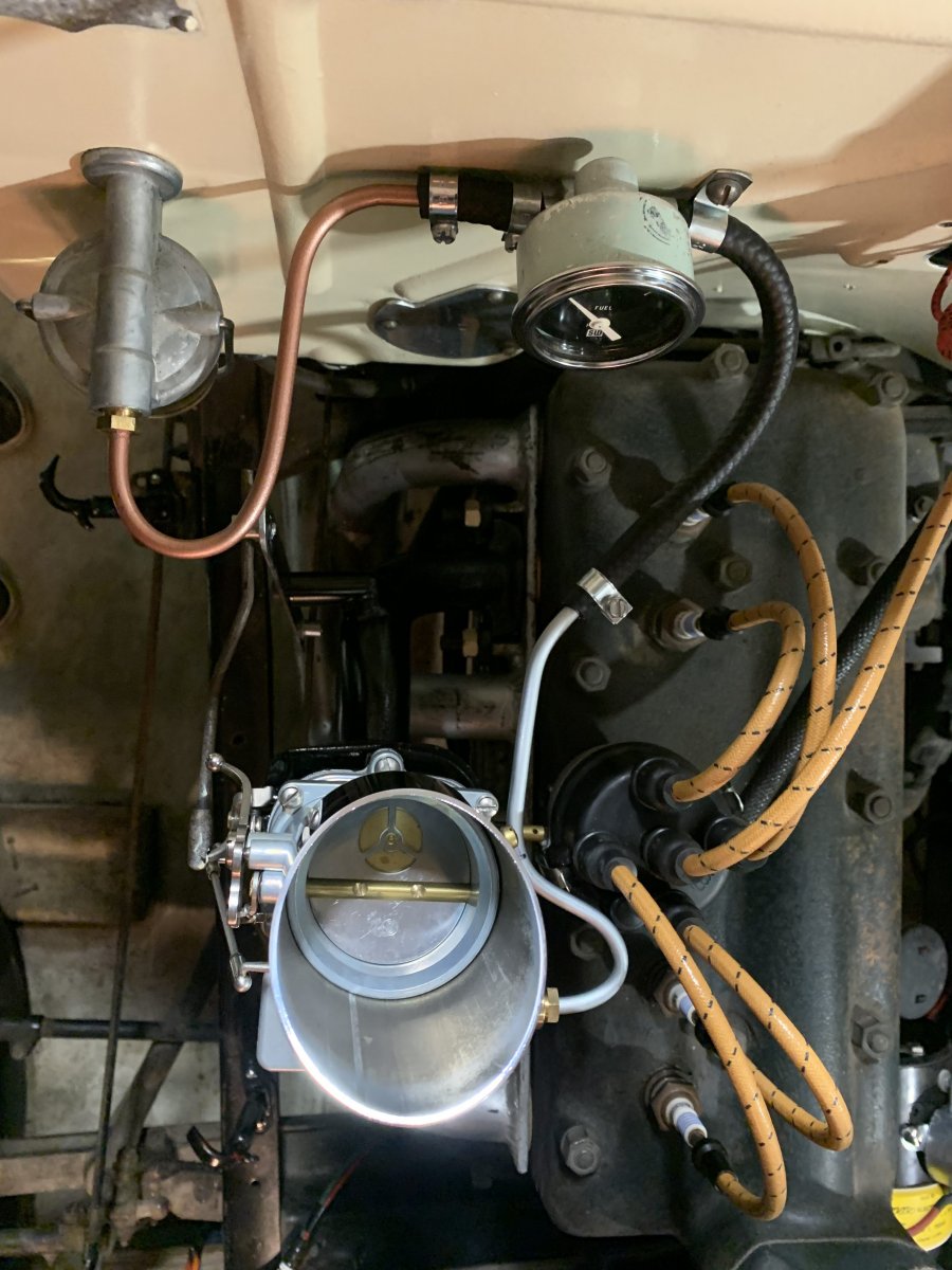

    As promised, I have a number of updates on the roadster project. First and foremost, as @winduptoy noted, I now have a fire extinguisher for the car. I splurged for a brand-new, refillable halotron for ease of cleanup. Buckeye has been around since the 1960s, and I like the cl***ic look of the logo and green anodized accents. It came with a DOT mount with a quick-release. Right now the plan is to mount it next to or right behind the driver's seat—easily within reach. It's a no-brainer to have one in the car.
    Between hiking to the summit of Mt. Diablo, camping at Samuel P. Taylor State Park and exploring the streets of San Francisco, Andrew and I decided to take a shot at finishing up the fuel system. Before we did, I purchased a Ford inertia switch that will be mounted underneath the dash. It will be here this week. (Thank you everyone for the guidance on that one.)
    It took a little bit of finessing, but we managed to hook up all the fuel lines and hoses. Just like before, these are steel lines painted copper.
    We also cut and drilled the bell-crank arm. One of the most fun parts was creating the linkage. We were both pretty excited to see it work smoothly with a press of the pedal.
    I kept the arm and rods long in case I needed to make more adjustments. Before I drive the car, I will be installing a throttle return spring. The arm will eventually be painted too. Money is tight right now, but I'm hoping to buy a choke cable and mount for it soon-ish.
    I am so happy to have all these old parts together on this engine. I have a small old chrome dress-up piece coming next week, but more on that later.

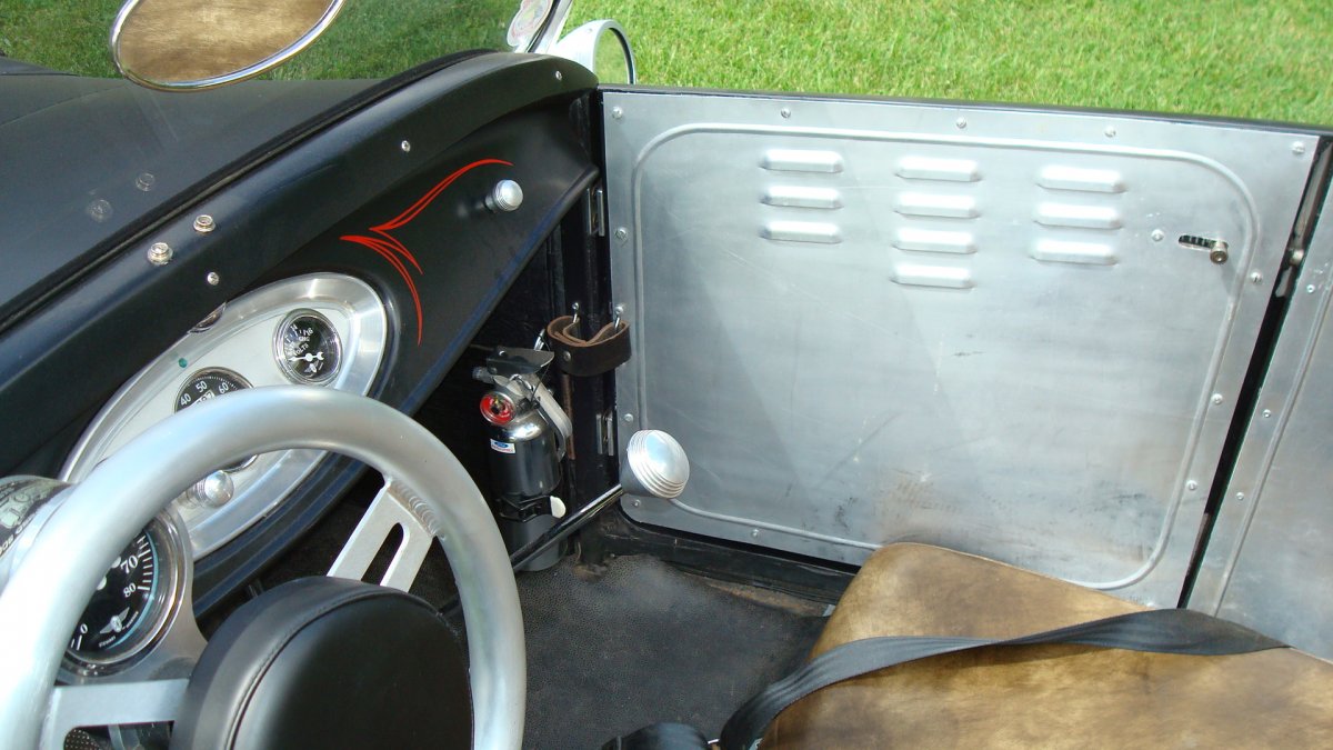

    The question is, will a chrome extinguisher put out a fire faster than a painted one

    If it don't blow chrome it!

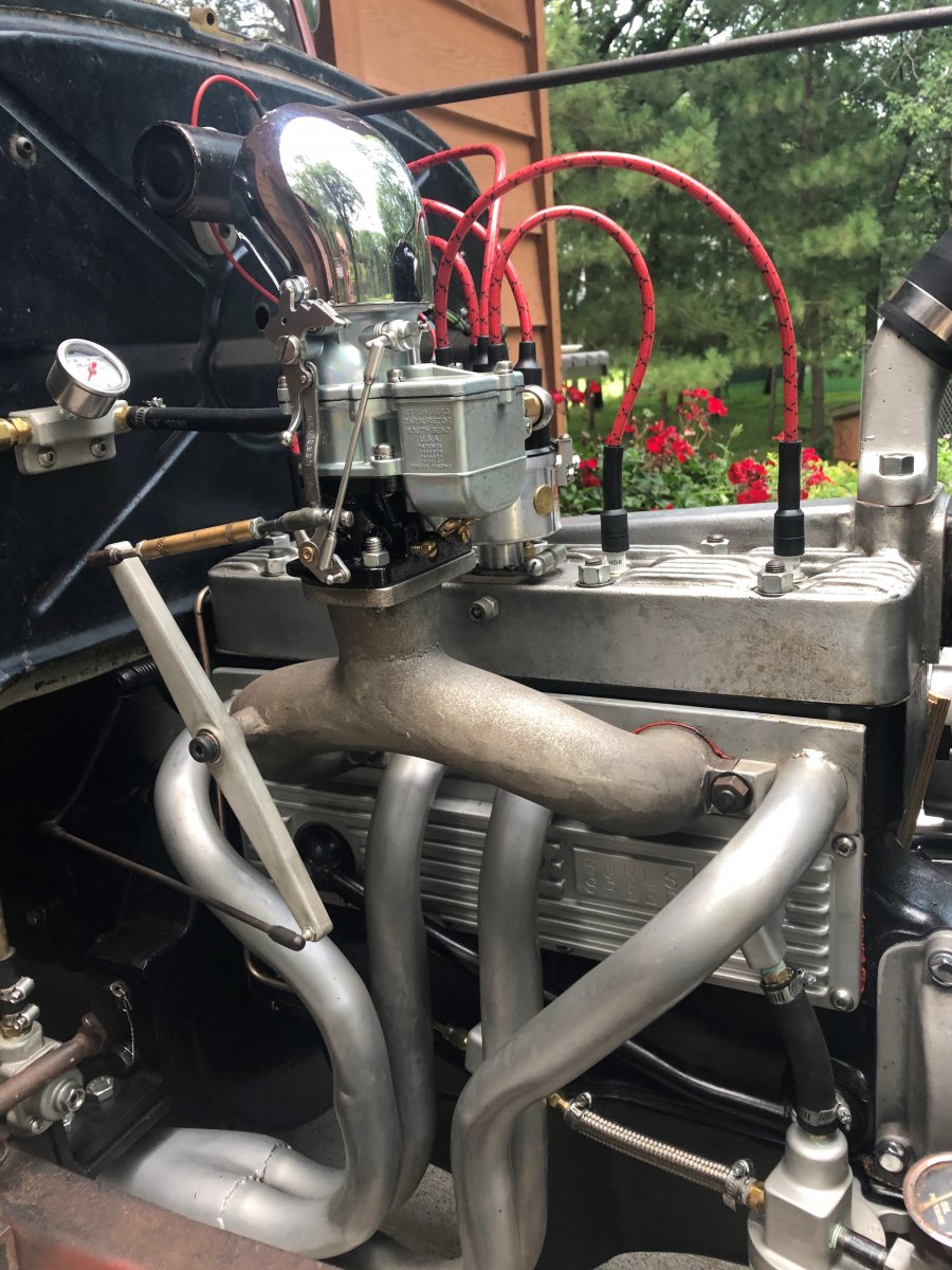

    I'm sure cash is tight and influence's your decisions but the banjo fitting on the carb is a much cleaner and better sealing option if you can afford it. This the best pick I have of my set up leaves plenty of room between the distributor and carb for clearance

    Is that a Ford engine in a (gasp) Chevy!?!? Just kidding, that banger looks killer! Is that a FSI dizzy? (Don’t mean to hijack a mans thread but I have questions)

    We have to find you a head & a cam. You don't need no stinkin' flathead. :rolleyes:

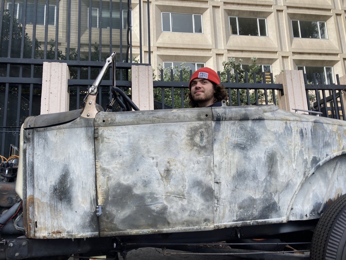

    Thanks! With a street full of Edwardian flats and the dorms looming in the distance, it was making all sorts of noise. Mufflers will be happening soon.
