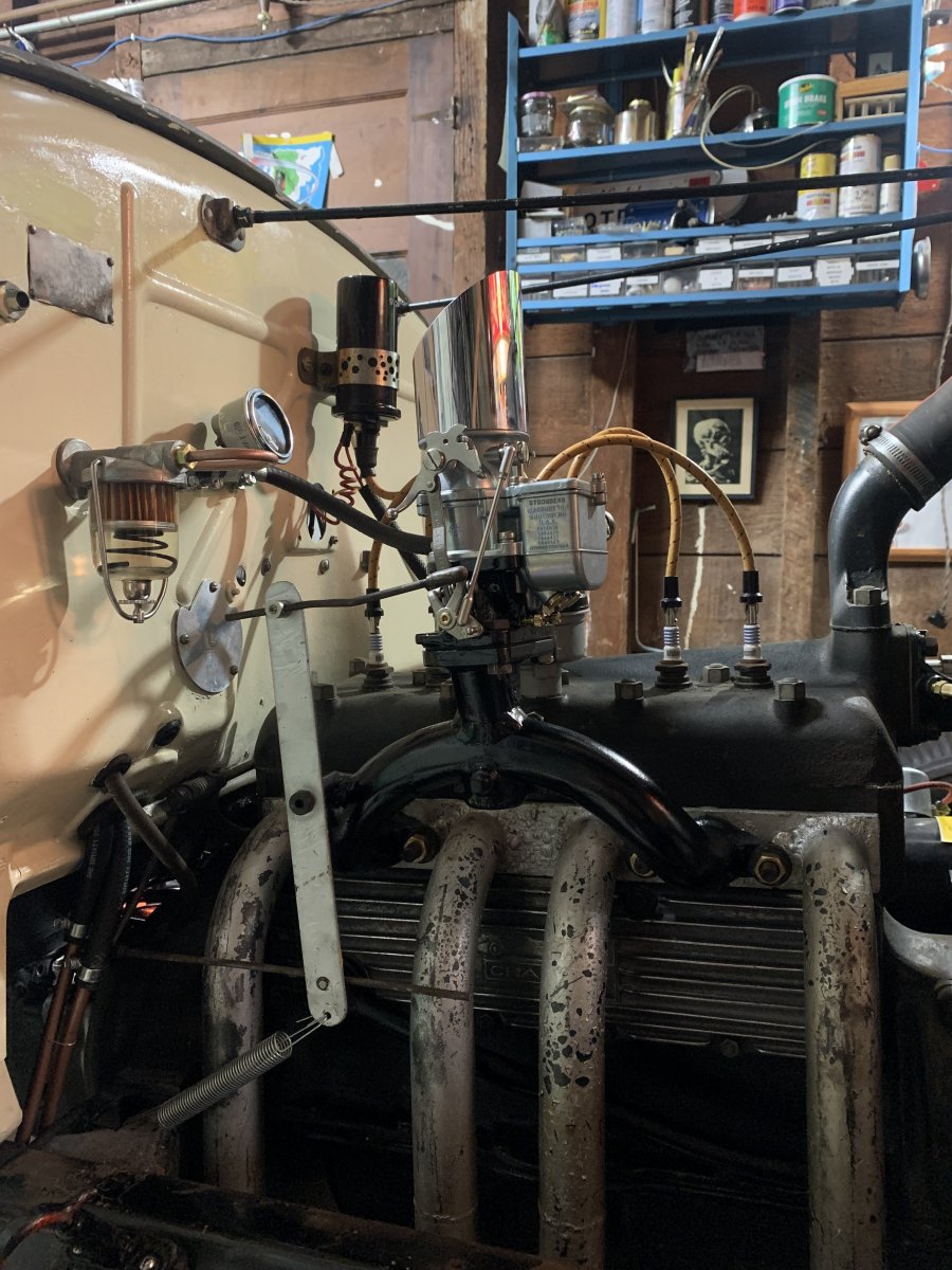

    Today I managed to buy the correct throttle return springs and find my missing Allen wrench (the only one that is the right size for the adjustable linkage ends). This weekend I plan to get all that squared away, grease the front wheel bearings with Sta-Lube and take it for a drive down the cul-de-sac.

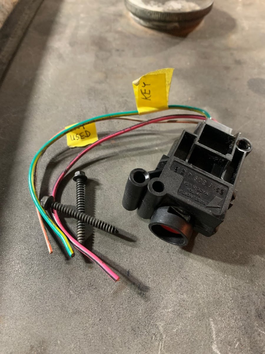

    You may not realize this but that inertia switch won’t work on a model A , you will note the first two digits on the part number are 32 , which designates it for use on 32 Fords only.....
    Ok I’m just screwing with you , love your build , I keep following along ‼️

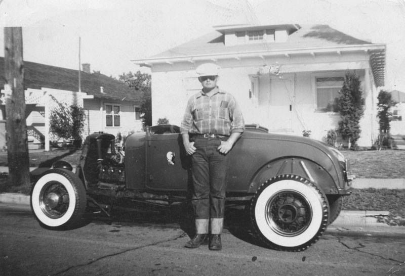

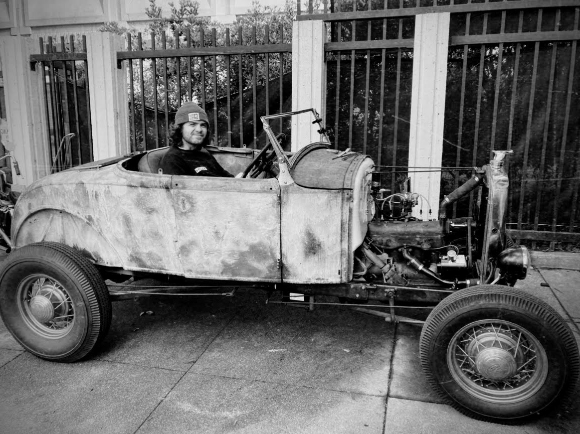

    Love the shots of the car using the old film, but to really do***ent your progress, YOU need to be in the picture too.
    Just like the first picture in this thread, having you in the shot do***ents the person as well as the car.
    One thing everyone here will agree with when looking over pictures from the 30s, 40s and 50s is look at the owners too. It helps do***ent the era, who owned it and show the people that did the work. As many old timers will tell you, it's the cars, but more importantly the people that are the connections that they treasure over the years.

    It’s been a long time since I’ve seen turned upon jeans, that really dates this picture

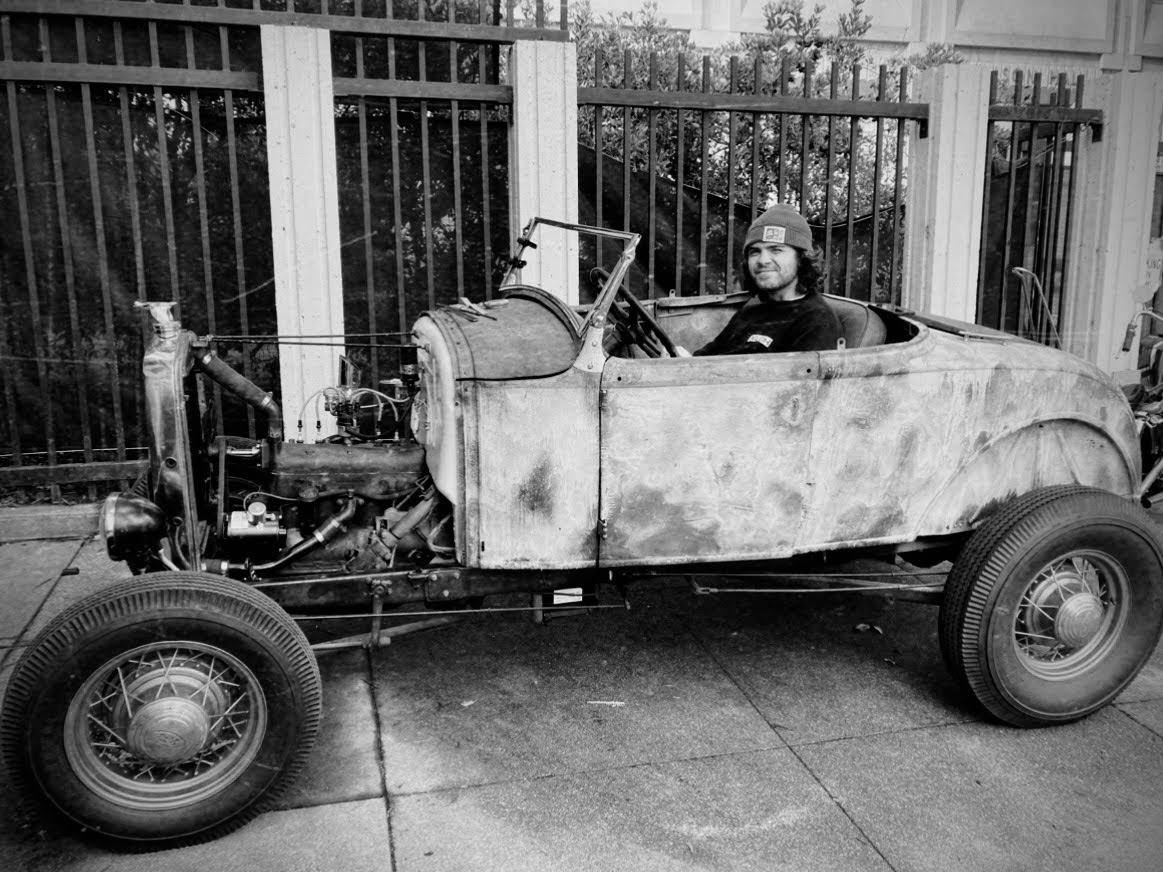

    I hear ya loud and clear. The majority of the time, I'm working on the car by myself. Seeing that my selfie game is poor, there aren't too many pictures of me with the car. But! I'm working to change that. Speaking of which...
    I need to have someone shoot one from the other side to highlight all my freshly installed speed equipment.

    Over the weekend I was able to check a couple of boxes off the big list. The first area I attacked were the throttle return springs. I tried a number of different ones before I got the correct pedal feel. When they were too tight, the throttle response was poor. I had to custom bend one of the springs to make it work. Once I got that figured out, I painted the throttle arm to match. I think there are about four layers of paint on there that will weather nicely. Loc-***e was added so that the ***embly will not rattle free.
    Note dual return springs. I hate to take it apart, but I plan to re-paint the header VHT hi-temp silver in the coming weeks.
    As paint was drying, I was able to roll the car into the driveway and re-grease the wheel bearings. Even though the green grease I was using was designed for boat trailer bearings, it didn't explicitly state that it was created for automotive use. Based on fellow H.A.M.B.ers' advice, I ordered the correct Sta-Lube bearing grease for drum brake-equipped vehicles. It's much more fibrous and feels like the right stuff for the job. I removed all old grease prior to re-packing/re-greasing.
    Seeing that it's a messy task, I only took one photo while the incorrect grease was on there. IMG_3843.jpg
