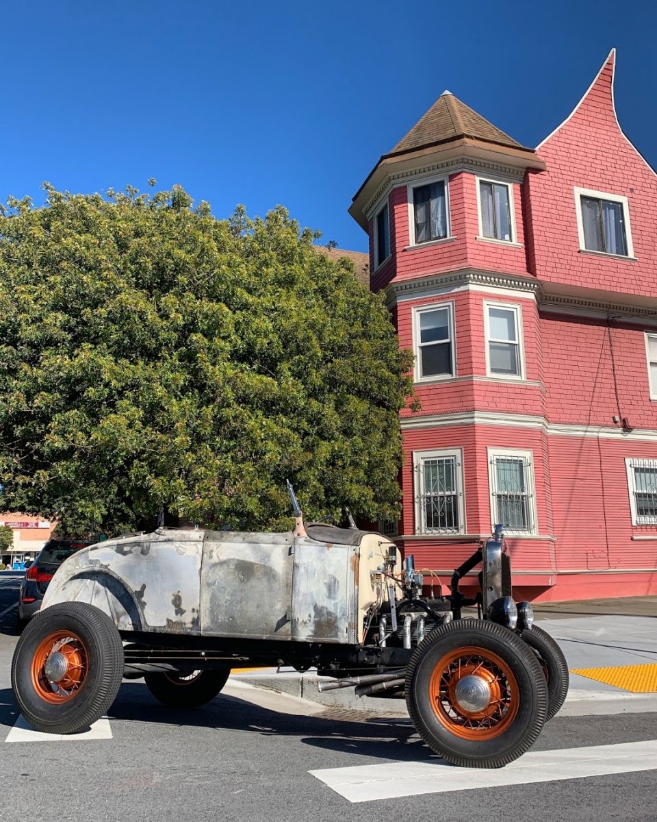

    I love hearing everyone's old hot rod stories! I have a fun one that I posted over on Instagram the other day that I'm going to share once again here.
    "The Pink House"
    This is my favorite house in San Francisco. Every time I p*** it, I smile—or stop mid-conversation and tell whomever I’m talking to how much I like it. I love the turret, swooped roof and, of course, the color. It’s undeniably fun.
    During today’s Model A test drive, I pulled over for a picture. It’s a shot I’ve taken many times with just about every vintage machine I’ve owned in the past six years. As I stood in the street, an older gentleman walked by. “I like your car!” He said with great enthusiasm. I thanked him and told him that it was from 1930. “Twenty years older than me!” He said.
    I let him know how happy this house makes me. “Oh,” he said, “it’s my house!” I couldn’t believe it. After all this time admiring it, I finally was able to meet the owner. He informed me that it was built in 1904—two years before the big San Francisco earthquake. “What’s your name?” I asked. “Joe.” What’s yours? “Joey!” He laughed, I laughed and all was well.

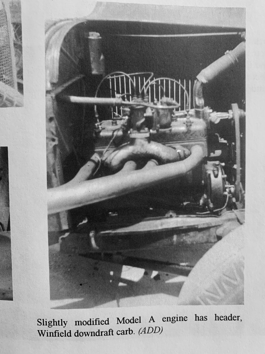

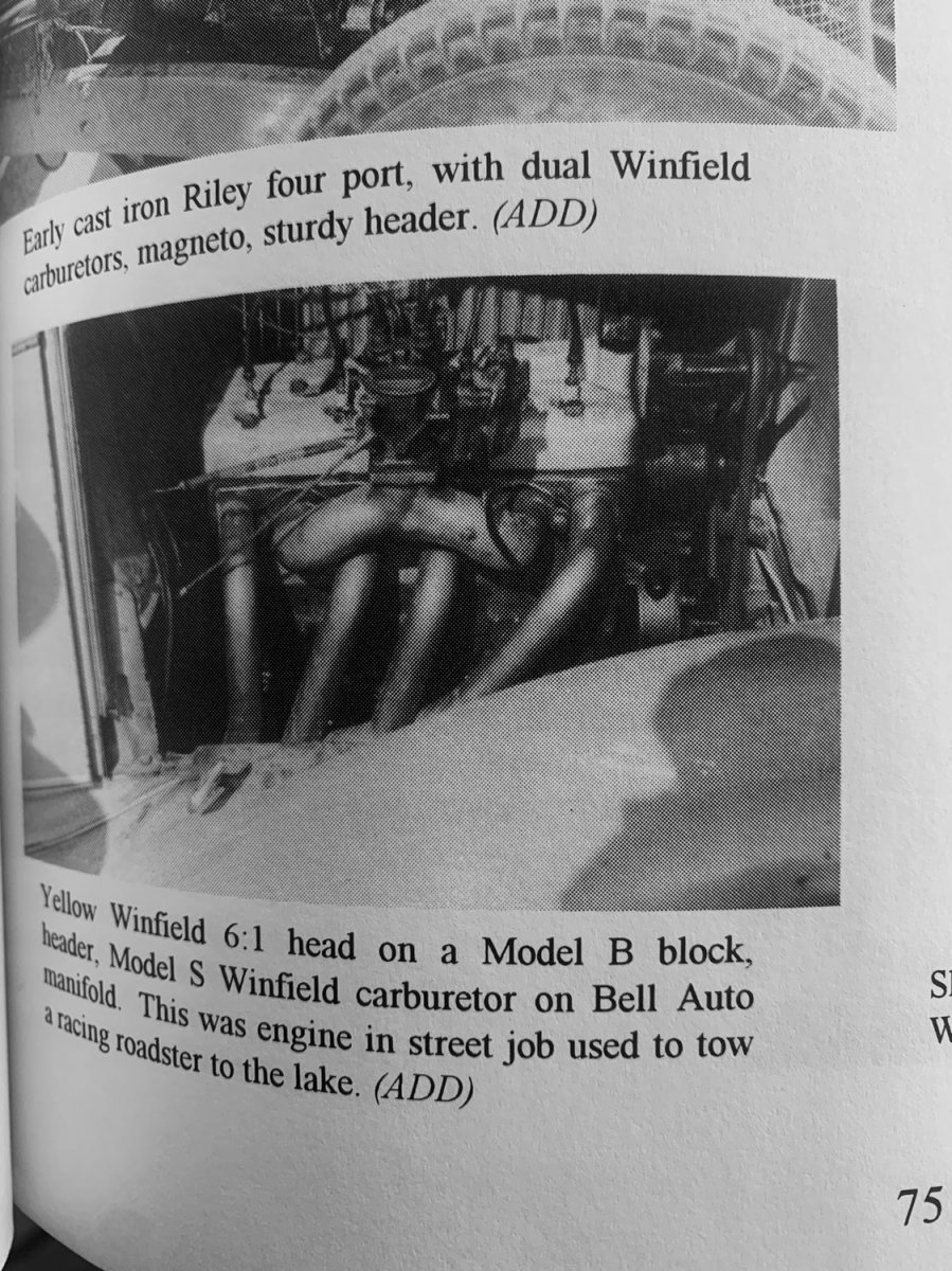

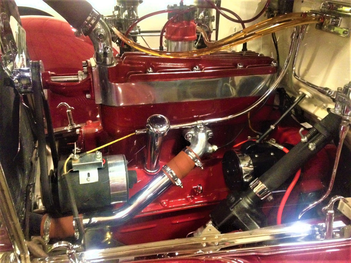

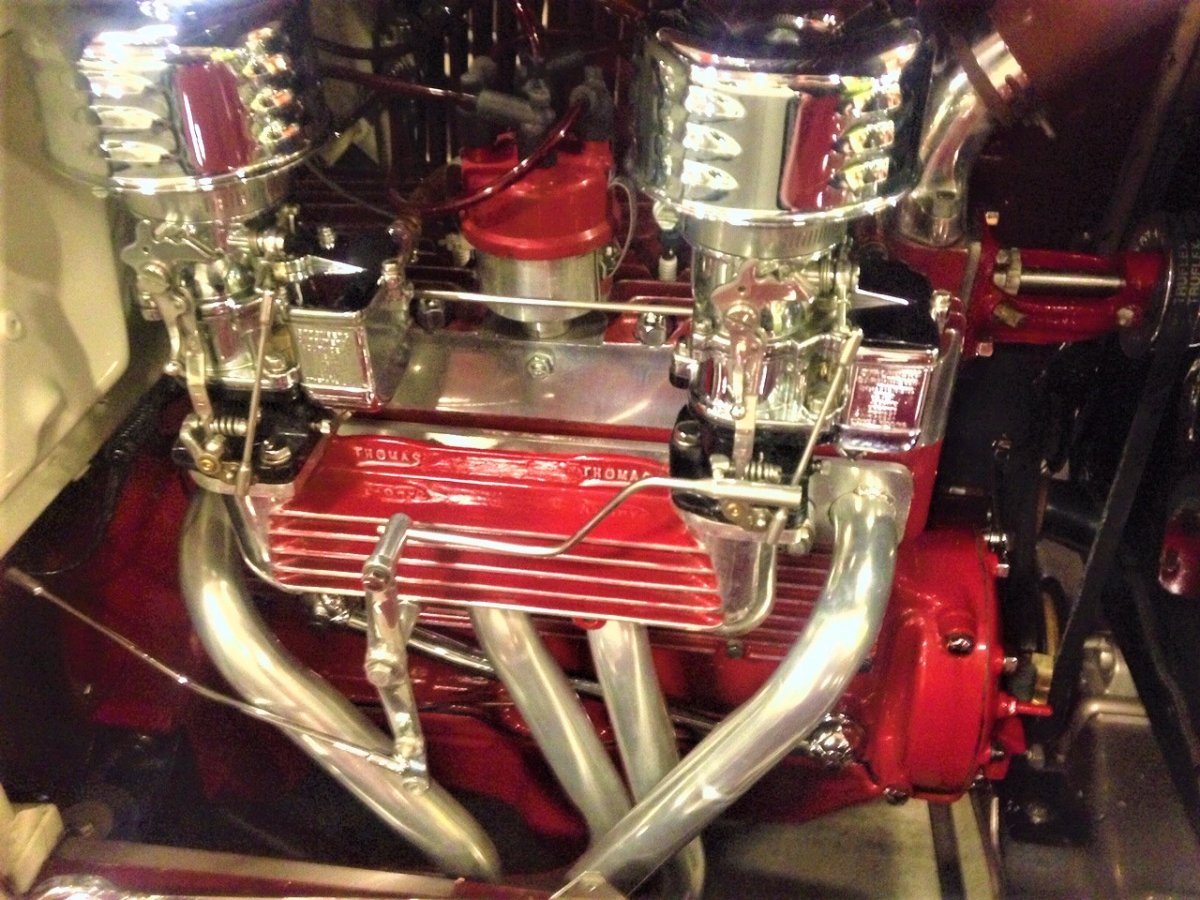

    Joey, I know this isn't the way you are going to go with your banger, but this is some magnificent eye candy to be appreciated, it belongs to a friend of mine here in Seattle.

    This video never gets old. That has to be the hottest traditional 'banger around. Worth the price of admission right there.
    Woah, that is pure art. Details everywhere you look. I especially like that Thomas head and matching intake.
