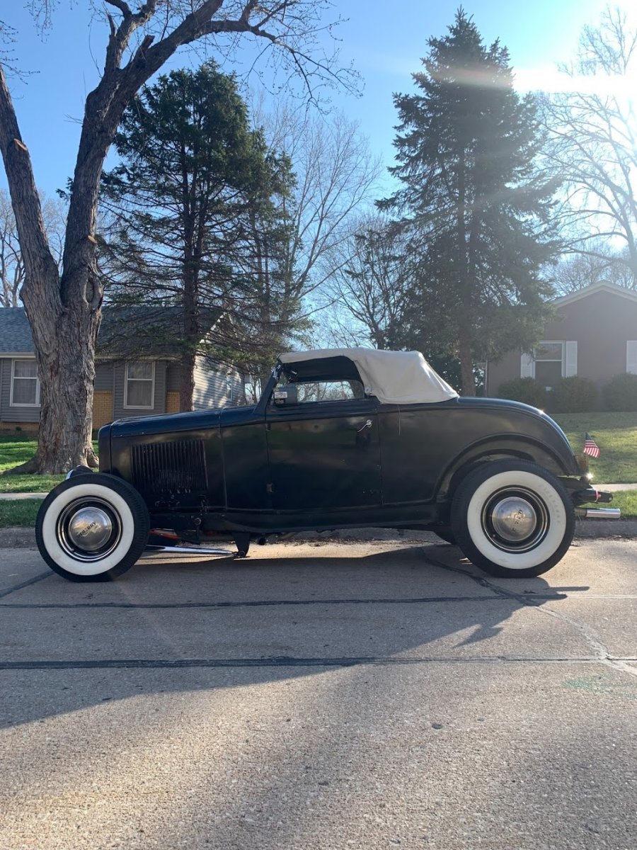

    Although progress on the car is a little bit slow right now, hot rods have been fresh in my mind. Here are some highlights from here and there. IMG_3931.jpg
    Hanging with @tdog in Omaha. We have a big project in the works, and I'll be sharing more on it later.
    Journalism action photo by John Cobb.
    Tom's dad's Chevy-powered survivor Deuce cabriolet.
