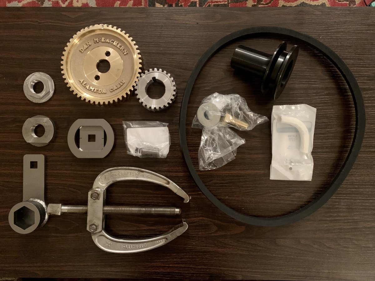

    When I walked in the door last night, I was greeted by a big pile of packages. I’d like to think of them as early birthday presents to myself and my car. I also have a few little pieces that I picked up in Oregon that I’ll share later.
    I have some work things to attend to today, but I’m thinking I’ll drain the radiator and get the rope seal soaking in oil this afternoon.
    I know we’re still a few days out, but what do you use for gear ***embly lube? There are a ton of products out there and I’m not sure which one to go with. Any input would be greatly appreciated.

  29. Glad you went with Dan's gear.
    Let us know how you like it!!
  30. Beanscoot
    Joined: May 14, 2008
    Posts: 3,644
    Beanscoot
    I'd put a squirt of motor oil or gear oil on those gears for ***embly, no need for anything fancy.
    Nice collection of machine parts there!
