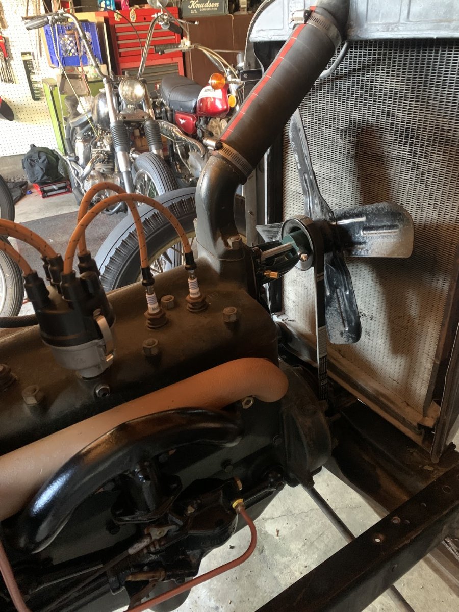

    So just like with the bikes, I know there’s a lot of two steps forward, one step back-type situations. Although the car ran well, the water pump was leaking like a sieve. After a great deal of research, I went with one of the newer leakless pumps. Seeing that I have a four-blade fan, I opted to remove the radiator.
    Out with the old. There was a lot of play on the shaft. I think I may rebuild it just for practice and to have an extra.

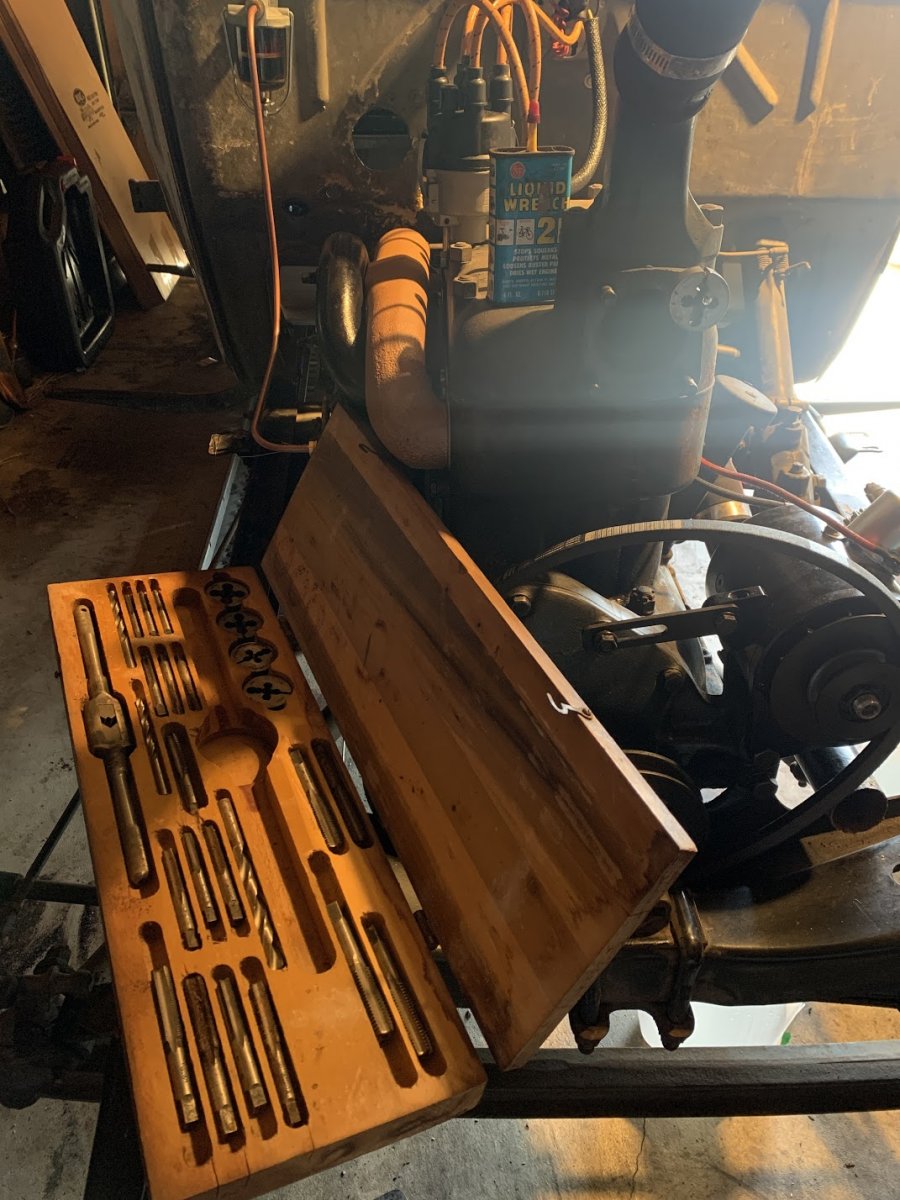

    I'm in the middle of moving, but my goal is to be able to drive the car to the new place. It's only a mile away, but I didn't feel comfortable doing that with the leaky water pump. I have until the 10th of October to have not only the old spot cleared out, but also the roadster ready. As you guys know, I'm always working with deadlines.
    This afternoon I was able to get the new water pump installed. One of the studs needed a little cleanup work, which gave me a great opportunity to use my era-correct tap and die set that I got at an estate sale in SoCal a little while back. With that all straightened out, I put everything back together and fired it up for the first time in a month. After a little fiddling, it fired right up. Best of all, the new water pump seemed to be working just fine.
    And the finished product...

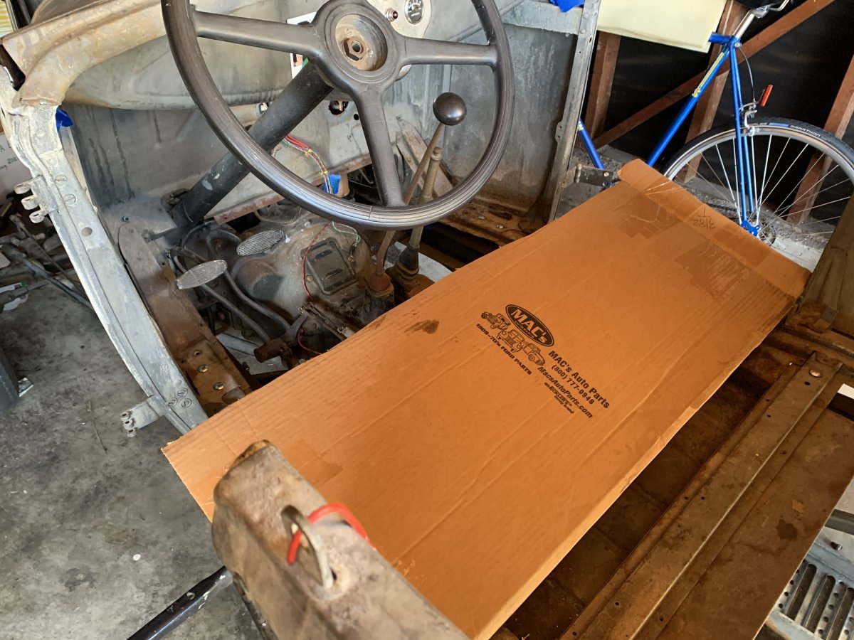

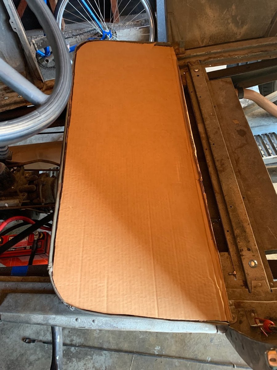

    Next, I started making the template for the lower seat out of cardboard. IMG_0483.jpg IMG_0484.jpg It will be 3/4-inch marine-grade plywood stained to match the floor. It will bolt on to the seat pan and serve as the base for the seat. Grade 8 hardware will be used to secure it.
    That's all for tonight. I gotta do some packing!

    Cool set of taps and dies. Snowman

    I'm going to ***ume that "stained, means sealed. It looks like you are making some serious progress even when you are on a trip across the country.

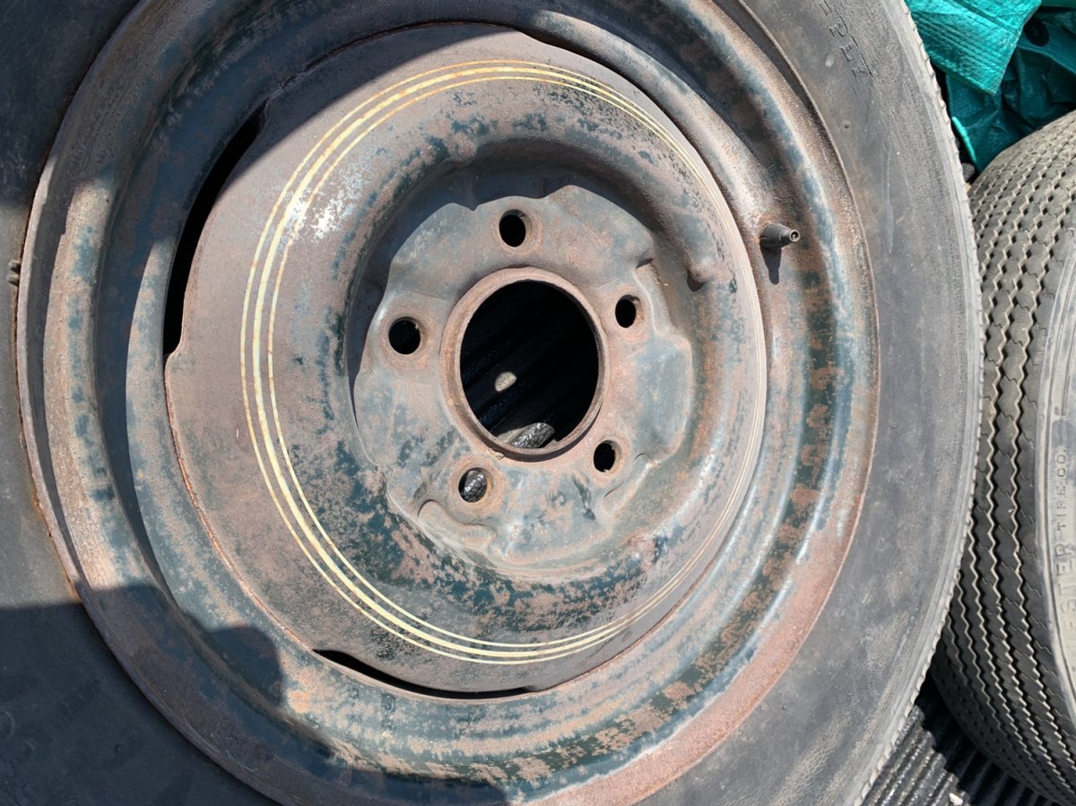

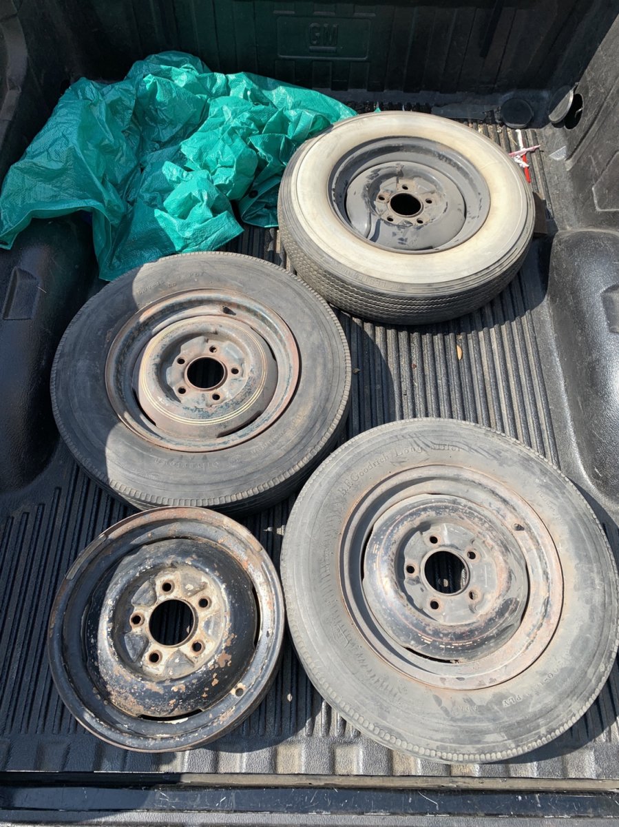

    Moving has been going smoothly, but it sure has taken up a lot of my roadster time. That being said, today was a red letter day.
    Even though this is an early style build, I knew I wanted to run steelies from the start. After talking with @13clicks about what he did on his roadster to have steelies and mechanical brakes, he sold me the front adaptors he made. They should be showing up shortly.
    Then there are the wheels. My friend Brandon Flanner of East Bay Speed & Custom hooked me up with a killer set of 16-inch ‘40 Ford steelies. They’re four inch fronts, 4.5-inch rears. I had a great time hanging out at the shop, catching up and learning the finer points of hot rod rolling stock. Later this week I’ll be buying my bias ply Firestone black walls. I can’t wait to get these on the car! Note the original pinstriping!

    Grade 8 hardware to secure plywood. :confused:
  27. 48fordnut
    Joined: Nov 4, 2005
    Posts: 4,215
    48fordnut
    A bit of overkill for grade 8.
    panhead_pete and J.Ukrop like this.
  28. J.Ukrop
    Joined: Nov 10, 2008
    Posts: 3,649
    J.Ukrop
    SUPER MODERATOR
    Hey, you guys know way better than me. I was under the impression that things like seats should be securely fastened. The seatbelts are connected to the seat frame via Grade 8, so I was just trying to follow suit. If this were your build, what would you use?
    chryslerfan55 and 48fordnut like this.
  29. 48fordnut
    Joined: Nov 4, 2005
    Posts: 4,215
    48fordnut
    A collision would likely tear the wood before a bolt would break. You are right use what you think would be adequate. I would use large area washers around the bolt heads whatever grade you use.
