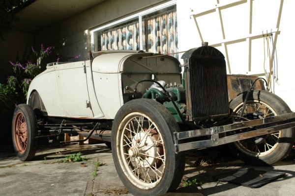

    Not much to see
    The day I moved the body from it's own frame to the stock frame of the other roadster, in preparation for the rebuild , it was already stripped out and primered for bodywork and new paint .
    Next iteration of my roadster will change things somewhat , the banger will remain, BUT there will possibly be some post war mechanicals and technology , from the outside it still will be able to be described as early. OR I MIGHT PUT THE BLOWN FLATHEAD IN! :D:eek:.....unlikely.
    Outback, Six Ball, Nobey and 3 others like this.
