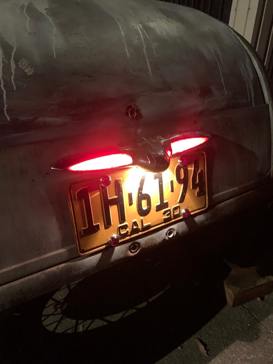

    So will the red lights above the plate be only brake or tail and brake?
    fantastic visibility and they look sharp.

    Thank you! So the lights above the plate are both brake and tail lights. Between that and the lower lights, you can tell I'm stopping!

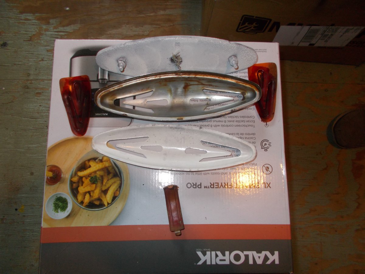

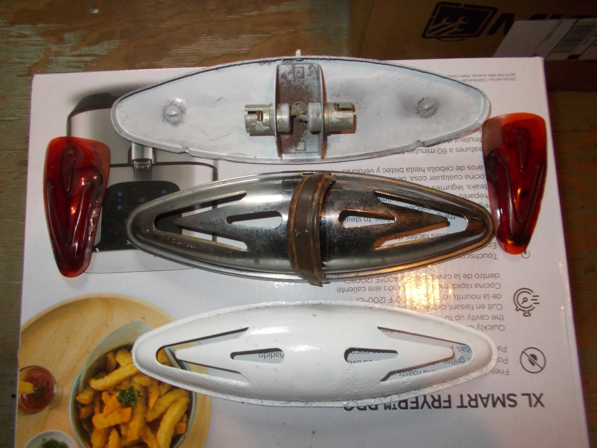

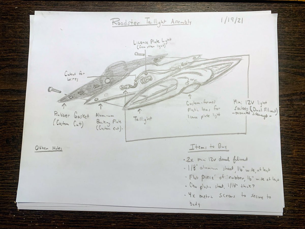

    WARNING: O/T content ahead. I may have to moderate myself and delete it. But there's a method to this madness. Anyways, here we go. IMG_2703.jpg
    Back in January, I drafted up this concept sketch. I had a basic idea of what I wanted to do but, as you can tell, I wasn't sure about the details. After a lot of trial and error, I realized that I couldn't get bright enough 12V bulbs to fit underneath the taillight lenses (only mini ones would fit). I tried different sockets and bulbs, but it didn't take long to discover that the best way forward was definitely O/T for this forum. But I'm driving this car in a major city and I want to be seen—especially at night. So, I went with four low-profile LED lights. Two banks are for taillights and two are for braking. There was no question that I would be running a traditional license plate light for that unmistakable yellow glow.
    I cut the aluminum backing plate at di Falco's and proceeded to paint it white for better reflecting properties. I wasn't happy with the internal wiring, so I switched it up after this photo to something a little cleaner. David also donated some cork material to the project. It gives it a neat factory look.
    While mounting the light, I made sure to incorporate some era-correct hardware. IMG_5182.jpg
    I then cut a rubber-ish gasket to fit between the light and the backing plate. Next up, it was time for testing.
    The camera picks it up as more orange, but it's red in real life. The aged lenses make the LEDs less obvious. Part of me wanted to keep it a secret, but for the sake of transparency I figured I'd let you guys know.
    All wiring is of the cloth-wrapped variety and goes through the spare tire holder hole. It's by no means perfect; measuring stuff on a car like this can be tricky.

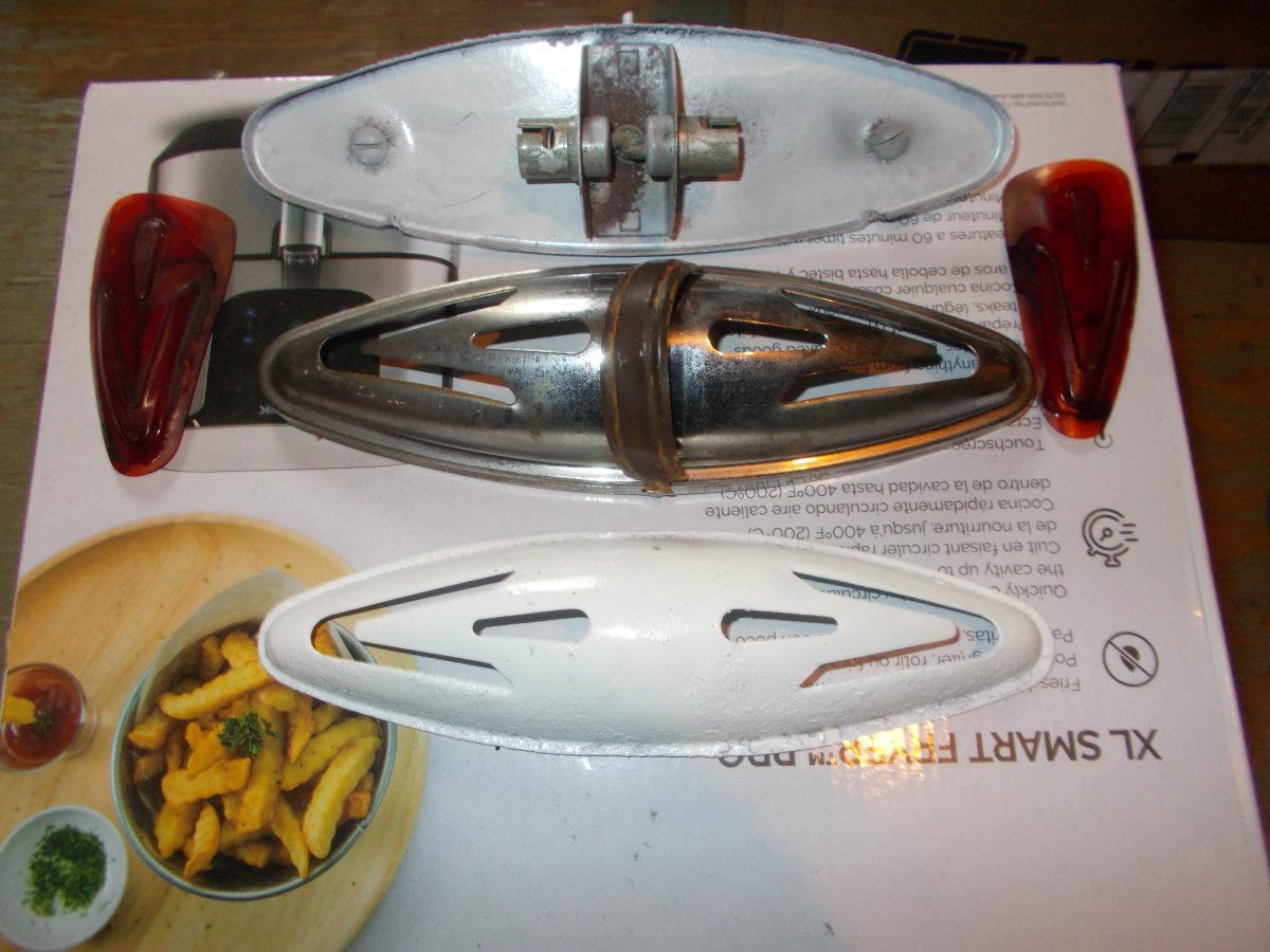

    Well the sacrilegious lamps won't cook the taillight plastic.
    If you were able to get bright enough proper lamps in there, they might produce damaging levels of heat.

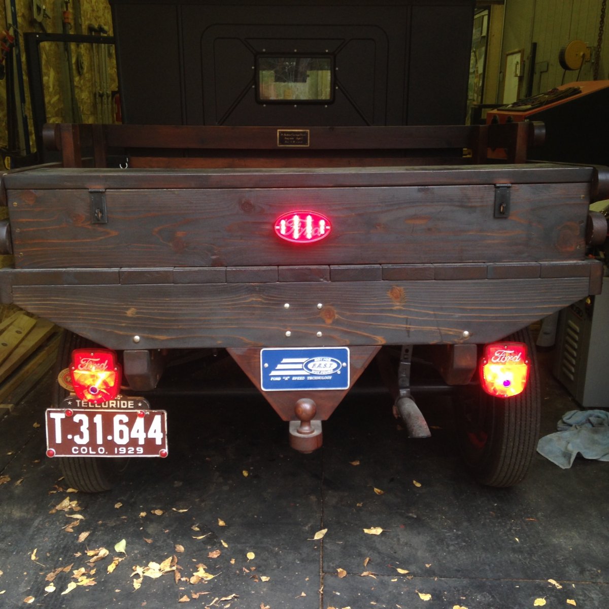

    In my opinion safety is never off topic. Seatbelts, better braking, louder horns and brighter lights are all good ideas... LEDs that don’t spoil the look are great.

    My third brake light is one of those LED hitch receiver units that I used. Like others have said, “safety is traditional”. ‘53 Truck tail lights bolt right on the Model A truck tail light brackets.

    i did coat both sides of the red turned orange lenses with "red" dy-chem, works great, can turn a bike's orange bullet marker or fender light red...
    he thought the light went for about $100.. DSCN7644.JPG DSCN7645.JPG DSCN7643.JPG

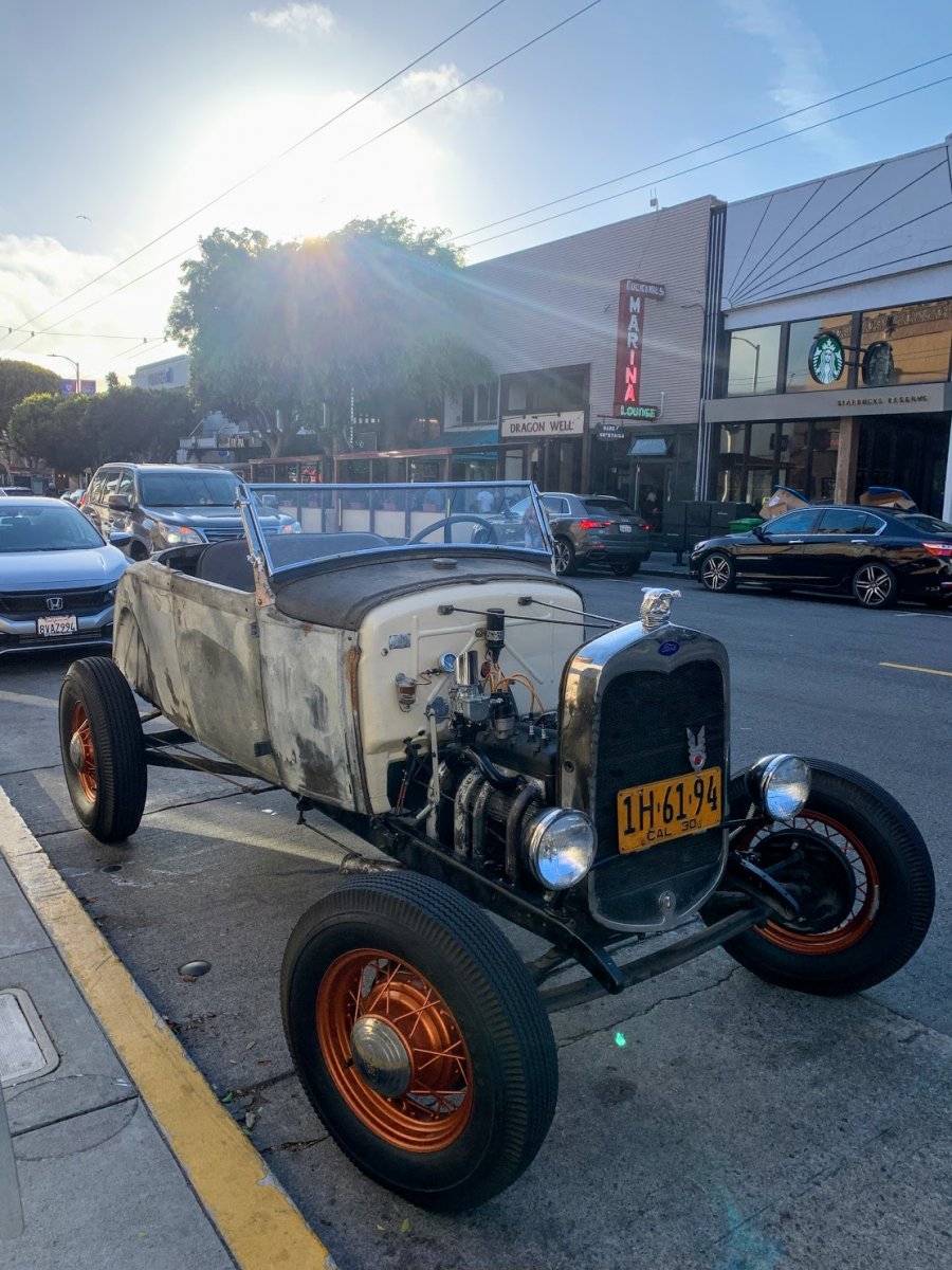

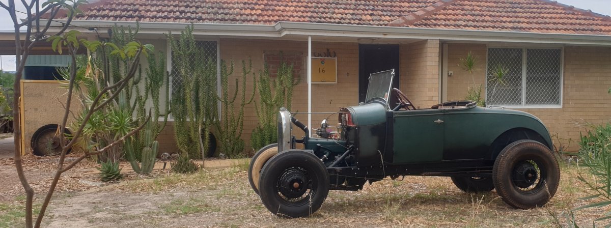

    For the rest of the day, I used the car as a car. It was crazy cool. I picked up groceries, took friends for rides, showed it to the guys at the local auto parts store, and even went on a nice late afternoon drive through the Presidio. Everywhere I went, I loved talking to people—both about the car and hot rod history in general. I know a lot of you have been driving old cars for most of your lives, but this is all so new to me. I feel extremely fortunate to be able to drive this old hot rod on a sunny San Francisco Sunday.
    Power parking in the Marina.
    The roadster and "The Rock."
