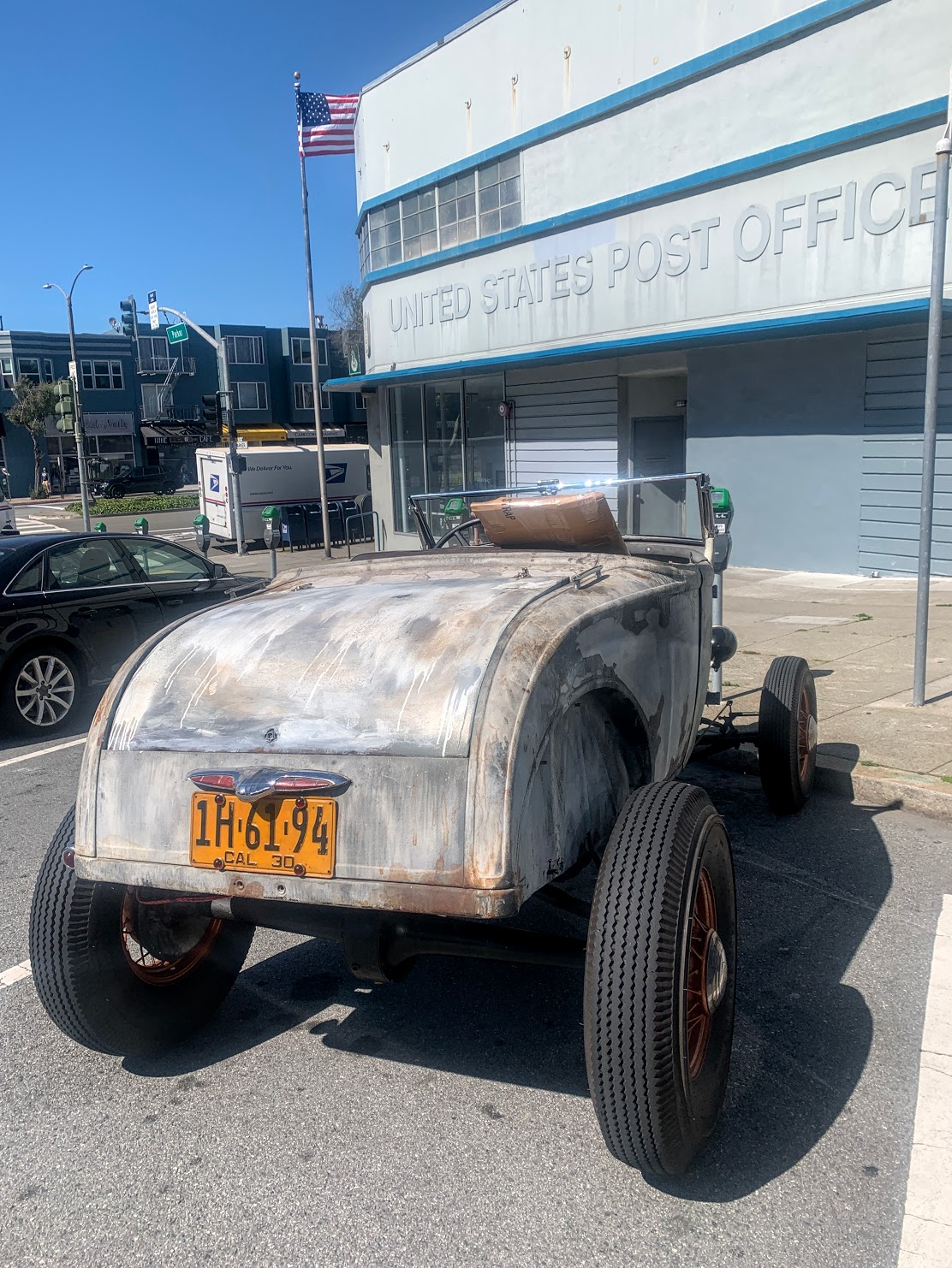

    Not much time to work on the car today. I did apply some spar urethane to the floor, and I'll be doing the same tomorrow. There's no doubt that one of the biggest highlights was sending @Tribalmonkey his windsheild frame for his up-and-coming roadster project. In that same batch, I shipped a Stromberg to @nickthebandit for a little parts-swap. IMG_5634.jpg
    Power parking at the Post Office in a pre-war Ford. That's my update for tonight. More soon.

    Haha! That is awesome! Fun being on vacation with the family and knowing that I have a Ukrop roadster windshield frame in the mail. Let me know if you need me to send any rust from ‘Ratty’ your way. I have plenty. Cheers! TM

    So, did you steal the paint style from the USPS or did they steal it from you?:D
    That package on the seat looks like a before from the "mangled" files. Hope it arrives okay.

    I'll have one of those next time I'm in Maryland!
    The paint scheme was a collaboration! Don't worry, I've done a lot of shipping both personally and professionally over the past six years. On a big item like this, I use a similar approach to my roadster project. Rough on the outside, well-built on the inside. Besides, having a rougher exterior helps dissuade the porch pirates.

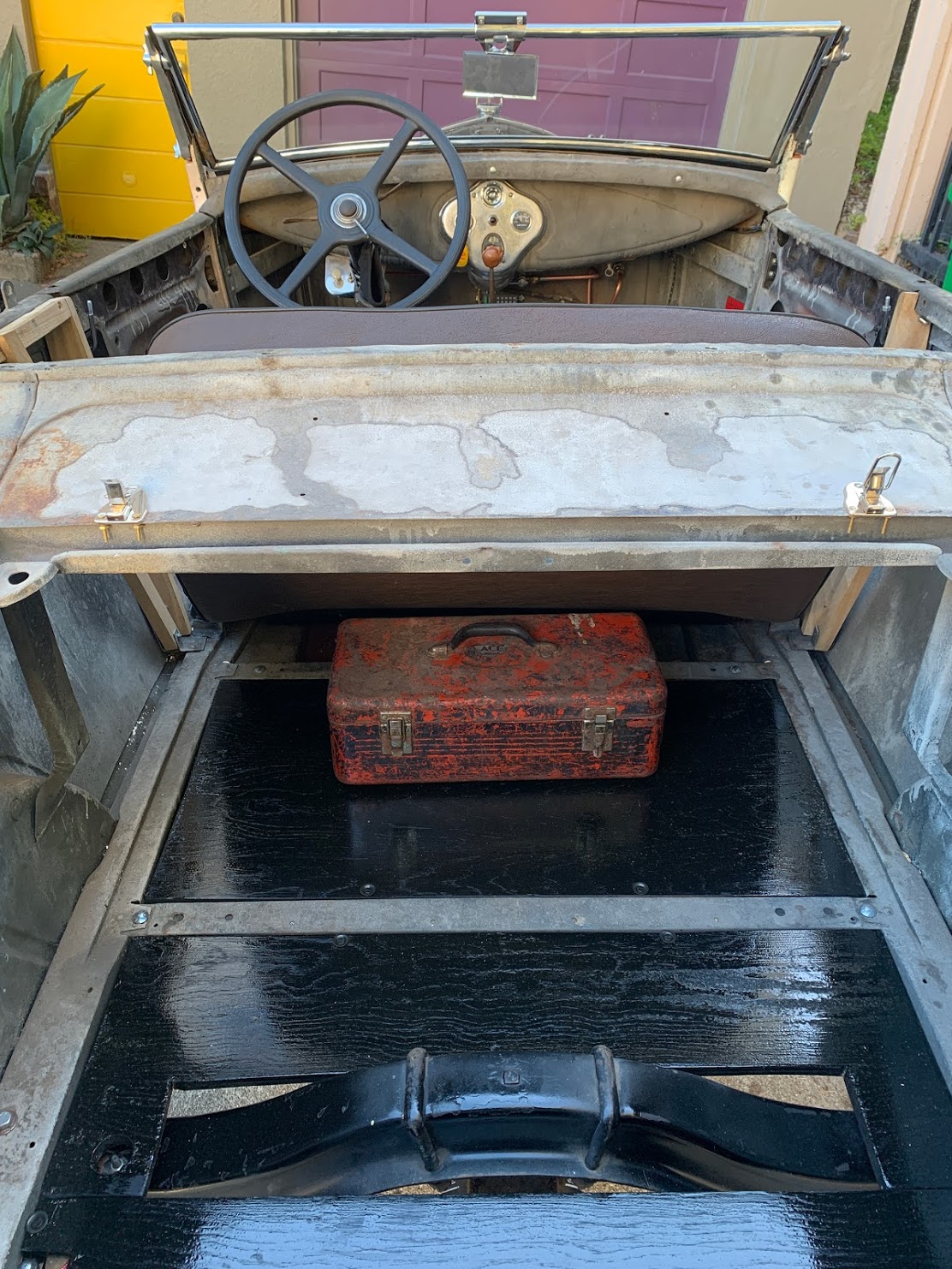

    I've taken advantage of these sunny days by finishing the floor. I'm very happy with how it turned out. And, best of all, it makes the car far more functional. I even picked up an era-correct toolbox to keep back there. My plan is to bolt it to the floor (position not finalized yet) and keep a tool roll inside. That way it will be one less thing rattling around.
    The floor was made in three pieces; I cut holes to easily access the junction block and ch***is ground while on the go. In the not-so-distant future I'm going to build the lower rumble seat/crossmember cover.

    Different tool box mounting idea.

    I think they make/made a tool box that fits between the front frame horns and follows the shape of the horns so it’s not even noticeable as a tool box.
    either way thanks for the updates!

    "VELCRO " is an amazing application that is hidden under the tool box, that stuff is strong, just a thought, so that you don't have to drill any holes !
    VELCRO comes in several different grades!
    ( The heavy duty industrial grade, will hold that tool box in place snugly, with confidence )

    Use your hood hold down latches to make it removable? That’d be cool…

    My first thought was a magnet but I like the idea of using model A hood latches. Could screw them to the floor and then put model A hood side lips /catches on the box.
    my second thought was a Dzus quarter turn faster on each side of the bottom of the box. That’s a lot of hills for velcro or a magnet to hold heavy tools in place

    I like the latch idea for the tool box. Hood latches or something similar to the lid latches on the box. Lots of those available on eBay.

    I was thinking leather straps to hold the toolbox in place, maybe with a wood frame for it to sit in so it doesn't slide around. Glad to see you are having so much fun with your project!

    Great ideas with the toolbox. It's funny that you guys mention this. I fully intended to build a spreader bar for the front of the car until I realized that if I did, it would no longer fit in the garage. How so? Well, the way it tucks in there, the Gopher Motor actually sits partially between the front frame rails. It makes for one snug garage! Maybe if I move I'll switch things up.

    Good call on the not bolting it down. I'm going to take everyone's ideas into consideration and we'll make something work.

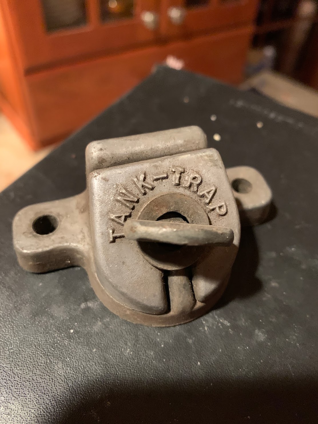

    After considering all of your excellent suggestions, I think I've come up with a toolbox mounting solution. Remember the old "Tank-Traps" that I got at a Michigan garage sale early in this thread? Well, it looks like I'm going to put them into play. I'll notch the sides of the toolbox so that they can grip it from either side. Quick, easy, sturdy and era-correct.
