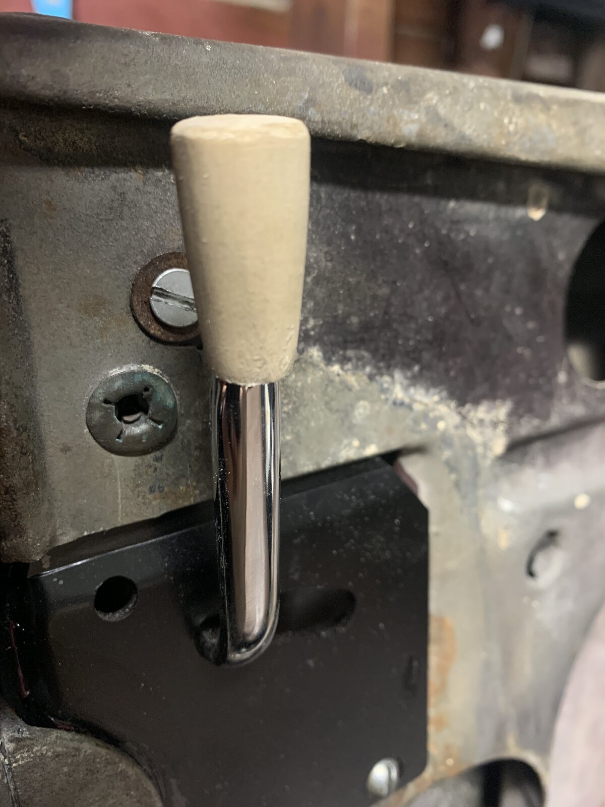

    One of those boxes was fitting, staining and sealing the wood kit. I had to whittle out one of the top pieces and then make it all fit. Boy, I'm glad that this is a roadster and not a closed car!
    Note the bronze screws keeping the wood in place. Believe it or not, these came with some vintage porcelain door knobs that I just so happened to have on hand. Yeah, I know I need to fix that rip in the seat.

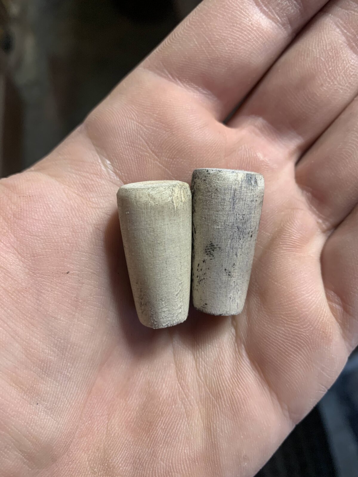

    While in the woodworking mood, I followed you guys' advice and made a pair out of a dowel rod. It's the little things!
    Oh, and how about the tack strip? I painted it semi-gloss black and outfitted it with flathead screws and stainless finish washers. Not only does this make the car look more complete, it helps with longitudinal strength big time. IMG_5833.jpg

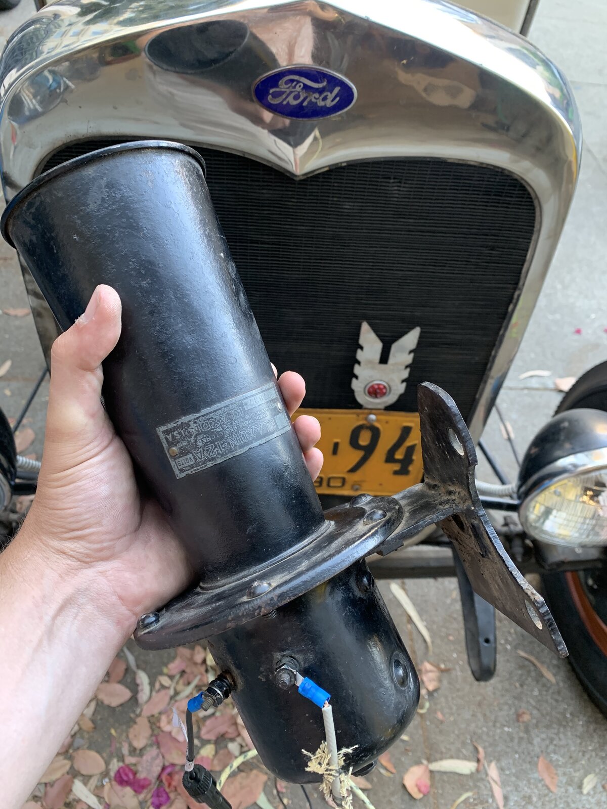

    I love antique klaxons. I have a Klaxon 8C that will be going on my coupe. It doesn't have the familiar ahooga voice, though. The best way I can describe it is an earsplitting goose honk. It's incredibly loud and really funny sounding.

    I love the Klaxon style Aoogah horns. To me it's so iconic for the period. I have one on my stock T- even if it's not correct. Had one on my doodlebug until the stater took that mounting area. And I'll have one on my roadster too....probably the one from the doodlebug.
    Are you running it on 12 or 6 Volts? Be careful if your on 12 and it's a 6v horn. It could fail in sort order. Plus the 6v horns don't IMO sound as good on 12v because the motor spins to fast.

    Thank you for the info. I was under the impression that it would work just fine on 12V as long as I didn't lay on horn.
    I was thinking about taking one from @Tribalmonkey's book and mounting it on the base of the steering column. It'll add some visual interest to the B-side of the engine while still remaining out in the open.

    Hey Joey - My current 6v horn in my coupe is running fine on 12v. It may be living on borrowed time; however, I plan to do the same with another 6v horn I have for the roadster. The horn is definitely a fun part of the car. Could also go the resistor route.

    6V horns work fine on 12V. Don't lay on it long and check the brushes in the motor from time to time. You'll be fine.
