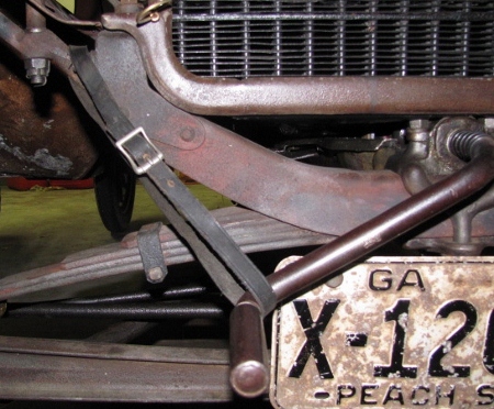

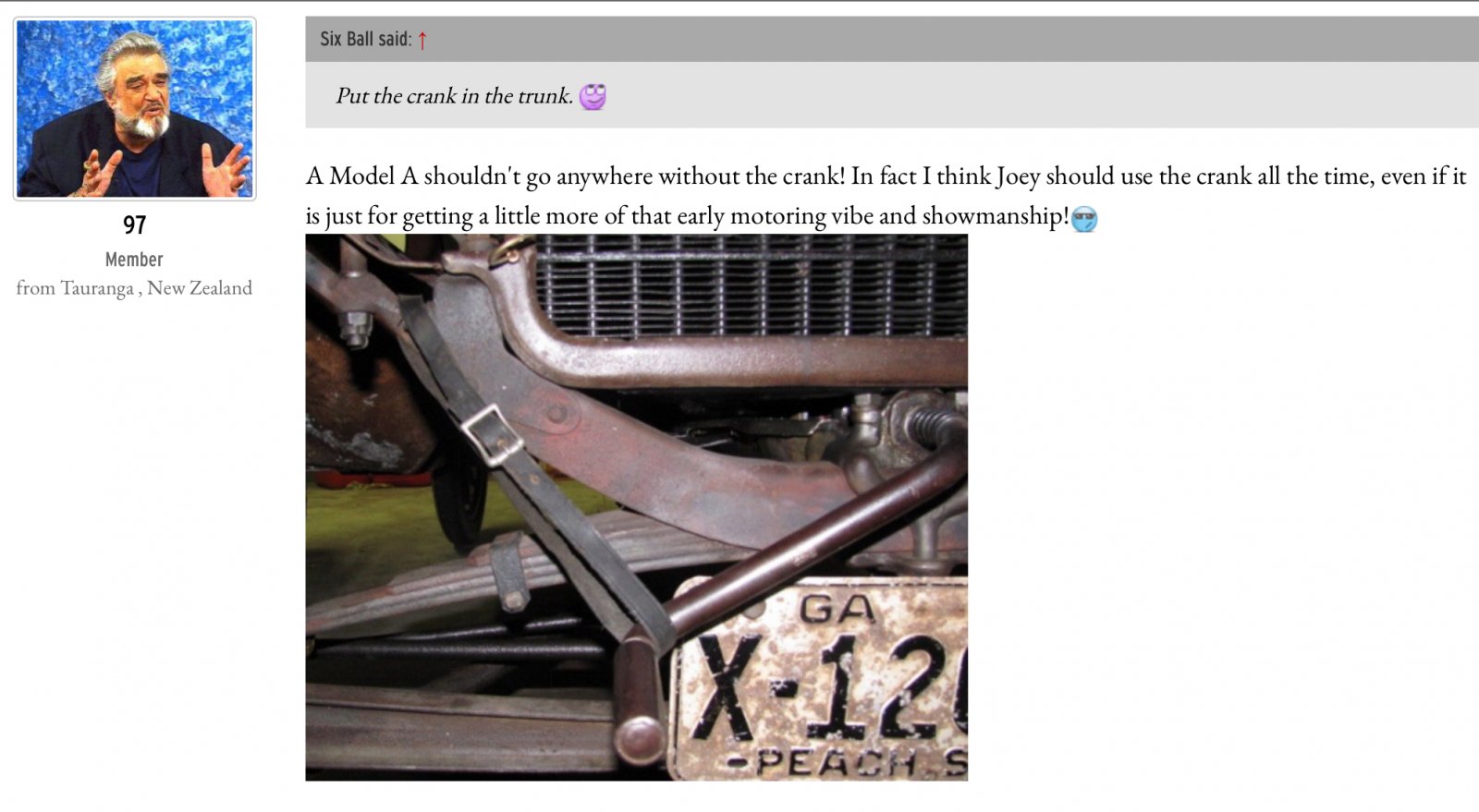

    A Model A shouldn't go anywhere without the crank! In fact I think Joey should use the crank all the time, even if it is just for getting a little more of that early motoring vibe and showmanship!:cool:

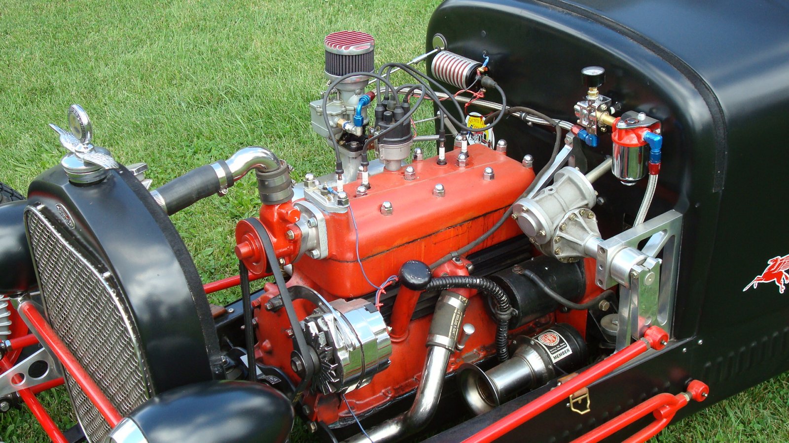

    I know you bought the expensive leakless water pump, however you could of course keep the stock size crank pulley and change the water pump for a more efficient early V8 one with an adapter as was done back in the day.

    I’m using this set up on the Zipper and I recently had to replace the modified pump I bought 15 years ago with a reproduction piece. Spent half a day modifying the adapter as the repro pump was ****py! I do recommend this set up as it was 90+ today and engine ran at 180 degrees. B7B369AB-FB08-475A-849C-CC3E52EAEF94.jpeg

    The port for temp sender on the water pump you bought tells me it is a 35 or 36 pump, the 33/34 pump is slightly different which could be the difference which forced you to modify the adapter. If you think the pump is so ****py , I would suggest you send the original one off to Skip Haney in Florida for one of his famous upgrade/rebuilds?
