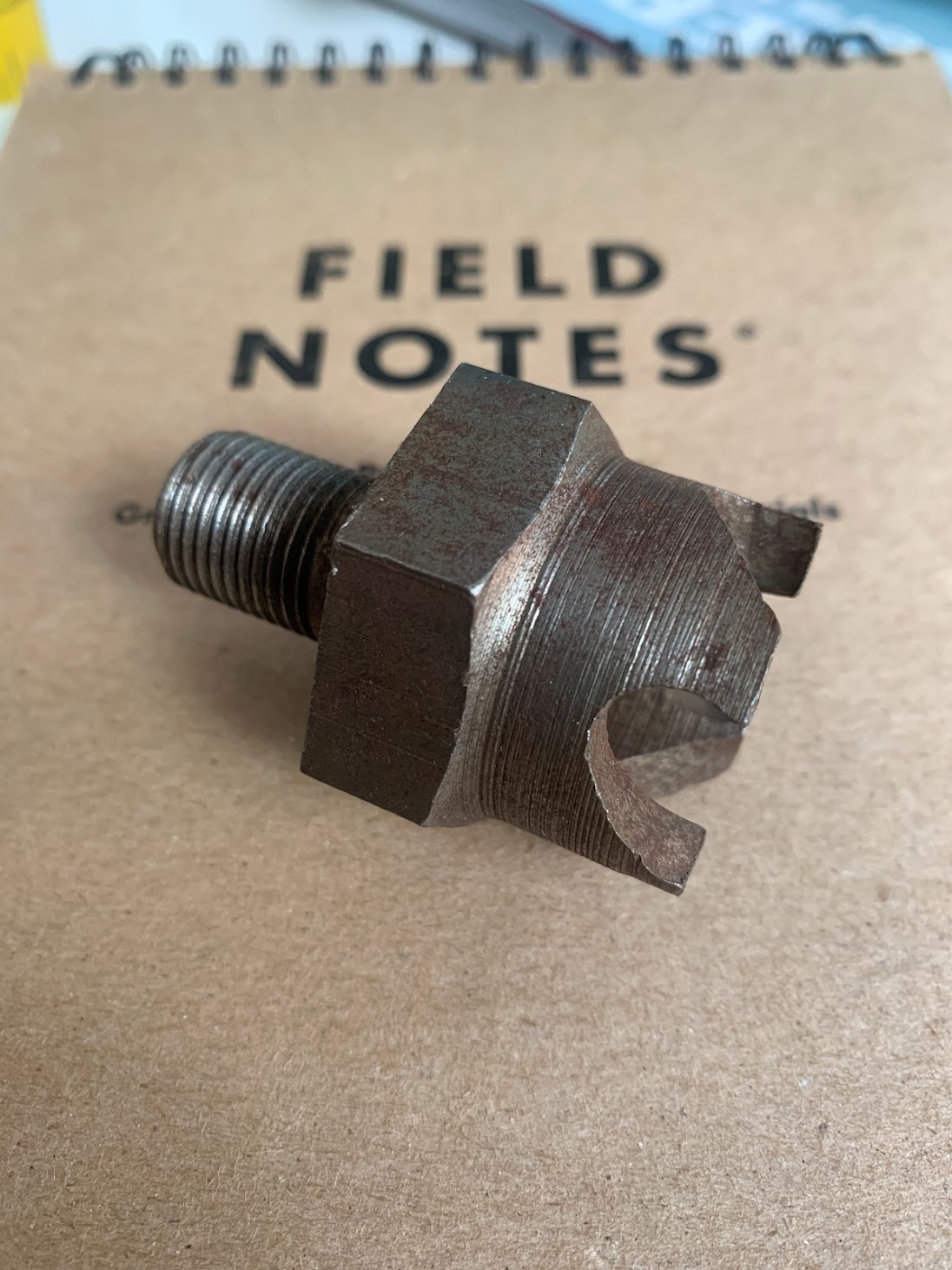

    First, I wrote a little more about my trip to Michigan on The Jalopy Journal. You can find that here. Also, I got my NOS crank nut in the mail. IMG_8226.jpg
    One thing I didn't like about the aftermarket pulley is that I had to switch to a standard bolt. Well, now that the old pulley is going back on, I figured I would replace it with one that actually has all of its teeth. The original one that came with the car was just plain tired. Now I can turn the engine over with the crank again! (I wish I could start it like that, but I read somewhere that you can't do that with electronic ignition.)

    Why go back to a stock pulley? The idea behind the smaller pulley is to slow the water pump down so you dont loose water out the overflow. I went with the smaller pulley and never have to add water or have I had charging issues. Nothing even goes in the overflow tank anymore. And I run it 65 on the highway.

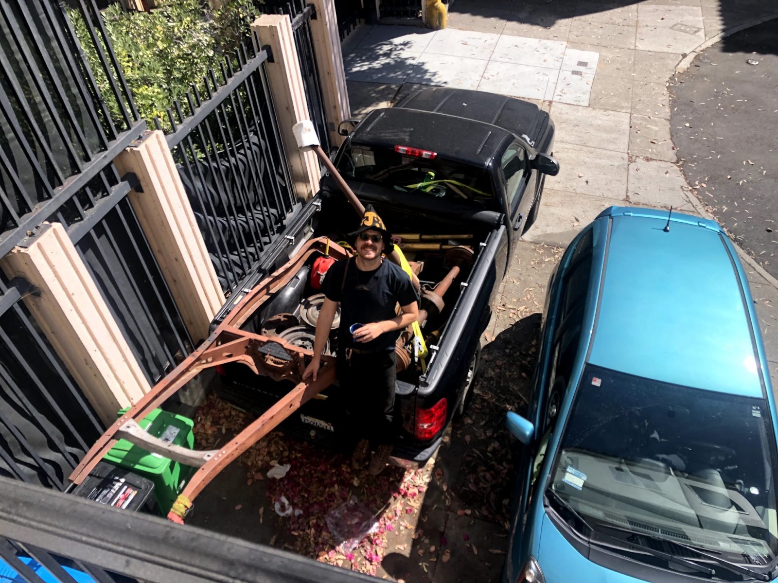

    It's getting late here, but I have just enough time for a partial update. The big news: Version 2.0 has begun! Yesterday I brought a truck bed full of parts to David di Falco (@six5monster) shop in Petaluma. The night before, I was so excited I could barely sleep. Saturday was like Christmas!
    I told my friends on the Terrace, "Next time you see this stuff, it'll be a hot rod."
    The rest of the day was one for the books. It was filled with hot rods, customs, Hillbilly Crash Helmets and all sorts of crazy vintage mechanical madness. Tons of laughs and general silliness. We're kicking off a new chapter and I couldn't be more excited. IMG_8280.jpg
    I’ll upload the rest of the story tomorrow.
