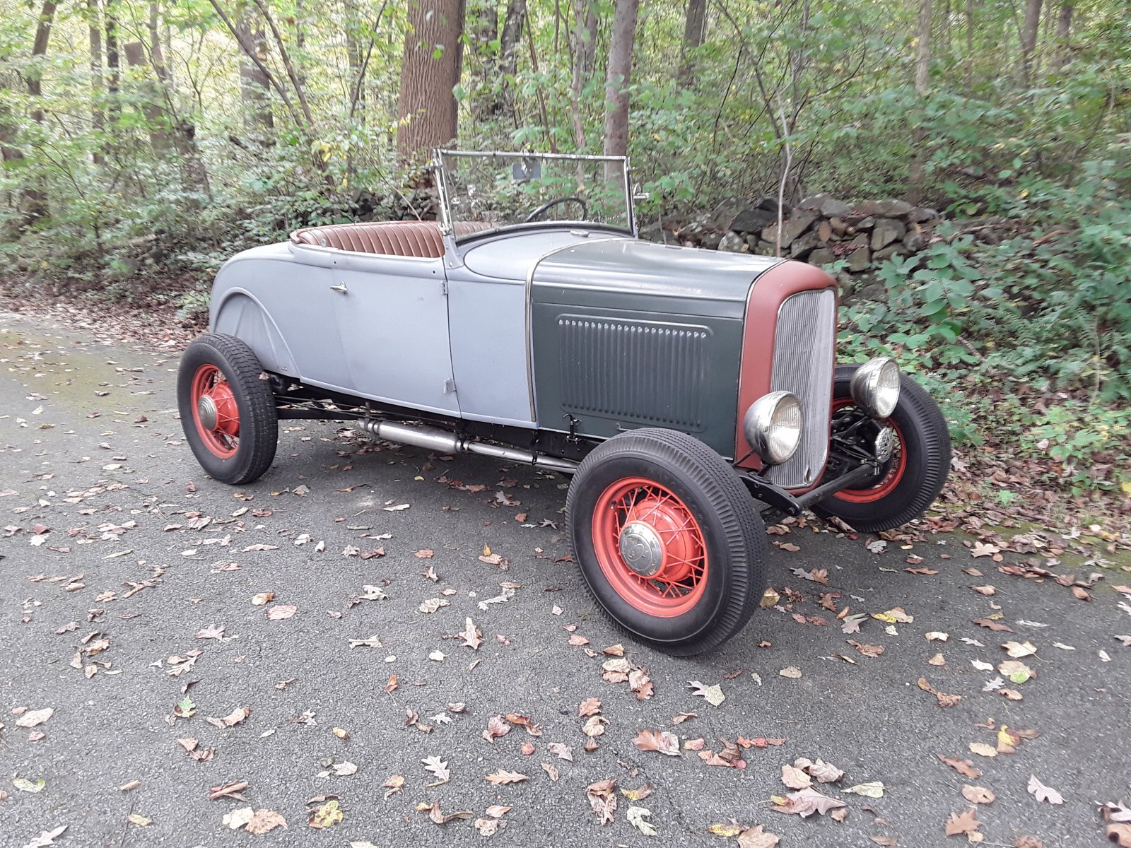

    To answer 97's question I am running a 6 volt three brush generator. At idle amp gauge reads 0, at 2500 rpm amp gauge shows 6-7 amps. Battery always shows full charge. I'm very stuck on the prewar theme. I did upgrade to turn signals but even those are 1942 guides. Running a B block, Riley cast iron 4 port with Winfield carbs. Brakes are 32 front, Model A rear, still mechanical. Running at 60 mph I would lose a quart of fluid on a 50 mile run. Switching to the smaller pulley stopped that and now I very seldom have to add fluid. That was why I questioned Joey's decision. I feel a lot of people over think this stuff. 20181007_115611.jpg 20200115_140058.jpg

    That is the answer I hoped (expected) to see! Yours has a different combination of systems and parts and you use the car differently. I suspect Joey very rarely runs his engine to 2500 rpm, mostly driving in the city, he has an alternator (disguised as a generator) and is running 12 volts. You have the ability to turn the charge rate up and down with the third brush, and I think the aftermarket crank pulley is useful for driving at higher speeds, made practical by your OHV B .
    I agree about the overthinking , like anything you modify, there a pros and cons , it's the combination that counts, to suit the owner/driver.
    I personally do not find it necessary or even desirable to convert to 12 volts or an alternator with a banger in a simple car. Henry really had a well thought out combination for the driving conditions of the era. I guess if I were to add audio, heater/fan, spotlights, and other modern power consuming "necessities" in a Tudor or similar , I may need a rethink .

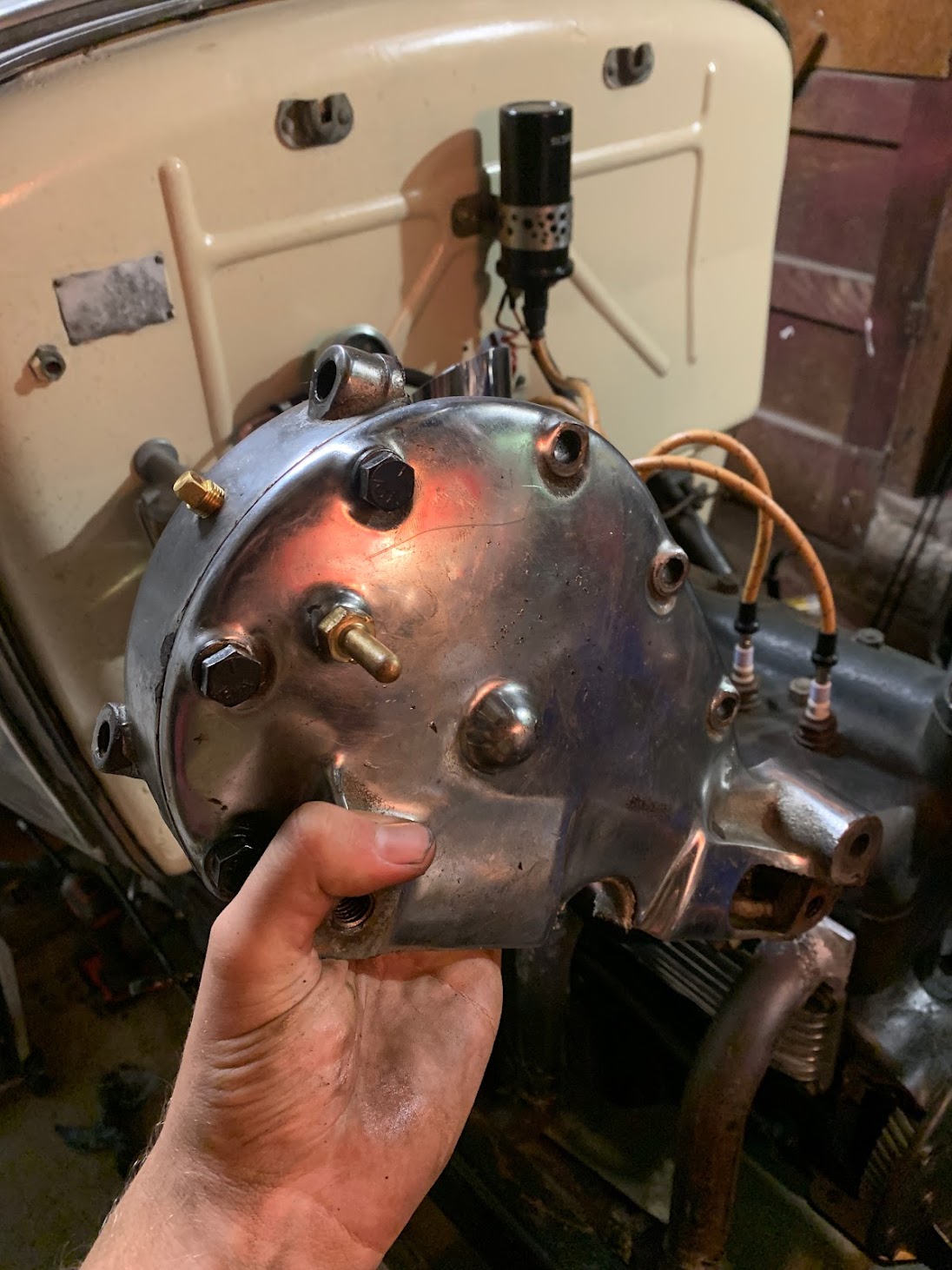

    As part of my pulley swap, I also installed the old chrome front timing cover from @Hitchhiker. I'll be honest—it was a little tricky to install. Why? The cover hasn't been on a car in decades, and the chrome makes all the bolts fit a little snugger. Nonetheless, I was able to get it in place and I couldn't be happier. Note the golden timing pin.

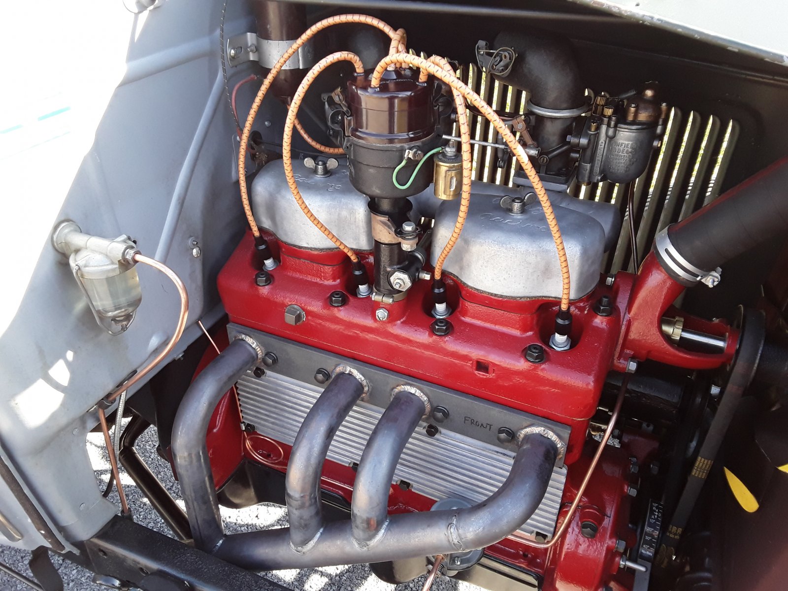

    I present you with Version 1.5 of my Model A roadster's engine compartment. I couldn't be more excited about the new old chrome addition. IMG_8580.jpg
    Another angle, just because.

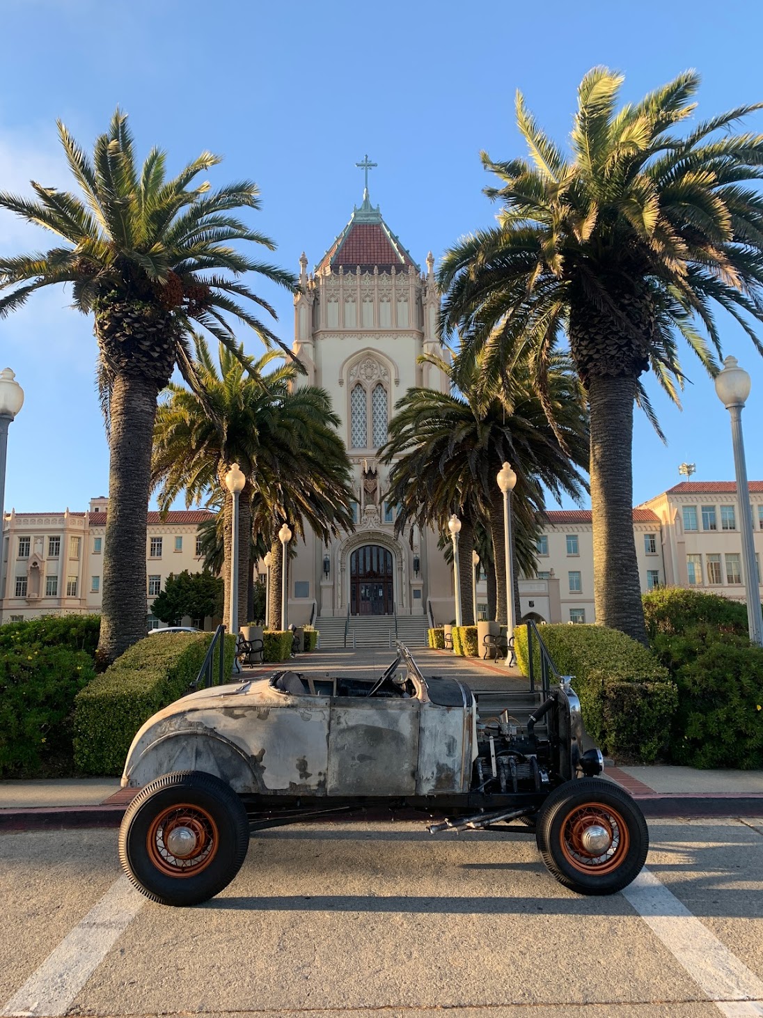

    The weather has been incredible here in town so, naturally, I've been driving the roadster as much as I can. The other night, I finally drove it up to University of San Francisco's Lone Mountain Campus.
    IMG_8583.jpg This building reminds me of something you would see in the background of an old Rod & Custom feature.
    The car is running great, by the way! The stock lower crank pulley improves the car's charging ability.
    That's all for tonight. More happenings headed your way tomorrow.

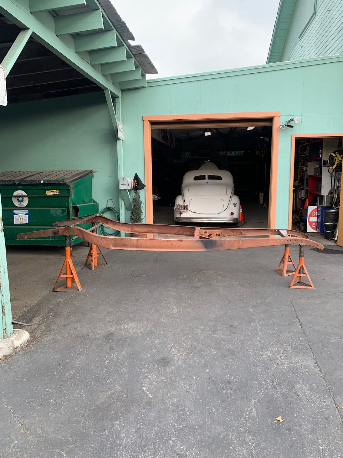

    Week #2: Cleaning Up the Frame
    When Saturday morning rolled around, I couldn't wait to head up to Petaluma. Unlike last time, my truck bed was basically empty other than pedals from '35 and '39 Fords. After a foggy, relaxing ride, I pulled into my usual parking space. A knock on the door later and I was in the shop, surrounded by hot rod treasure from here and there. It felt good to be back.

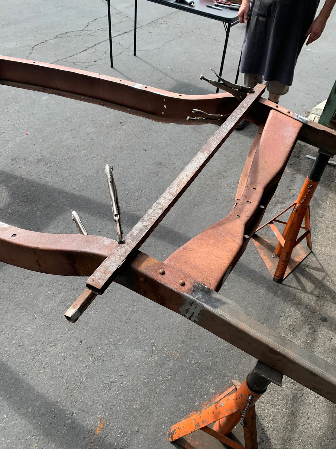

    David suggested that we bring the frame out in the driveway and set it on the biggest jackstands possible. Why? "To help save your back when you're working on it," he said with a smile. I dragged out his largest ones that he refers to as "Harbor Fright" specials. They were perfect for our application.
    First and foremost, I removed the original pedal mount. Judging by the rust on the rest of the frame, I figured there would be a lot of Kroil-soaking and power tool usage. Much to my surprise, every nut and bolt came out with ease using an impact wrench and a 1/2-inch box wrench. As you can imagine, I let out a big "Ahhh haaa!" when the first one broke free. We plan to clean up the hardware and use it elsewhere on the build.
    Next, I grabbed the angle grinder and began eliminating some of the sharp spots on the frame. The previous owner had straightened it on his jig, and there were still some remnants from where he cut off the bracing. I also cleaned up the torch cuts on the K-member. I was glad that I could use the grinding skillz I learned during the build-a-Triumph-in-a-ba*****t days at Mazi Moto!
    Next, we grabbed some square tubing from the back and tacked it to the frame. This will help keep it square until we install the Model A rear crossmember to clear the quickchange. It had been awhile since I MIG welded (or did any sort of welding, really) so I did okay on some of my tacks and managed to blow a hole through the tubing (not the frame!) on the last one I tried. David had no problem getting everything back to a presentable state.
    Getting things in position.

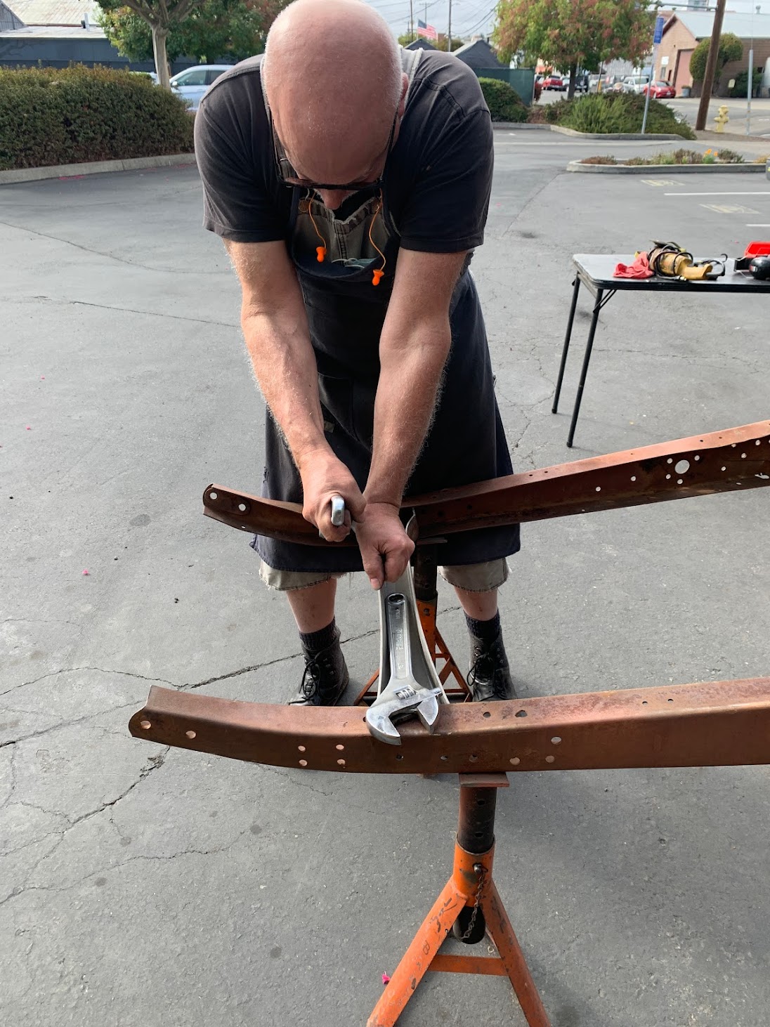

    Once the pieces were in place, David noted that the front right frame horn was bent. He then taught me the proper technique on how to straighten them. "Just think about the chain of events that made them bend," he said, "and then work in reverse." I had a feeling it was going to involve some very big wrenches.

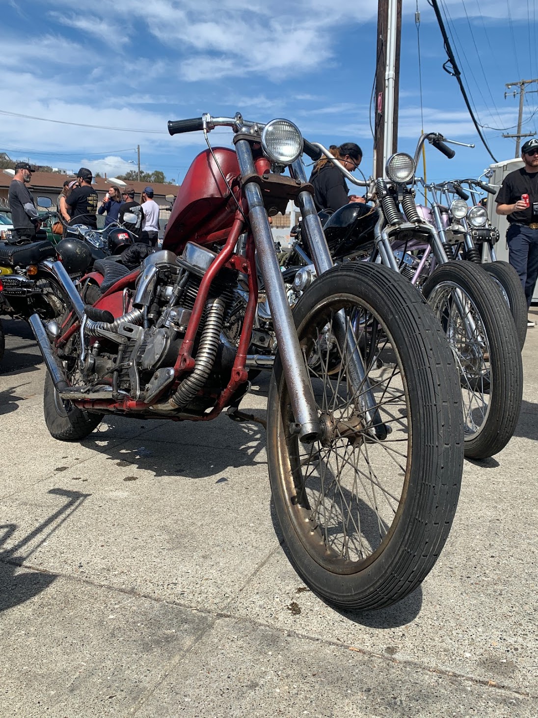

    Sunday was spent doing field research at San Francisco's "Still Here" chopper show. Yama debuted his crazy Panhead survivor and I took lots of notes on things I liked. IMG_8548.jpg
    Yep, we're still here!
    My friend Stephen's perfect Pan.
    If you stay tuned to this thread, you'll be seeing more of this treatment in the not-so-distant future.
    Yama and his Pan, now equipped with an early I-beam springer. Very proud friend moment for sure. IMG_8564.jpg
