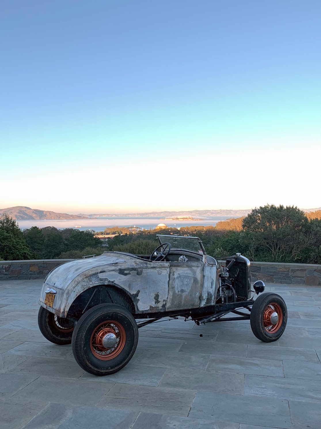

    Yesterday was the first day in a long time that I was able to work on the car all afternoon. So what did I do? I addressed some big and little things.
    While I was in Portland, my Holley fuel pump died on me. This had happened twice before, but I wasn't able to figure out why. Well, when I pulled the pump, I tapped a whole lot of sediment out of the metal filter. I found this surprising, considering there's a screen filter in the tank. Now that I think about it, my car's fuel is triple filtered. 1) Tank screen 2) Pre-fuel pump filter 3) gl*** filter bowl in the firewall. Nonetheless, Yama and I replaced the fuel pump with a fresh one on the side of MLK Boulevard in Portland. The whole process took about 15 minutes.
    When we returned to SF, I wasn't happy with how the car was idling. For whatever reason, it was just too high. I played with the timing and the mixture, both of which only made it worse. I was pretty perplexed. Then, while it was running, I checked the fuel pressure gauge. At one point it was close to four pounds of pressure. Reviewing my Stromberg's instructions, it said 2.5 max. The new pump was identical to the old, but it was pushing out double the fuel pressure. My guess is that, with unrestricted flow, it's able to crank out max psi. But...that's too much.
    So, what did I do? I bought one of Holley's 1.5-2.5 psi pumps and hooked it up. I then re-timed the engine. After a whole lot of driving yesterday, I can say that it definitely helped. We're back to regular idle, and the car runs well.
    Just in the nick of time, too. I really wanted to drive it to the Balboa Theatre to see "The French Dispatch," which is a movie by my favorite director, Wes Anderson. It's a story about magazine journalism, so naturally you guys know how much I enjoyed it.
    Rolling up to the theatre, I was worried about finding a spot. With the car idling out on the main drag, people poked their heads out of the neighboring bar to see what the fuss was all about. As I waited, I saw a couple approach their car, which was positioned right in front of the marquee.
    "What is that?" the woman asked.
    "A 1930 Model A," I said with a hint of pride.
    "Model A?" she said. "My dad learned to drive on a Model A. He always talked about it, but I've never seen one in person until right now. Is it all original?"
    "It is," I replied. "Sorta!"
    She and her husband pulled out of their spot, allowing me to take the best spot in the house. IMG_9819.jpg

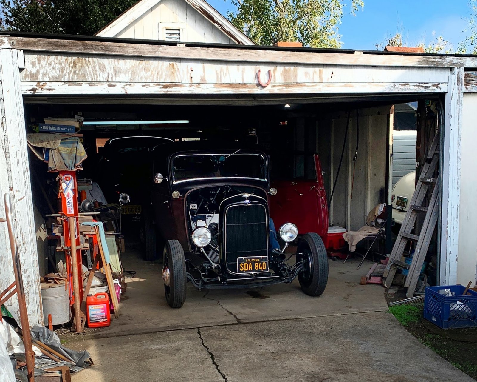

    As promised, we're back with the weekend recap.
    Saturday morning, I made my way north to Petaluma to meet up with fellow H.A.M.B.er @bushwacker 57. Although it was sunny in San Francisco, I ran into some heavy fog as I rolled into Sonoma County—usually things go the opposite way. The air was crisp when I stepped out of my truck, and it wasn't long before I was in Mike's driveway. Boy, was in for a surprise.
    There, front and center, was his freshly finished 1932 three-window. After decades of collecting parts, he put the pieces together to make a first-cl*** hot rod. I was blown away by the hot flathead and incredible detailing throughout. IMG_9950.jpg
    Flathead goals.
    This is the engine in Mike's survivor '32 roadster—one of my favorite hot rods of all time. With any luck, you'll be seeing more of this one in the not-so-distant future.
    For the rest of the morning, I got to hang out with Mike and hear some amazing stories about everything from racing G***ers to tearing around San Francisco on a brand new Harley Servi-Car. I can't wait to go back to his place soon.
