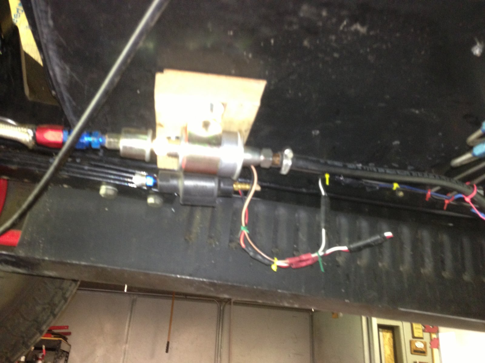

    This next update is one to serve as a reminder (mostly to myself) that things don’t always go as planned with these old cars. And, in the spirit of the build, there’s a little bit of a story—and a lesson to be learned.
    With a big day of roadster work planned for Saturday, I decided to take it easy Friday night. Other than running errands, my only plan was to drive my car to Tommy’s Joynt. I checked the weather; it was 48 degrees and clear. I rolled the car out of the garage and into the driveway. I hopped in, fired it up and let it idle for a little longer than usual to warm it up. I then parked it on my neighbor’s super steep driveway while I returned my truck to position in front of the garage.
    When I went to go start the roadster again, it had trouble firing. I’ve only driven it one other time since returning from Thanksgiving, and that was a short trip to run errands. While leaving the store the last time, I encountered the same issue but I figured it was an isolated incident.
    I should have checked the battery voltage before leaving, but instead I fired it up and set off into the night with the lights on. The car ran excellent, but as I approached my destination in the Tenderloin, the fuel pump was really loud. When I parallel parked the car on a steep stretch of Geary, I let it sit for a second. Then I tried starting it. It turned over but wouldn’t fire. I continued to run the fuel pump as I tried a number of times. After all this, the battery read 12.1. Damn.
    So, there I sat on the side of the street with Friday night traffic whipping by. I opened the hood and turned on the pump to check the fuel pressure. It read zero. I then pulled off the fuel line at the carb and ran it. There was no fuel flow at all. The pump was hot. Battery: 11.9V.
    I used what was left in my jump box to bring it back, but it wouldn’t stay running. The fuel pressure remained at zero. I pulled the floor and grabbed my backup pump.
  16. J.Ukrop
    Joined: Nov 10, 2008
    Posts: 3,628
    J.Ukrop
    SUPER MODERATOR
    With the new pump in place, the engine roared to life just like it has in the past. I wasted little time collecting my tools, throwing the car into gear and gunning towards home. I made it back without any issues. When I rolled into my garage, I had mixed feelings. Part of me felt down that my car, which has been doing so well for so long, is having issues. On the flip side, I was happy with the way I handed the situation. The fact that I was able to troubleshoot and revive the roadster on the side of a major city street and successfully drive it home makes me proud of how far I've come.
    Now that I've had a few days to think about what happened out there, I have a few hypotheses.
    1) Parking the car on two steep hills during startup made the pump run dry, hence the loud noise and subsequent overheating. By continually cranking the car without any fuel flow, it ran down the battery. Swapping in the replacement pump seemed to remedy the issue.
    2) Maybe there is a parasitic draw on the electrical system after all. I charged the battery to 13 volts, and I'll check on it after the holidays to see how it holds up.
    Not the best update, but I figured it was worth sharing. Just like every issue we've come across in the past, we're going to get to the bottom of all of this. The most important thing is that I keep this old hot rod on the road!

    You had mentioned low charging before, with talk of pulleys, RPM and such in comments. I don't recall you changing the pulleys, checking output with load (lights) or any other diagnosis or repair.
    1. Fix charging system to provide output at idle with a load.
    2. Electric motors HATE low voltage. While parking on a hill might starve the pump and make it run hot, No. 1 will also cause this. You don't mention where the fuel level was, and the pump is located under the floor at least a foot under the tank, so even SF street angles should not cause the inlet side to be exposed to air. It ran back to the house, so there was some fuel left. So IMHO back to No. 1.
    3. Check for parasitic draw and voltage drops. You don't have any of the typical modern accessories that will draw with the key off. Any draw in the car should be found and fixed. Check battery condition too. A tired battery will not hold a charge well.

    I have to ask. Why are you running a fuel pump? The float bowl on your carb is even with the top of your sediment bowl. You should never starve that carb for gas unless your tank is empty. I have a 31 roadster and run two Winfield CC carbs on gravity with the float bowls a bit higher than yours with never a fuel starvation issue. I know your in hill country but we have some nasty hills in Pa. My thoughts are keep it simple and ditch that pump.

    Not quite the same set up as yours, but I can switch fuel pumps in less than two minutes. Mine are mounted side by with quick connect wiring. I’ve had to switch twice with this set up.

    A fair question. My part of town is called Lone Mountain. It's hilly. While running the updraft, I faced fuel starvation issues with a nearly full tank basically everywhere I went. Other than this most recent scenario, I have been happy with the way the system is set up. That being said, this is still a relatively fresh car. Things can always change.

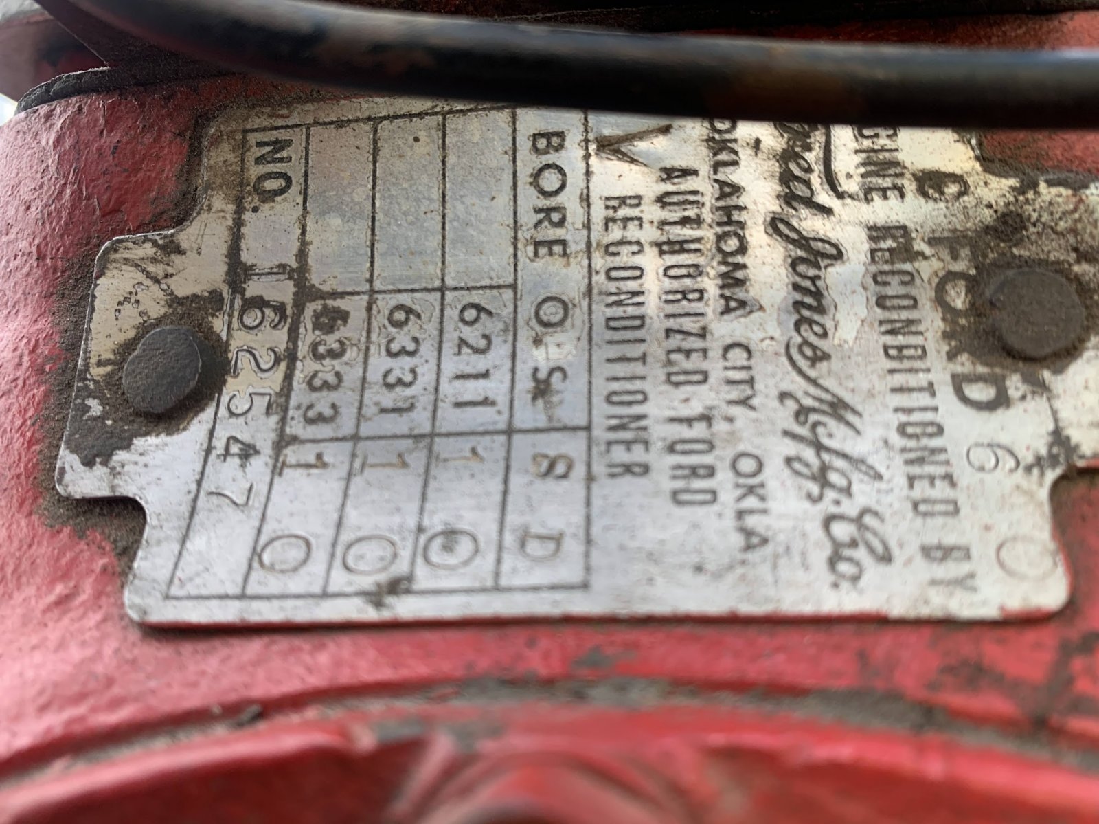

    This gave me a good look at the rebuild tag. As far as I can tell, it was rebuilt in 9/1960 with a standard bore and .010 over...bearings?

    Joey, with an updraft vacuum pulls the gas uphill so to speak into the motor. With a full tank if you had fuel starvation there was a problem with your carb. On a downdraft fuel almost flows directly into the motor when the source is higher than the carb. Stand at the side of your car and look at it and think about how gravity works. Save your money for speed parts not pumps.
