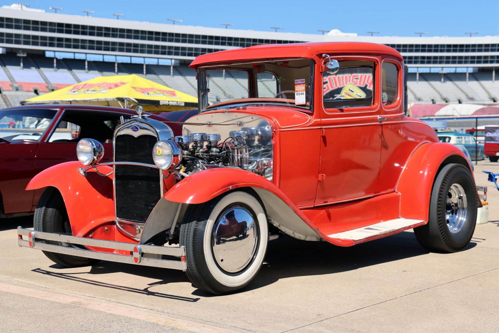

    Overall, I had a great time in Texas. I got to see a bunch of H.A.M.B. cars, including my favorite Model A coupe of all time.
    Fun fact: I actually tried to buy this car long before I started mine. It didn't work out, but that's okay. IMG_2559.jpg
    That being said, there are a few things on my roadster that are/will be inspired by this very special Model A.

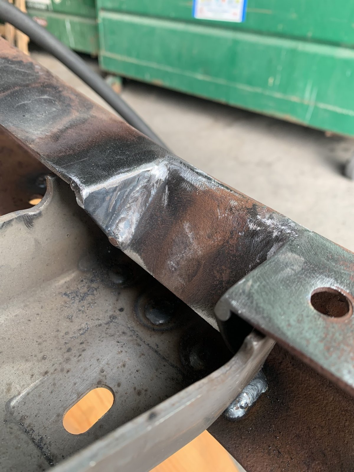

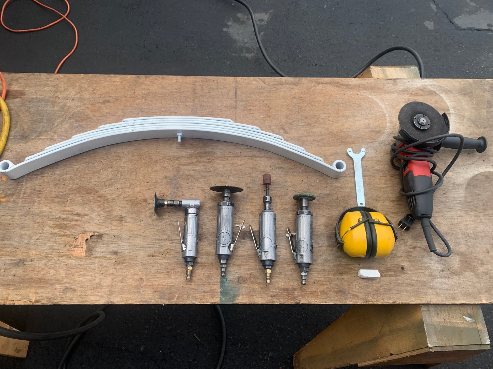

    On Saturday morning, I arrived in Petaluma ready to work. Despite gray skies, David and I brought my frame out in the driveway, set up my workspace and got moving.
    The task? Notch and partially box the front of the frame to clear the reverse-eye spring.
    Step 1: measure and mark with chalk
    Step 2: make a cardboard template out of 10-gauge
    Step 3: cut them out with David's garage-sale bandsaw
    Step 4: David welded them in place
    Step 5: I then ground down the welds
    And there you have it! It was super fun diving in and working on the ch***is. Next up, we'll be filling a few more holes and figuring out the rear crossmember location.

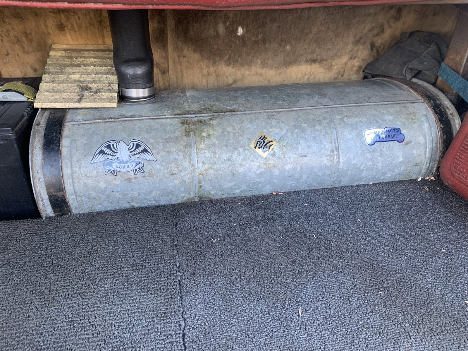

    Miscellaneous shots from around the shop:
    Speed, power and a Hillbilly Hat.
    My Mazi Moto/J.Ukrop sticker made its way onto the gas tank of David's roadster. A real honor!
