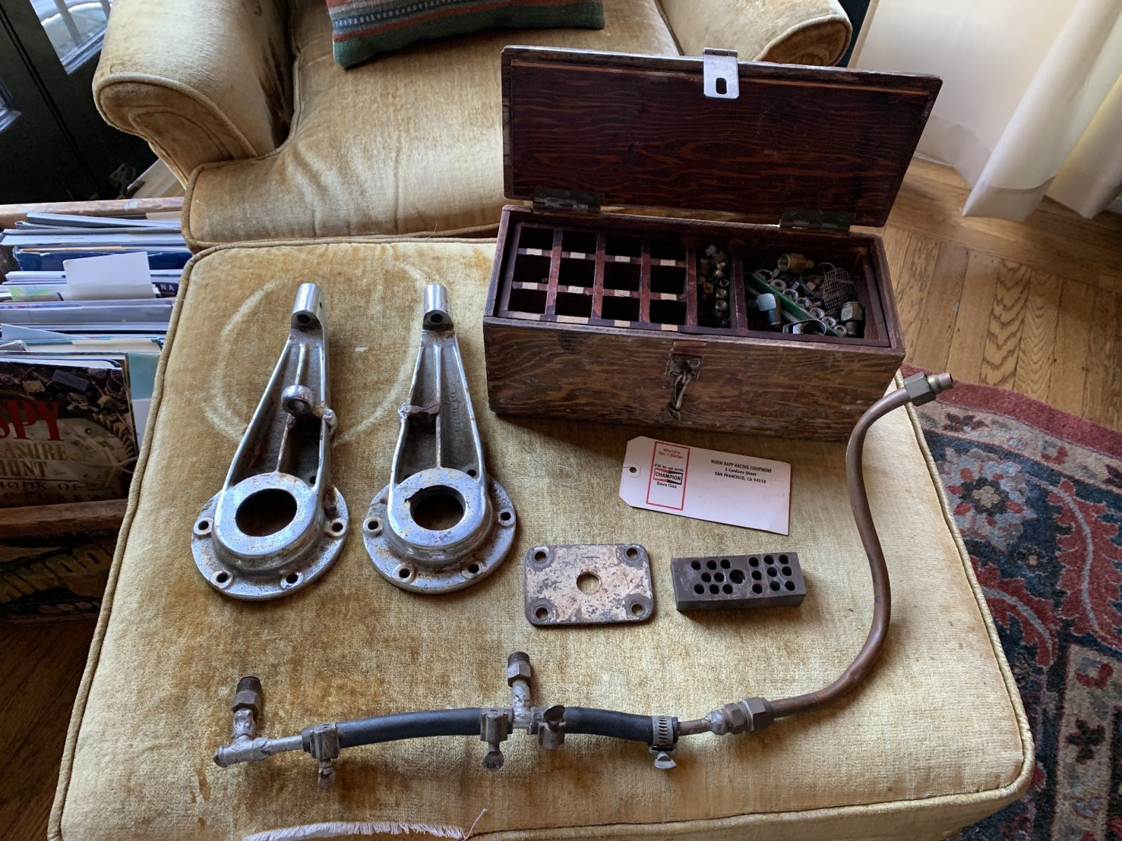

    what are the other pieces of your score from the sale? I can’t quite place them but they look neat!

    So, that's the big question. I believe they're Midget rear suspension components from the 1950s. Interestingly enough, they're cast steel that's been chromed. If you look closely, there's a name cast in there. I'll take a detail photo tomorrow. My first thought when I saw them? Headlight stands. I'm pretty sure I'm not going to run them, but they could be fun to mock up!

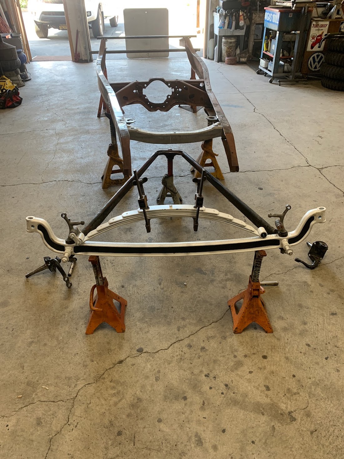

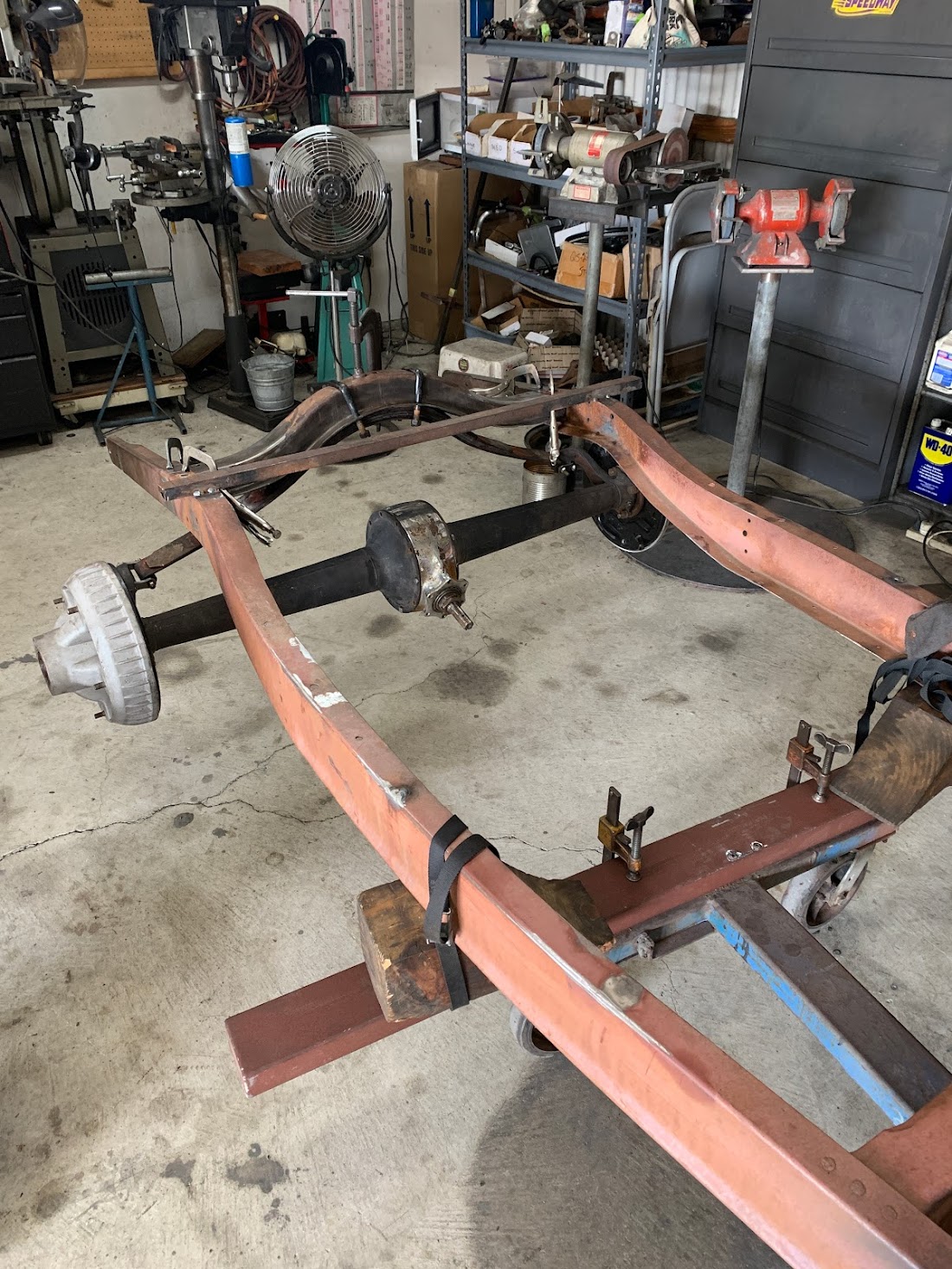

    Ever since day one, this project has been about learning. In the past two weeks, David has helped me demystify so much of the hot rod building process.

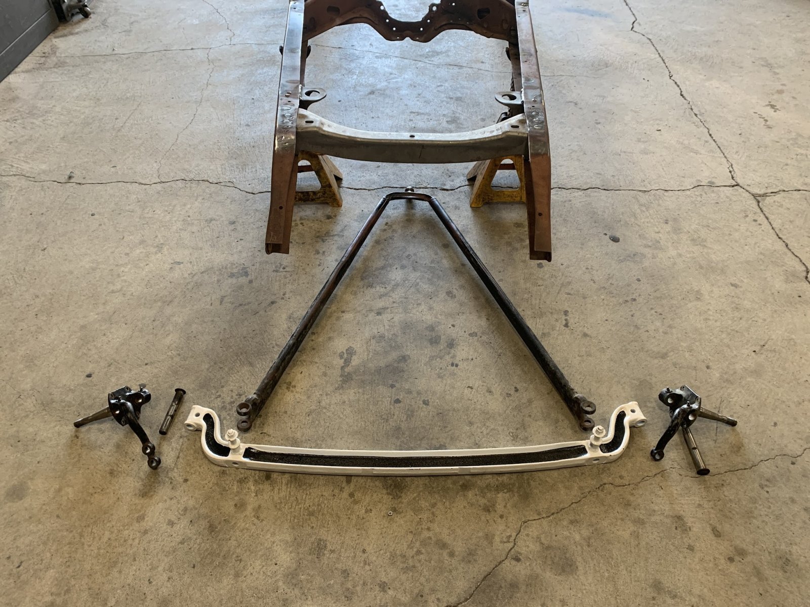

    It all started with the bare frame on the floor.
    Then we laid everything in place.
    And then we pushed out the old bushings on this spring perch using a modified KR Wilson tool. IMG_2960.jpg
    Out with the old.
    After I sandblasted the perches, David gifted me a set of bronze bushings machined by his friend Jerry. They're perfect. He then showed me the correct way to dis***emble a spring using clamps and all-thread.
    This is exciting stuff!
    I blasted the old U-bolts and related hardware.
    And then we ate lunch.
  14. J.Ukrop
    Joined: Nov 10, 2008
    Posts: 3,614
    J.Ukrop
    SUPER MODERATOR
    Since the original crank clamp won't work with the Deuce radiator and grille shell, David welded a block to the bottom to make up the difference. IMG_2978.jpg
    We were both dead-set on using original U-bolts, which took a little bit of convincing to work with the So-Cal front crossmember. But it's all together now, and I'm really happy with how it looks.
    Last Saturday, we were confident that we could get the front end together. Unfortunately, I discovered that my '35-'36 Ford spindles will not work with the four-inch dropped '32 axle and the '37-'41 kingpins. Luckily @Hitchhiker is the man and set me up with a set of round-back spindles that will be getting here later this week. It's hard to say for sure, but I think they came from the same old hot rod as my perch pins. We'll see.
  15. J.Ukrop
    Posts: 3,614
    J.Ukrop
    SUPER MODERATOR
    Right before I left the shop, David showed me how to remove rivets with a torch. He perfected this technique while working at Vern Tardel's infamous Prune Orchard, and it's incredible to see how easily he can make the metal do exactly what he wants. "Cutting, bending, cleaning—the torch can do it all," David told me as 90-year-old rivets popped from the Model A crossmember.
    IMG_2974.jpg That afternoon, he gave me a homework ***ignment: have the crossmember trimmed to the exact width (39 9/16ths) and cleaned up by the time I came back. IMG_3091.jpg
    So I did exactly that. I'm sure the neighbors enjoyed it.
  16. J.Ukrop
    Posts: 3,614
    J.Ukrop
    SUPER MODERATOR

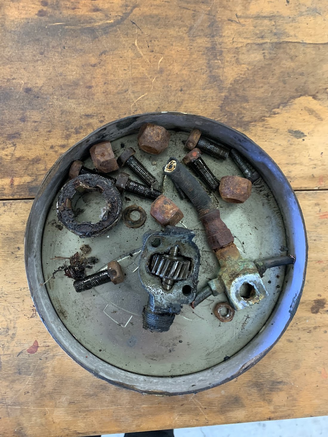

    Last Saturday, we jumped right in. We started by setting the narrowed crossmember into the frame and removing bushings. Next, David taught me how to correctly remove a torque tube from an early Ford banjo.
    It was fun to finally tear into this thing. I was surprised that nothing was seized or even stripped. We'll be shortening the torque tube once we get the quickchange in place. IMG_3099.jpg

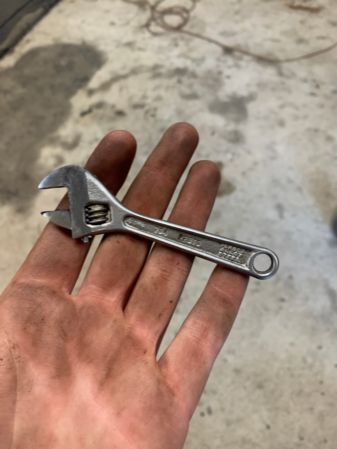

    Some of the work even required a very small wrench.
    Salvageable hardware.

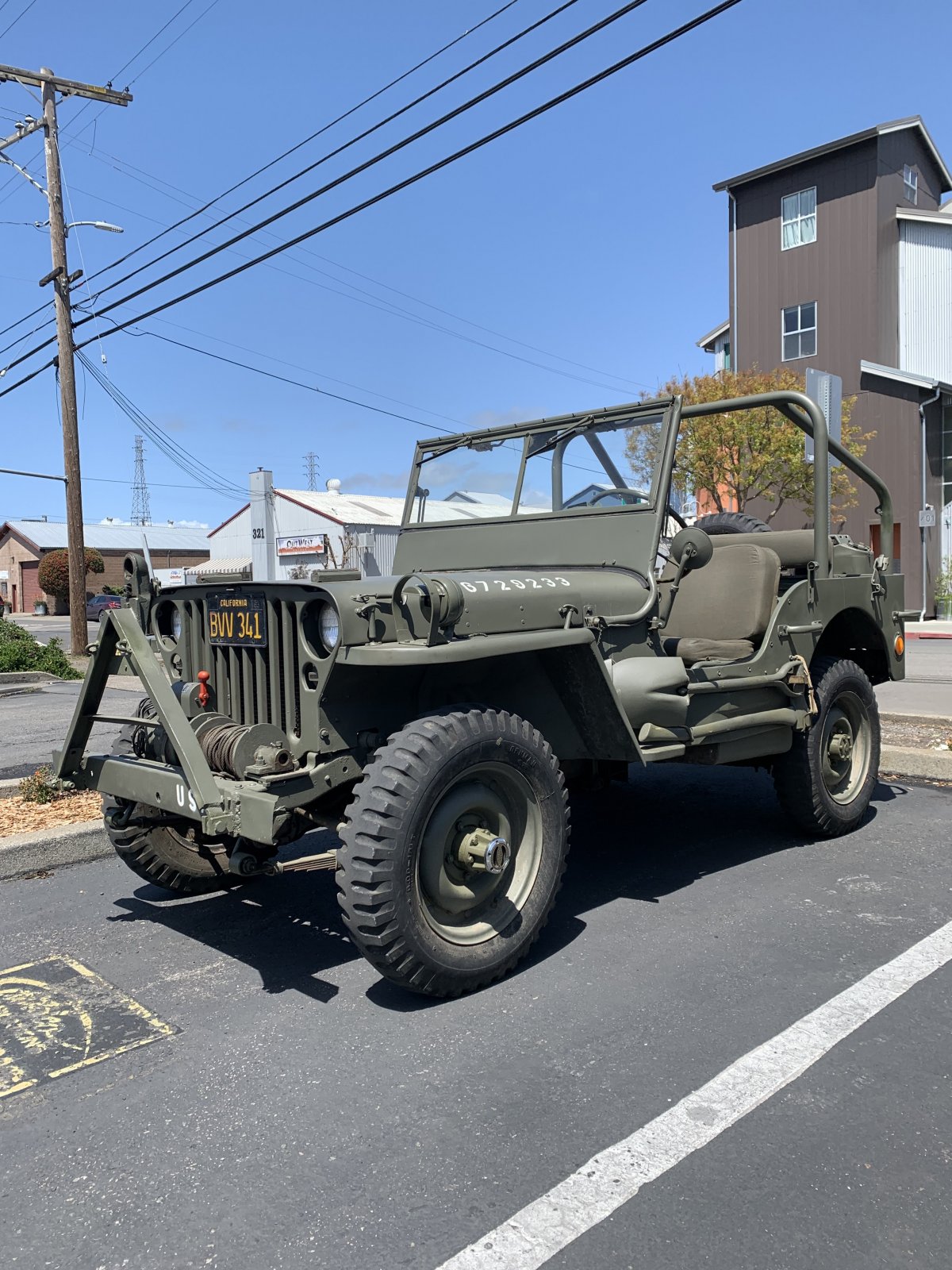

    On Saturday afternoon, gray Petaluma skies transformed into a clear blue day. We took a customer's 1945 Ford GPW for a test drive during lunch. David had just revived it from a long slumber, and it ran perfectly on our trip to town. I had never been in this early of a Jeep (type vehicle), but I had a blast riding shotgun. With its flathead four, three-speed transmission and solid axles, it's amazing how similar it feels to my roadster.

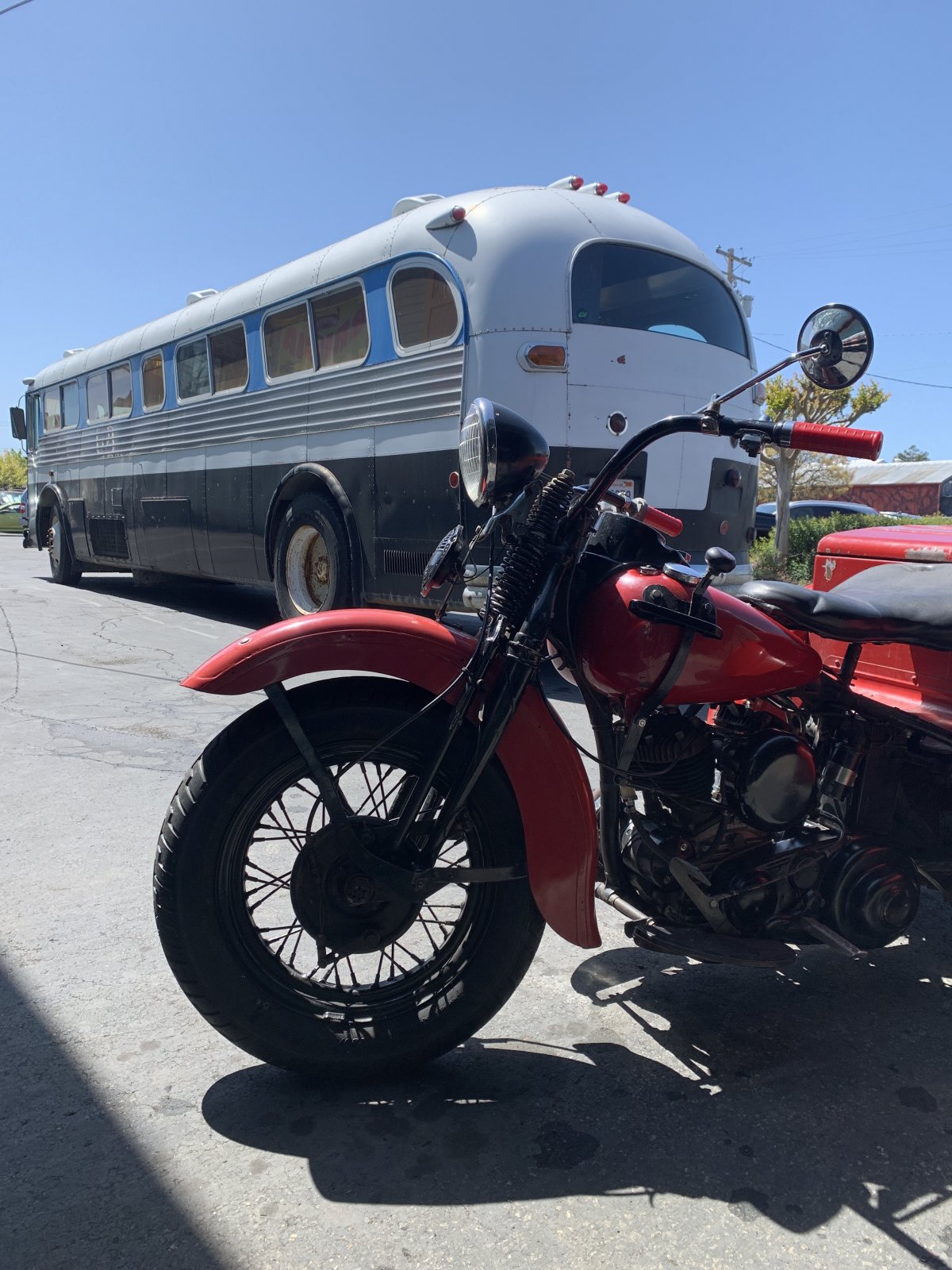

    Other visitors included our pal Sonny and his HD Servi-Car and one of David's customers in their 1967 Crown bus.
    The bus is an absolute behemoth, and the inside is a total time-warp with its streamlined features throughout.

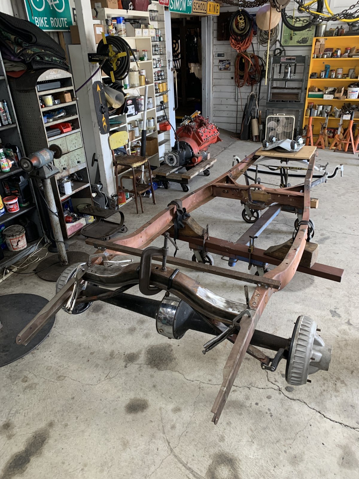

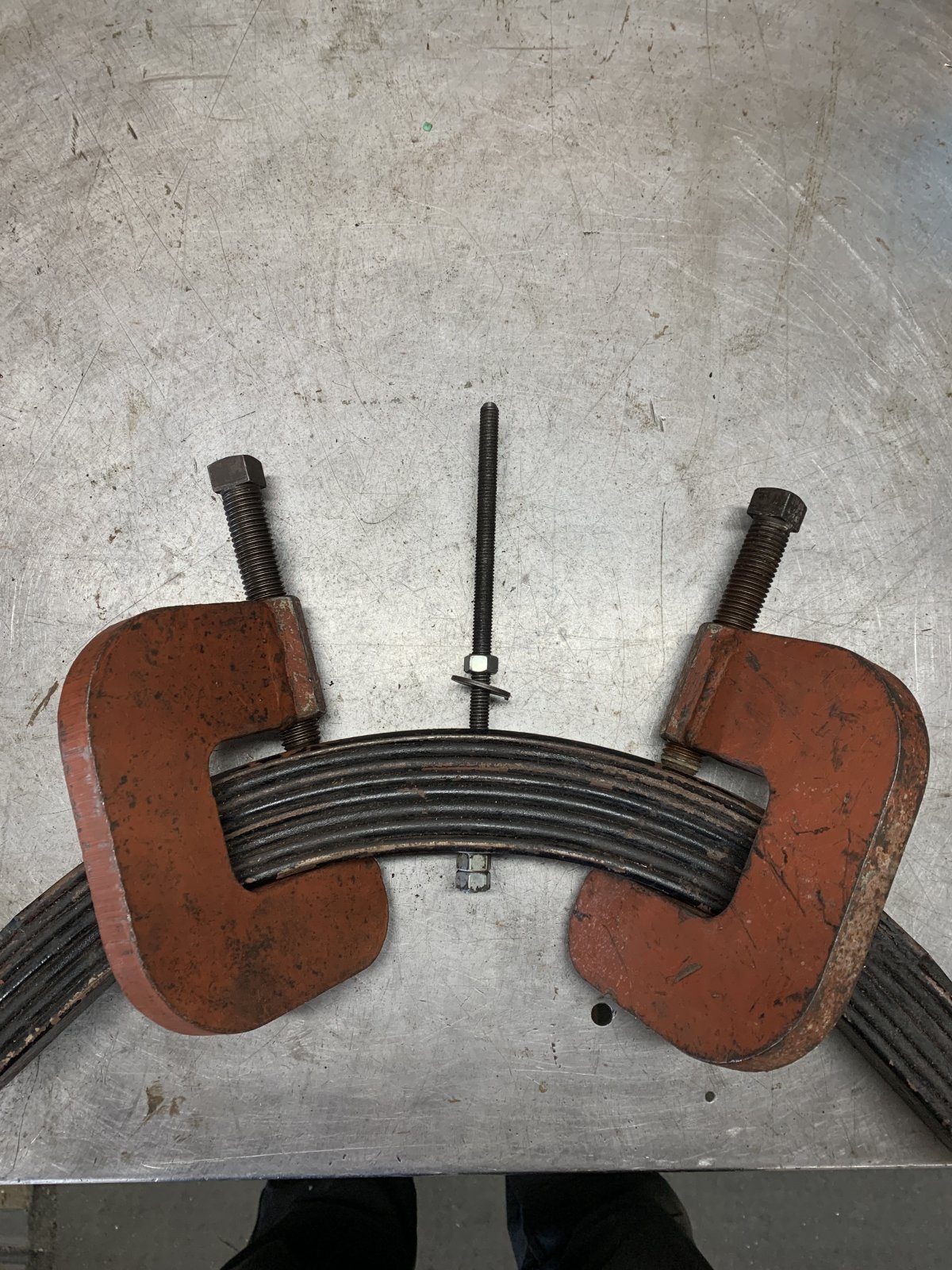

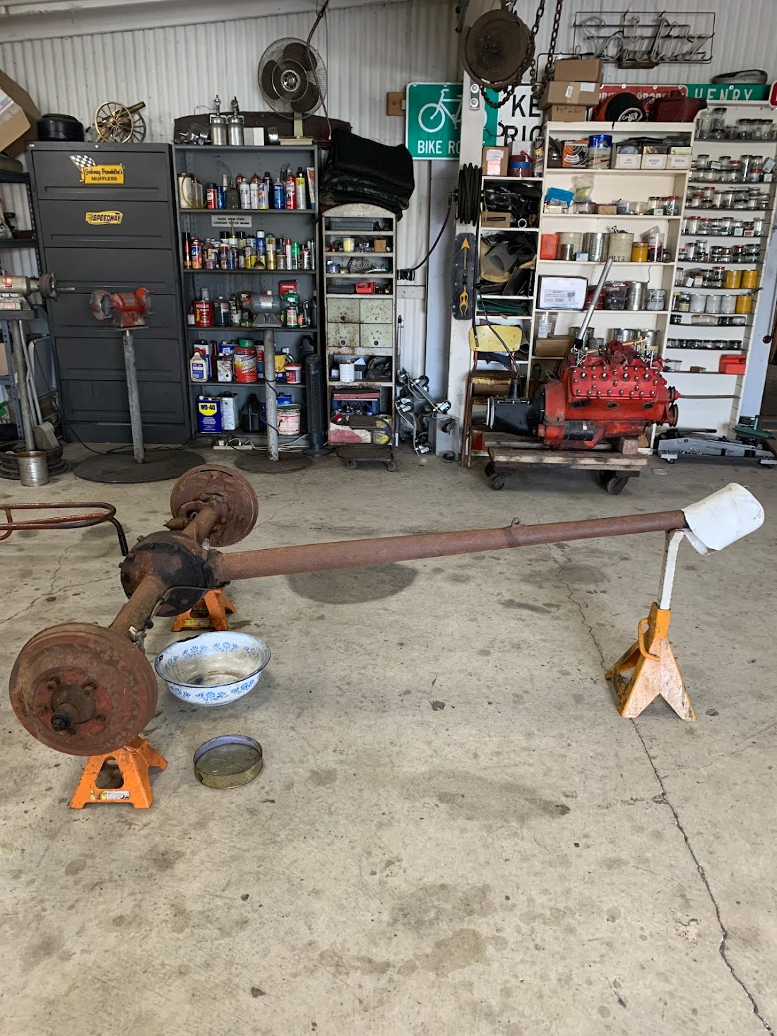

    Once the visitors had come and gone, I used a pair of homemade C-clamps to help dis***emble the rear spring. Three leafs were removed, and we slid everything into position. IMG_3111.JPG
    All the rear end components are on loan from my friend Aaron. My quickchange leaves Texas in the morning, and I'm already counting down the days until I can unbox it! IMG_3112.jpg
    We're now up to speed on the fabrication and ***embly. I have a few small updates that I'll throw in when it's time, but more on that later.

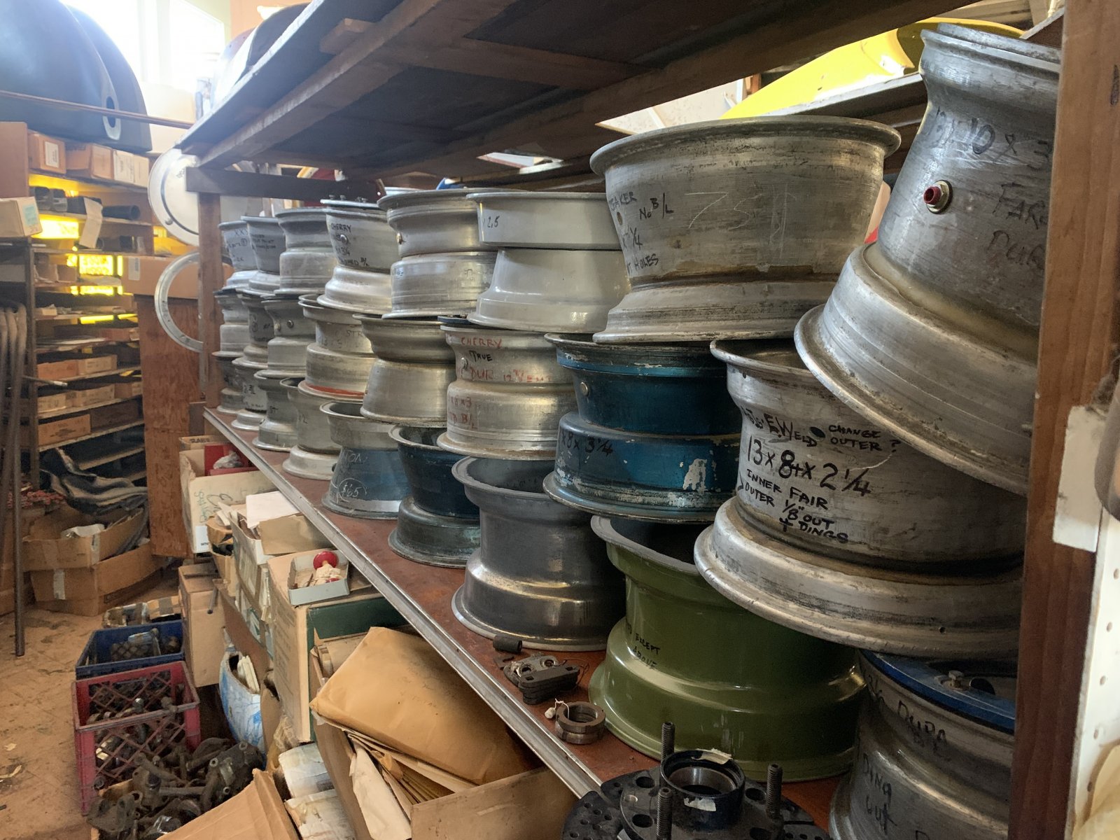

    @J.Ukrop just out of interest what are the wide 5 drums on your friends diff? (Sprint car I'm guessing?)
