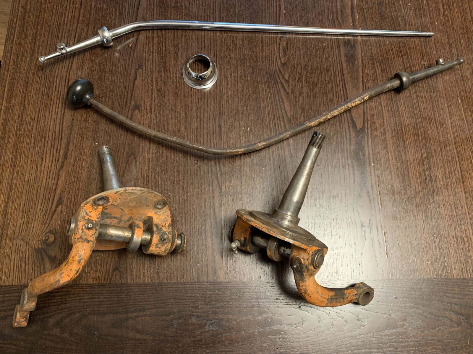

    Oh, and @Hitchhiker is the best. More details on these parts to follow.

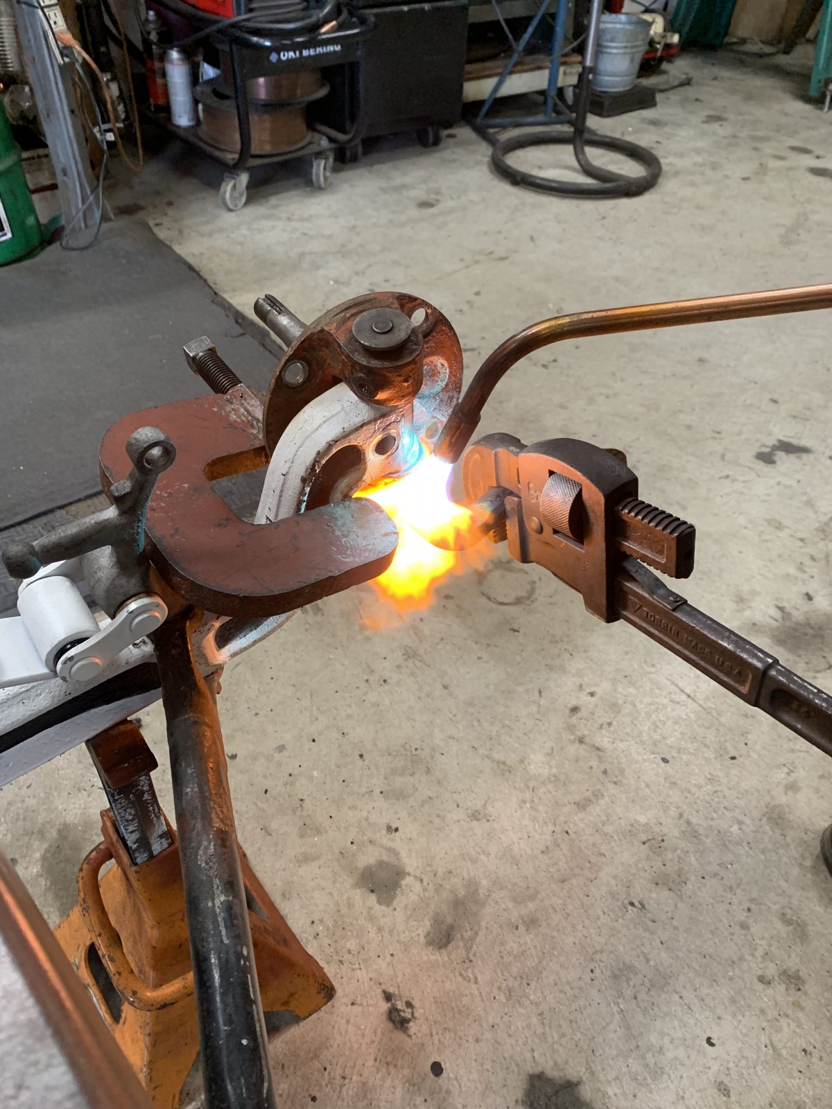

    First, we rolled the cart in the middle of the shop. I slid the new round-back spindles into place. We set the ch***is on jackstands so the front spring could have the weight of the drivetrain on it. Also, this gave us more leverage while bending the steering arms.
    We marked where we would need to bend the arms with chalk. Then David then broke out the Oxy/Acetylene torch and started working his magic. I was in charge of C-clamp installation and supplying tools when necessary.
    With the four-inch drop/no stretch on the axle, the steering arms required a great deal of finessing.
    We referenced Vern Tardel's dropped spindle book to double-check our work.
    Cherry red glow in a cooling state.
    Once the arm cleared the axle, we bent the bottom portion so the tie rod would fit. The steering is smooth and there's ample clearance throughout. IMG_3245.JPG
    Next came mock-up backing plates and, the moment we've all been waiting for, wheels! IMG_3250.JPG
    Things are really coming together! David and I pieced together temporary front hubs and drums, but I have a line on a much better set. I'm still searching for rear drums and hubs if anyone is holding.
    Possibly the biggest update in this thread all year. It's looking like a car! We still have to weld in the rear crossmember, but it's really happening. Can you believe it?
