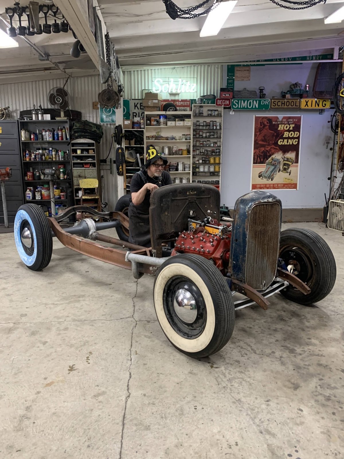

    Picking up where we left off...
    David's expertise really showed through on the torque tube shortening. Here you can see the fixture he made to align the pieces of the tube. IMG_3757.jpg
    "Grab the wheels," David said. I had been looking forward to that moment for a long, long time. On went the rear wheels.
    Just like that, we had a roller. We pushed it over to the corner of the shop and smiled. This is what we've been working towards since the fall.
    Can you believe this is my car?
    It still hasn't hit me yet.
    I really like the ride height in the front. We'll be adding those three leaves back into the rear spring to give it a little more rake.
    Hot rod hooligans!

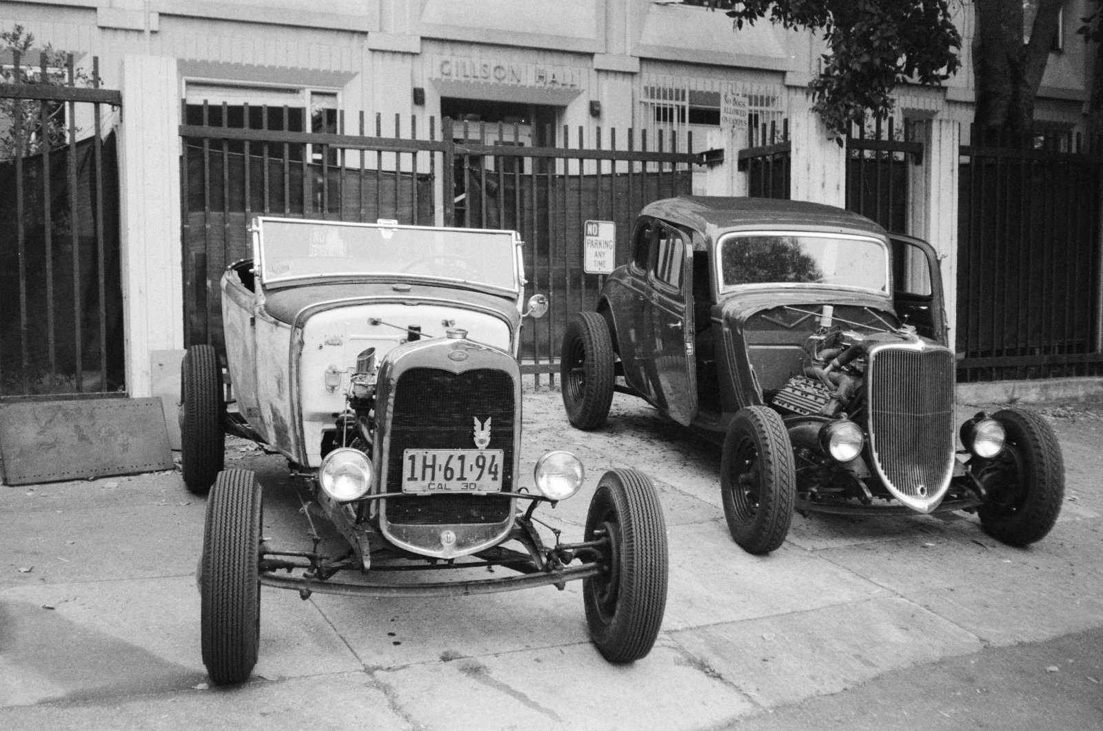

    Later in the week, I got my film back from the lab. Of all the shots, this one of @SAVAGE's coupe next to my car on the Terrace was a****st my favorites. It's hard to beat the feel of a 1968 Konica C35 with expired Ilford 400 film—it's certainly of another place and time.
