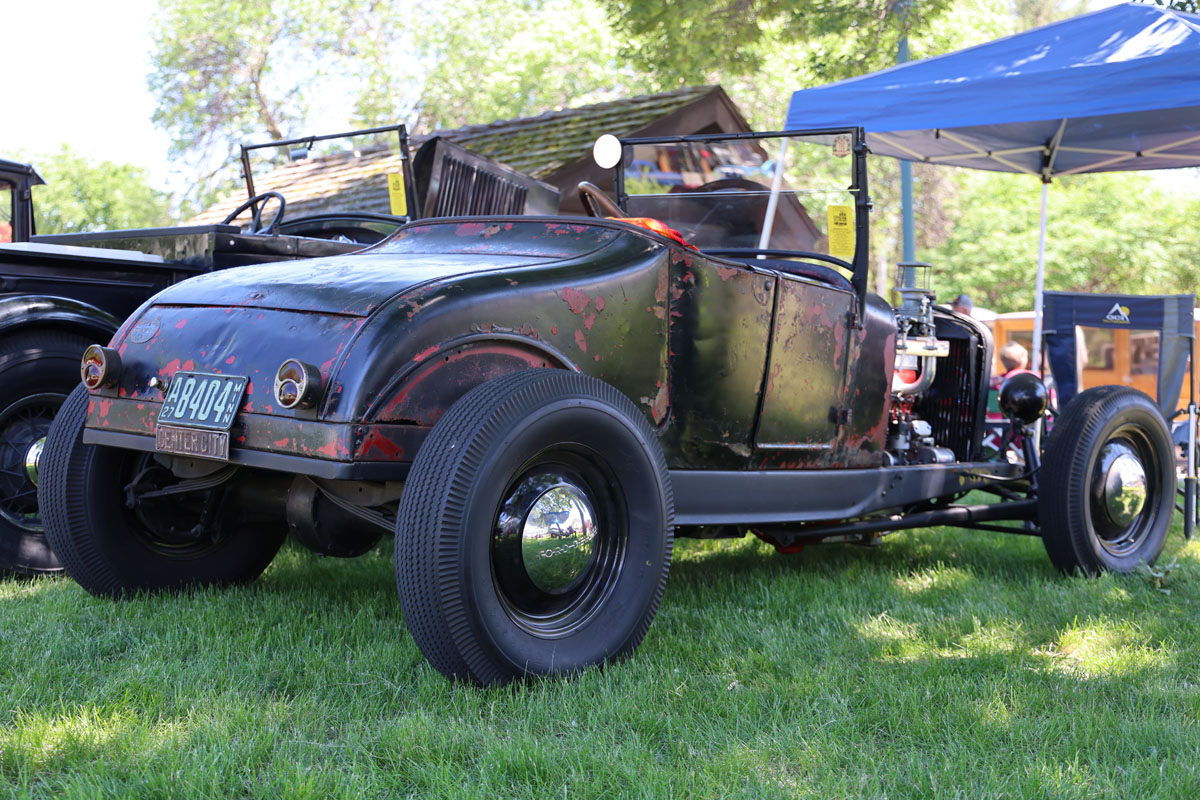

    Like this Model A roadster, for instance. It looked as if it was an older resto rod that was backdated to 1940s style. Talk about a great stance!

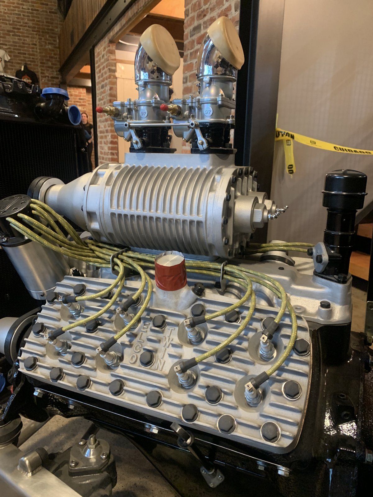

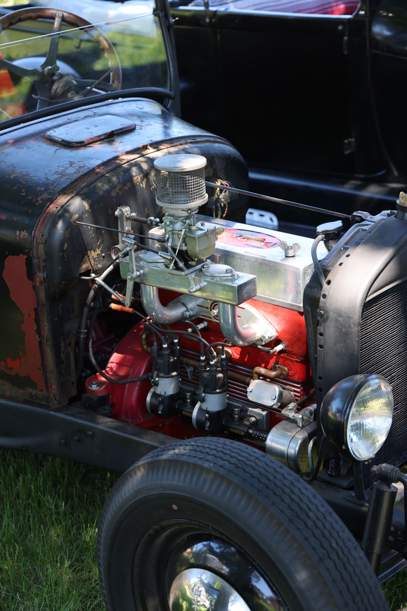

    This supercharger was impressive, as was the detailing on the engine. I aspire to have fit and finish like this on Version 2.0's 59AB.

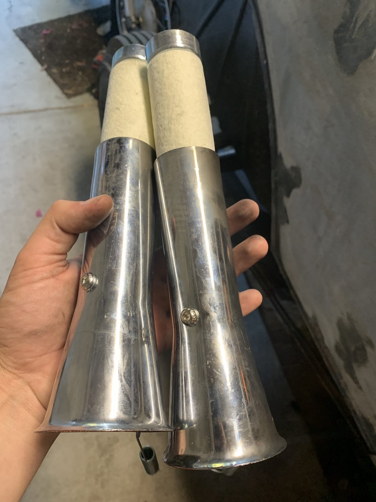

    The night I got back, I immediately walked into the garage and started working on the roadster. I've been experimenting with the exhaust and wanted to try a set of baffles.
    I started with these eight-inchers and took the car for a test spin. It's pretty quiet at idle and not much louder when you get on it. I bought a four-inch set, but I plan to trim these shorter and shorter until I get the sound I like. The straight pipes were cool, but wearing earplugs while driving around town got old pretty quickly.

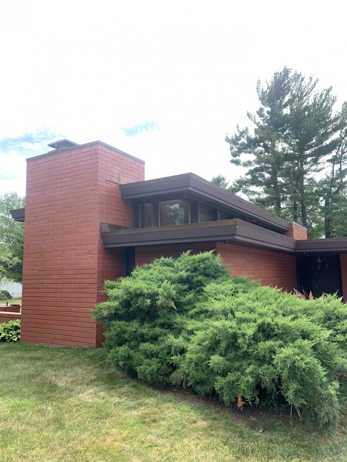

    And yes, I had to swing by this Iowa FLW treasure that was built around the same time the red five-window (above) was channeled.

    If Frank Lloyd Wright, could have possibly found the time to be a gear-head, it would have been amazing to see what he would have built, as a hot rod or as a kustom.

    In fact, Frank Lloyd Wright was a car enthusiast and, a**** a large stable of cars all painted the same color, he had a customized '40 Lincoln. It is a bit odd.

  24. And yes, I had to swing by this Iowa FLW treasure that was built around the same time the red five-window (above) was channeled.
    Joey,
    Did you get to stay in this one?
    Brian B
    J.Ukrop and 41 GMC K-18 like this.

    I did a quick search on FLW, as much as I appreciated the incredible structures he designed and built, it never occurred to me that he had a great collection of automobiles, that were unique and distinctive!

    Woah, that's a new bit of trivia for me. Wright marked his buildings with his signature single red tile by the front door. I bet this tied into the color of his machines.
    I wish! I really wanted to knock on the door and chat with the owners. I'll do that when I drive Version 2.0 over there.

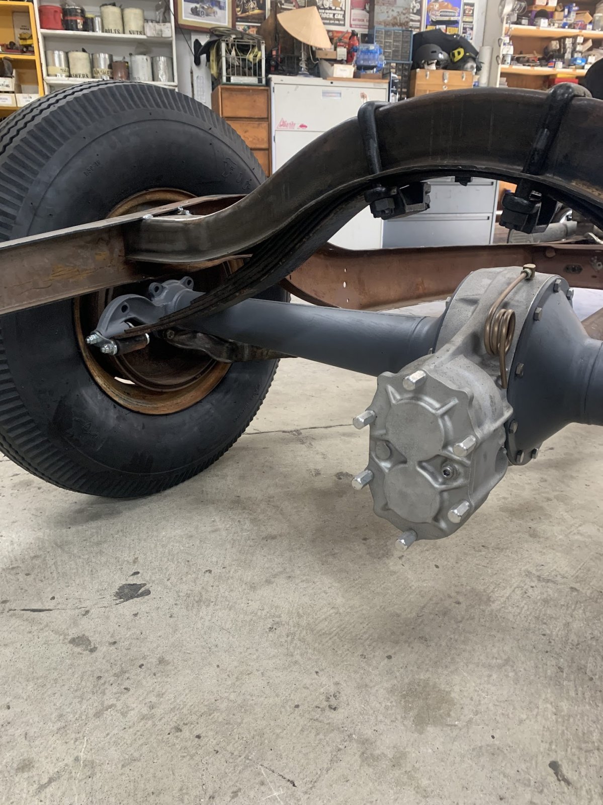

    What do I mean when I say “right?” Well, when we got it going as a roller, it became immediately clear that the rear was too low. We had removed two leaves from the Model A spring pack last month, and we decided that we were going to put them back in.
    So, as David focused on customer work, I removed the rear end and dis***embled the leaves. I think this is the third time I’ve done this, so I’m glad to say that I’m getting proficient at it.
    With the spring back together, we conducted the most scientific test of them all: jump on the crossmember and see if the suspension bottoms out. David and I took turns and both got a good laugh out of the process. Note the traditional chain hoist that David saved from the dump! Screen Shot 2022-07-06 at 12.32.56 AM.png
    Here's a screenshot of a video. I will say this: it was pretty interesting to watch the spring, shackles and axle all working together from above!
    Well, after our test we decided that we needed to make some spacers for the top of the spring. This would help stiffen the spring while also adding an inch to the ride height. With that, we went to the back and pulled out some extra Model A leaves.

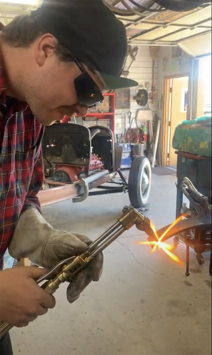

    Springs are tough, so David suggested we cut them with a torch. We traded off cutting duties, and I learned a lot about everything from flame type to technique. Screen Shot 2022-07-06 at 12.41.06 AM.png
    To answer @HOTRODPRIMER's question from my other thread, I'm using this as practice for when I bob the rear frame rails.
