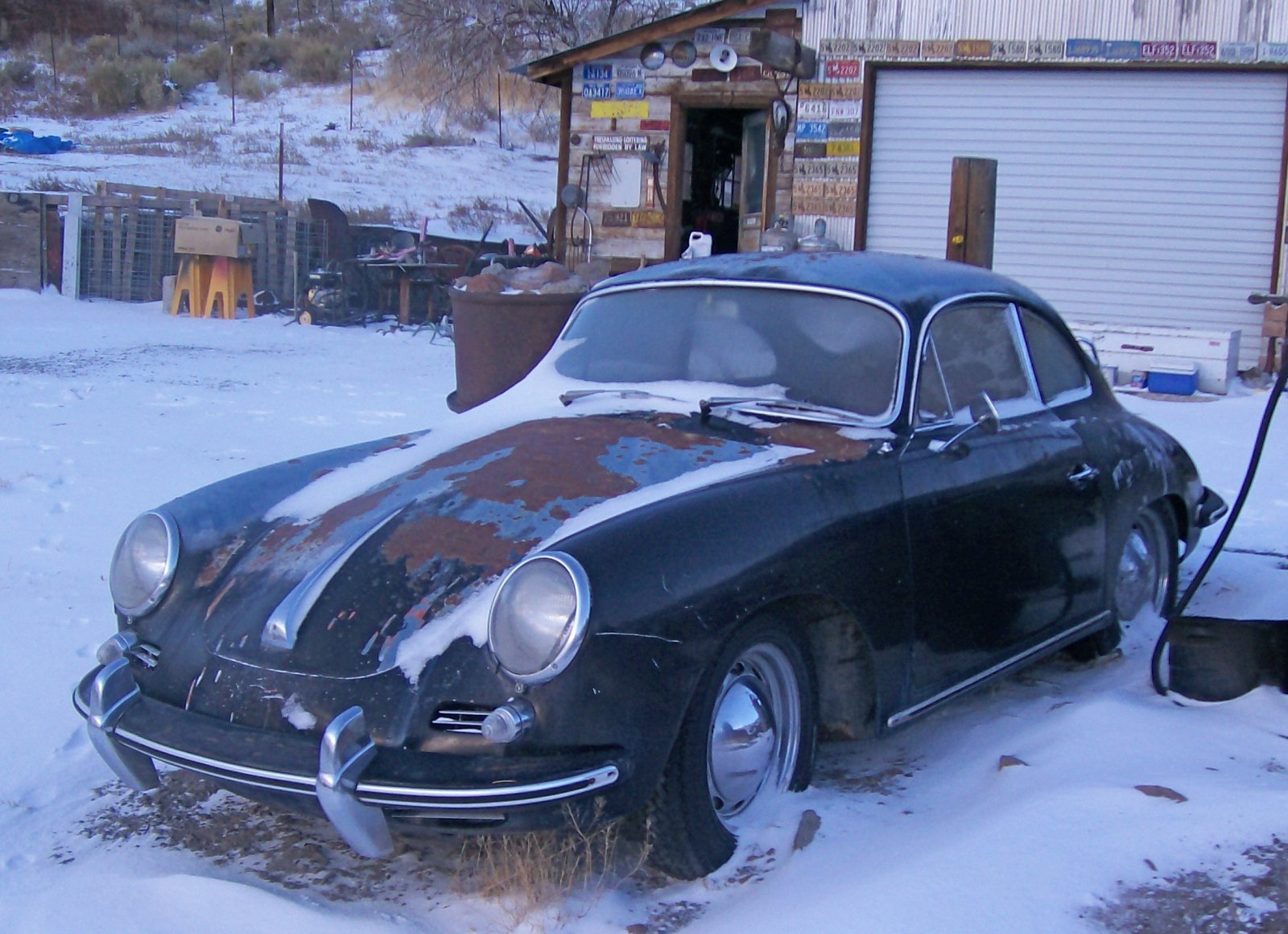

    I just about died when I spotted this 356 in Berkeley.

    This one is a bit less inspiring. Someone should be shot for leaving it outside for the last 30 years. So shoot me. It was very nice when we brought it here from Oakland 50 years ago. 100_0667.JPG
