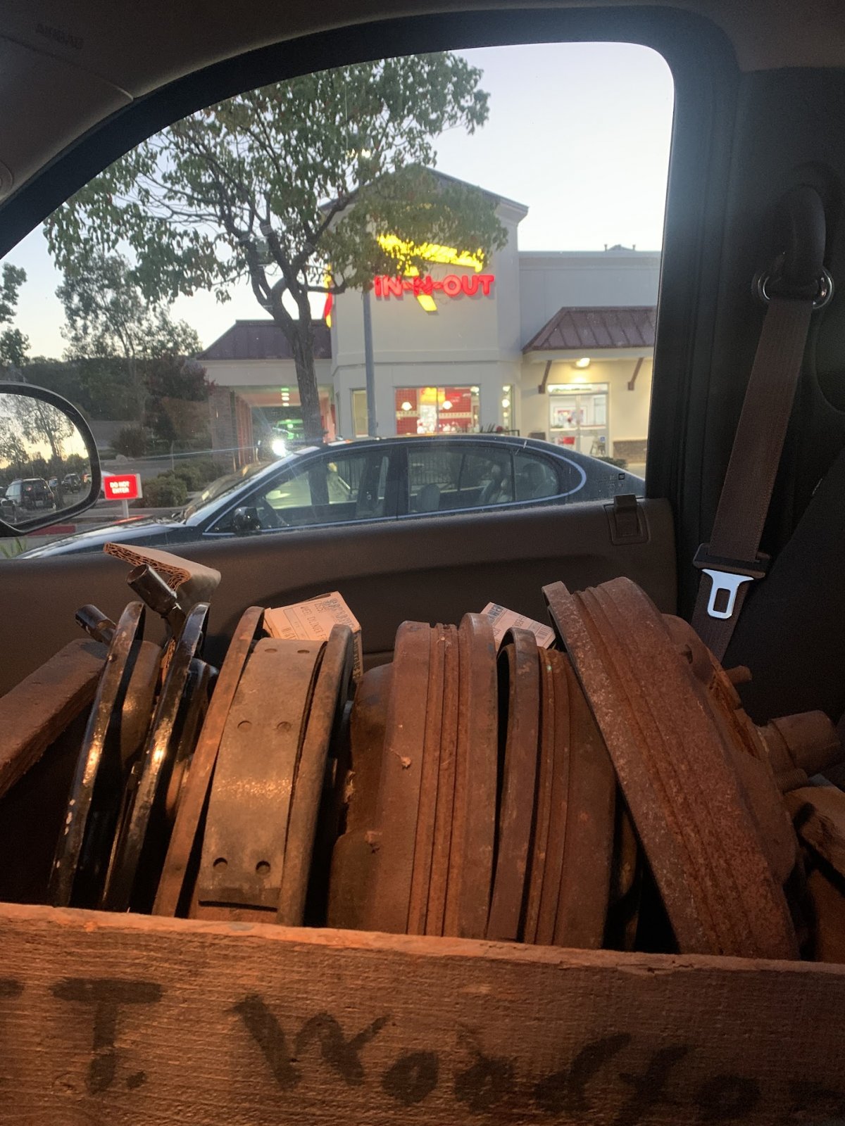

    Longtime readers of this thread know that I've been on the hunt for front brake drums with hubs since the start of Version 2.0. A few weeks back, @Jeff34 mentioned that he had a friend, Dave, who was looking to move some brake parts down the road. This afternoon, I called Dave to ask if he still had the lot. He said he did. After confirming that they're within spec with his 1950s Bear brake gauge, I let him know I would be over before dinner.
    Driving up to his house in Santa Rosa, he immediately greeted me with a smile. The sun had started to set, casting golden light across his lawn. The familiar sight of a Model A wire wheel as a hose reel confirmed that I was in the right place. On our walk towards the back yard, I learned that Dave has had a lifelong fascination with early Fords, and he's an active member—and judge—in the area's Model A club. Both he and his wife have toured extensively in their A's.
    With a cold beer in hand, I loved hearing his stories of visiting National Parks, rebuilding his '28 Model A pickup, and driving his flathead-powered '41 Ford stakebed in San Francisco's SOMA (South of Market) neighborhood back in the 1970s. He's an absolute wealth of knowledge. As we were winding things down, I mentioned that I wish I would have met him while building Versions 1.0 and 1.5 of my roadster. He agreed, but told me I'm more than welcome to return whenever. IMG_7791-1.jpg
    The story goes that these brakes sat in an attic for the better part of 50 years. With some sandblasting, turning and test-fitting, they'll be ready. IMG_7792.jpg
