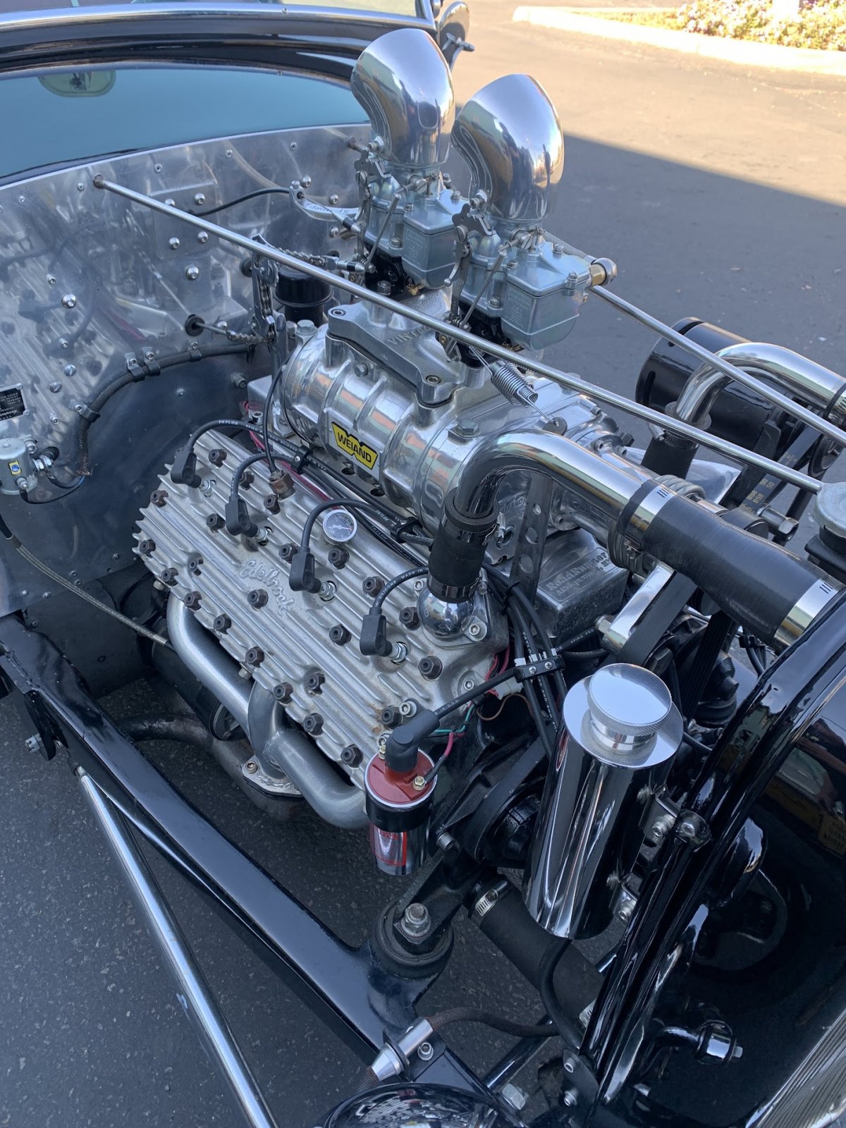

    Before we dive in, here's one of the day's visitors. David did a great deal of work on this survivor Model A. IMG_7846.jpg
    The throttle linkage is a signature di Falco piece.
    The chrome trans is a work of art.

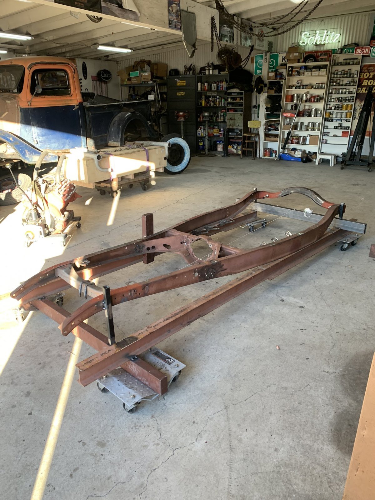

    To kick things off, I removed the front suspension. We then swapped springs and realized that, although it went on easier, it did not make a difference. We measured, measured and then checked again. It was at that point that we realized that the p***enger side frame rail was bent. My heart sank. How could that be? We checked everything when it was a bare frame. What could have changed?
    There was no other choice: we had to tear it down to straighten the frame.
    Much to my surprise, I had the whole thing torn down in less than 30 minutes. To quote my old boss Steve ****an, "Experience is what you get when you don't get what you want." I will say that throughout the course of this build, I've gotten pretty proficient at taking this thing apart.

    For the rest of the afternoon, we focused on building a frame table. We made sure everything was square, and we made a centerline out of string. Next time I'm at the shop, we'll use every trick in the book to whip it back into shape.
    It's hard to pinpoint what it was about this frame issue that took the wind out of my sails. In retrospect, it was because I felt like we were getting so close, and Saturday was going to be a relaxing day of simply bolting things together. But this isn't a kit car. It's not a mail-order car. It's a traditional hot rod built out of dozens of 1920s-1950s parts that were never meant to go together. It's not supposed to be easy.

    My roadster frame had a bent horn. Leroy & Bruce clamped it to the ch***is table applied a bit of heat & a little pressure and it remembered how straight it used to be. No big deal. It's just metal. It's soul purpose is to be shaped, re-shaped, or melted down and made into a new shape.

    had a '33 frame no front crossmember, bent in 1/2", buddy makes the beer brewing vats,
    had me heat the inside of the rail red hot in a vertical 1/2" wide strip, then in a triangle from the vert rail out to the inner frame edge,
    it pulled the wrong way when HOT but pulled it in perfectly when COLD,
    it only can pull as the metal cools /contracts, ask a metal guy about baking the carbon from the steel...
    it works well... go j u go !
