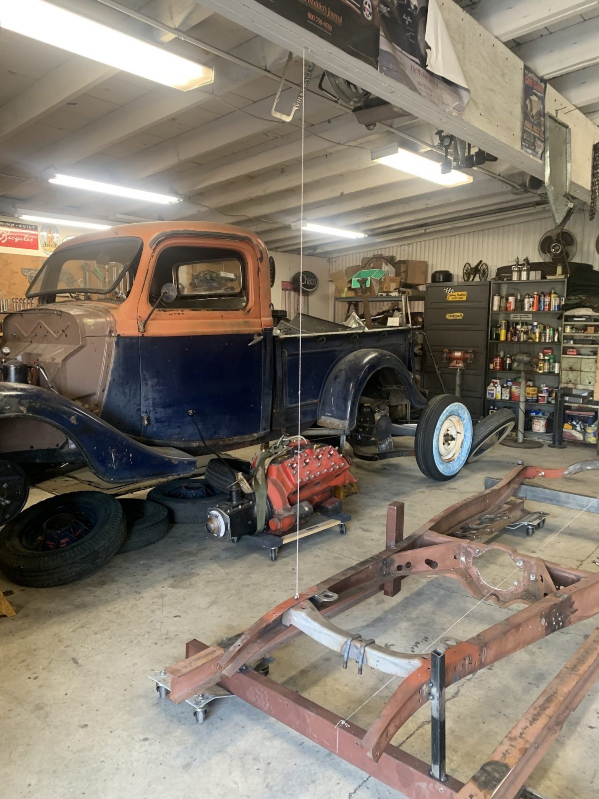

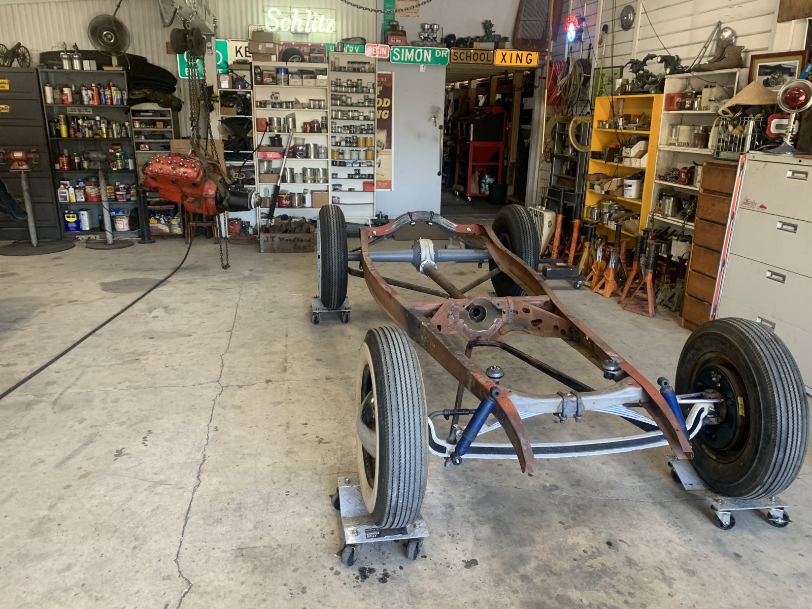

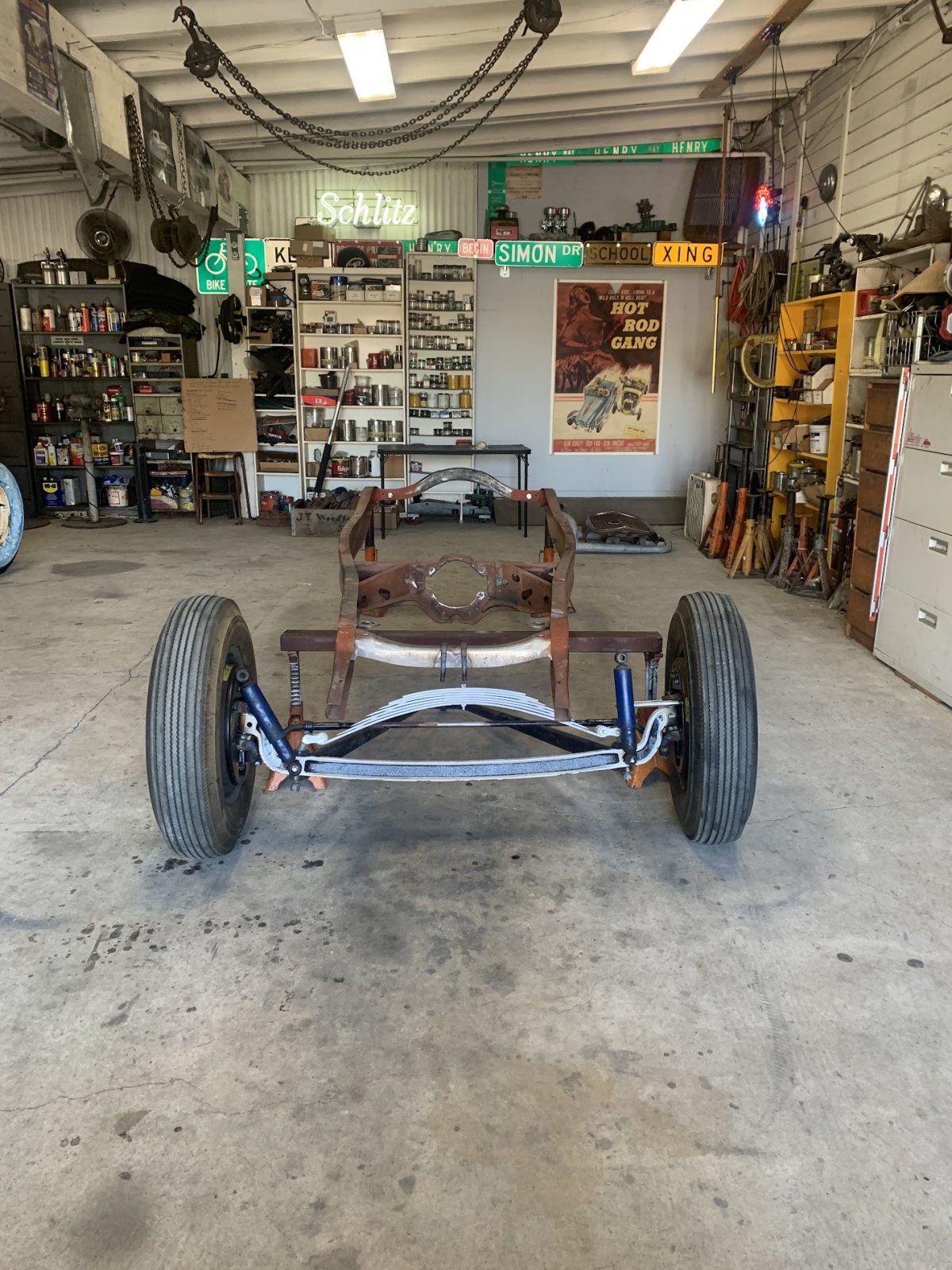

  10. J.Ukrop
    Joined: Nov 10, 2008
    Posts: 3,649
    J.Ukrop
    SUPER MODERATOR

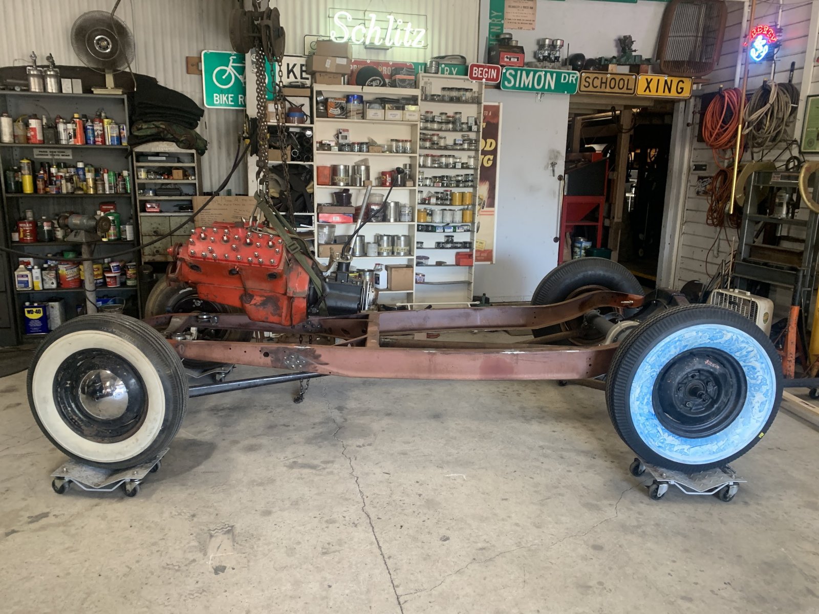

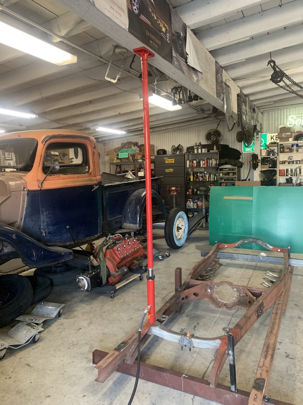

    Let's turn back the clock to early October. The car is 100% dis***embled, and the frame is sitting on a custom table built out of pieces of the Golden Gate Bridge (1937 International Orange paint and all). David has just purchased a Portapower, and we're determined to straighten the frame.
    First, he recommends I create a plumbob out of a nut and some twine. I affix it the ceiling beam beneath a favorite Rodder's Journal poster.
    Next, we break out the Portapower with extensions.
    It's important to note that the iPhone lens makes this look crooked, even though it's not. We measured it in all directions using multiple levels. Once it was square, worked the handle and watched the Portapower slowly do its job. We had to push it pretty far because the frame wanted to spring back. When it was all said and done, we successfully brought the p***enger side down 1/2-inch.
    Much better.
    We checked everything with a level and, after we gave it the green light, I started re***embly. I made a point to do it entirely by myself.
    A fun part was installing the engine with this heavy duty chain hoist that David found at the local dump. It's a real workhorse.
    While I was at it, I trimmed the lower motor mounts to better fit the frame.
    JalopyJimbo, Stogy, warbird1 and 10 others like this.

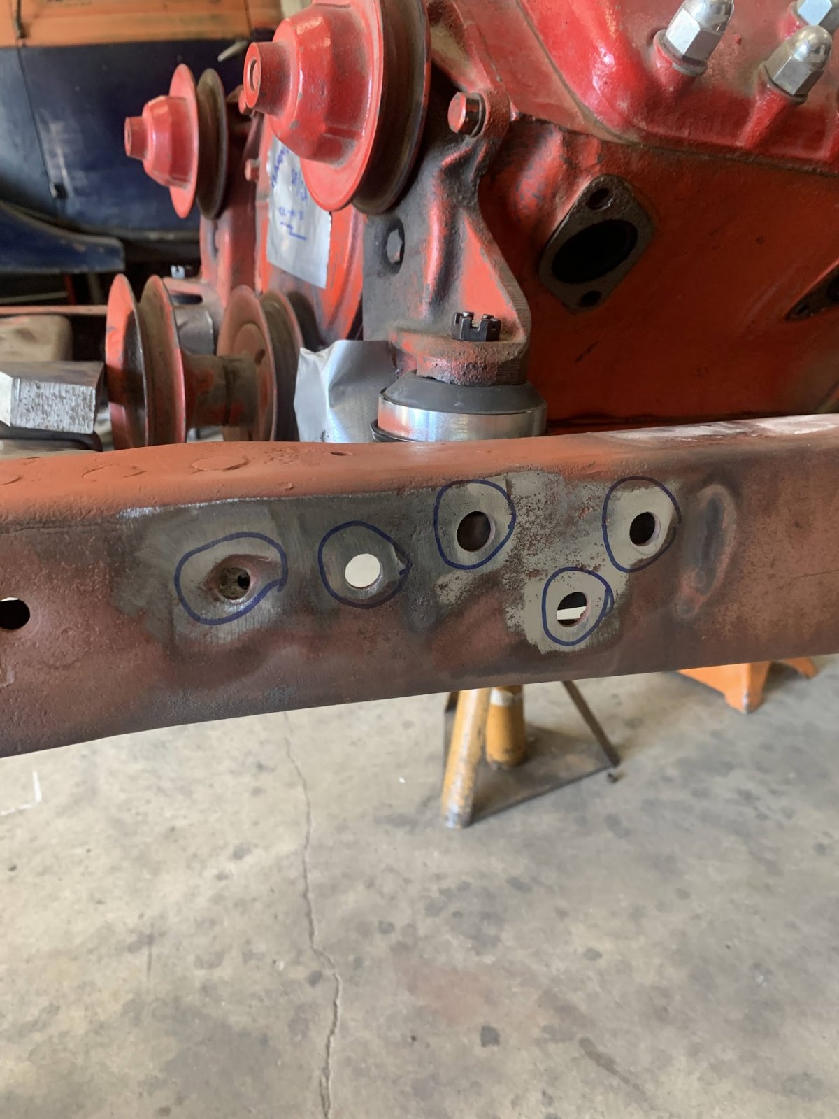

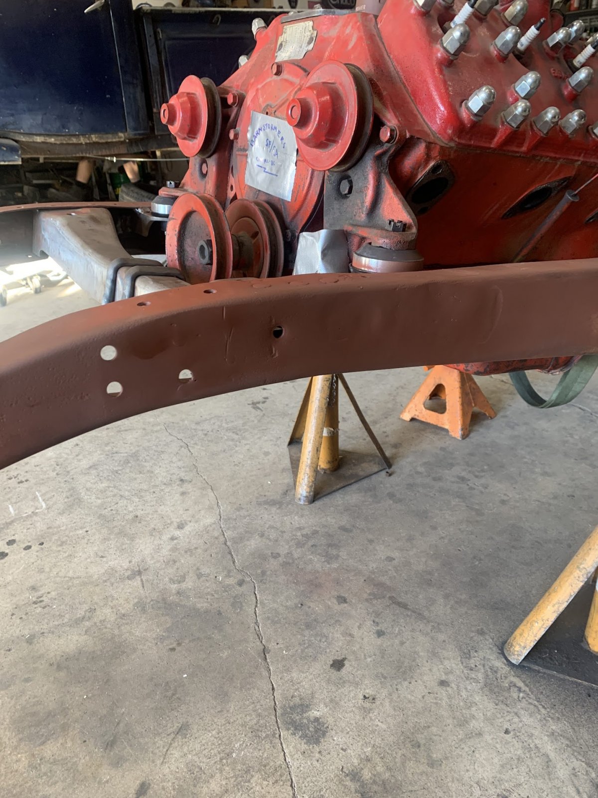

    As I prepared to install the front shock mounts, I had to fill these five holes.
    It's far from perfect, but there's no denying that it's a genuine '32 frame. I plan to finesse it more prior to powdercoat. Due to popular demand, David revamped some vintage brown primer for me to spray.

    Probably a daft question, but it often occurs to me if welding up a bunch of big holes in one area like that could pull the frame out of whack again, or is that not usually considered a problem?

    Thank you! That is a completely fair question, and it's one I had myself. Two things. 1) I jumped around between holes, never filling a full hole at once. This allowed for some cooling. 2) Post-weld I measured everything when I drilled for the F-1 shock mounts. Using my Mocshocks as a rigid guide, the holes landed in the same spot on either side, meaning that everything is in check. I hope it stays that way!
