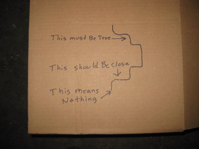

    you checked your rim on the absolute outer edge, which really has no relationship with where the tire sits when mounted. the outer edges are quite often bent up from tire iron operators with no skill or patience, but that does not affect the tire running true. the place to check is where the bottom of the bead sits, and where the side of the bead sits. place a jack stand up near the inner surface of the rim where i mentioned and check again. they gotta be round, and side play can be 1/6 to an 1/8 ok, 3/16 look for a better wheel. put the worst on the back. hope this makes sense, i am not computer savvy enough to draw out what i mean !
  3. rusty valley
    Joined: Oct 25, 2014
    Posts: 4,325
    rusty valley
    well, i drew up a sketch so i wouldnt loose sleep over the confusion i created. should make better sense now. btw, i have never seen a perfect old ford wire wheel, but they gotta be round. happy motoring IMG_0754.JPG

    I was eying all portions of the wheel while spinning it, but your diagram makes a ton of sense. Thank you for taking the time to p*** on the knowledge!

    also, marty's truck wheels above ^^^ are strong enough that two lug nuts would work just fine. however, i find that on old ford wire's you should really use all 5 lug nuts tight like normal for a more accurate test

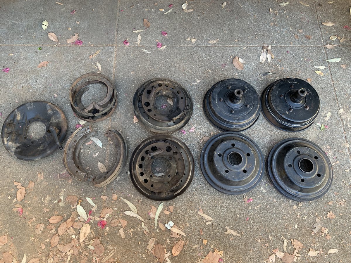

    Aaron (@SAVAGE) swung by this afternoon with a truckload of great stuff. Both the front and rear drums have already been turned and the rears need a tiny bit of cleanup. The fronts will need new wheel studs sweged in, but I've already talked to a machine shop in Los Gatos that can do it (if anyone knows of a place a little closer to SF that can tackle it, I'm all ears). In the pile are also a set of four almost-perfect brake shoes and plenty of parts.
    It was great catching up and hearing about Aaron's new projects ranging from a survivor '34 Ford to a bad*** home garage that he's building. I'm going to head down his way to check it all out in the not-so-distant future.

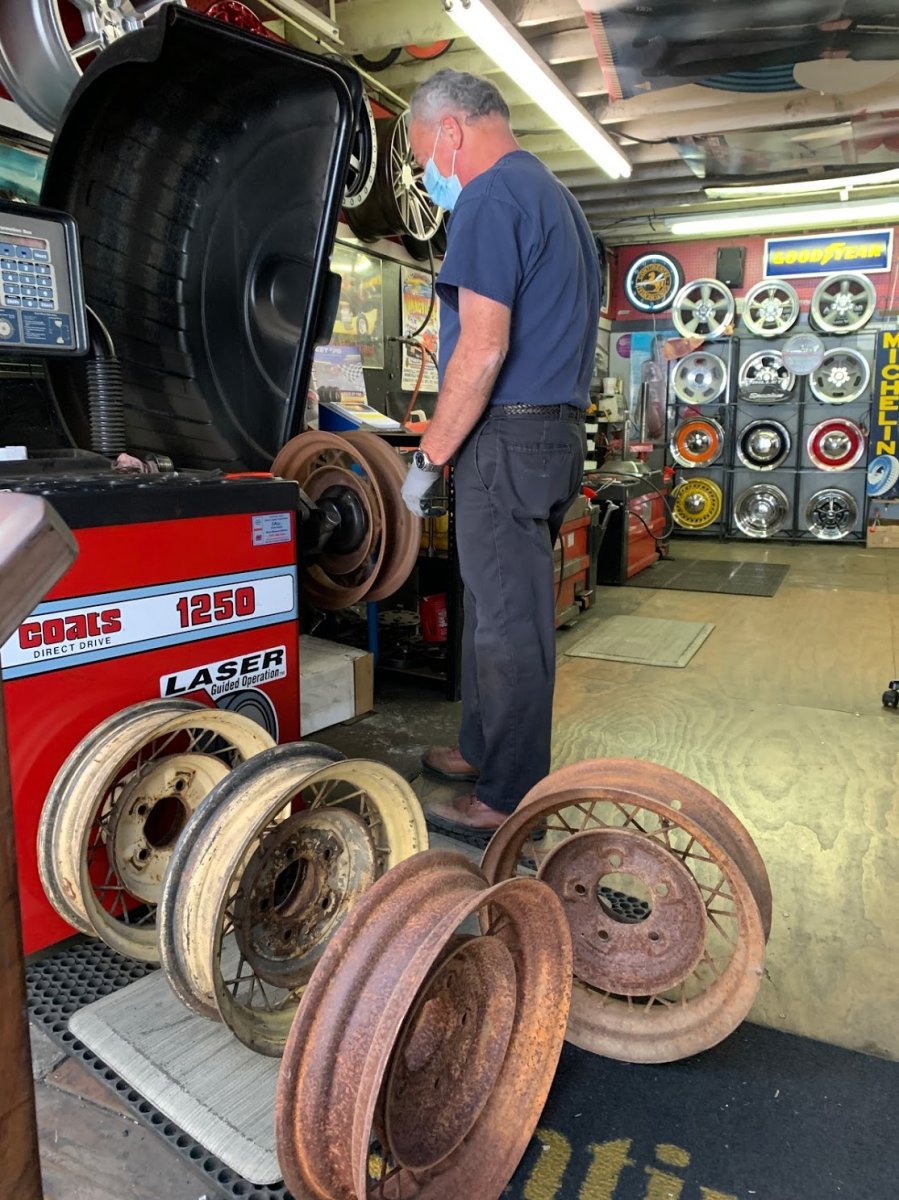

    Also of interest: I was able to take my wheels to Andy's in South San Francisco during lunch one day to get a second opinion. After running all four on the balancing machine, they confirmed my findings. Four were good, one was just alright. So now the best four are at the sandblaster and should be ready Friday. Know what that means? Paint this weekend! IMG_1120.jpg

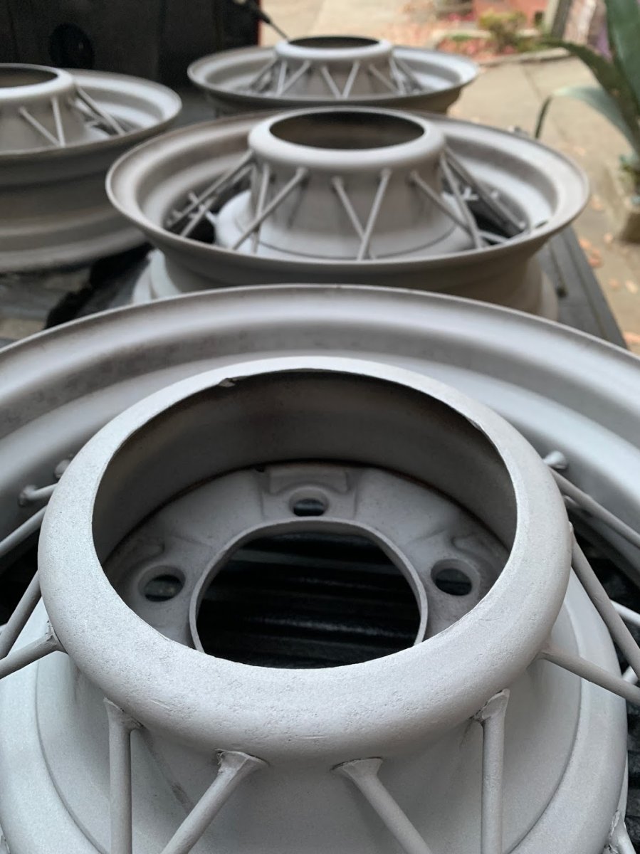

    Tomorrow morning, my wheels will be ready to pick up from the sandblaster. It's supposed to be sunny, so hopefully I'll be able to spray some primer on my lunch break. I also got the studs for my turned front drums. I found a machine shop in Berkeley that will be able to machine the shoulders down 1/16th of an inch (per manufactures instructions) and swedge them in there. With any luck, I'll be able to tackle that this week. Additionally, I'm dis***embling my extra set of rear brakes to 1) learn about them and 2) send in the brake shoes as cores for my new ones that I will be buying in the next week or so.

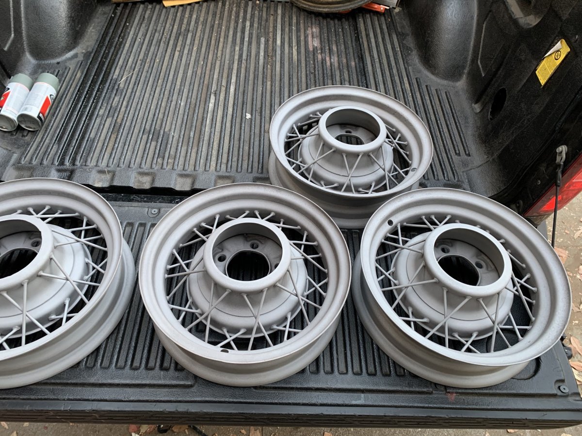

    Today I picked up my wheels and I am super impressed. I have never had anything sandblasted before, but I am blown away at how good they look. They're tucked away in the dry garage tonight, and I'll be priming them tomorrow. IMG_1231.jpg
