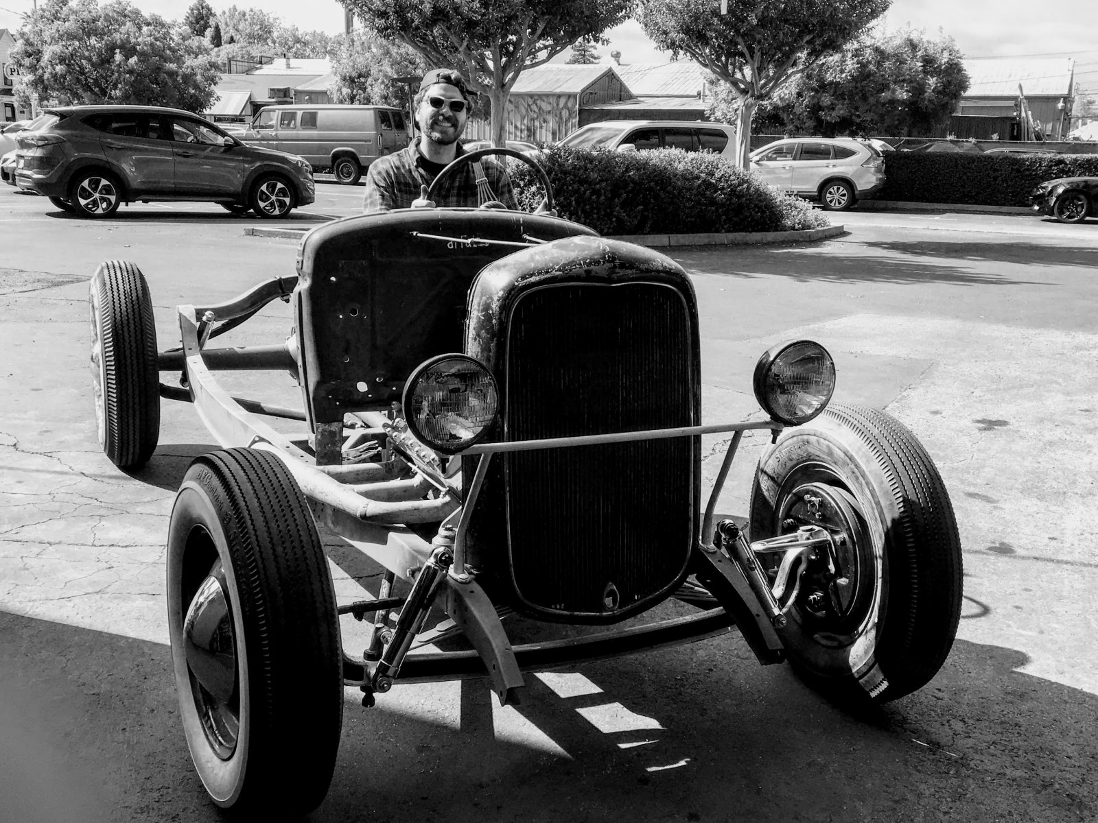

    Hahah that's how you know it's of the era! I'll have to take some black and white pictures of it again.

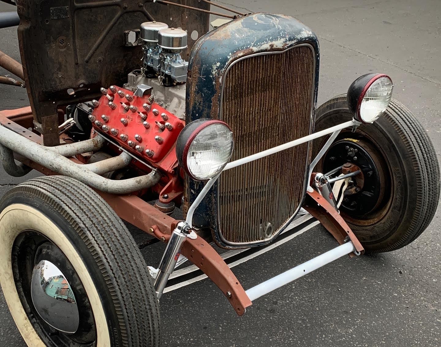

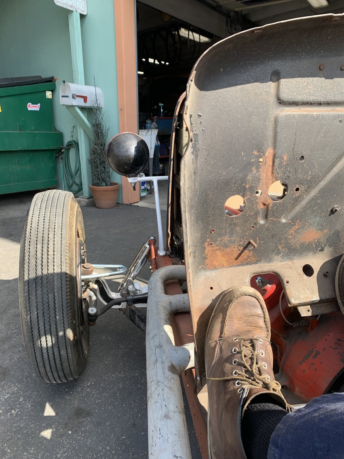

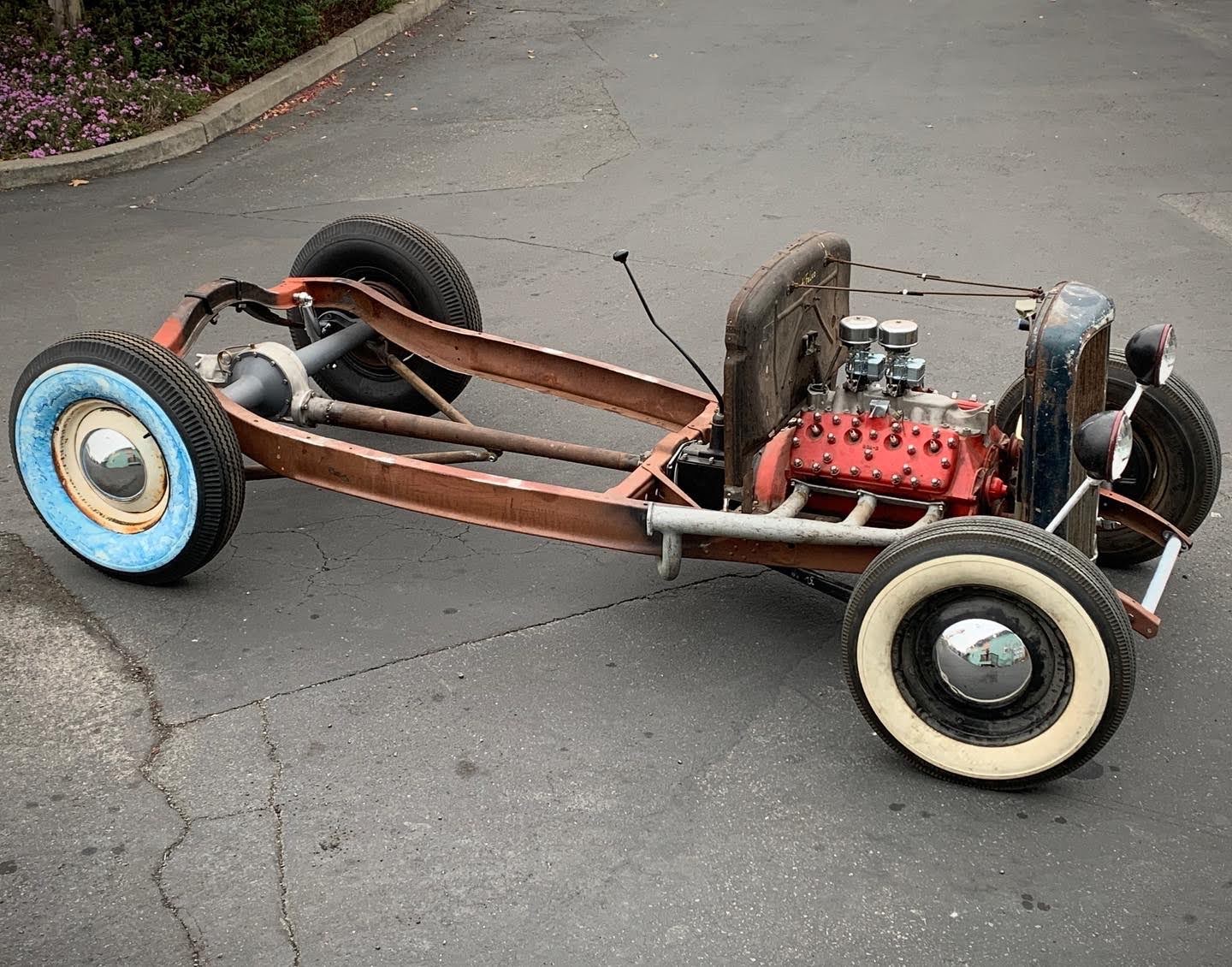

    I just finished writing a feature article for print that I'm extremely excited about, so I figure I better strike while the iron is hot. Let's dive into a roadster update.
    Last Saturday, I had two distinct projects in mind. First, I planned to re-install the radiator, grille and headlight bar. Second, I would focus my attention to the pedals.
    Just like on Version 1.5, I wanted to make rubber gaskets for the headlight bar. I cut pieces of reddish rubber to shape at home and drilled holes. When I showed them to David, he suggested that I hit them with his hole punch. Note the wood block backing. "You have a tool for every job," I said.
    When I put the headlight bar into place, I could immediately sense something wasn't right. "What changed?" I asked myself. The answer? Nothing. The more I looked, the more I realized the headlights were way too far forward. I hadn't picked up on that last time.
    Undeterred, I reconfigured everything and drilled two more holes in the frame.
    This puts the headlight bar in line with the shocks and tucks it closer to the grille. Coincidentally, the base of the bar is in a nearly identical position on Version 1.5 and 2.0.

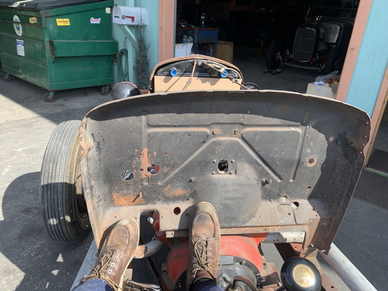

    Once everything was in position, I couldn't help but grab an old step stool and jump behind the wheel. David handed me a banjo wheel and I was off to the races. This was the first time in a long time I've sat in the car. Talk about an exciting moment.
    Getting a feel for things.
    Imagining pedal and steering column placement—and dreaming of watching this wheel roll as I drive down the road.
    A friendly reminder from @Lucky Burton. I love that it says that my lucky day is Saturday.

    Sidebar 10.15: Leveling Up
    Right before lunch, I started cleaning up tools. As I did, I kept on looking at the ch***is sitting in front of the shop. There was no doubt about it: things are really coming together. I felt confident in the work David and I had done thus far, and everything looked good to the eye. Yet, for whatever reason, I felt the need to test it one more time. I walked into the shop and grabbed a bubble level. I set it on the headlight bar and took a deep breath.
    It was almost perfectly level.
    Back when David was building bicycle frames, Bruce Gordon told prospective employees that if they couldn't see a 90 degree angle, they should just pack up their things and go home. From day one, David saw the right angle. He went on to work with Bruce for more than a decade.
    When I saw that level, I felt a sense of relief—and I thought about David and that story. I thought about all the pieces that had to work in concert to make that happen. Wheels, tires, spindles, front axle, shackles, spring, U-bolts, headlight bar, frame and more. These are all things we had our hands on to get this far.
    As we sat down at our card table for lunch, I told David about our success. "That's what happens when you do things the right way," he said. "Now take off that level. It's blocking our view."

    Next, I started working on the pedals. After consulting Vern's book, we decided that the '39 pedals would be the way to go. David gave me a few pointers on the dis***embly process.
    Off with the old master cylinder.

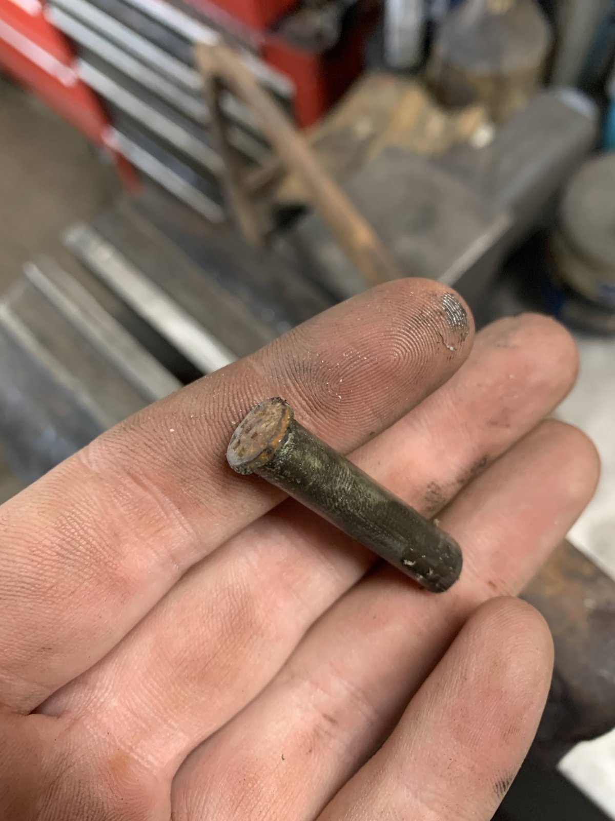

    Then I ground down the head of the pin and drove it out with a punch. Much to my surprise, it slid out easily.
    Then I soaked the pedal ***embly and drove out the main shaft with a br*** drift.
    Once I had all the pieces on the faux wood paneled table, I was able to inspect them.
    A new shaft and bushings are on their way.

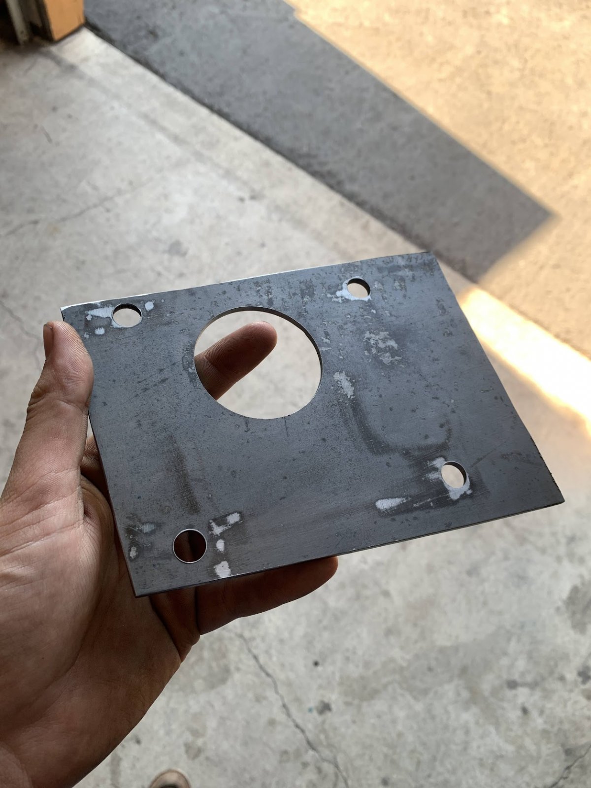

    I then made a template for the plate that will be added to the K-member. I'll be cutting this out of 10 gauge next time I'm at the shop, and David is going to show me the best way to get everything mounted.

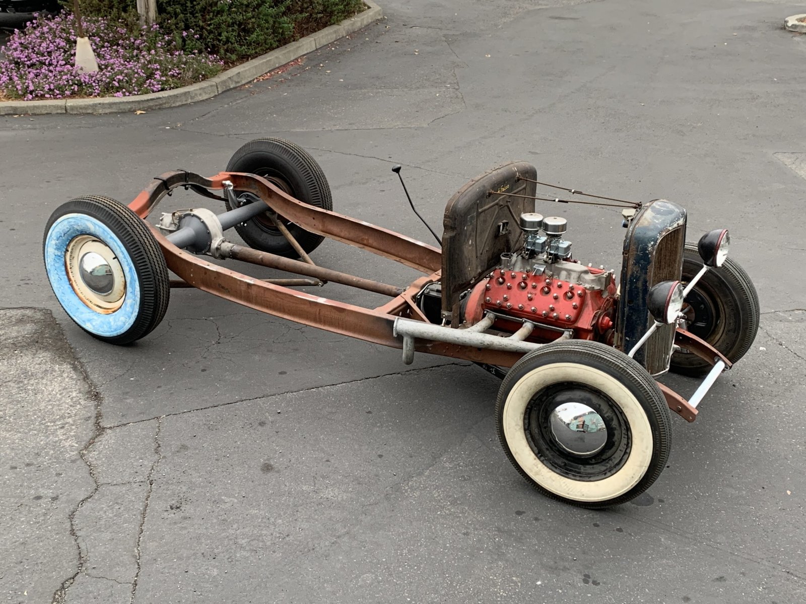

    As the day wound down, I rolled the ch***is out towards the middle of the lot for a mini photo shoot. The lighting was good, and it's never been more complete.
    For me, this was huge. You guys know how much time and effort we have in this ch***is. You've been here every step of the way. I know we're far from finished, but it felt really good to take a step back and see it on all four wheels outside of the shop.
    Oh, this reminds me that I still need to clean up those headlight stand pads!
    So there you have it. I left the shop feeling great. I'm excited to jump back in next time I'm there and keep trucking on the pedals.
    That's all for tonight!

    Fantastic update. I remember the first time I sat the 46 on four wheels and tires and it really did feel like “wow! I’m almost done!”
    all the work going into a hot rod ch***is to make it hold drive train, steer and roll. No one but someone who’s done it knows how many times you’ve stared at it sideways making sure that cross bar lines up with the shocks and the fronts of the headlights hit the perfect spot of the ark of the front tires.
    It would almost seem the more simple a ch***is the more staring and tweaking that’s been done.
    now all that’s left is the rest!

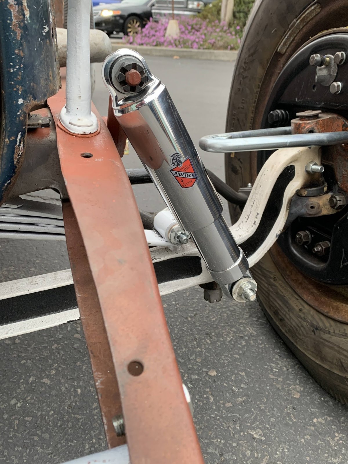

  22. Excellent! What kind of clearance does the tie rod have to the frame? It looks like they might might lean in and kiss each other from what I can see in the picture with your boot.
    Stogy, J.Ukrop and Budget36 like this.

    Nick, you make a good point. By jumping up and down on the front frame horns, I was able to get them to touch a little bit. David and I plan to un-drop the tie rod ends a little bit and then narrow the tie rod some more. I think the Speedway ends are forged, but they kind of look cast to me? If that's the case, we'll have to find another solution.

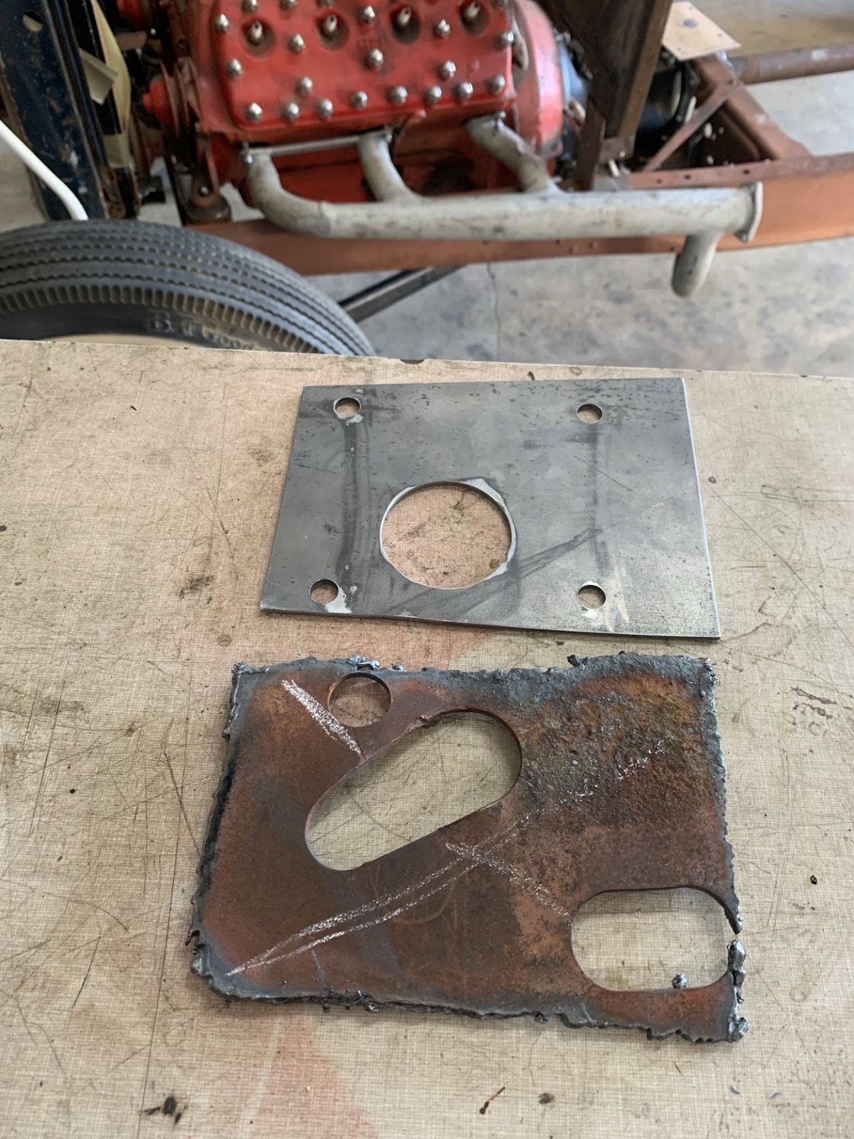

    IMG_8633.jpg When we got back, we had a clear goal in mind: remove that piece of the K-member. We debated whether or not to use a cutoff wheel, and I opted for using the oxy/acetylene torch. After spending a whole lot of time removing the rear frame rails with the former, I figured this would be the more efficient route.
    David gave me a few pieces of metal to practice on. After about 15 minutes, I realized I was as ready as I was ever going to be. I donned my shade 5 gl***es, slipped on some gloves and started cutting.
    As the torch hissed, I worked to follow the soapstone line. A couple minutes later, I pulled the old section out. Next time, I'll be cleaning up the perimeter and tacking the new plate in place.

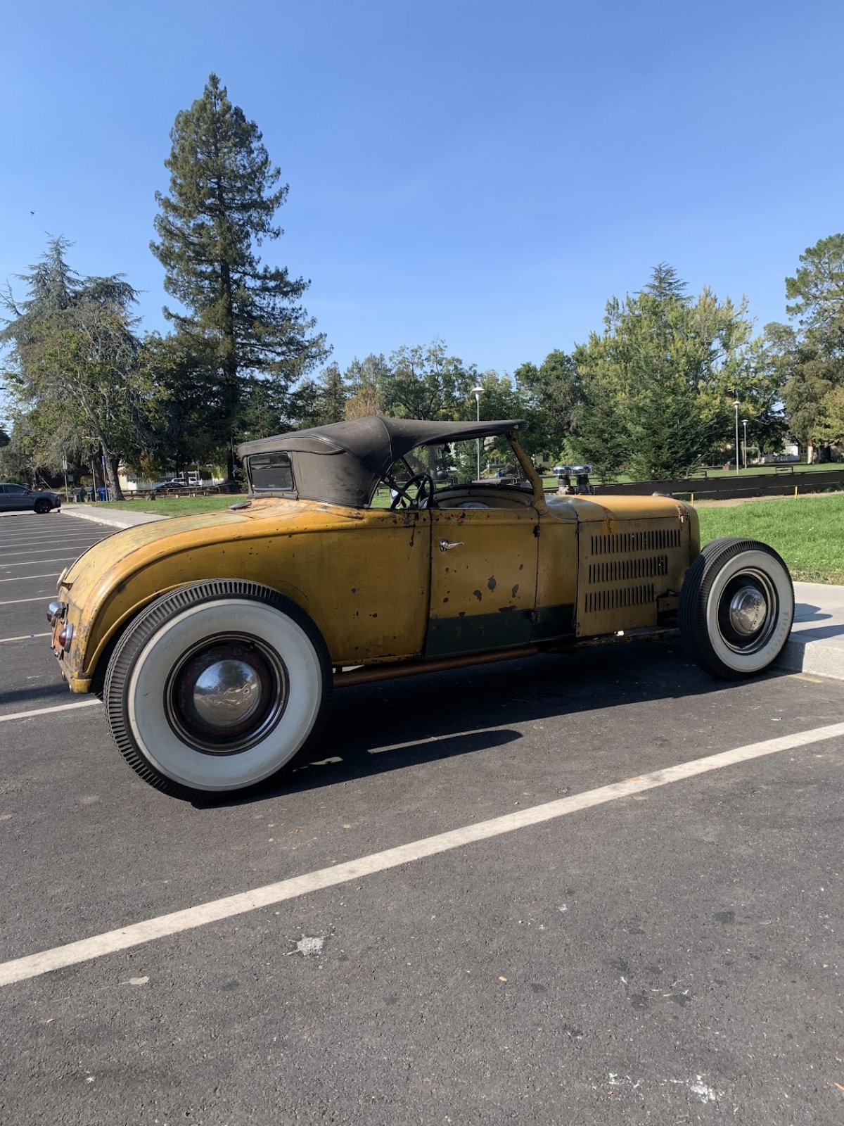

    Does David ever drop the top on the roadster? Seem to see it up most the time, curious if it folds or lifts off.
  30. J.Ukrop
    Joined: Nov 10, 2008
    Posts: 3,643
    J.Ukrop
    SUPER MODERATOR
    Thanks! He usually keeps it on there. If I recall correctly it does fold, but if it's down he takes it completely off.
