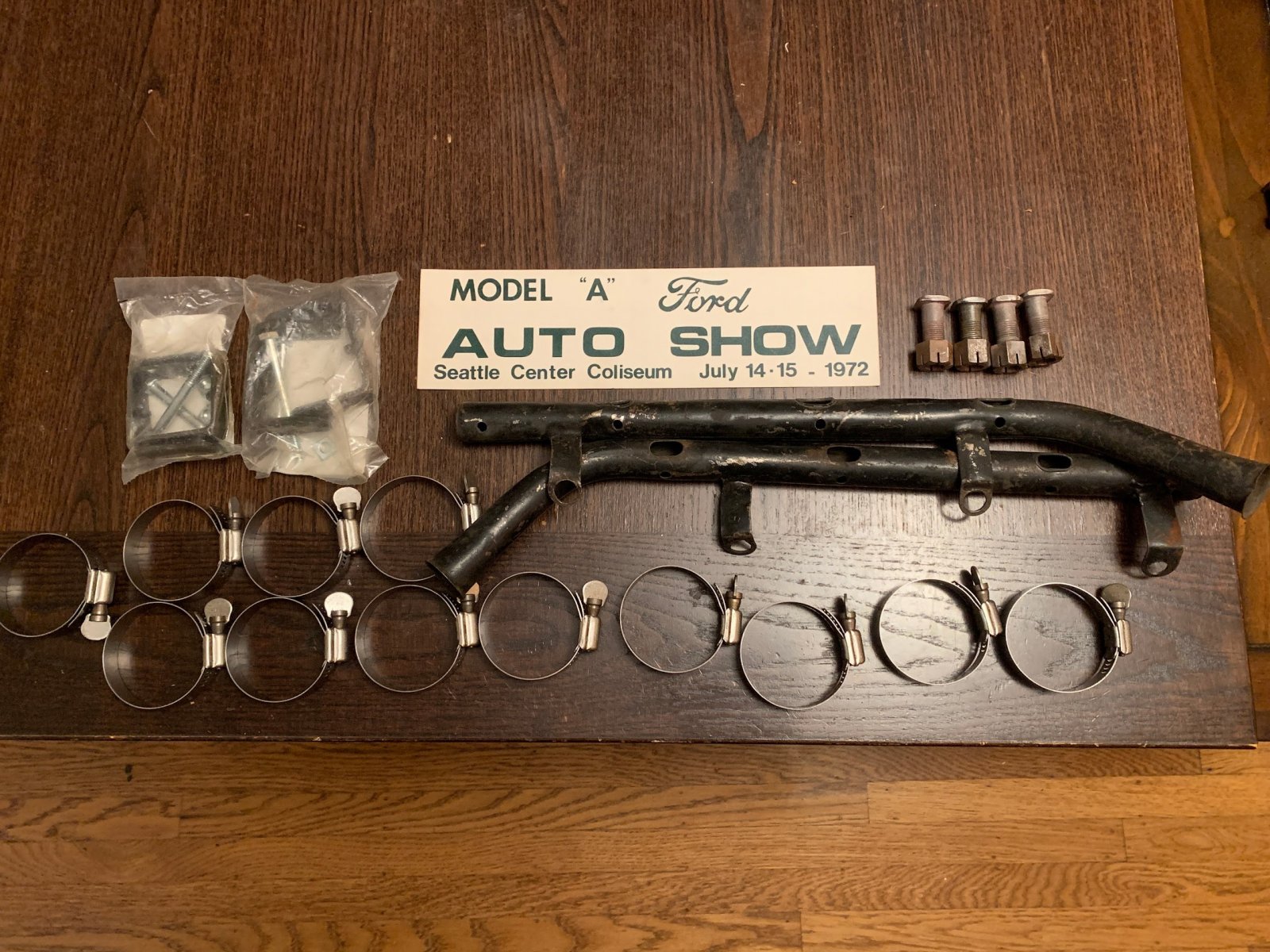

    Oh, and I got some absolute treasure in the mail from @Hitchhiker. It's feeling like Christmas around here. The thumb-turn breeze clamps are going to be absolutely perfect for my setup. It's going to be exciting to put them on there!

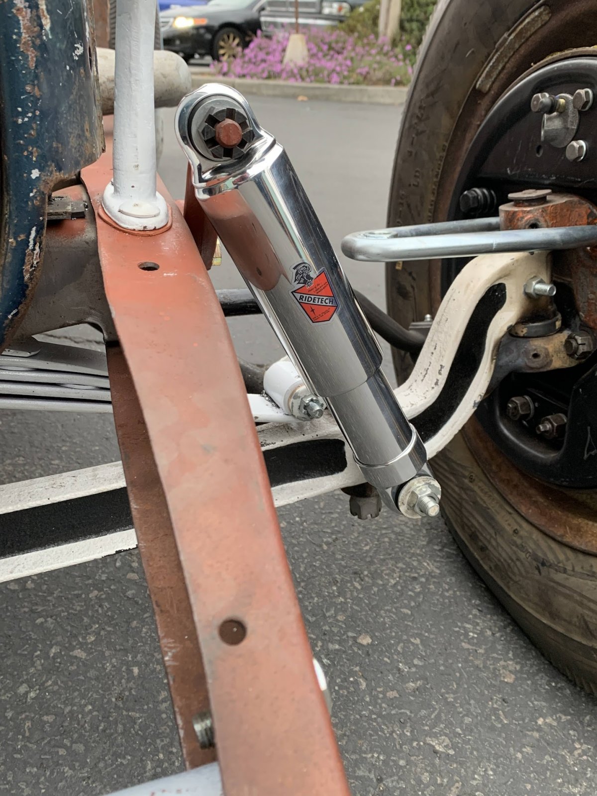

    :rolleyes:...Oh yeah...that steering arm and the upper zerk on the spindle...that is one of those little headscratchers...that's near identical to mine...I've got an elbowed stack of fittings to get grease in there...
    I've seen the arms curved down following the axle which surely affects the angles of the pitman and possibly improving access to that nasty access point...note I said possibly...
    ...that just happens to be a place where grease is also hard going in on my ride as well just to complicate the adventure...I think the bushing might be off a bit sort the fill hole might be askewed but it does let some in...
    Any thoughts, plans, on that not so great sum of Ford parts?...

    Well, you could take a few things apart. Drill a new hole in the axle king pin area in the middle of the seeing arm. Then tap it and use a 45/90 zerk pointing up or down, whatever will be easier to access. Plug the original hole.
    Edit: I meant to add I’ve a similar set up on an axle for my ‘57, who ever put it together used a straight zerk, the knuckle head just needed to use a 90 pointing up or down.

    Thanks Budget, perhaps I can find another 90 zerk that can get in there...they may not all be alike...the suggestion of a reposition is a great idea as well...I suppose that may entail a bushing rotation to align the grease hole or path...not sure what's in there...maybe both...
    One good thing though is I see some grease coming out even though it seems difficult going in...and I do jack it up and move the steering to ***ist...
    Actually I think the 90 went in there was a conflict with the grease head fouling on the space between preventing it from going on...

    I’ve never done king pins and bushing by myself, but bought new bushings for a shop to replace. I took everything apart and just took the axle and bushings in. I don’t remember anything other that the locating slot on the king pin though.
    I was thinking, in your situation what might work would be drill through, tap, etc. then use one of those small curly looking deburring tools to clean the inside of the bushing up, through the new hole.

    Very nice setup! Once we get the steering components in position, we'll be dropping that steering arm, hopefully allowing for an elbow zerk.

  17. Hitchhiker
    Joined: May 1, 2008
    Posts: 8,507
    Hitchhiker

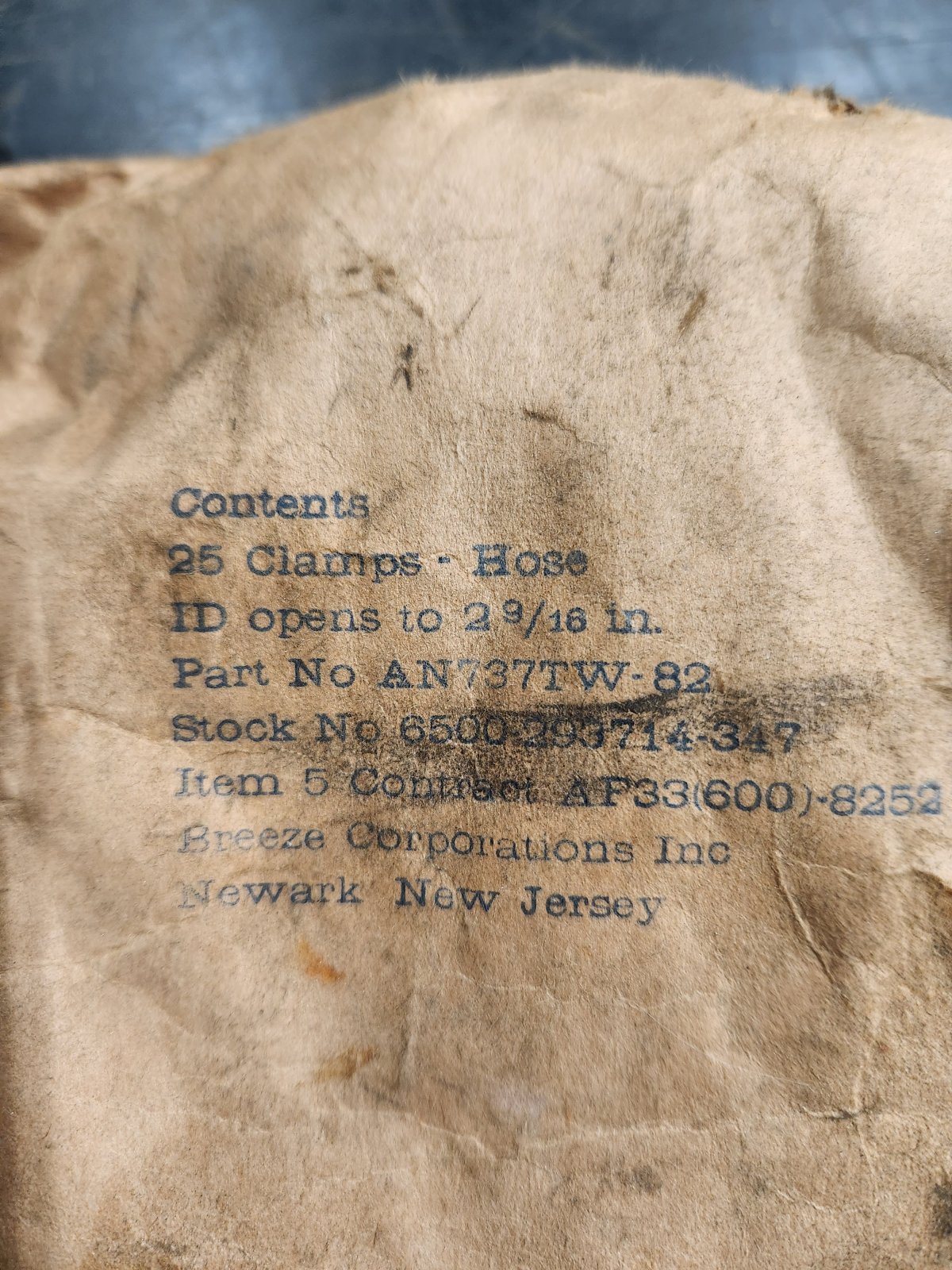

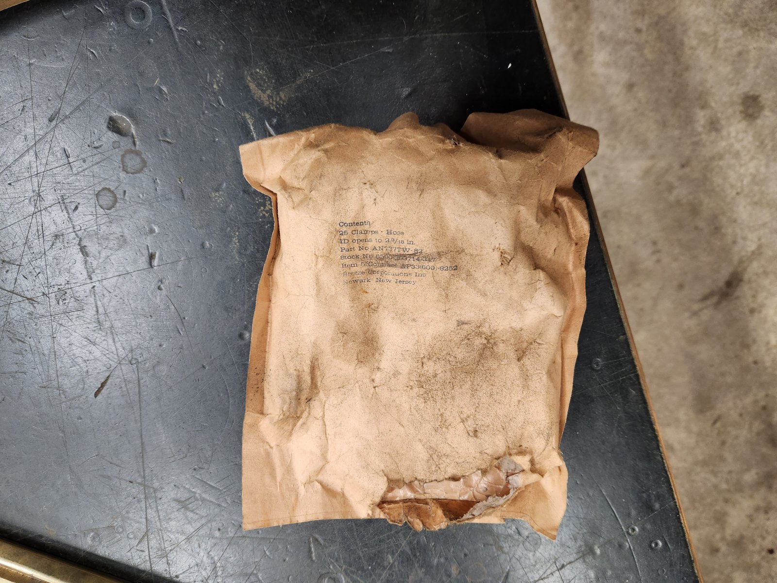

    Joey, those clamps waited a lot of years to wind up in your hands. I honestly would not have sold them to anyone else on the planet. But when we were talking, I realized they would be perfect for your car and would be a cool little link between my truck and your roadster.
    This is the bag, that they were in when I acquired them almost 10 years ago. It was unopened when I got them.
    Seems fitting that they end up on your car. It's the little things that all add up to make a car special and I think yours is on track to be stellar!
