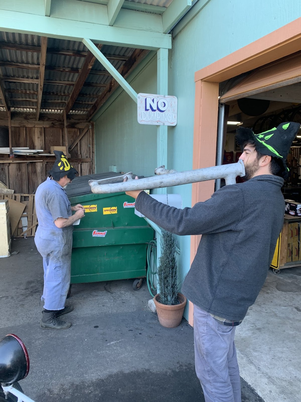

    As he worked on the headers, I focused my attention to the cloth-wrapped wiring. Just like on the last version of the car, I stressed every connection to make sure the wires all looked—and functioned—as they should. Oh, and we made sure to have a little bit of fun along the way.

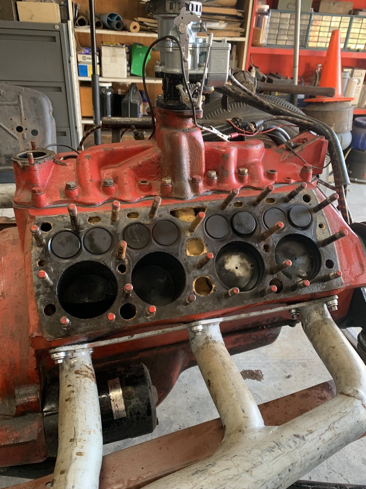

    That's when it really hit me. This engine is seized. Completely locked up. My mind began to race. "How did this happen? What did I do wrong?" David suggested that maybe it was just stuck for sitting and that pouring ATF down the cylinders would help free it up. So that's what we tried.

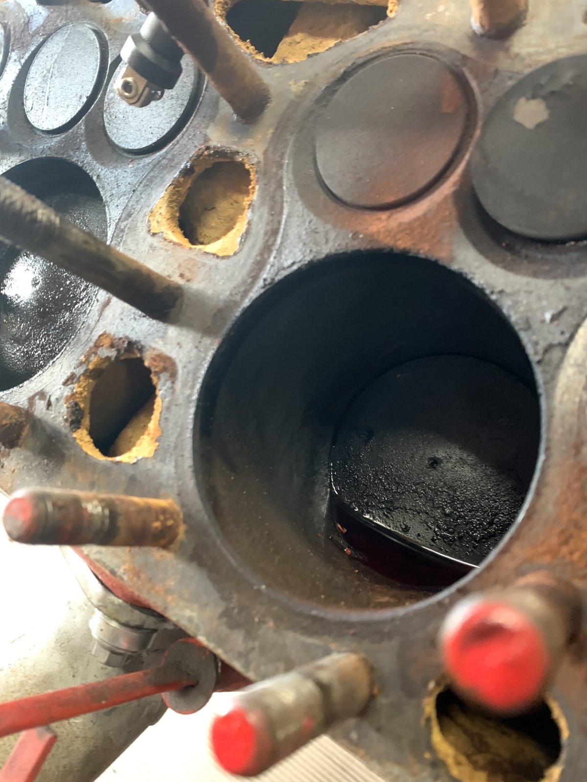

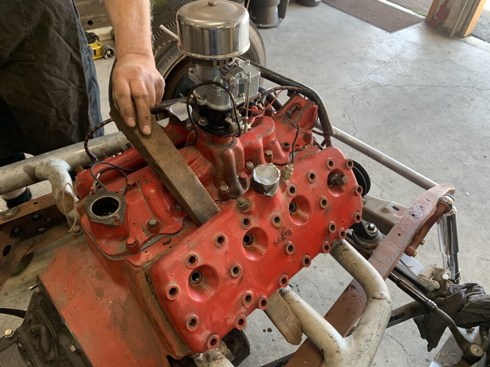

    After, we pulled the heads. The p***enger side put up a hard fight, but we managed to break it free.
    As you can see, we used a wide variety of tools.
    Including ones we made ourselves.
    But in the end, no matter how much ATF we used, or how much we hit them with a hammer and wood block or breaker bar on the crank nut, nothing would budge.
    I pulled the other head, for posterity's sake. Same story.
    IMG_9627.jpg So it goes.
    But the story isn't all bad. I called the seller, and he said I could still return the engine for a full refund. I plan to do that soon. In the meantime, I've been searching far and wide for a replacement. I have a line on a few, and I'm looking forward to seeing what I can come up with.

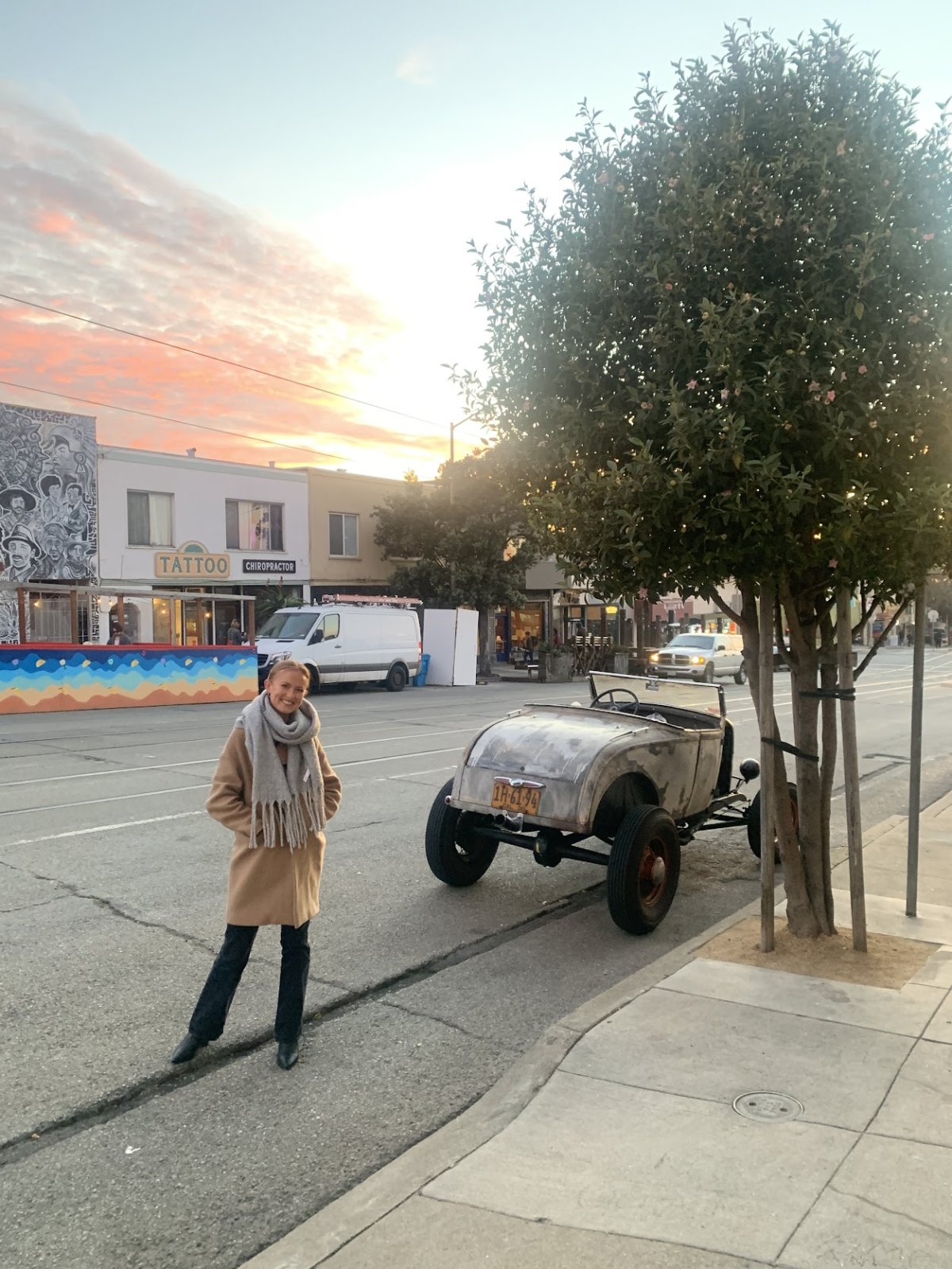

    My girlfriend Gen and I hit the town on a crisp San Francisco night, cruising to the Sunset for dinner.
    And taking whatever opportunities we can to put miles on this thing!

    Before you give up on the V8 check the flywheel bolts to make sure their the correct length. Longer ones would bind the crank.

  20. There is nothing jumping out at me about that engine being seized by the pistons, I would second the option to check for fly wheel bolt interference or a sticky valve. There are not many places on a flathead to check for a mechanical hangup so definitely don't tear it too far down yet. I would also get a peek at the timing gear set to make sure all is good under there because of the multiple starter hits you guys performed. If it has a fiber gear throw on an aluminum one.

    Focus on TROG the Petaluma Princess will sort herself out. Meanwhile keep it soaking clear up to the bottom of the throttle plates with 50/50 ATF/paint thinner.
    Not to rub salt in your wounds but didn't you see if it turned over when you bought it? You are way too trusting. Yeah, I'm rubbing salt in your wounds. :p Did it have the flywheel on when you got it?

    The pics of the FH, look like either a ring over the piston, or too land peeled off. Regardless it has to come apart.
