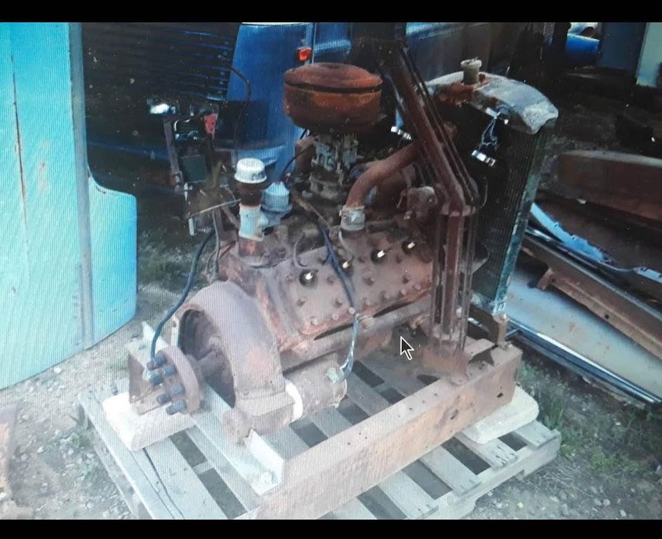

    I saw that. I have a strong lead on a 59AB in SoCal. I'm going to check it out when I head down south for TROG. Thank you for the heads up!

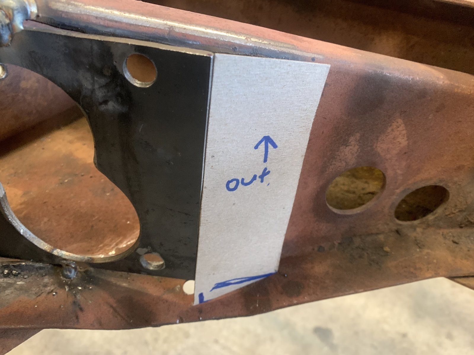

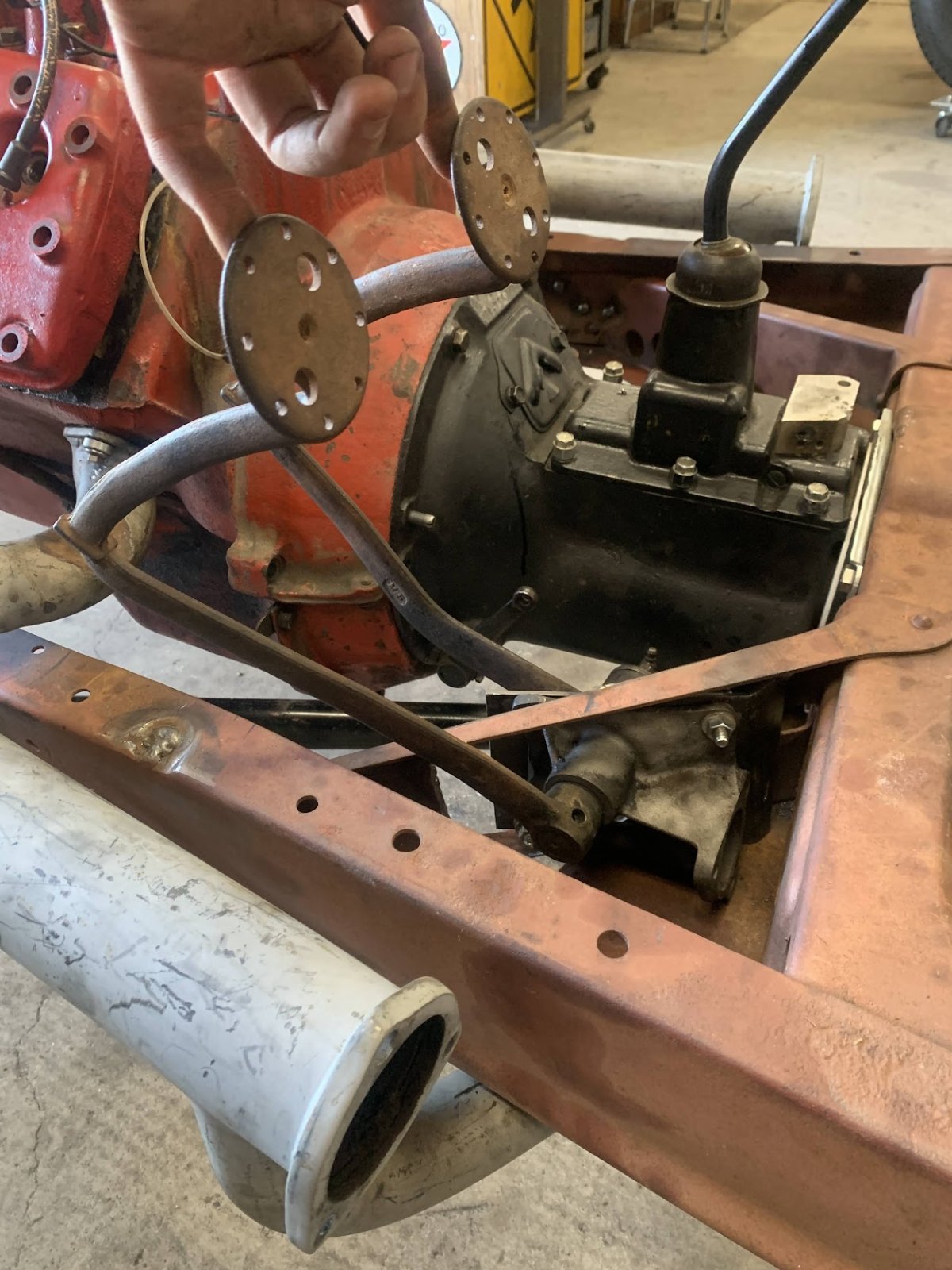

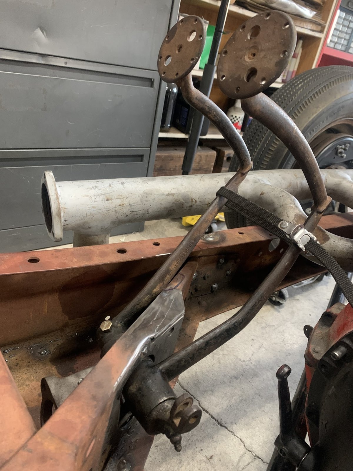

    Yesterday morning, I pulled up to the shop with a clear goal: take on a task where I knew we would succeed. We weren't thinking about the engine—we were thinking about the big picture. With that, we shifted our focus to the pedals.
    It felt good to revisit the pieces that I had been working on a month ago. The 10 gauge frame plate, the sandblasted pedal bracket with threaded holes, everything. With David's help, we worked it into position and tacked it in place.

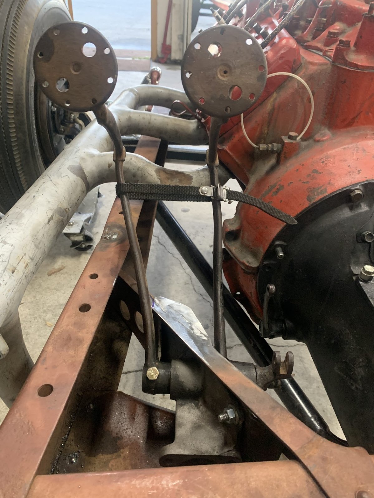

    I welded as much as I could. I'll finish the final pieces once the engine and trans are out.
    Looking solid!
    We then bent the clutch arm to align with the pedals. This will be fine-tuned when we rebuild the transmission.
    As the sun set over Petaluma, I felt good about the day's progress. The pedals are in place, and we're one step closer to getting this car on the road.

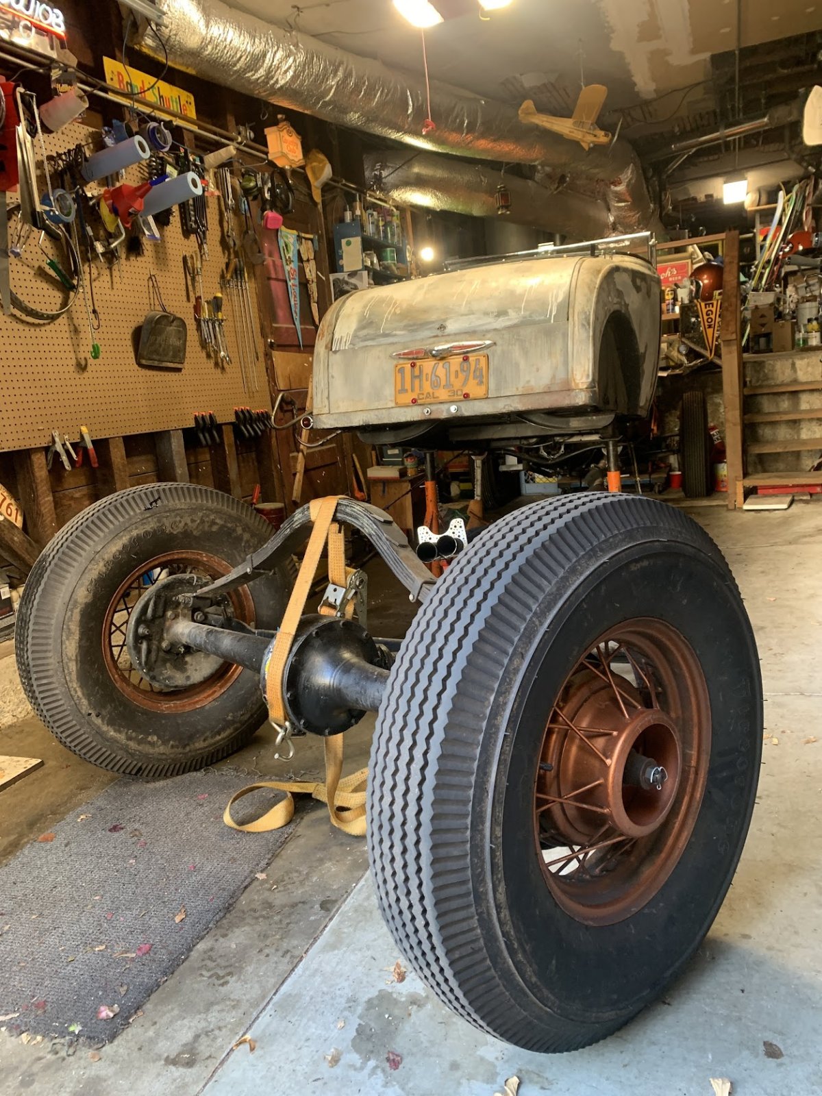

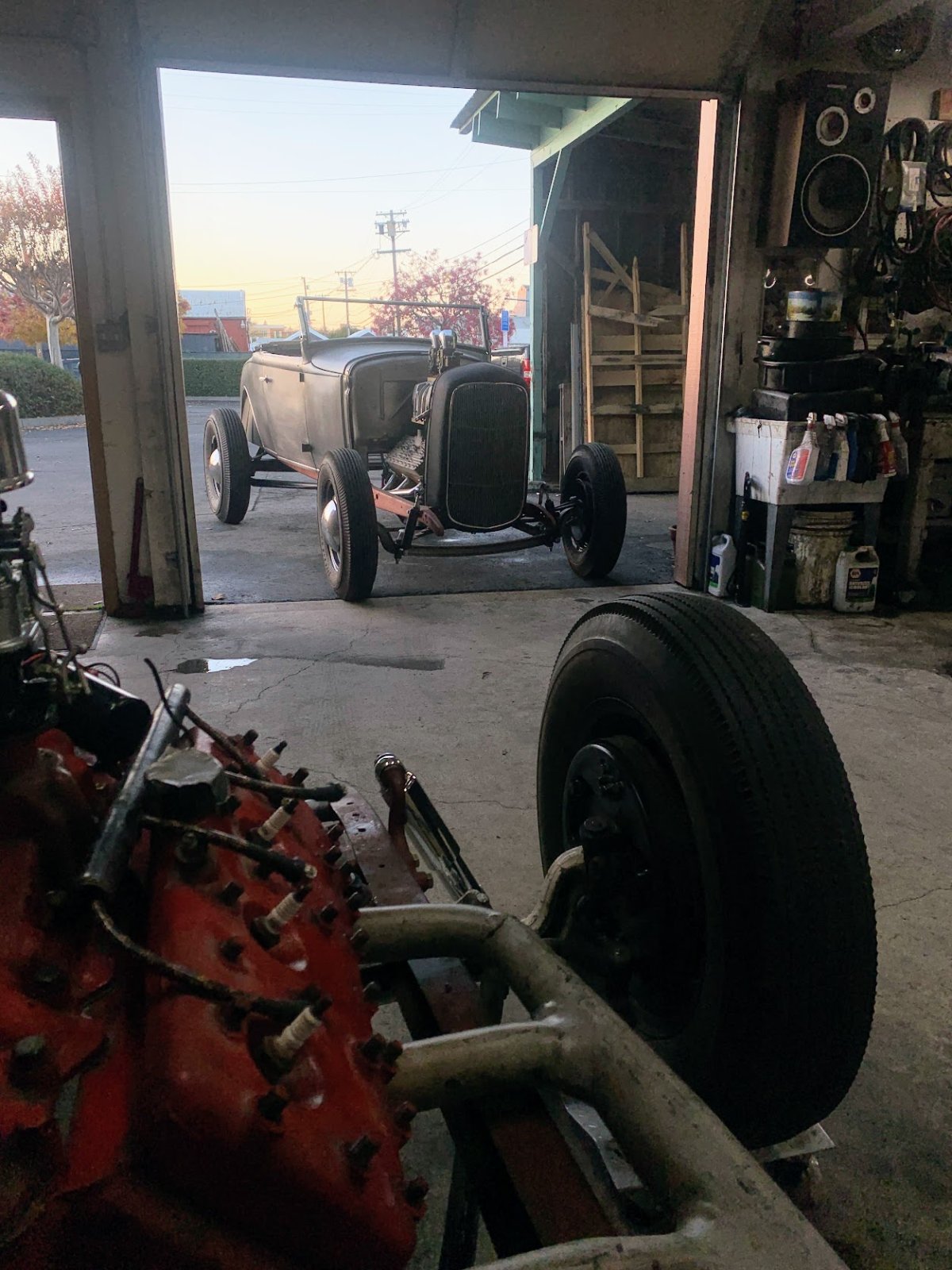

    Today was my day to get stuff done. It was quiet on the cul-de-sac, and it felt good walking down the front steps into the warm late fall sunlight. After reviewing Les Andrew's Model A book, I started removing cotter pins, organizing hardware and pulling the car apart. Sonny and the Sunset's album "Longtime Companion" played in the background.
    Soon thereafter, I slid the rearend out from under the car. Success! With the complete ***embly removed, I cleaned the clamshell and submerged all the necessary hardware in the ChemDip bucket.
    Even though I've taken Version 2.0 apart dozens upon dozens of times, this was the first time I've taken the rear out of this one. I'd chalk today up as a victory.

    I've heard rumors of those engines and, as a matter of fact, was texting with Keith Tardel earlier today.

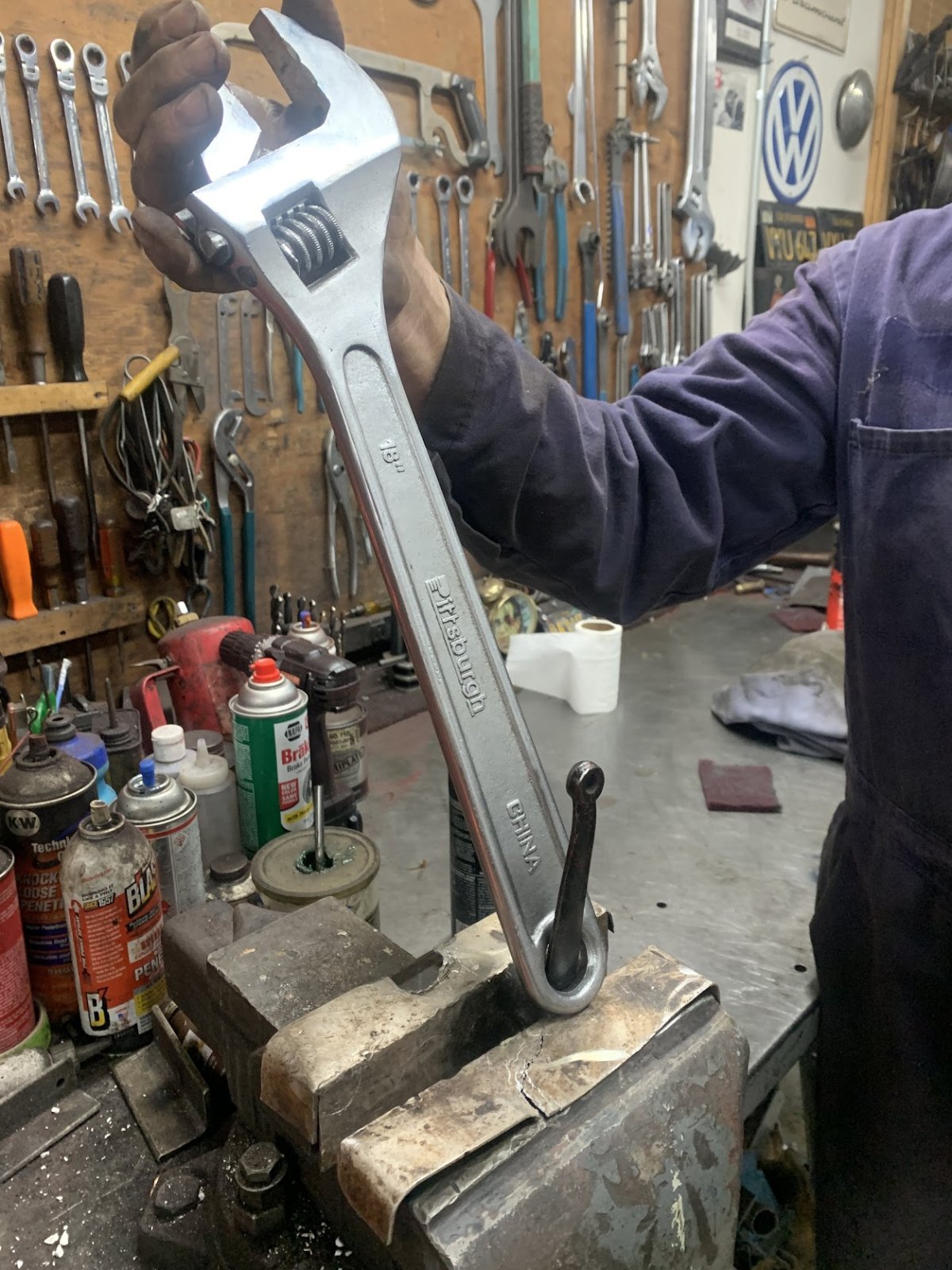

    Perspective can be a funny thing. Definitely thought this was like a 4' wrench, until I saw the giant of a hand holding it.

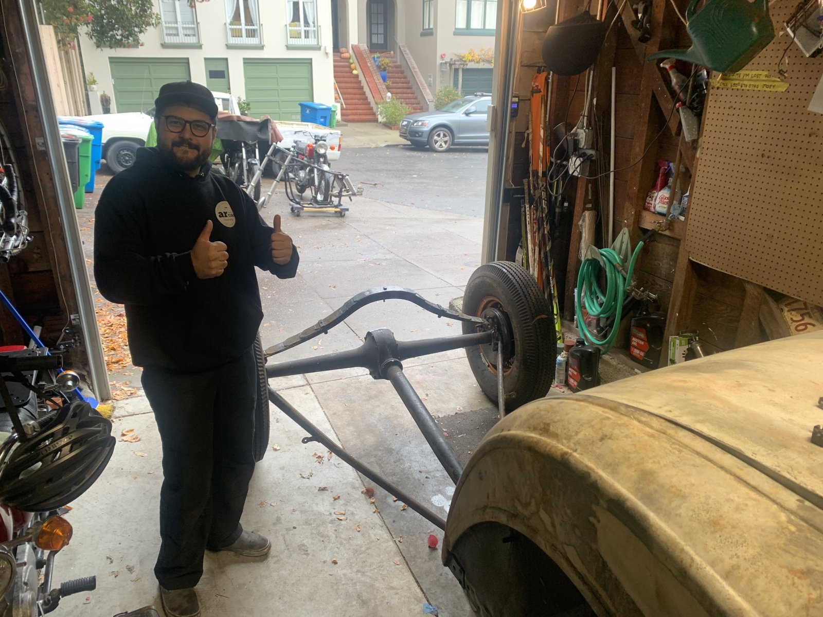

    Yesterday, I made the trip to Petaluma to meet up with @Jeff34 and pick up the replacement rearend. As I backed into his driveway, I saw his '34 pickup, which has been in his family for years. (When I have some more time, I'll see if I can dig up the RJ Times coverage of it from one of the Northern California Reliability Runs). The truck sports a warmed-over flathead, complete with dual carbs and Edelbrock heads. It sounds healthy and runs even better. IMG_9878.jpg
    After checking out his in-progress "Flathead Flathead" roadster, we rolled the rear out of the garage. IMG_9881.jpg
    Using some strategic maneuvering, we managed to load it in the back of my truck. Even with two of us, it was still pretty heavy.
    With that, I thanked Jeff for his generosity and I was on my way. Friends helping friends—this is what hot rodding is all about.

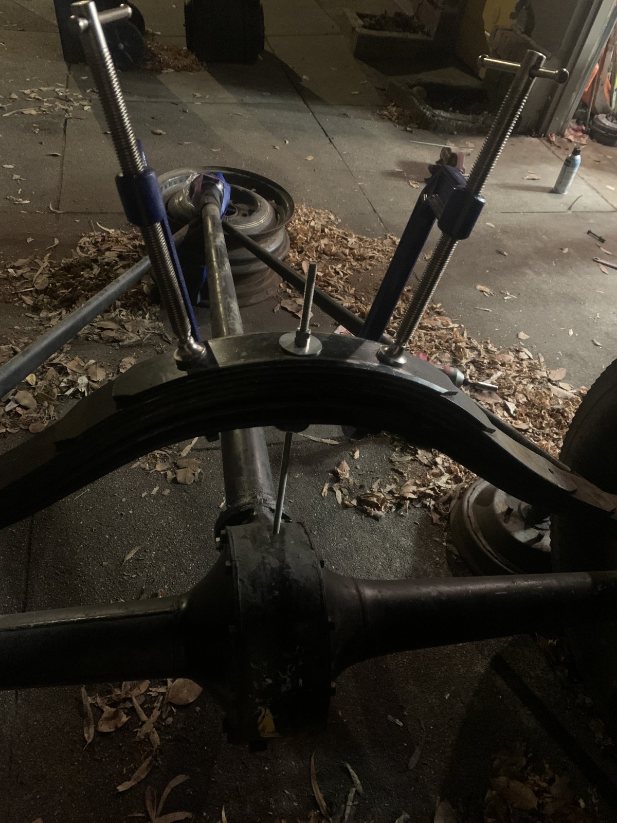

    With the rear still in the bed of the truck, I dis***embled the leaf spring pack using heavy-duty C-clamps and all-thread. I'll be off camping tonight, but I plan to start re-***embly tomorrow after work. Oh, and Jeff also lent me the fabled cornhead grease, so the clamshell will be a-okay. I'm looking forward to putting the pieces back into position.

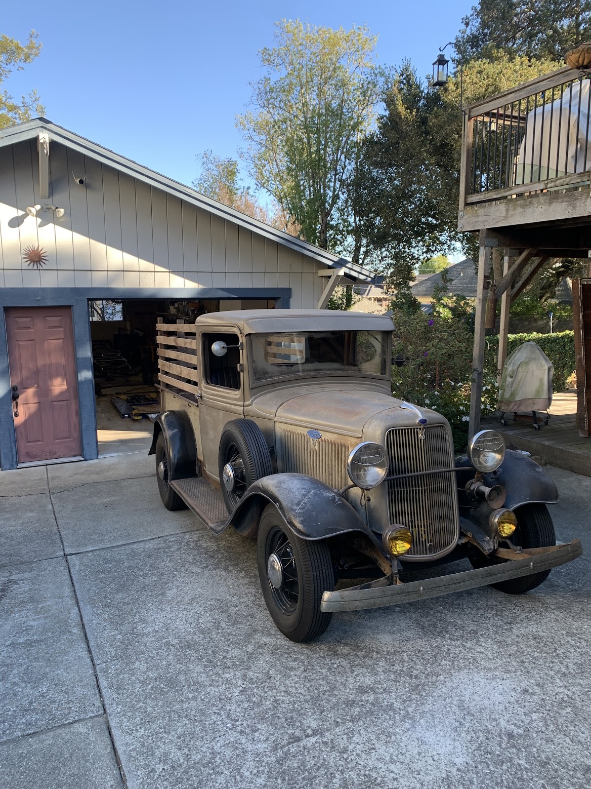

    The Hudson belongs to Rich, a neighbor of mine. He owns that as well as a Ford T-Bird. I think he spends more time working on old airplanes out at the airport hangar than cars, though.

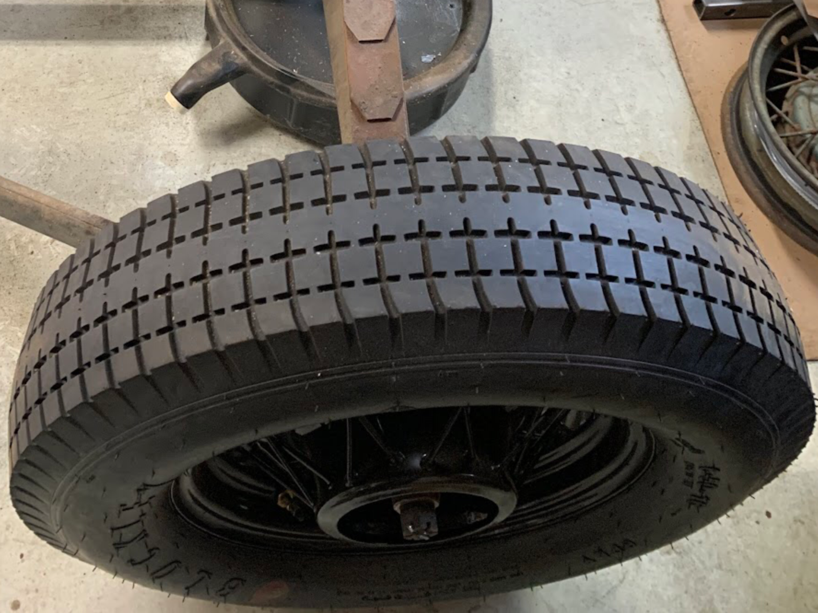

    Where can you get those tires? Looks like the could be made to look like dirt track tires real easy.
  26. Jeff34
    Joined: Jun 2, 2015
    Posts: 1,245
    Jeff34
    Glad to help him out. I just hope the banjo works for him at TROG!
    I bought them directly from Blockley:
    https://www.blockleytyre.com/
    Unfortunately, in the Crossply range, they only go as large as 6.50X16. That's the tire you see in the picture.

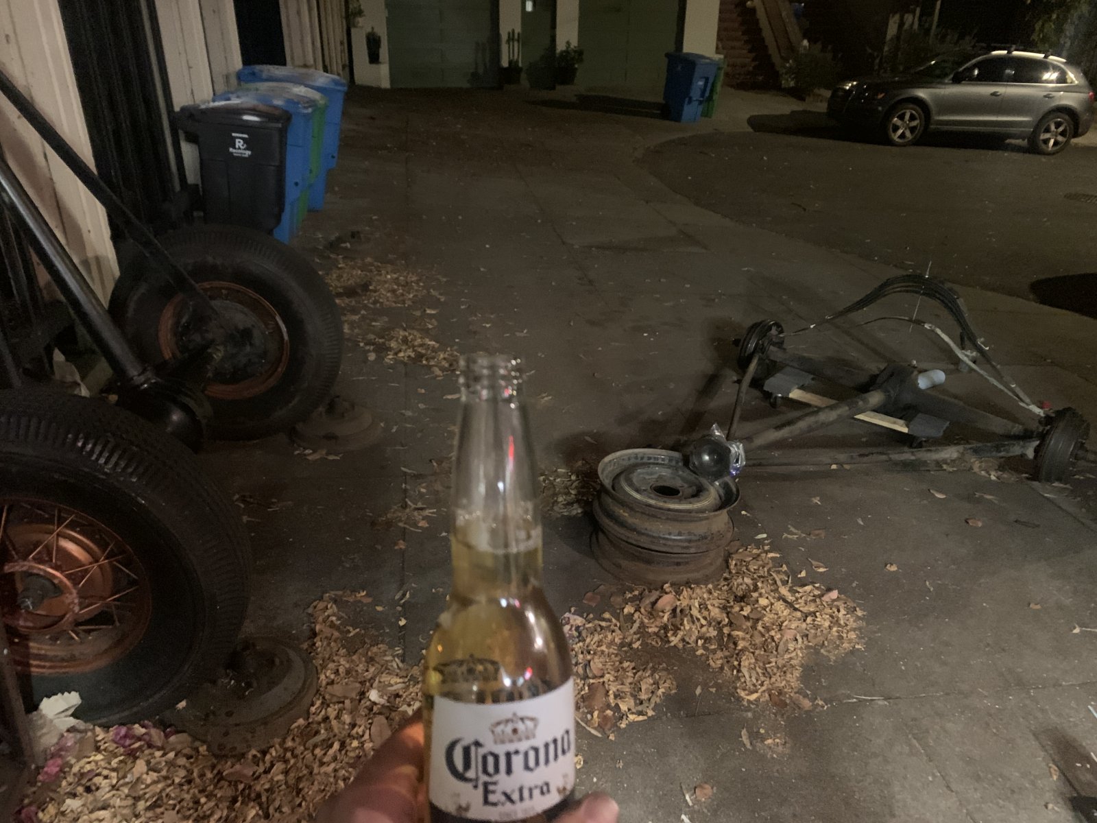

    Things have been busy with work, but I was able to dig into the rearend project on Friday night.
    Using the technique I learned at David’s, I tore down the old spring. Next, I greased the leaves with Lubriplate and transferred the seven-leaf pack onto the new rear.
    Sometimes I forget that not everyone works on projects like this on Friday nights here in the city. As I was moving axles, a stranger walked out of the house next door. “What are you doing?” he said with a sense of wonder. “Working on my 1930 Model A to get ready for a race in SoCal next weekend.” He couldn’t believe it. “Can I look at the car?”
    As he walked into the garage, the whole scene didn’t seem to register. An old hot rod, seemingly levitating on jack stands, tools, and vintage motorcycles in a neon glow. “Thanks for letting me look,” he said. “I’m going to the liquor store—can I get you anything?” Realizing how much I still had to do, I declined, but thanked him for his generosity.
    When he returned, he handed me an ice cold Corona. I thanked him and popped it open. “Cheers my friend!”
    By the time I went in for the night, the new rearend was ready for the swap.
