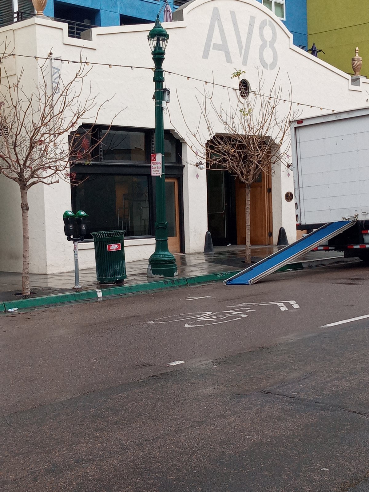

    I was in San Diego this week and happened to walk by the AV8 Garage facade.
    It is now the AV8 Apartments.

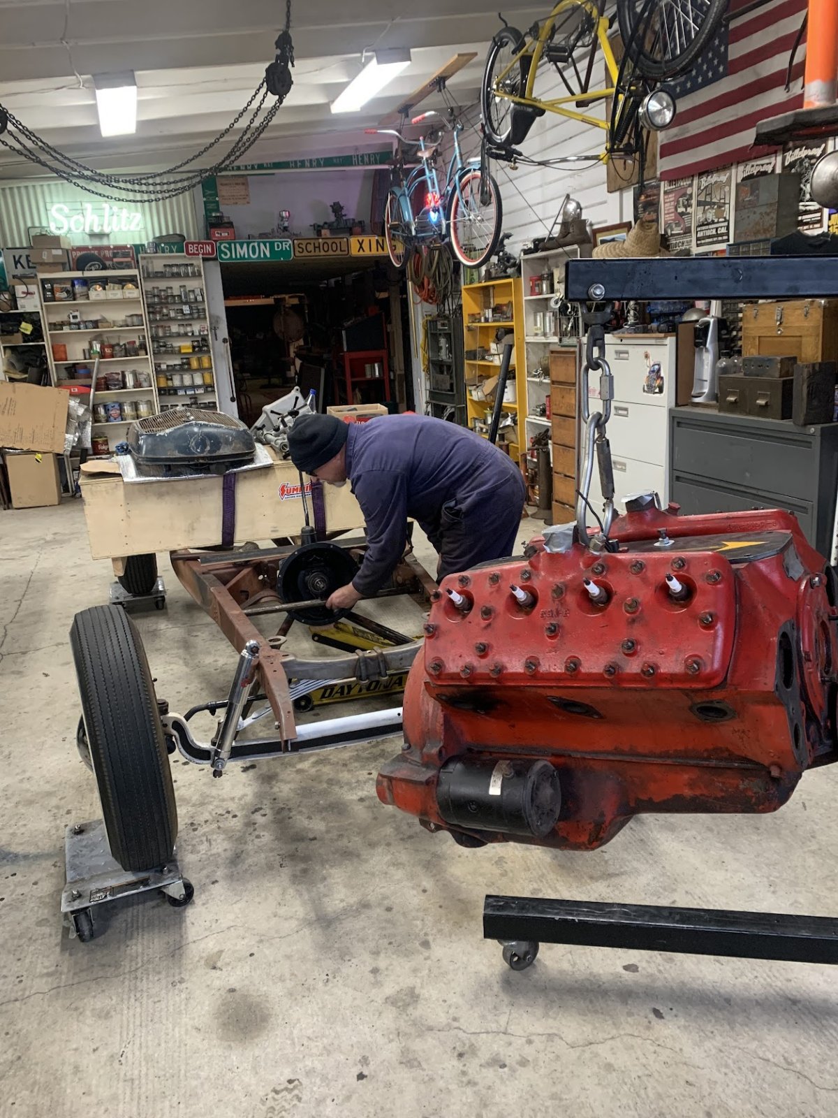

    After enjoying some delicious sandwiches from Petaluma Market, David and I pulled the roadster's old flathead.
    He parked his car outside to make room for the swap. This view never gets old!
    It still hasn't sunken in that I now have a running engine for my roadster. Next time I'm at the shop, we're going to pressure wash off all the external gunk and install the fresh water pumps. I'll bolt on my 2x2 Weiand intake, Strombergs and crab distributor. Then, with any luck, we'll get it ready to fire in the ch***is. That's a day I've been looking forward to for a long, long time.

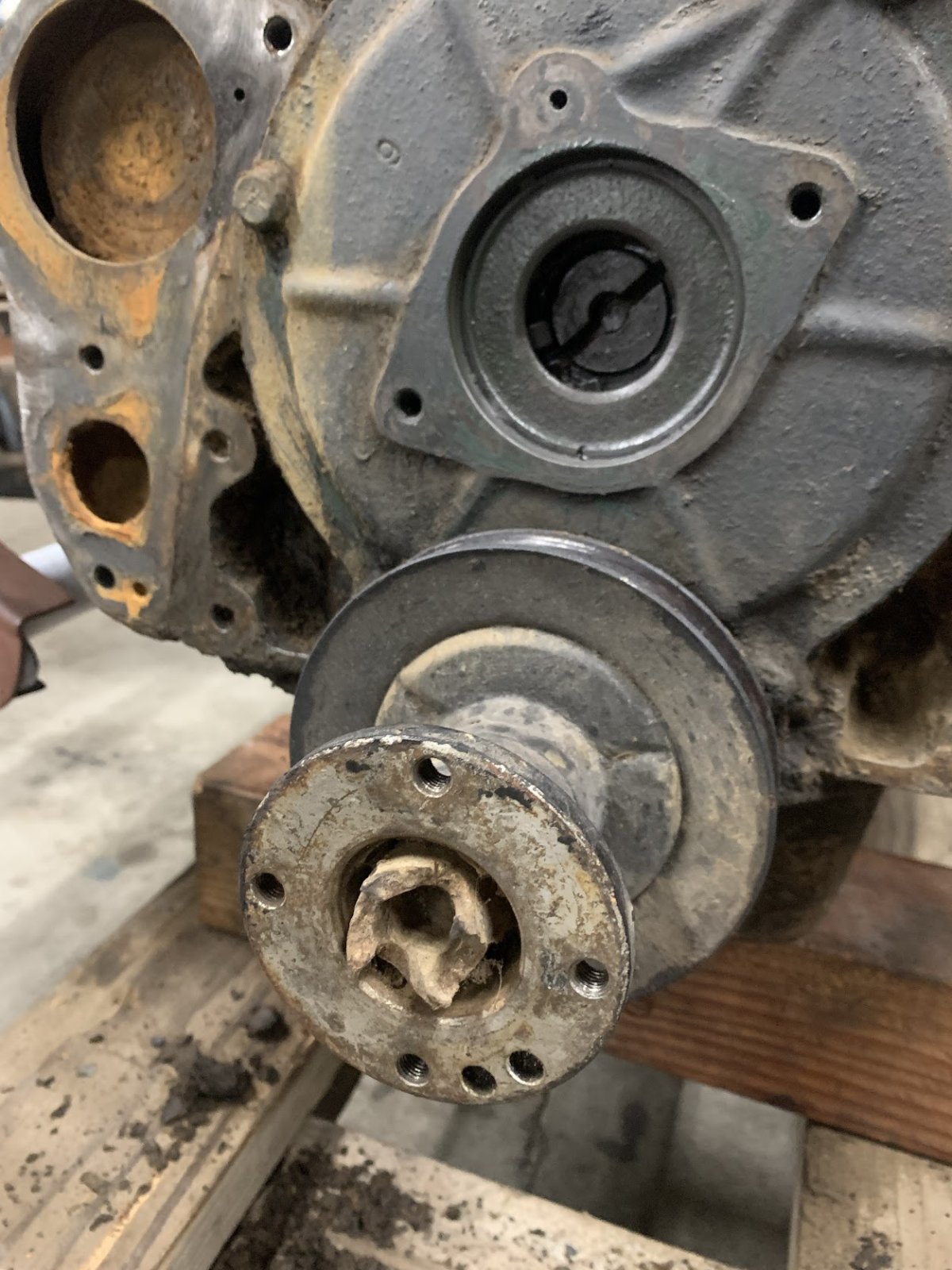

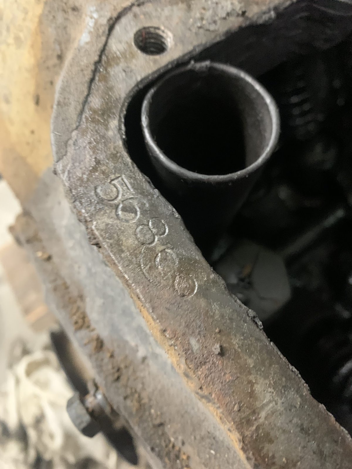

    Exciting stuff! The story goes that the engine came out of a 1940 Ford. From what I can tell, it's a 239 cubic inch '46-'48 59AB. IMG_0904.jpg
    Here are some identifying markings.
    And a closeup of the lower pulley.

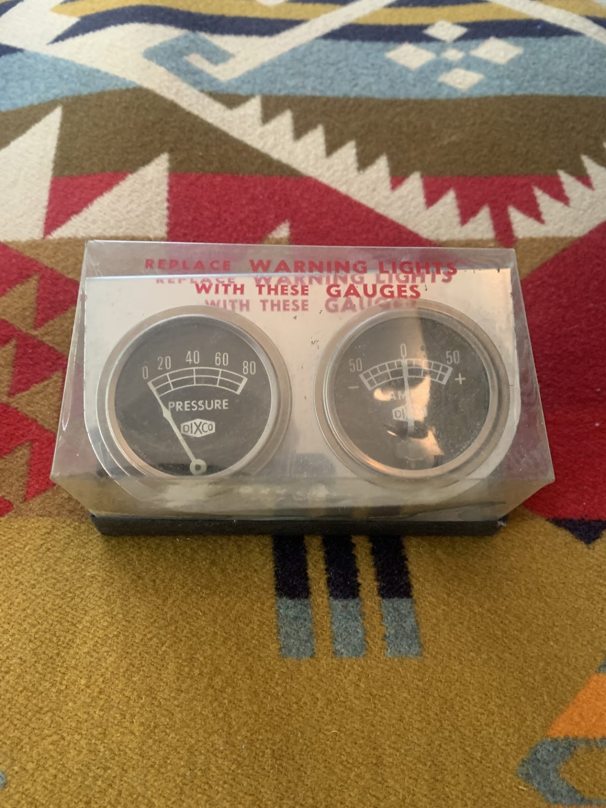

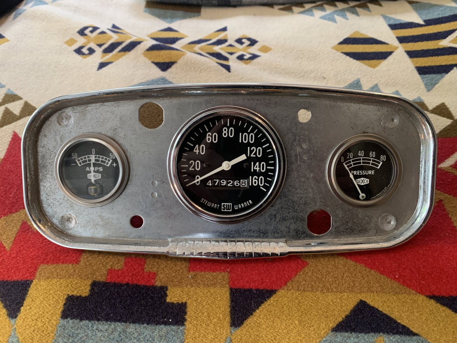

    Amidst the flathead excitement, I was able to do a little bit of behind-the-scenes work. Over the holidays, @So Cal Brian B texted me about a SW 160mph speedometer for sale here on the H.A.M.B. The condition was good, the price was fair, and I knew I needed a speedo for Version 2.0. So, I pulled the trigger. The seller, @fleetside66 made sure it arrived quickly and safely. Thanks, Greg!
    It's been a busy week. So busy in fact that I had the speedometer sitting on my desk for multiple days before I plugged it into my SW dash pane that I got from David. It's a perfect fit! I plan to add the ignition switch and possibly some jeweled indicators to fill the remaining holes in the panel.
    Oh, and see the Dixco gauges? Those are early-'60s NOS from the one and only @corncobcoupe. They've been on his shelf for quite some time, and he was gracious enough to donate them to the cause. Thanks again, Cob. See you in Des Moines!

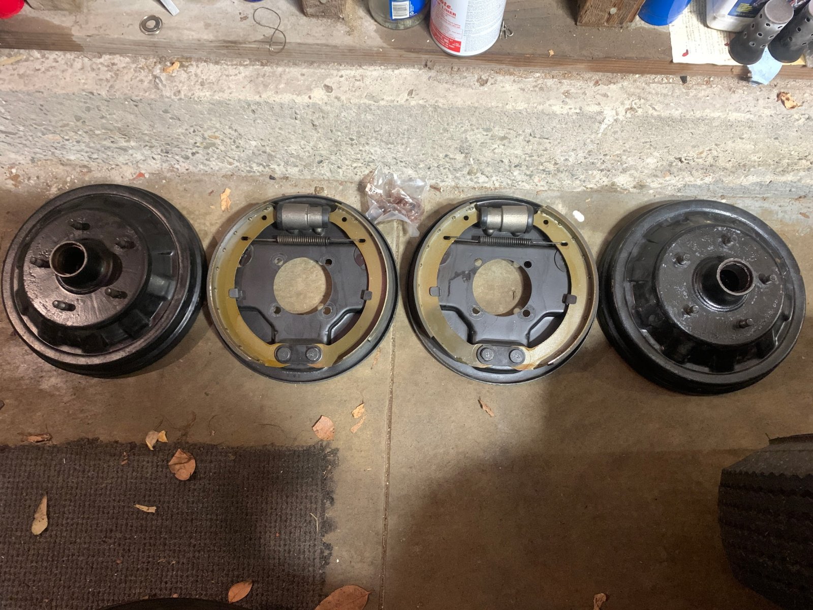

    During my daily Craigslist hunt yesterday, I came across a set of juice brakes taken off of a flathead-powered 1932 Ford highboy. The owner was upgrading to an overhead V8 and wanted Lincoln brakes, so he put these up for grabs. The drums I have on my car still need to be turned, so I figured this may be a good way to save money and keep the ball rolling. IMG_0940.jpg
    So, after work, I made the hourlong drive to Livermore. I had no issues with the backing plates and related components, but I did see a slight s****e on the inside of one of the drums. Since I had already driven that far, I figured I'd make an offer. The seller accepted, and I brought them home.
    After sanding the inner drums, I'm starting to think I might have acted too quickly. They're nice, no doubt, but there's a chance that they'll have to be turned too. I can barely feel the s****e when I run my finger over it, but I know it's there. I'll measure the drum size when I get to the shop Saturday. Worst case scenario, I'll have some good hubs, fresh bearings and loaded backing plates for sale.
    The past week of the build has had its ups and downs. You would think that at this point I would have a grasp on what to buy and what to leave behind, but this is just a reminder that I'm still learning. With the highs, lows and in-betweens, I'm doing everything I possibly can to get this car on the road—even if that means potentially making mistakes along the way.

    I’m sure DiFalco will tell you the drum is good as is. I’ve only had drums turned when I can feel them being out of round/warped.

    Great to know. I'm going to bring them up this weekend for a full inspection.
