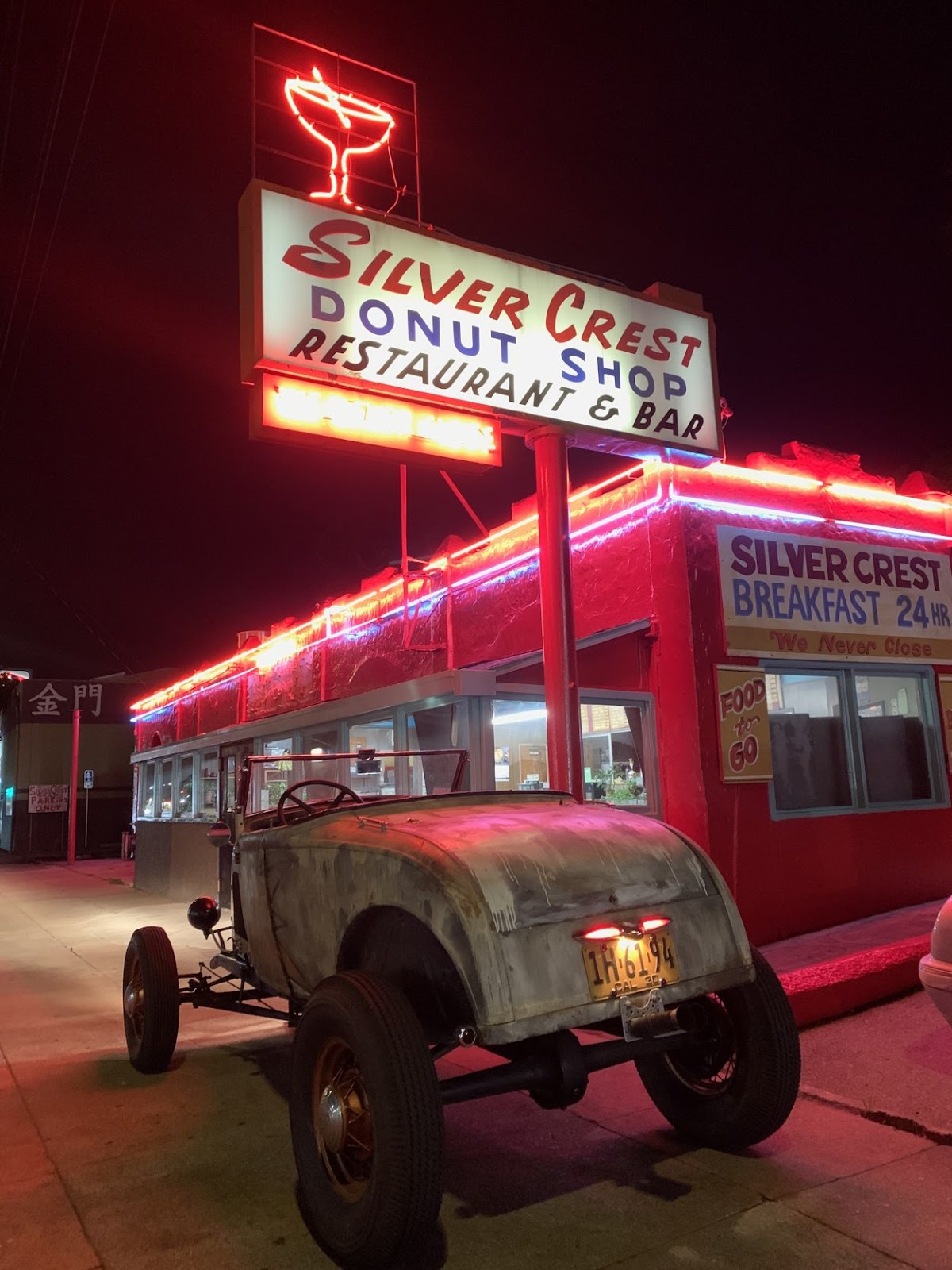

    A postcard from tonight's adventure. I'll share the full update tomorrow.

    Those are 40-42 hubs/drums right? Boling Brothers is supposed to make the best reproductions (no experience, jus HAMB reading) but not cheap.

    Thank you so much for thinking of me. As of right now, I have two front drums that measure 12 even and 12.010 that I bought from a local Early Ford club member. They may need to be turned. My plan was to get these other drums to avoid the turning process all together, but that clearly didn't work. I'll let you know if the two existing drums don't work out.

    Great photo !!!

    Killer shot! Love that license plate light!

    The "947" roadster, is always attracted to neon drenched places of history and culinary adventure, with just a touch of late night danger and gritty city " NOIR "
    When I saw this picture you shot of the Silver Crest Donut shop, I said to myself, there has to be more to the story of this place, so I did a little digging on the net, and indeed, there is a rich history to this late night hangout.
    In the publication " SFGATE " June 10, 2009, author/journalist Chris Colin wrote an article on the Silver Crest, ***led
    24-hour donut people / Four decades on their feet at the Silver Crest.
    WOW !
    This article is exactly the style of writing that captures the heart and soul of this place, this article will give you the lowdown on this vintage hangout.
    I encourage you and anybody else that loves to peel back the Formica, to see what makes it stick, this is a great article.
    Put on the Tom Waits album " Nighthawks at the dinner " Que up " eggs and sausage " and read this article, its guaranteed to put a smile on your face!
    The next time I am in San Francisco, I will definitely go check out the Silver Crest.
    Other places listed on some of the revues were
    " Orphan Andy's "
    " Grubstake "
    " Mo's grille "
    " Saint Francis Fountain "
    Thanks for staying up late at night and touring the gritty underbelly of the City by the Bay!
