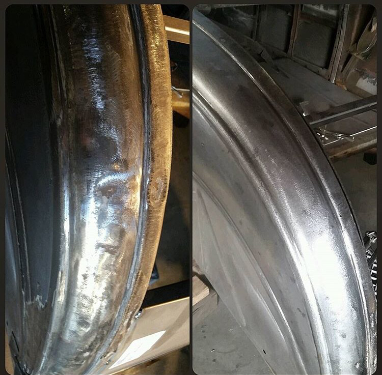

    ImageUploadedByH.A.M.B.1452994117.467210.jpg when I bought the 30 (online) it had advertised new inner fender panels -- but it looked like someone had welded it with toothpaste. Skoty hand made these recess inserts. Looks so clean now -- almost a shame to paint them -- I am at least $2k in new metal for this build so far
