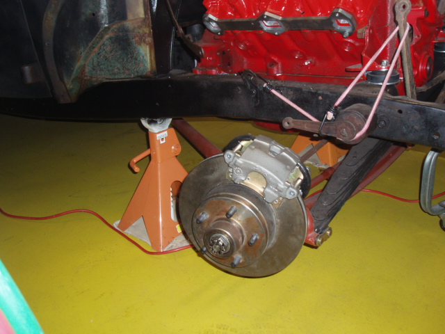

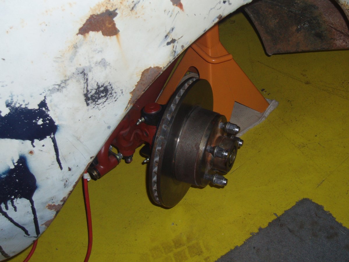

    I found a couple of pic's of the disc brake setup that I used.

  18. Kan Kustom
    Joined: Jul 20, 2009
    Posts: 2,746
    Kan Kustom
    Thanks for the pictures. I bought a new Speedway kit with Ford bolt pattern rotors and GM calipers because I haven't figured out what kind are on the car now. They look like some Mopar ones that I saw a guy selling awhile back. To me they resemble the look of my Daughters 77 Vette but smaller. Not a big deal, just makes me curious since they were on there so long. Made me wonder what guys were using back then. Whenever it was that they were installed. The rest of the car looks like it was built in the late 50's or early 60's. 49 Ford inside handles. Ashtrays brazed shut. 57 Chevy rear end. etc. Just speculation.

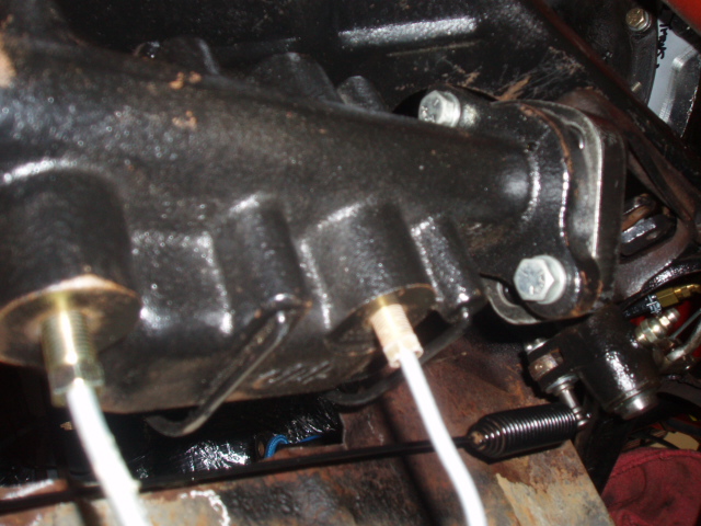

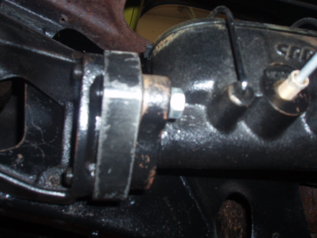

    Got an adapter from the Sachse Rod Shop which allows mounting a modern dual reservoir master cylinder on the '40 ford brake pedal bracket so I can retain the stock pedals. 003.JPG 001.JPG
    catdad49, loudbang and 62hotcat like this.

    Here's pic's of the install before I installed the springs. I used a Posies spring kit.
    Even the brake backing plates are chrome!
