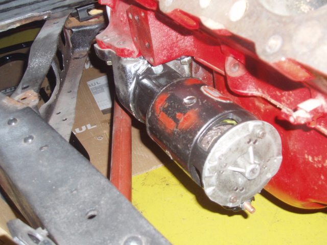

    Is that a chrome plated starter switchover down there? Cool

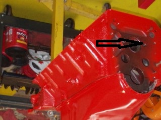

    Also, what did you put in this hole here
    Suppose to a special bolt with a small hole to allow oiling of the chain. Often overlooked unless you have done these Olds engines before:rolleyes:

    Good eye Paul. Yep it's a chrome starter change over. I modified the solenoid position, on the stock starter, and
    mounted it upside down to get extra clearance to the headers. SidePipes2 003.jpg SidePipes2 008.jpg
    Kind of a hokey link, to the starter gear engage lever, but it works!

    Yeah I'm aware of that special bolt with the oiling hole. Actually I think I posted a notice about that, on one of the Olds Rocket threads on here, recommending that you should collect and preserve that piece as well as the plug in the rear of the oil gallery that oils the distributor gear, which also has an oiling hole. The machine shop that does the vatting, cam bearings and freeze plugs are likely to send it back with solid plugs if they don't know. Obviously you already know this Paul but I'm restating it for inexperienced guys to see again.

    Jim, you would not be the first to overlook it. Usually the machine shop overlooks it and plugs it and then it is easy to ****on it up. Just one of those "gotcha deals":rolleyes::rolleyes:
