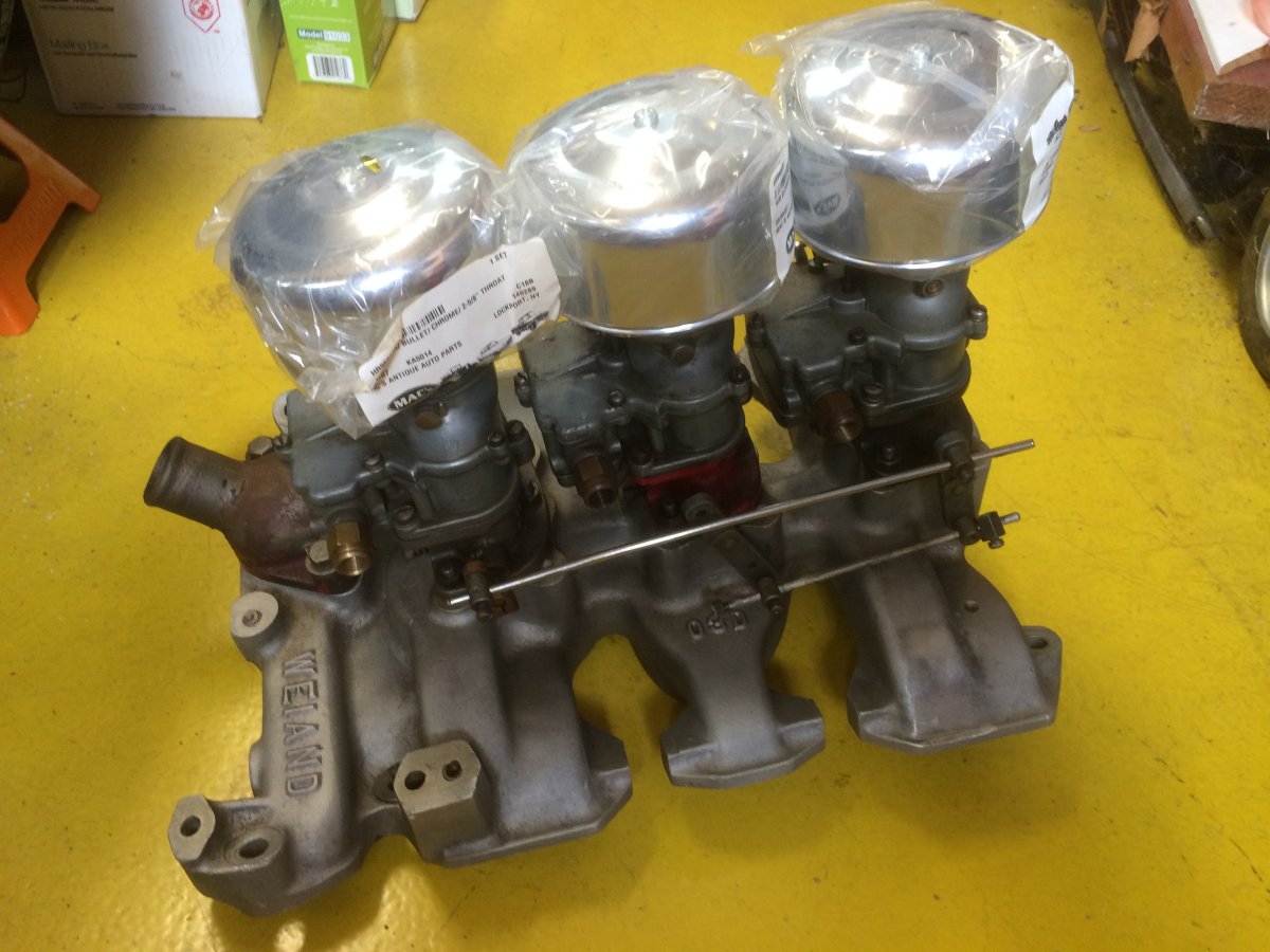

  4. How amazing is that! So, is that a small port intake then? I know that the Edelbrock Ol396 came both ways, small port for the 303 and larger for the 324. I port matched my OL396 to the #10 '56 heads as it was off quite a bit but had enough stock to allow the mod.
  5. blackrat40
    Joined: Apr 19, 2006
    Posts: 1,167
    blackrat40
    Yes the Weiand is a small port intake. I wouldn't want to modify such a rare old part. I have made a great effort to avoid any significant modifications to this '40 coupe so that it can be restored to original by some
    car lover after I'm gone. After all, this is my 4th '40 Ford coupe. I think I've had my share!

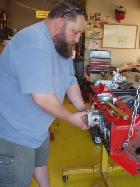

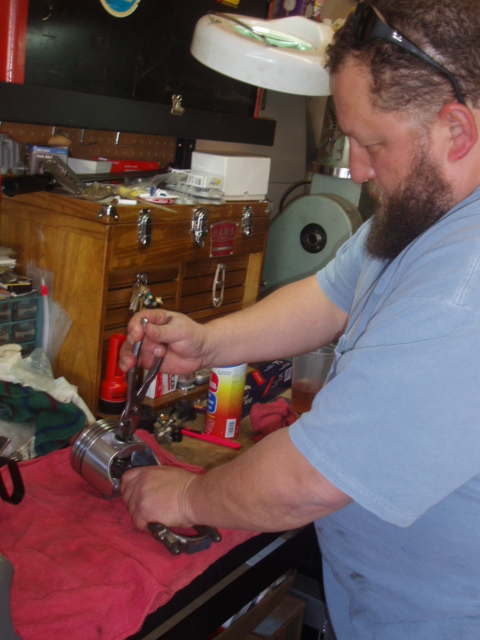

    Time for short block assembly of the 4" over-bored 324. ShortblockBuild 024.jpg
    Piston going in.

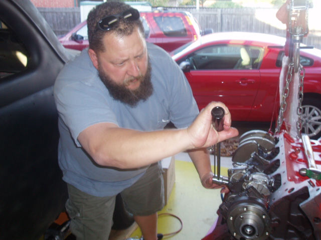

    ShortblockBuild 008.jpg Torquing the mains with the assistance of my nephew Bob.
    Bob getting his first experience at engine building.
    First time piston assembly! (Note H.A.M.B. tag on machinists chest).

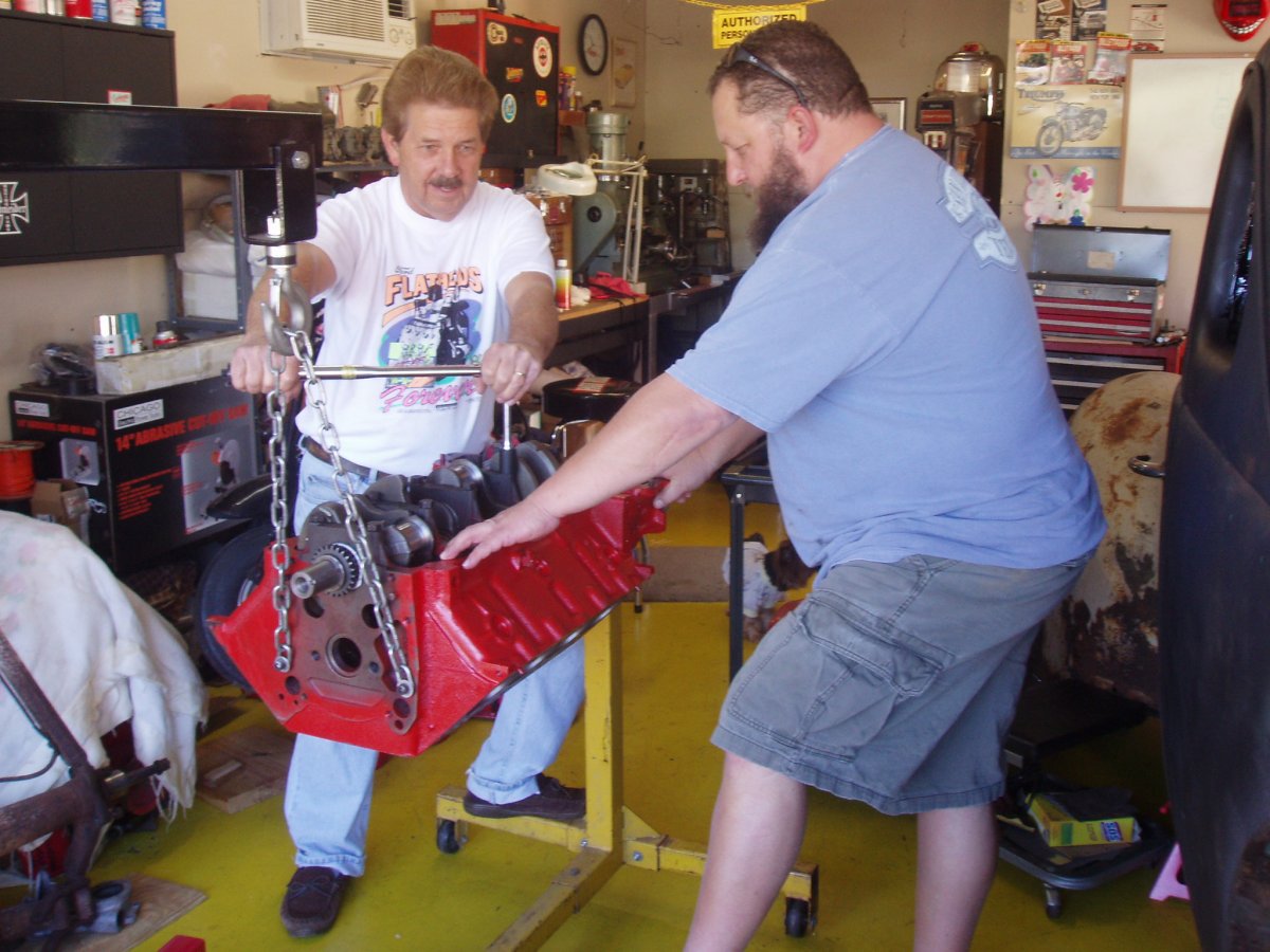

  7. blackrat40
    Posts: 1,167
    blackrat40

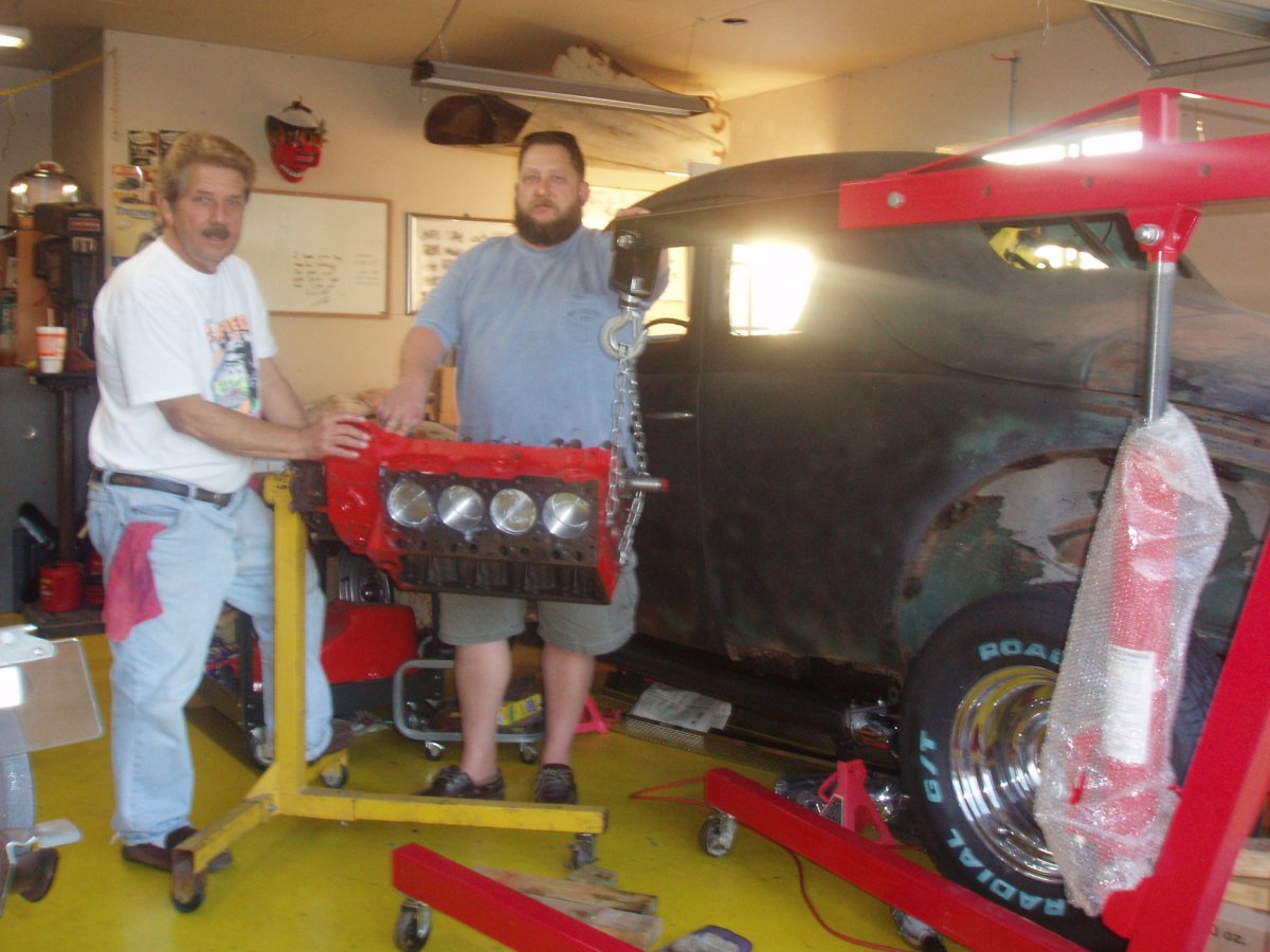

    324 Olds becomes 346+ with '71 4" pistons. Short block complete less cam & chain.
    Bob torquing the rod bolts.

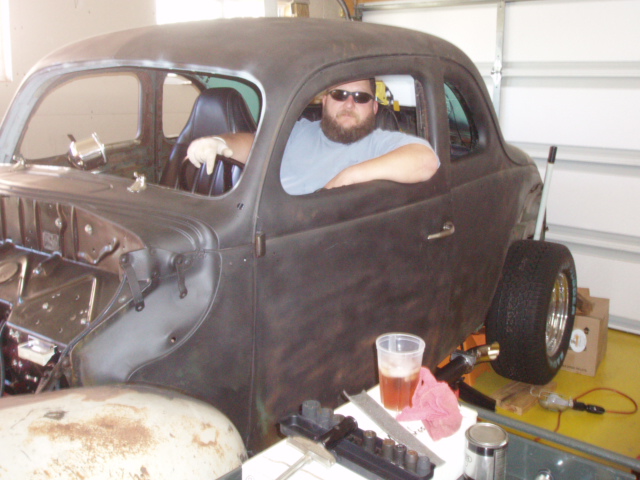

    Bob profiling in the coupe after the short block build.
