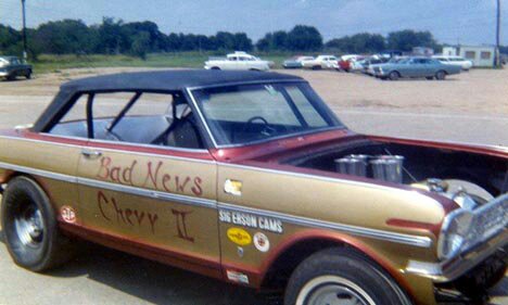

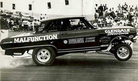

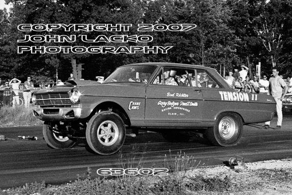

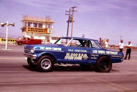

  24. II FUNNY
    Joined: Jul 31, 2010
    Posts: 1,840
    II FUNNY
    This car could have been a
    "MATCH -BASH" car running against some of the altered wheelbase cars. There were a few Chevy II's that ran with straight axles and stock wheelbases and lots of setback to be compe***ive. It could have been one of them before being campaigned as a g***er.
    Here's a couple that look to have stock wheelbases.
    Posts: 1,840
    II FUNNY
    I also forgot to mention that the Glendale Speed Center Chevy II supposedly ran on a rectangle tube ch***is that used to be a "T" altered ch***is to begin with, I have no proof of this it's just what I read somewhere. So there is no telling what the car started life as.
