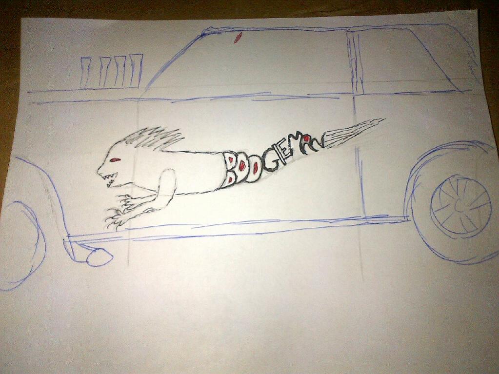

    OldColt
    Chris, Patricia took this picture off the side of a custom van at a car show tonight and asked me to post it as a possible suggestion. She said the yellowish face in the middle is the kind of Boggie Man face she was trying to convey with a pencil.
