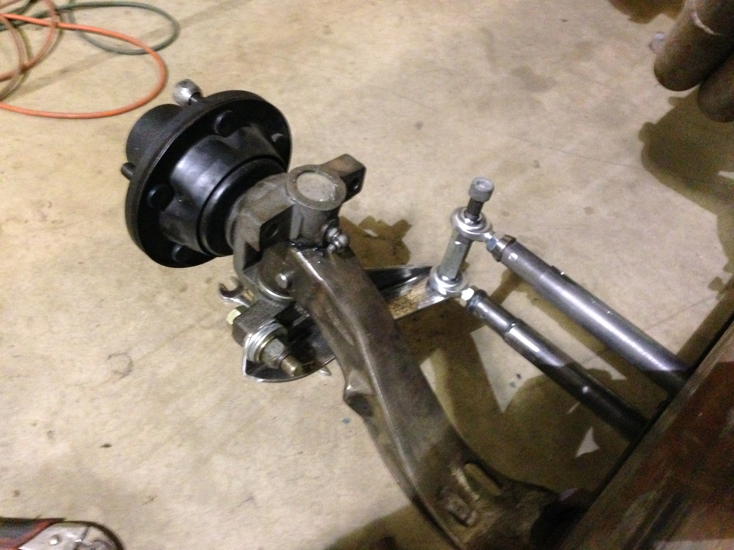

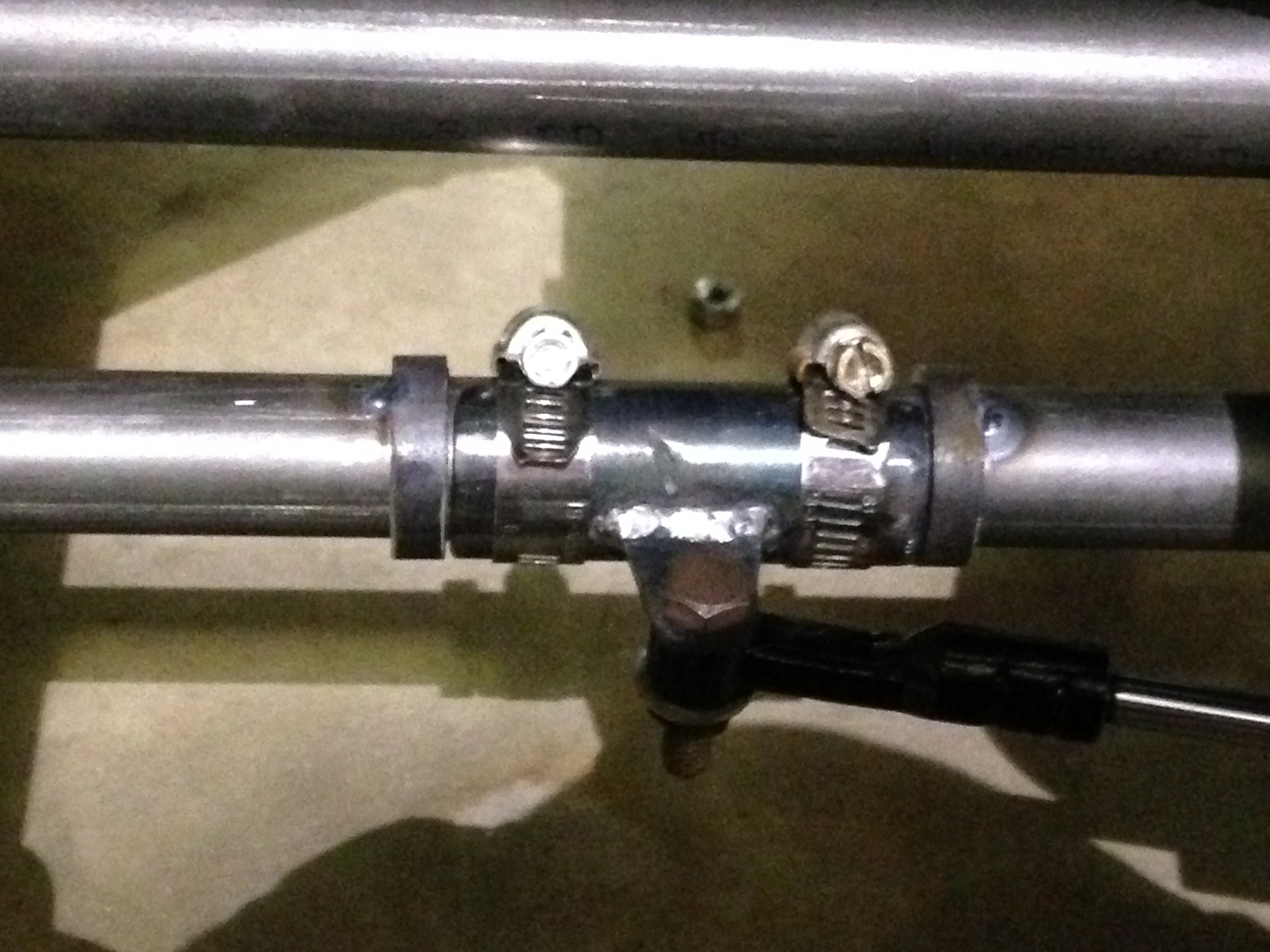

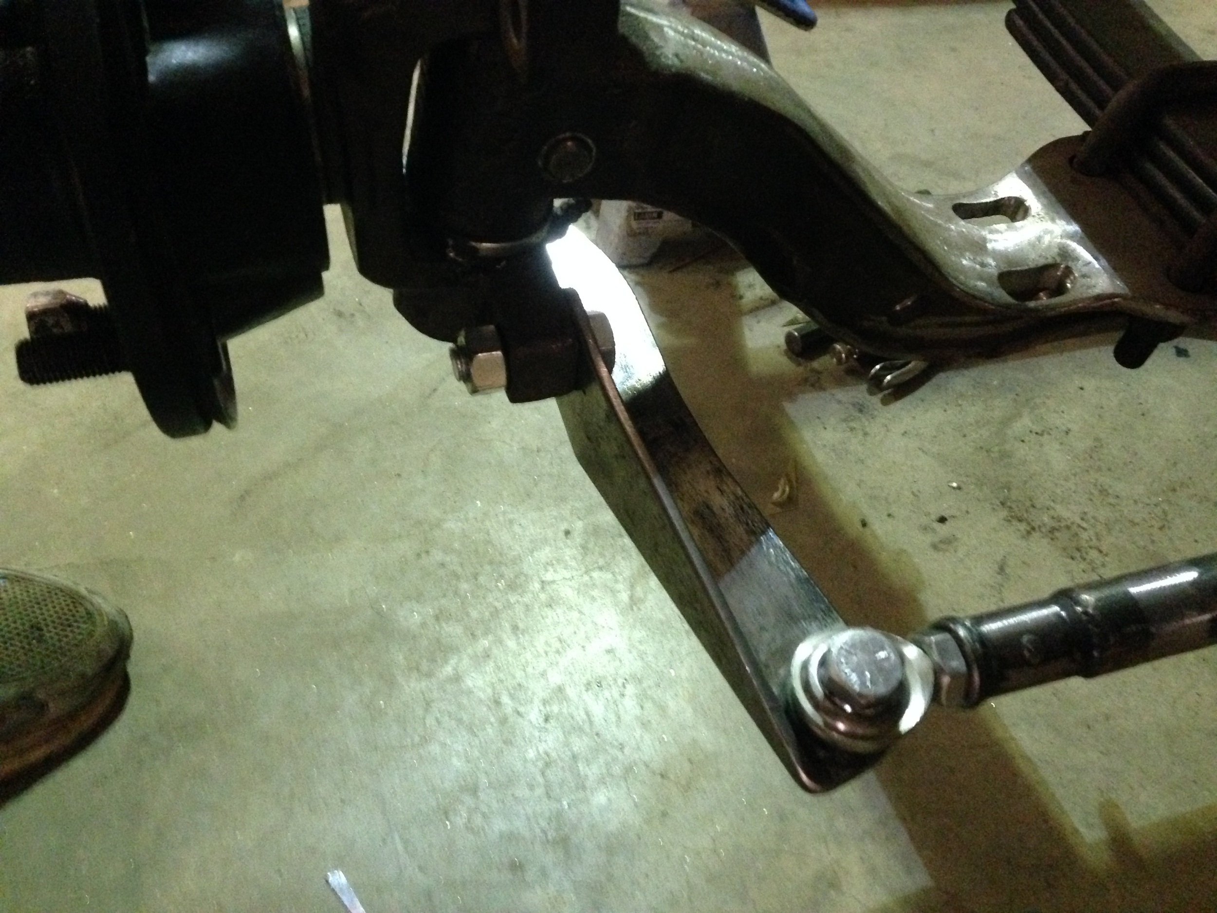

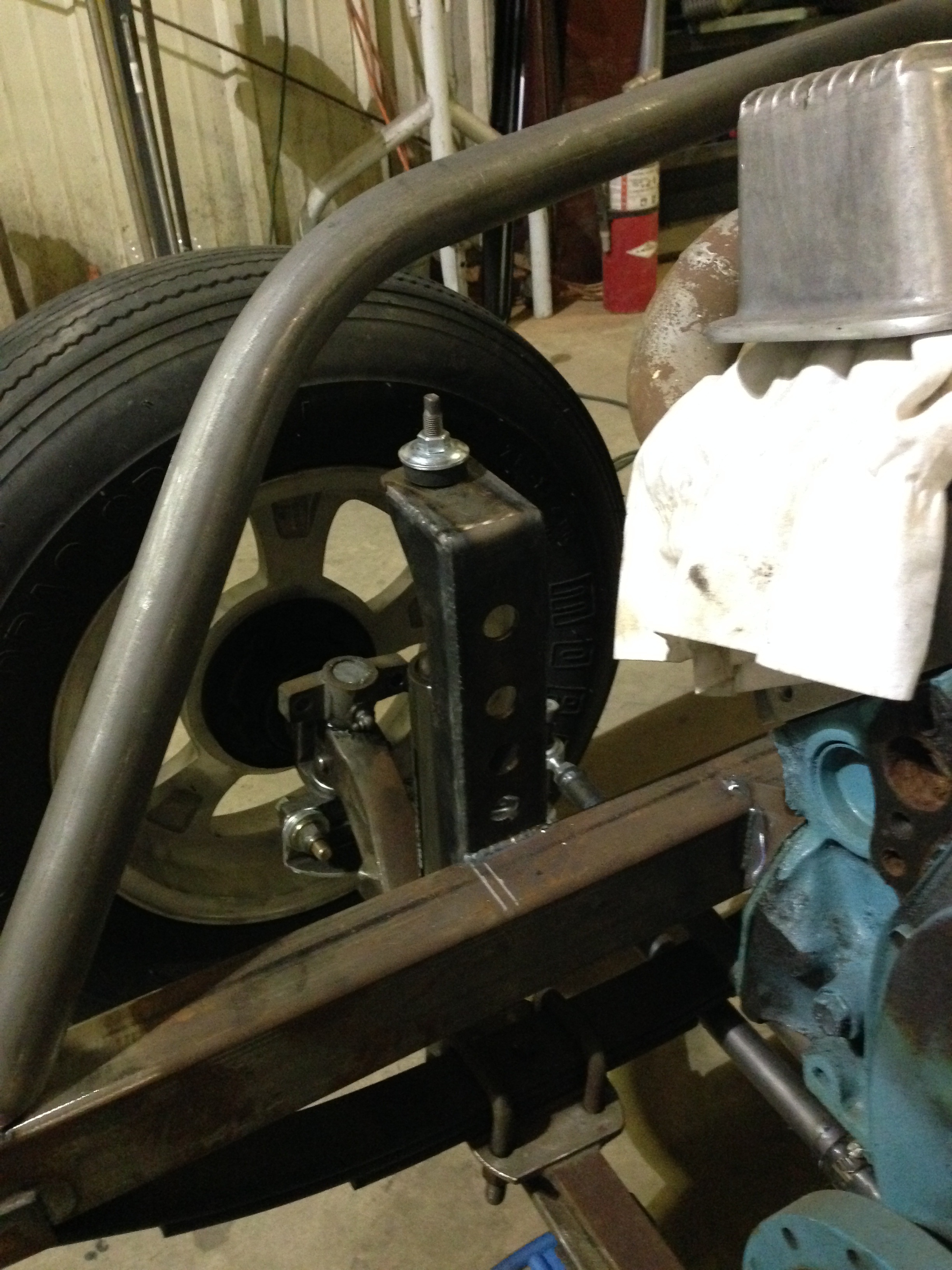

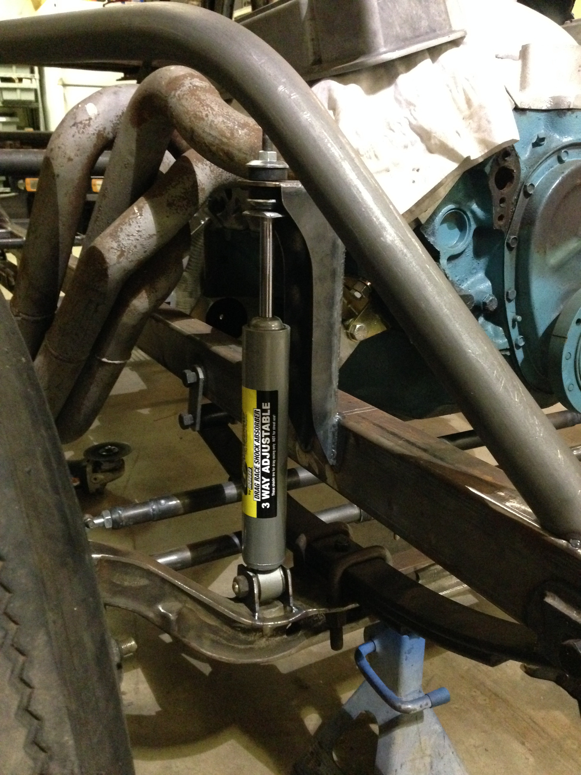

    Made the new steering arms these are a lot lighter. Mounted the front shocks. And mounted the steering stabilizer we use a VW one. They are small and you can hide it behind the front beam.....

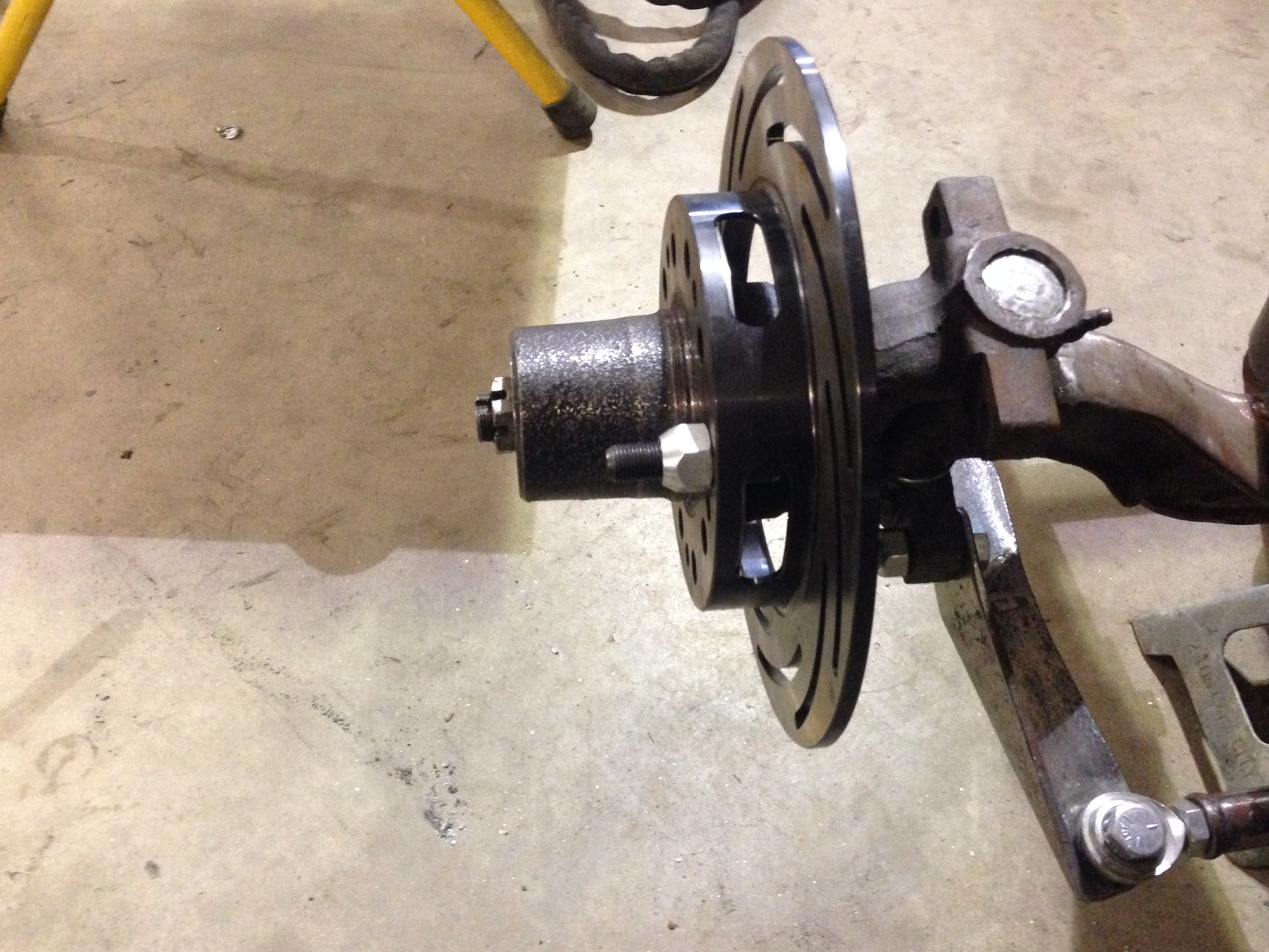

    These are the front brakes. I took a 1950 chevy car hub and machined it to fix a Strange strut rotor. And made brackets to bolt on Wilwood 4 piston calipers.. They don't make drag brakes for the 1959 chevy truck axle I used...

    Nice! Looks light as a feather!

    This is awesome. I might steal this. My idea for good front brakes was 77 camaro rotors with the speedway gm metric caliper brackets and wilwood d52 calipers. But your idea is much lighter. Nice work. Are you going to get tapered bearings for the hubs?

    Yes sir, I think they would hold up longer.

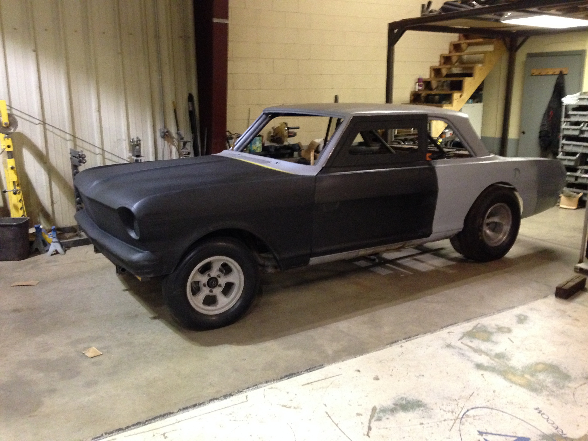

    We got the fibergl*** in finally. One piece frontend and doors from VFN. Now the hard part of fitting them...
    AHotRod, CGkidd and enloe like this.

    She's looking good Chris

    I love the rear wheel fender cutout's .... PERFECT !

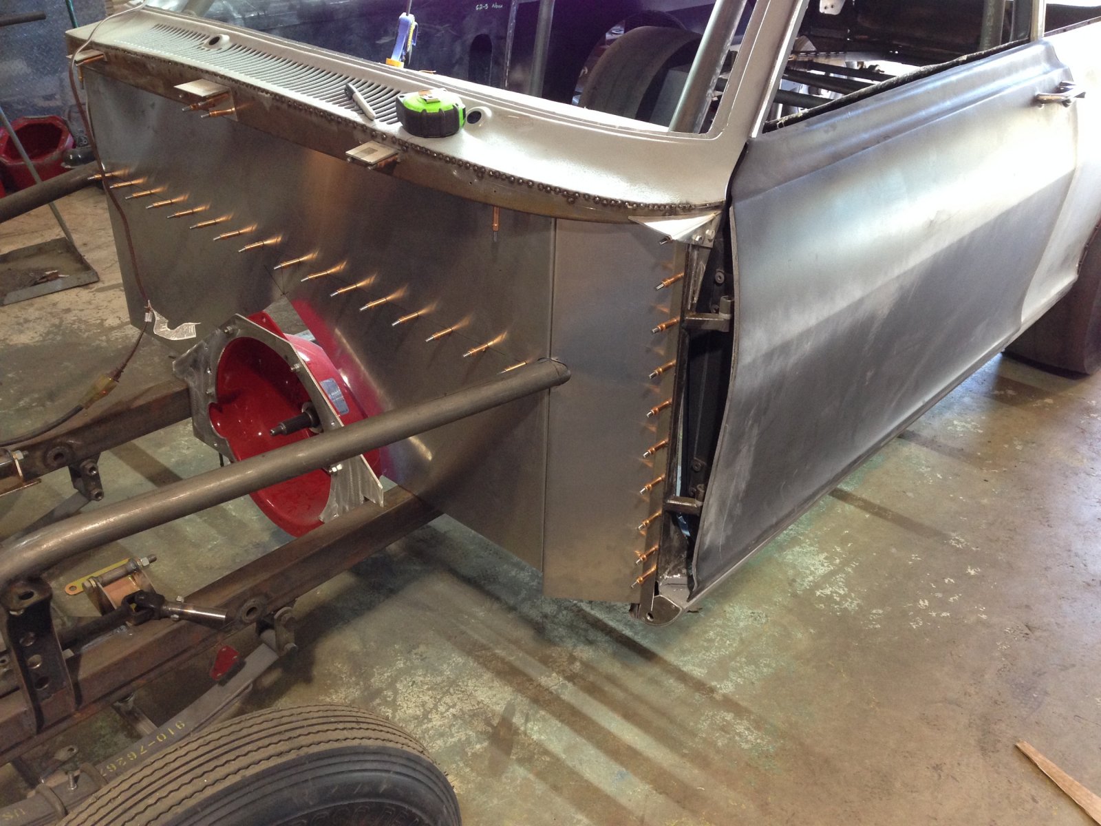

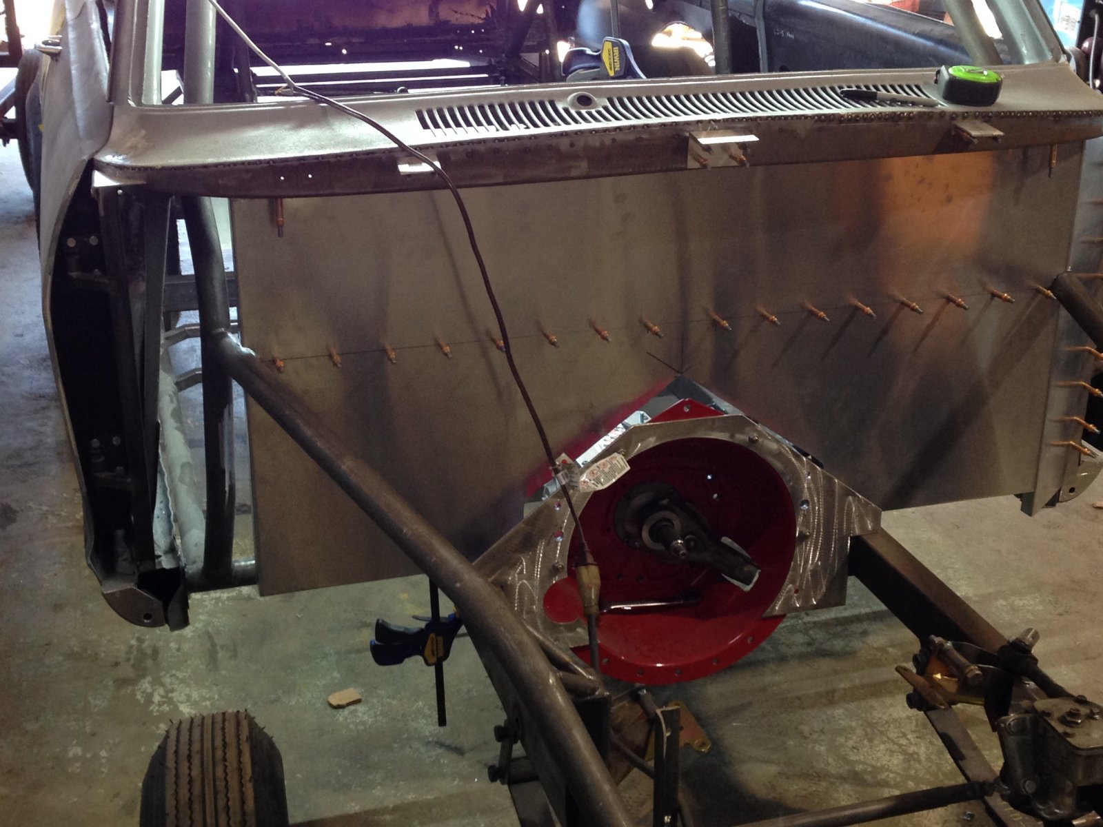

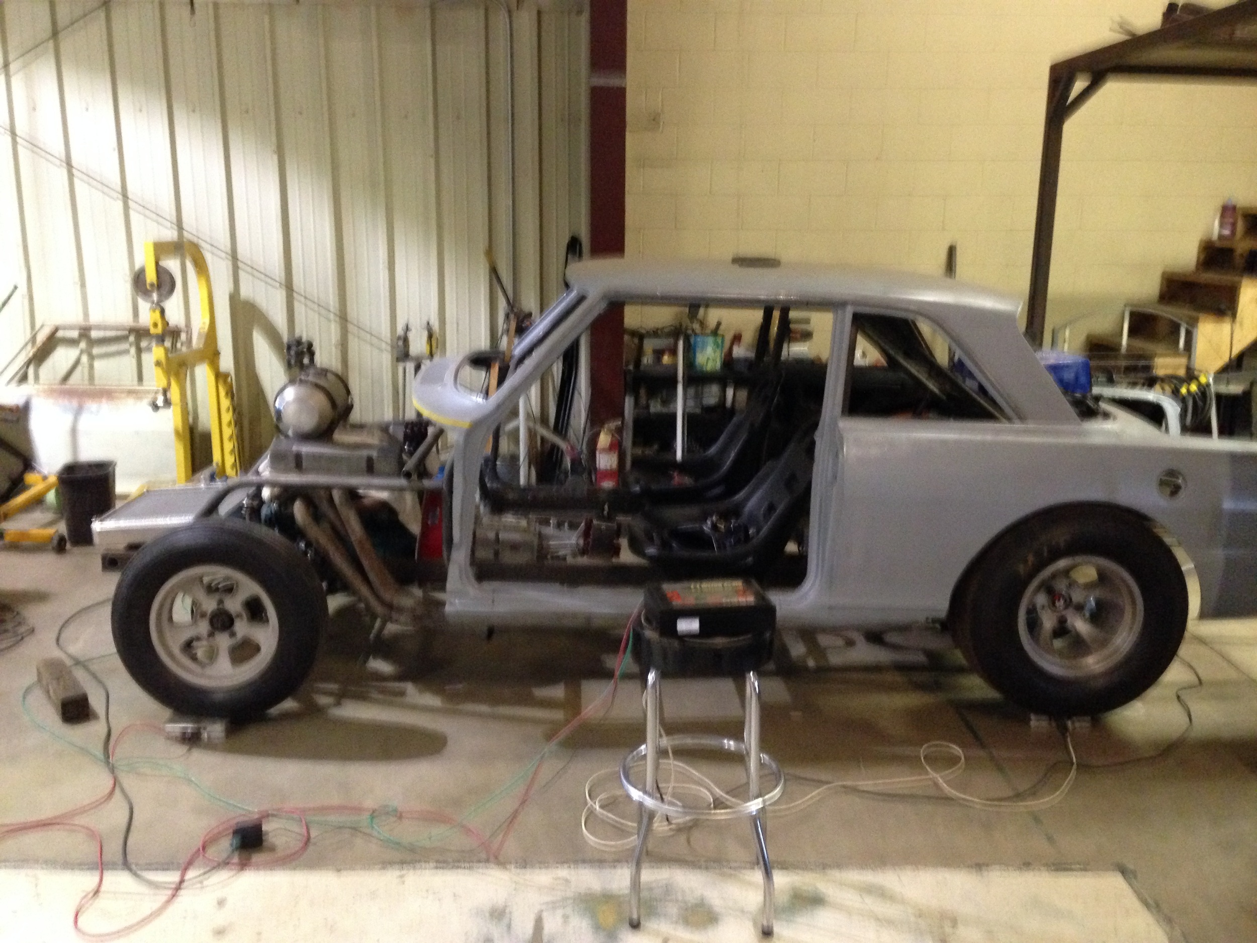

    Yes sir, Here are some pic of the Aluminum work started...
