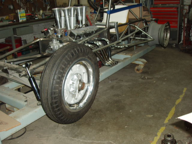

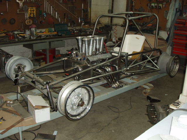

    2024-12-03 09.56.56-1.jpg 2024-12-03 09.56.56-3.jpg 42" long spring in front of the axle for stability and longer spring base. Dead perch on the left. My 1965 front weight jacker. [ Copied by many others in M S C ] I- H spindles on a Ford tube axle. Cross torsion rear suspension. 6 pin knock offs in front. Wide 5 rear end. One radius rod on RR. 2 radius rods on LR. [ Hot dog Wisconsin setup back in the day. ] 2024-11-29 17.01.13-2.jpg 2024-11-29 17.01.13-3.jpg 2024-11-29 17.01.13-4.jpg 2024-11-29 17.01.13-5.jpg 2024-11-29 17.01.13-6.jpg 2024-11-29 17.01.13-7.jpg 2024-11-29 17.01.13-8.jpg 2024-11-29 17.01.13-9.jpg 2024-11-29 17.01.13-10.jpg 2024-11-29 17.01.13-11.jpg 2024-11-29 17.01.13-12.jpg 2024-11-29 17.01.13-13.jpg J bar Panhard bar for lower roll center. 8-1 Schroeder steering.

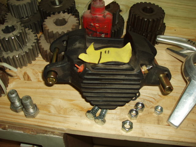

    What kind of rear brakes with finned aluminum calipers?
    Will it have front brakes?

    Thank you. The brakes are Wilwood G M replacements. Purchased GOODSGUYS   PACKARD 018.JPG 4 at a swap meet for $25.00 for all 4. Used 2 on the front of my black 27. Right now I don't have plans for front brakes. Maybe the LF only.

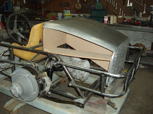

    New Years Eve did the back panel for the tail. Annealed the corners and flanged the ends to make it easier to weld the top and side panels on. 2025-01-01 20.15.10-5.jpg

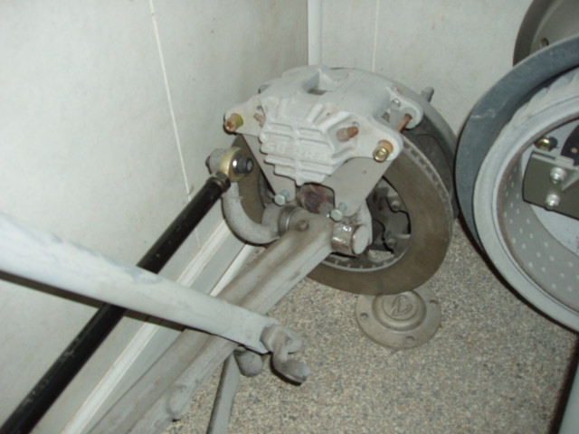

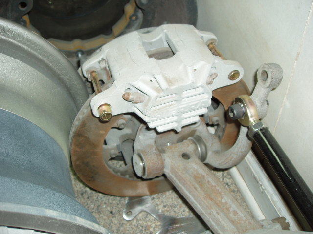

    G M alumunum 2025-01-03 16.20.48-1.jpg 2025-01-03 16.20.48-2.jpg 2025-01-03 16.20.48-3.jpg replacement calipers. These were made by Sierra. Iv'e never heard of them. Don't want to sell them. I have a new pair of Wilwoods for 1" thick rotors. $125.00 each.

    I built the buck to do the top and side panels like the professionals do. IE; Join the 2 panels in the middle of the radius. Anneal the edges and shrink. Compound curve top & side. Did not work out for me like the metal shapers instructions book. I gave up after doing one side and called Damon. Full time metal shaper. He took the buck and the panel. Fixed the side I messed up and shaped the other side all with a power hammer. It is a thing of beauty now. Nice to know what you are doing. I think I can handle the sides. Only a single very small curve. 2025-01-26 14.49.43-1.jpg 2025-01-26 14.49.43-2.jpg

    Bent rails for build # 4 arrived but I decided to build the roll cage for the Killer. Build # 3. 2025-05-31 21.08.27-1.jpg
