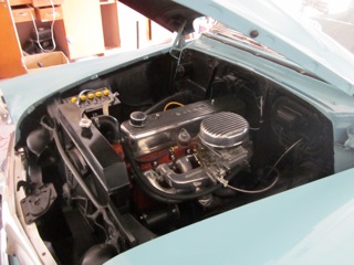

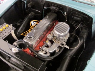

    I built what i consider to be a nice 235 - bored .080", cam, dual carbs, fenton headers with cherry bombs, full split exhaust, polished and balance the crank and rods etc, 5 speed, open drive rear, drop tube front etc.
    Have a look at the link in my signature line - there is some Youtube footage too, so you can hear it run.
