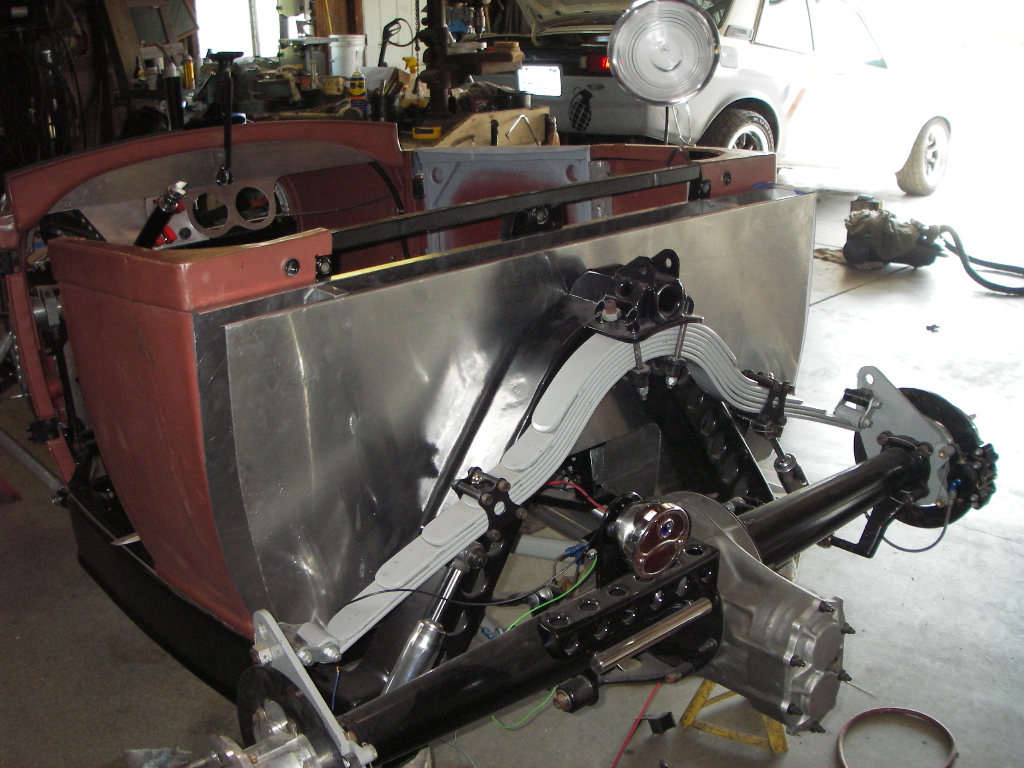

    I built mine from aluminum and then filled with water and checked for pin hole leaks, and there were some! did that several times and now have run it for several years with out problem. You should probably think about some sort of internal baffles and also make sure that the point that you pick to connect the fuel out let is a low spot. Plan your take to meet the needs of your fuel system, especially if you happen to be running electronic injection you will probably need a return connection. Plan first and then fabricate as it is a pan in the *** to add things afterward.

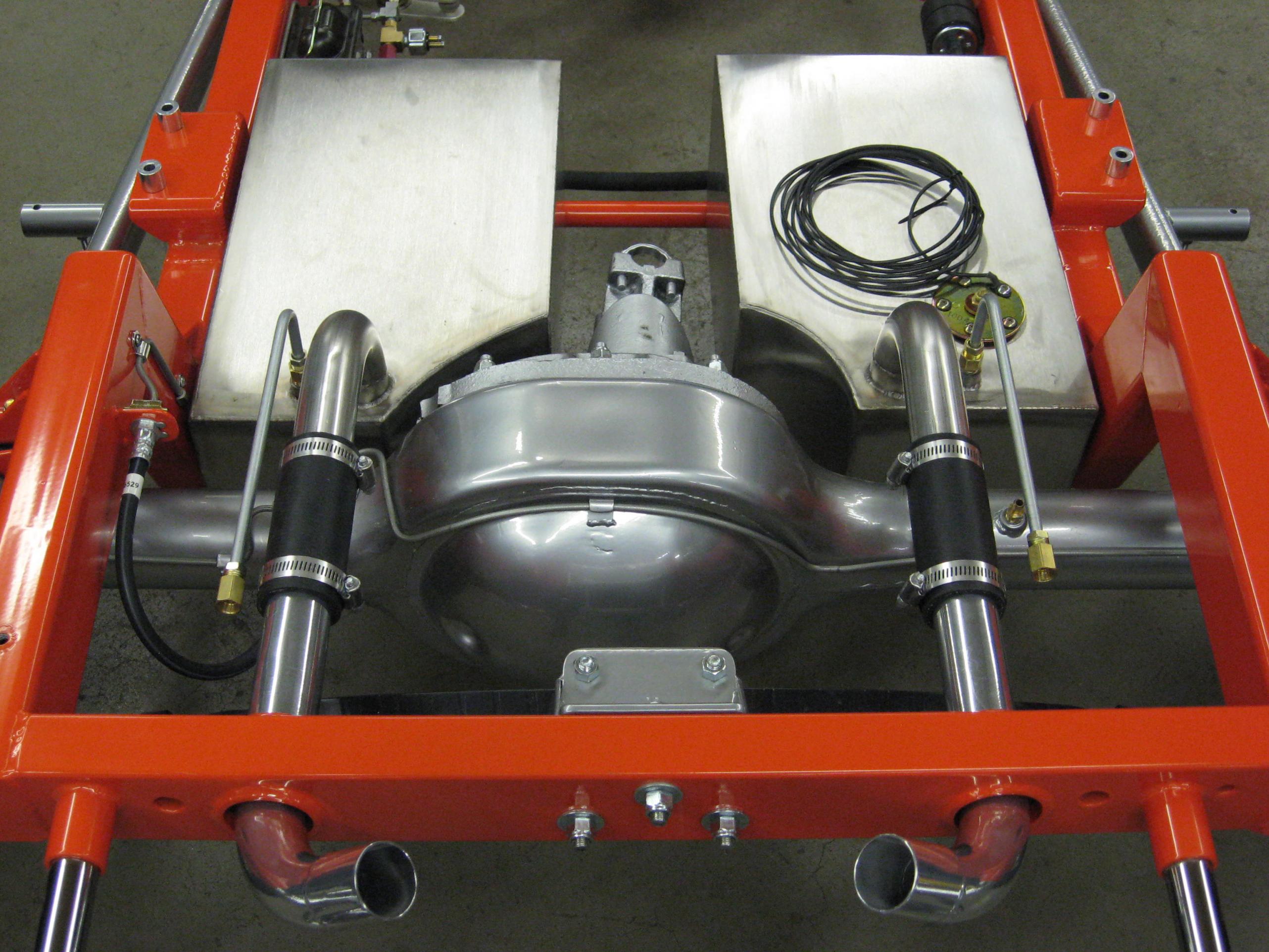

    I built these out of 14 ga stainless, as others have said, plan it out well, with cardboard samples, make sure of your placement of mounts, plumbing, and fill neck (with proper drop) and vent, to make filling it easy. This one was a tough one, with the duel tanks and rear seat, filling through the rear.
