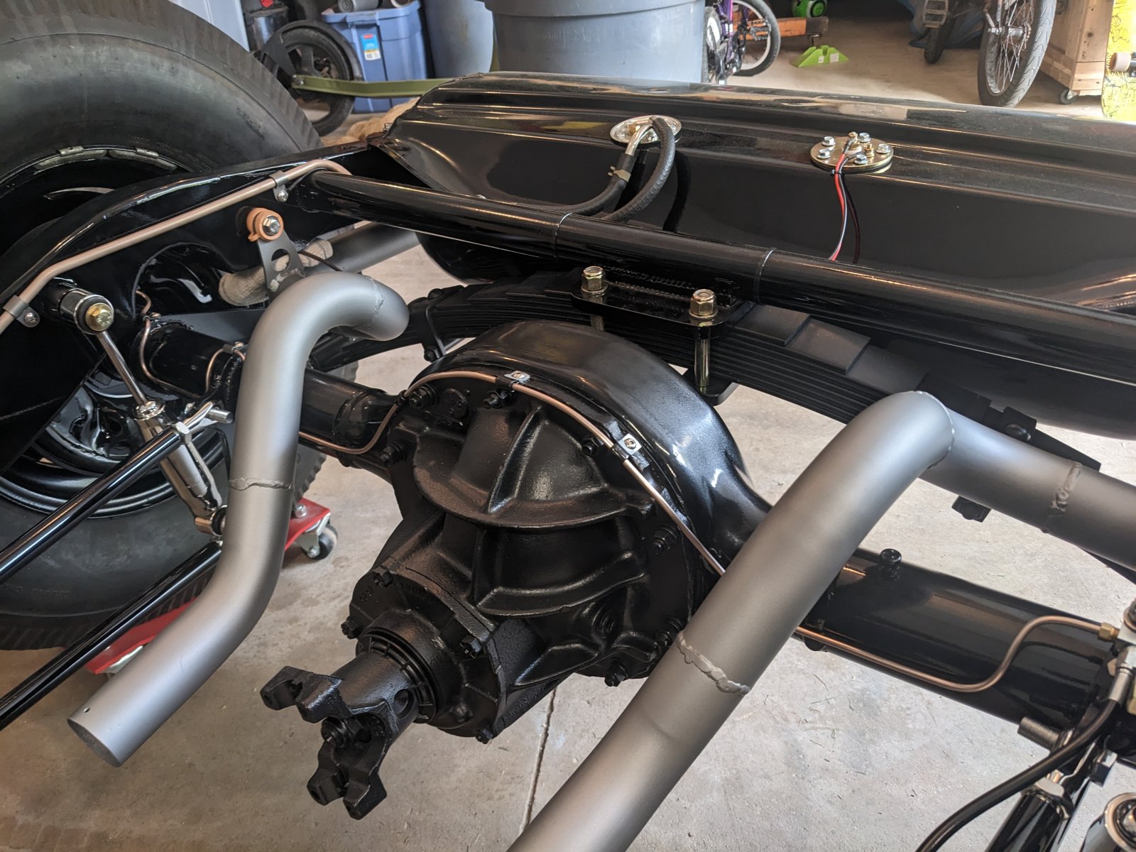

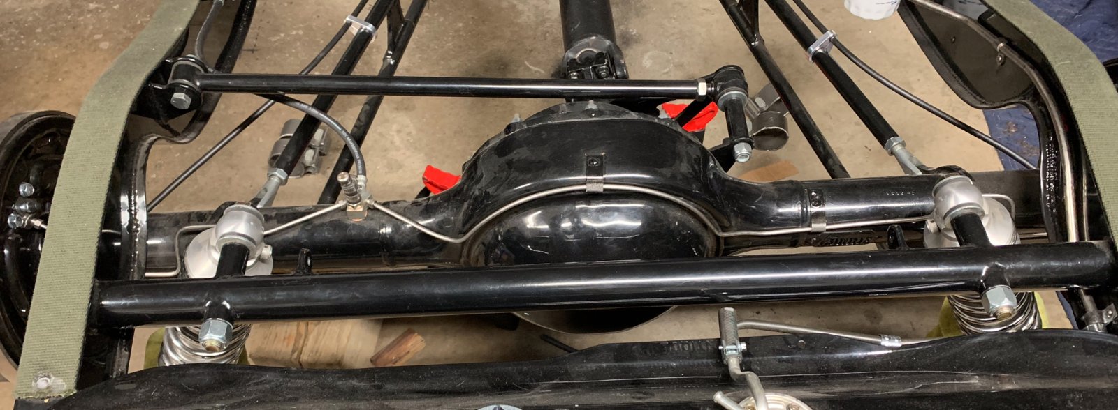

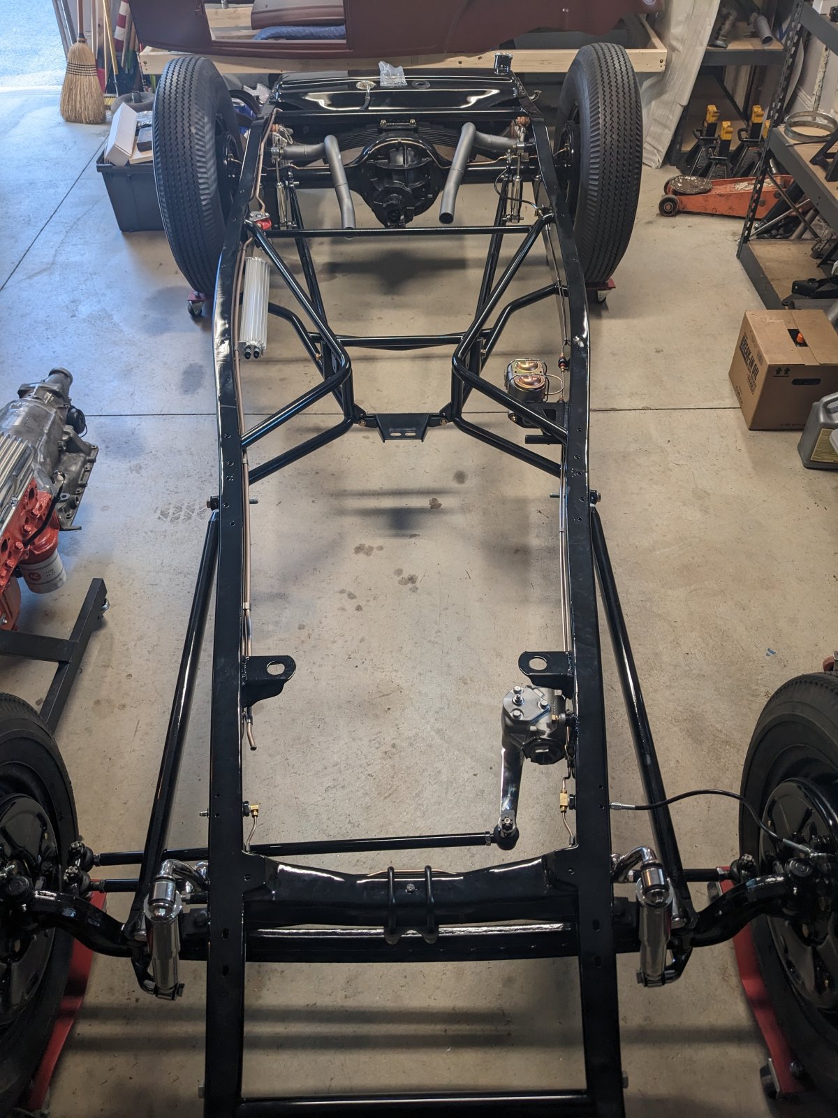

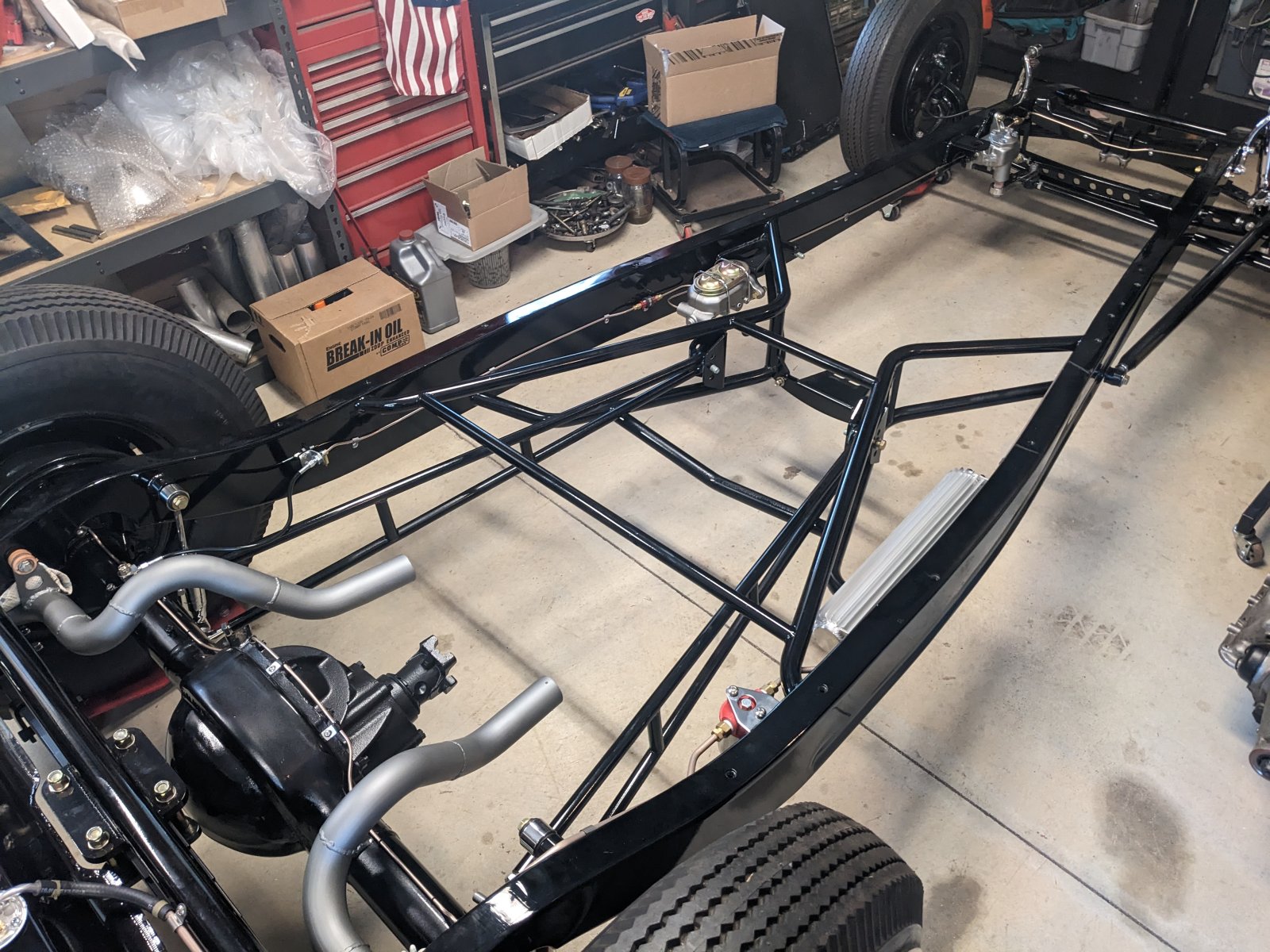

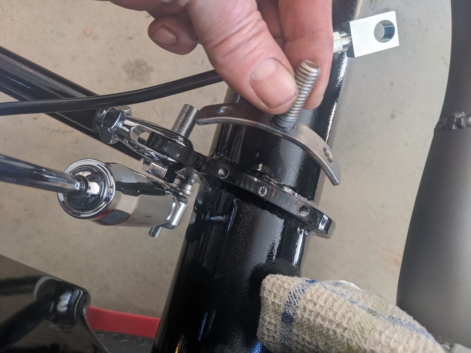

    Finally warmed up a bit...got it all plumbed. A few more things to do, like ftame welting, install the exhaust and e-brake lines, the the body goes on!

    Before the body goes on:
    Much of the frame gets built from the top, but once the body goes on, it can only be serviced from down below.
    Check everything over to be sure it is actually serviceable from below.

    Are you putting rubber bump stops in the C notches? Will the brake lines running on the top side of the axle get smashed on a hard bump?

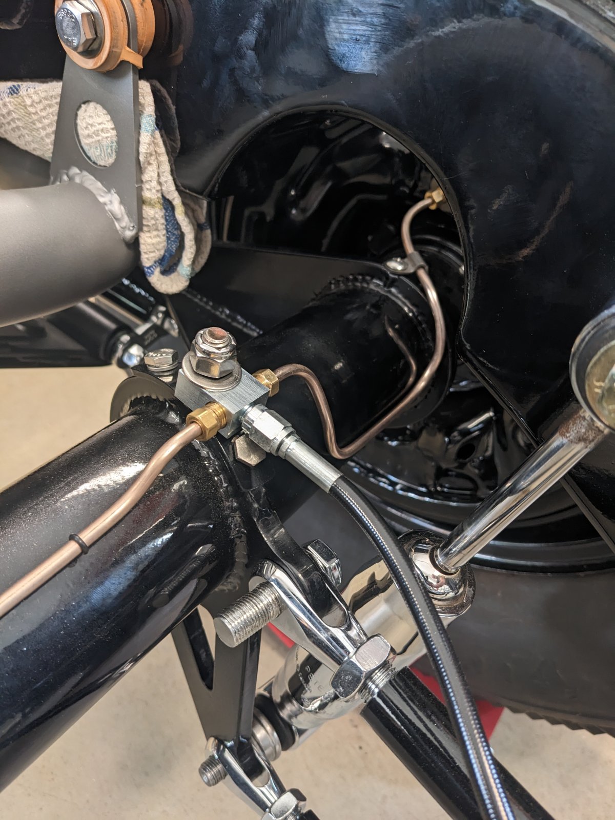

    I’ve done a few 9” rears in 32s, but a buddy of mine just turned me onto mopar b body rear axle brake line hardware. 1st time using it on my current project and it sure seems to work out well. I can add some more pics if folks interested in seeing the bits used, but as noted above you might want to ensure everything is safe from bottoming out and that you can service everything from the underside. The brake lines along the top of your axle scares me and being able to yank your 3rd member as easily as possible should be considered (that’s why I went on the backside on this project).

    I'll 2nd what the two posts above said about the brake line. You need to re-do that.

    If that crashes, I have bigger problems...
    There is less distance between the top of the rear-end center and the floor of the body (3.25") than between those brake lines and the c-notch (3 3/4"). There's probably more of a chance of the brakes lines getting hit by the exhaust pipe where it goes up over the rear-end.
    I weigh 275 and stood on the rear spreader bar, then jumped up and down - the c-notches went down no more than 1".
    Does the rear suspension on cars with this setup really travel much? It has a Posies transverse rear leaf spring.

    Yes it will. When you least expect it. Mark my words, at some point you will have that axle use all the travel available. Even if the pumpkin is going to hit first, who’s to say you don’t have one tire hit a bump and the other doesn’t?

    If your rear only travels an inch, you’re going to have a **** ride. You need those inches.

    Don’t forget than when you turn a corner, you’re going to have body roll. Take a corner a little too hard that has a bump in it, and yeah there goes your brake line. I’m sure you don’t want to take the time to redo it…but redo it.

    Remember, with a full tank of gas hanging way behind the rear axle your rear ride height will be lower. Fill the tank then do your spreader bar jump and you will be surprised. My ride is different with a full tank of gas vs almost empty, although I have a 16 gallon tank. My .02$ is move the brake tubes.

    OK...got the hard side done this evening
    Went ahead and ducked it under the exhaust pipes too (there's certainly the propensity for the axle to crunch into the exhaust pipes when I hit a big bump too)

    You have air in the system somewhere. I use a vacuum bleeder but you have to seal the bleeder valves so it doesn't draw air in through the bleeder valve threads when loose. A pressure bleeder would be a good choice since you don't have the body on and the master cylinder is accessible. "Speed Bleeders" are another option if you are by yourself.
