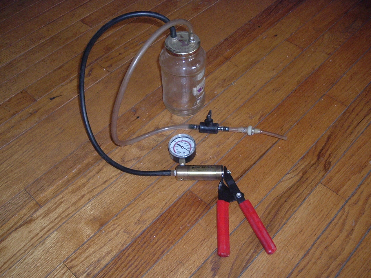

    Here's the rig I use. It's an Accutron Vacuum pump that I pump to 15" Hg once the hose is fit to the closed bleeder. I added a shut-off valve and a one-way valve in line because my hand got tired from pumping it up from "0" each bleeder.This way most of the vacuum holds in the jar and I lose very little brake fluid when removing the hose. I use petroleum jelly around the bleeder valve threads to stop air from being ****ed in when you open the bleeder. You can **** a large amount of brake fluid into the jar at each valve to insure you get all the air out of that line. Start at the bleeder farthest from the M/C and work closer just like you would during any bleed job.

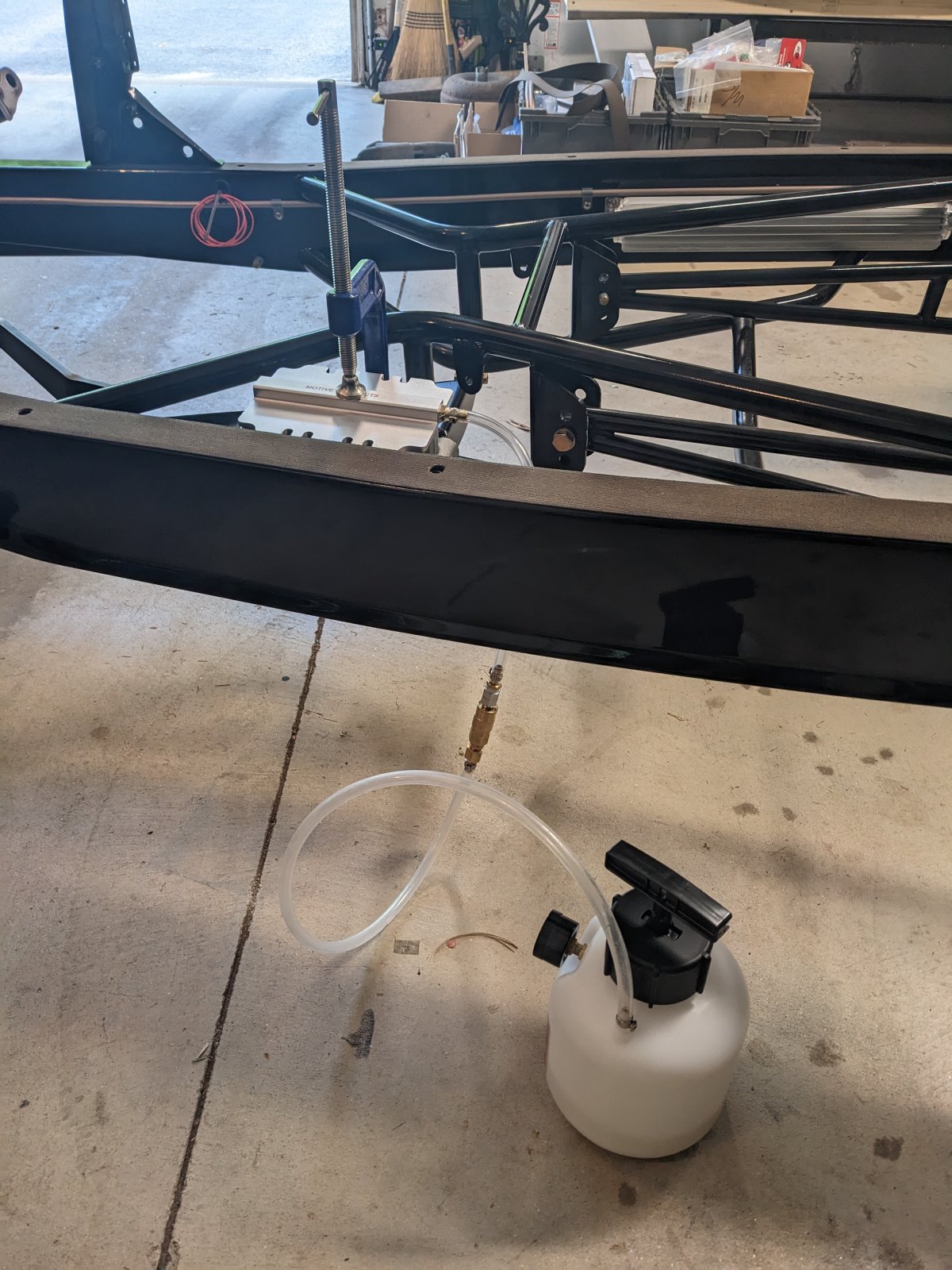

    I've done that method many times and it's got it's pros/cons. I'm going to try this:

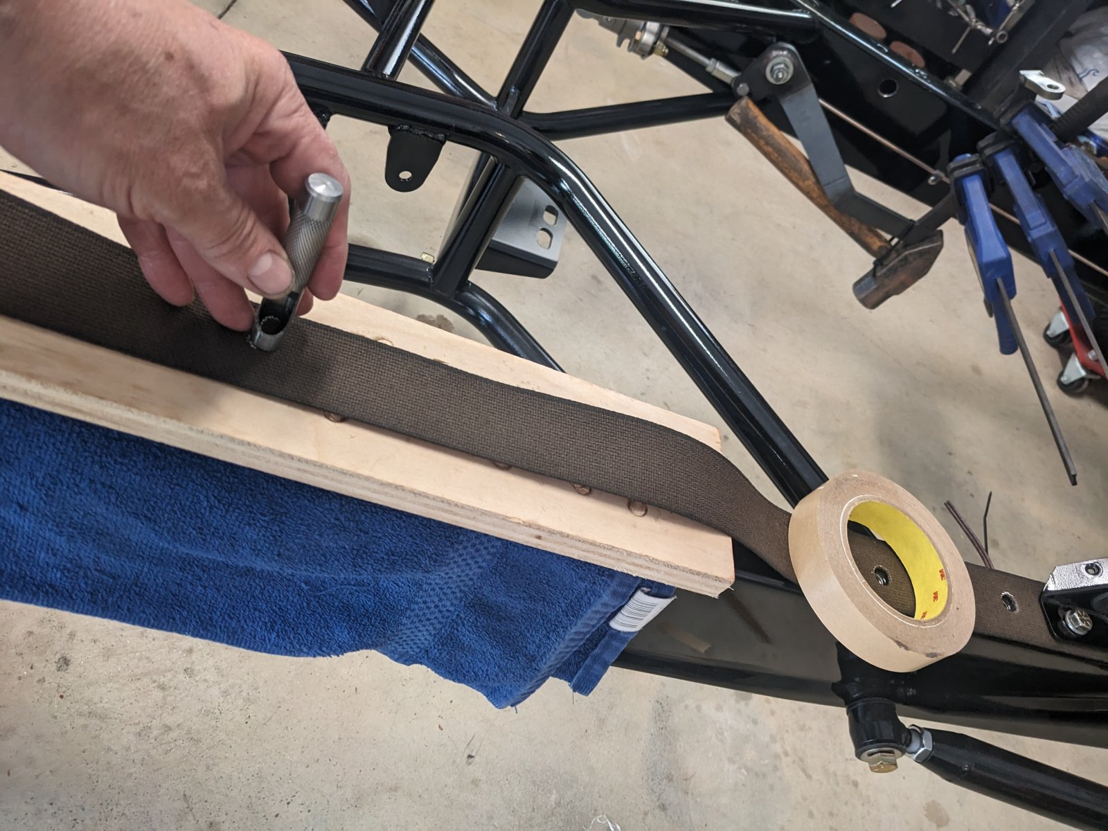

    In the meantime, I installed the frame welting. I used very high bond 3M double sided tape to hold it down. Punched the holes as I went along...

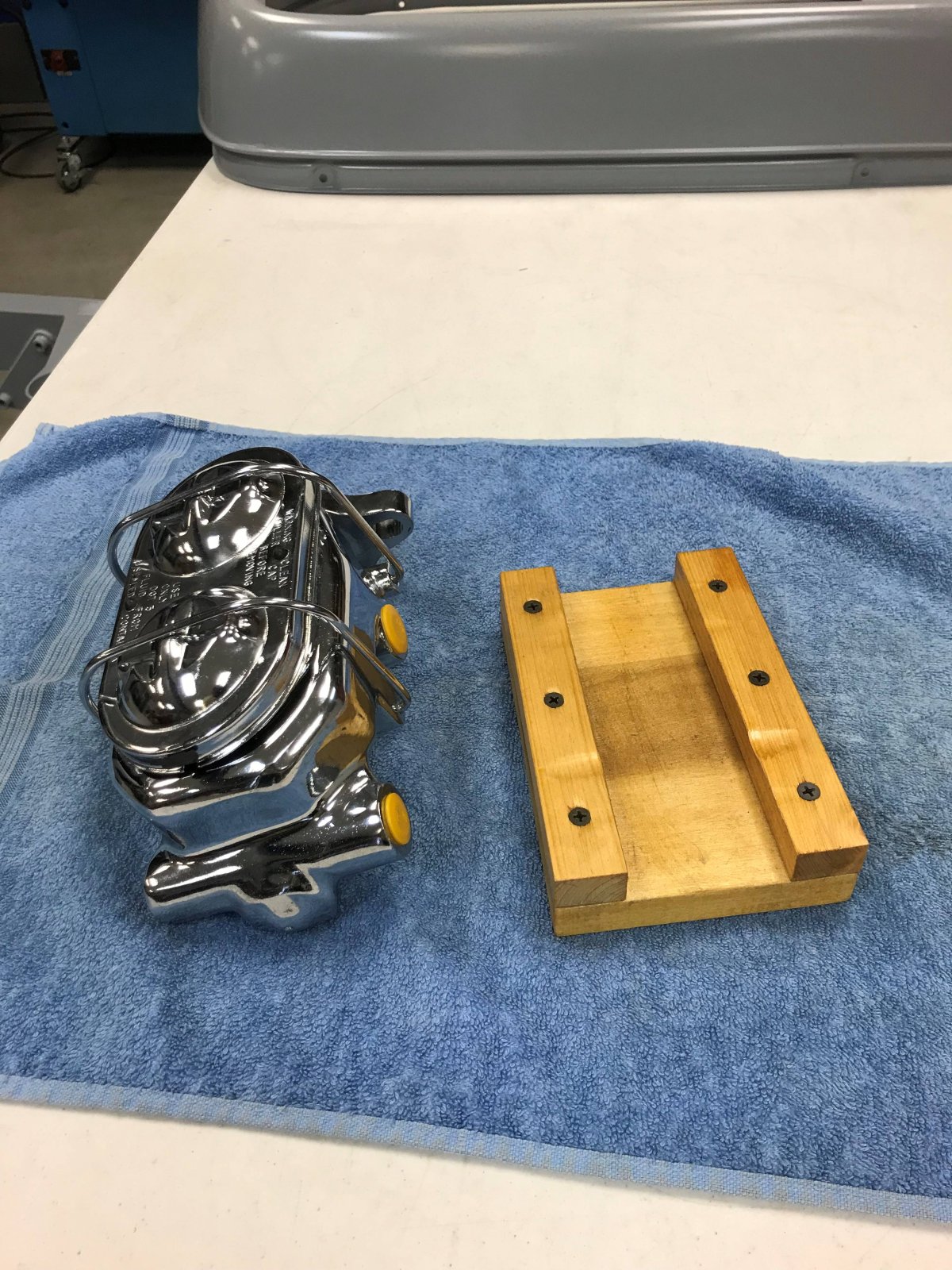

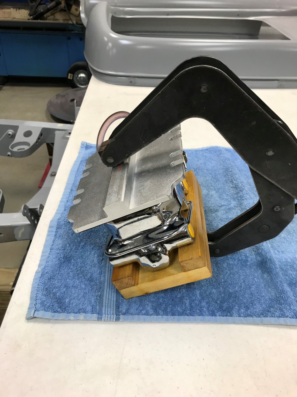

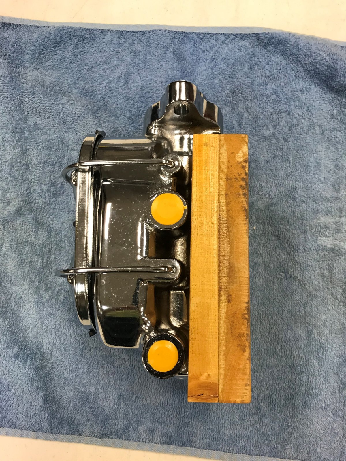

    I've been using that style bleeder for years and I really like how it works, but there is a slight learning curve to using it without having unpleasant accidents. Here are some tips that will make this easier to use.
    #1 Before I bought this bleeder, I read many reviews that said the hold down chains for the master cylinder lid did not work well to make a good seal. So I came up with a way that always made a good seal on the master cylinder. I made a wooden platform that fits on the bottom of the master cylinder.
    Then I use a c- clamp to hold the lid on. You have to find a clamp that fits in the space you have at the master cylinder when it is on the car.

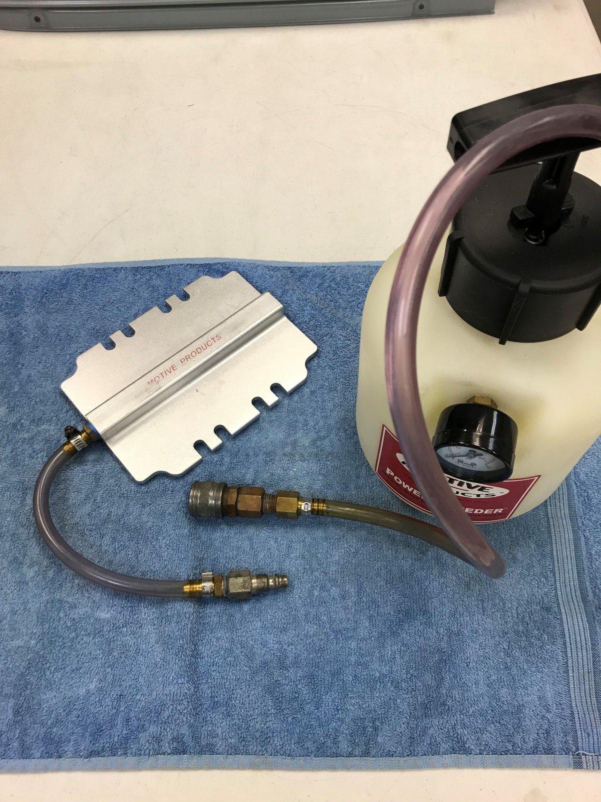

    #2 I added some air line quick connect fittings in the rubber tubing between the tank and lid. This was really helpful when you are finished bleeding and are about to remove the lid, more on that in another tip.
    #3 Before you add fluid to the tank, mount the lid on the master cylinder and with the tank connected, pump up the air pressure and do a dry test to check for leaks. You don't want to find out that you don't have a good seal by watching a puddle of brake fluid growing on your floor. Watch the pressure gage on the tank to see if pressure is holding. If the seal is good crack the lid on the tank to relieve the pressure, then fill with brake fluid.
    #4 Sometimes after you are done bleeding the brakes, the master cylinder may be totally filled to the top. If you try to take the lid off brake fluid can spill out and ruin a fresh paint job. Here is where the quick connect fittings help. I disconnect the tank and empty the remaining brake fluid out, then reconnect the empty tank. Pump up a little pressure and bleed some fluid from both the front and rear brakes, this will push fluid out of the master cylinder without adding more and will lower the level below the top of the master. Don't bleed to much out, you don't want to wind up pushing air through the master into your system. Now with the fluid level below the top of the master cylinder it's safe to remove the lid.
    Good luck.
    brEad, Tman, SDS and 1 other person like this.

    Thanks! Getting ready to try it tonight. Going to try a quick grip on the MC cap.

    Bicap's tips are spot-on! Saved me a lot of headache.
    The chains with the Motive kit are garbage.
    Wood under MC with a c-clamp is the hot ticket.
    Air fittings on the hose is a big improvement over the way the kit is sold.
    Thanks for posting that, man!
