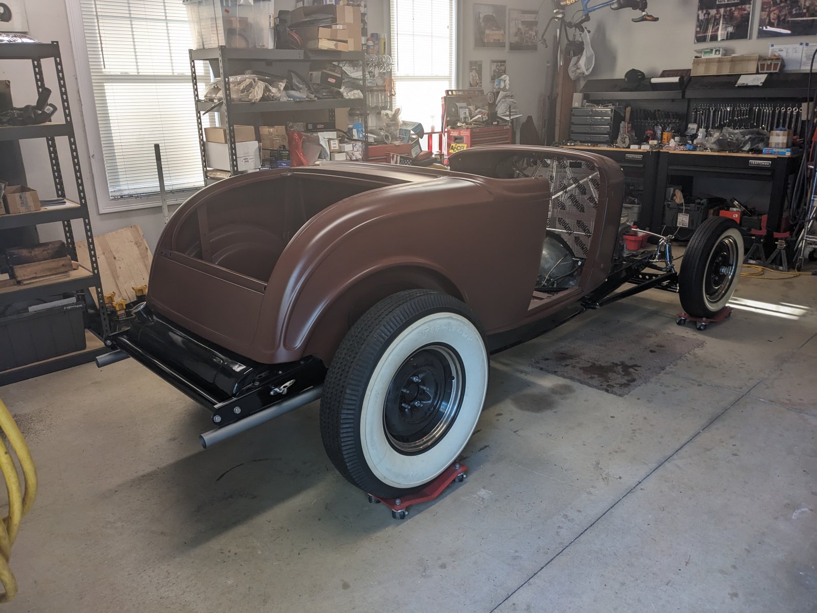

    Thanks to the guys who gave me advice - a few who have built a lot of 32 Fords said to cut some off the back edge of the seal.
    Using a straight edge and a razor blade, I cut about 1/16" off the back edge of the seal it popped right in the grove.
    I then put a couple drops of soap and water on a wad of paper towels and soaped the seal...the cowl slipped right on to the seal
    For those who think that you can spread the bottom of the cowl out enough to get the little bronze feet over the top of the cowl, think again. I had another big guy helping me and we couldn't spread it enough to get it over the cowl. We ended up pushing it forward while lifting about 6 inches.
    PXL_20230620_223314263.jpg PXL_20230620_223307787.jpg PXL_20230620_223320512.jpg
