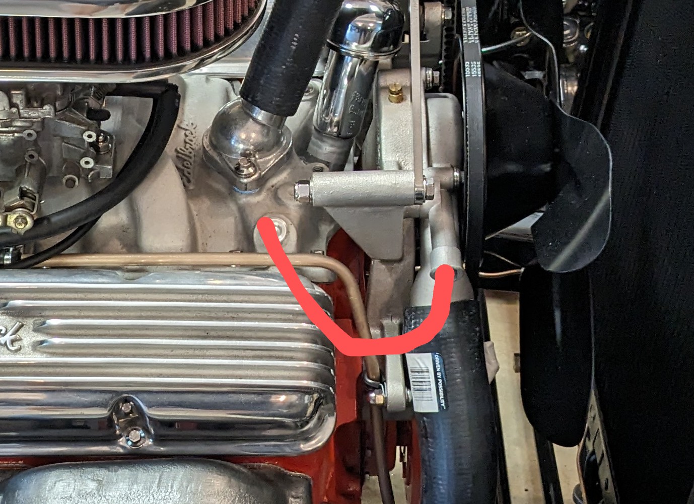

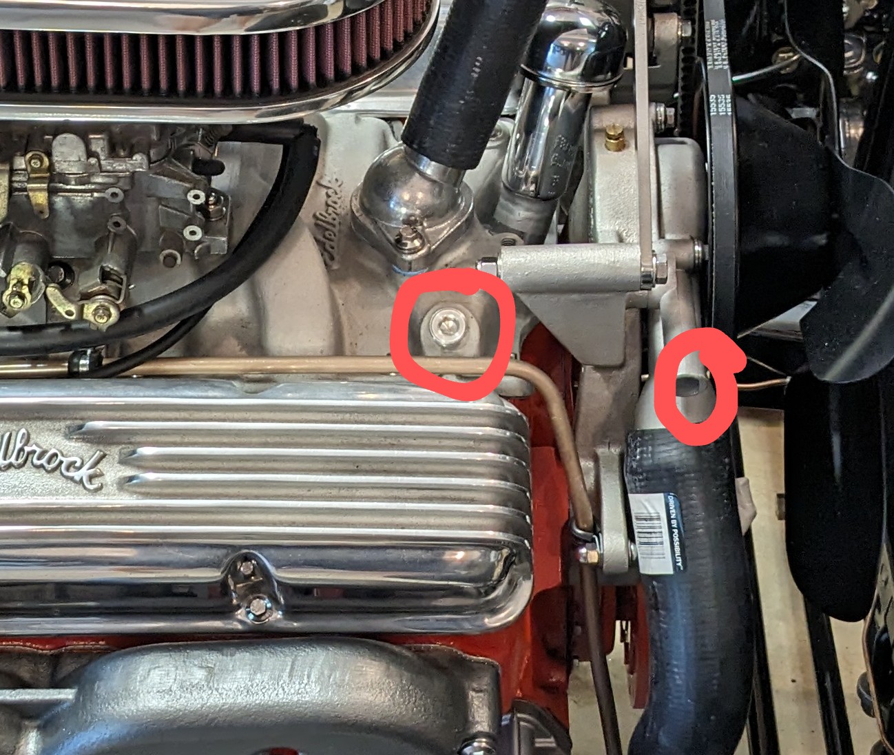

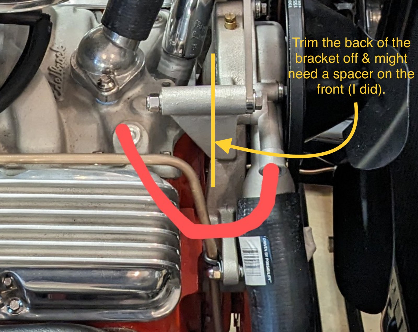

    PXL_20230720_231435135~2.jpg PXL_20230720_231435135~3.jpg Also looking for advice on a hose to byp*** the port on the Zip's riser/6 cyl water pump port.
    The instructions say to run it to a fitting between cylinders, but I have 463 casting heads and there's no port there. Was planning on running it to the heater hose port on the intake.
    Thoughts?

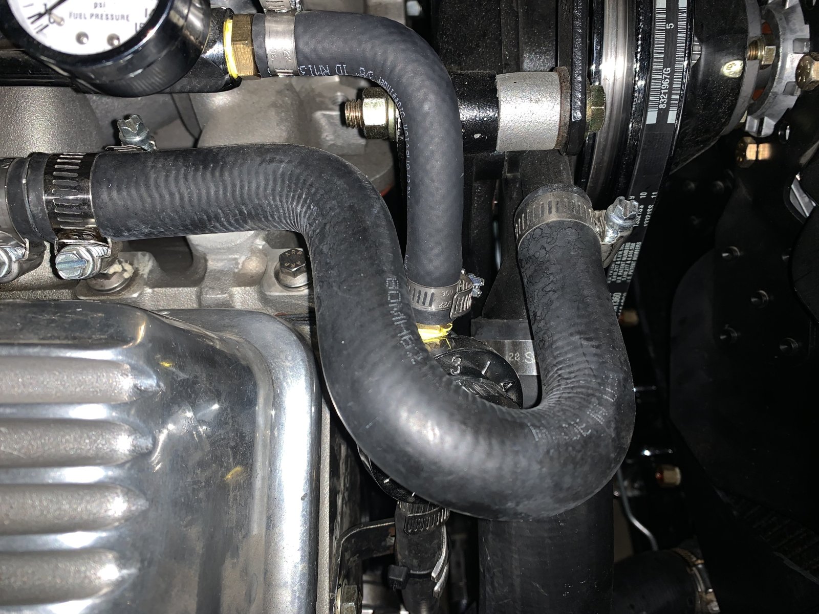

    Here’s what I’ve done.
    Hopefully this helps.

    That’s pic is from my Tudor build and it is routed to a heater.

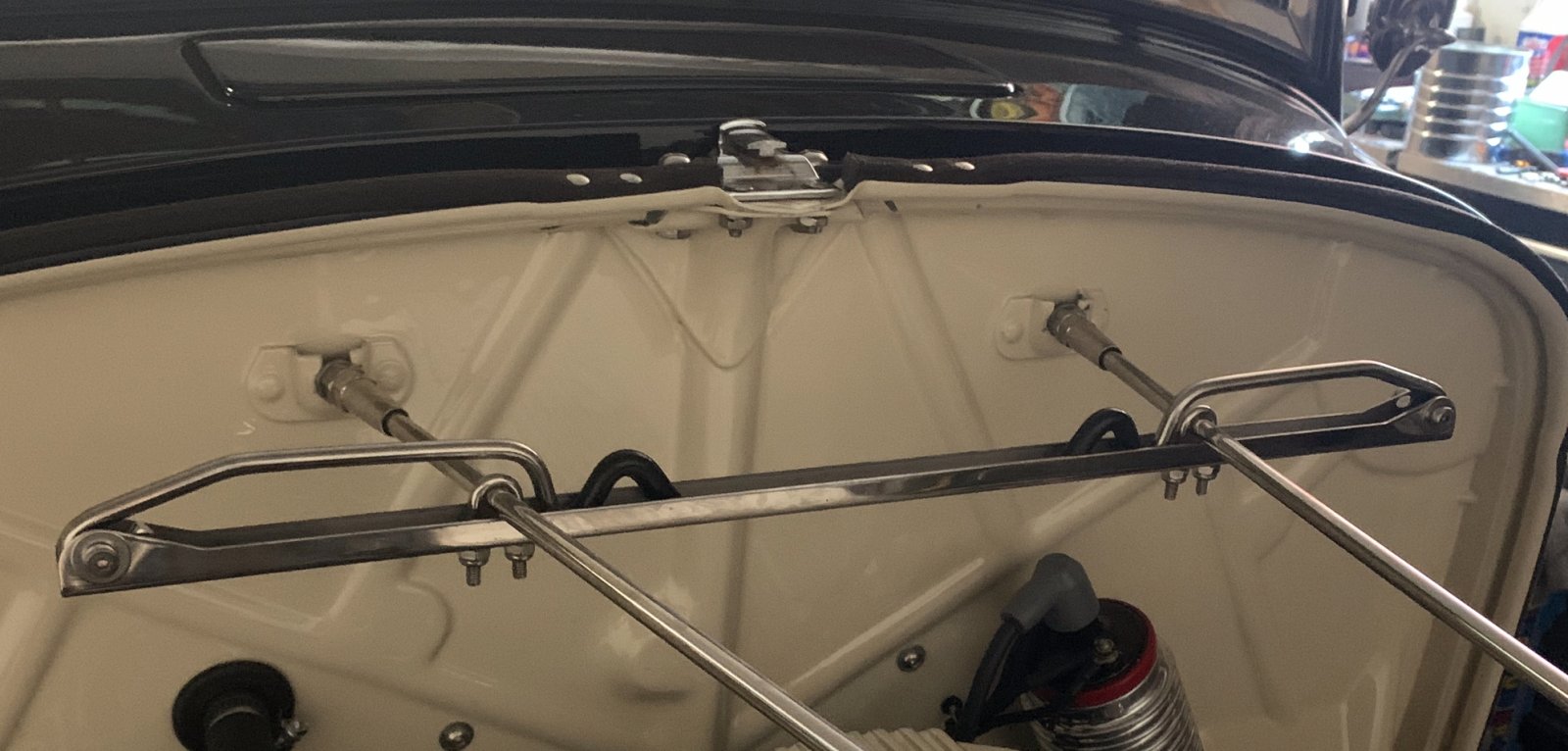

    The two round bump stops attach to “L” brackets that are on the frame rail at about center of hood. Never see anyone use them especially on an aftermarket frame without fenders. If you use, you’ll need the L bracket and need to drill/tap hole in frame rail to mount them.
    The triangle hood bumpers attach using the rivets to the bottom rear corners of the hood. You’ll need to drill the holes if you have an aftermarket hood. Again, seldom see anyone use them either.
    FYI: I always use the prop rod gizmo as it stays hidden until needed.
    Just flip the arm out for whatever side of the hood you have up.
    edit pic for the ‘shiney sensitives’ on this board.

    And just to finish it off. Here’s what the “center” bumpers look like in action.
    ps: another stolen pic.
    Note: if you use them, be cautious when lowering hood into position as there may be a tendency for the hood to get caught up on the hood latch bases and some paint may be sacrificed. Ask me how I know. But if Gary says use em, use em.

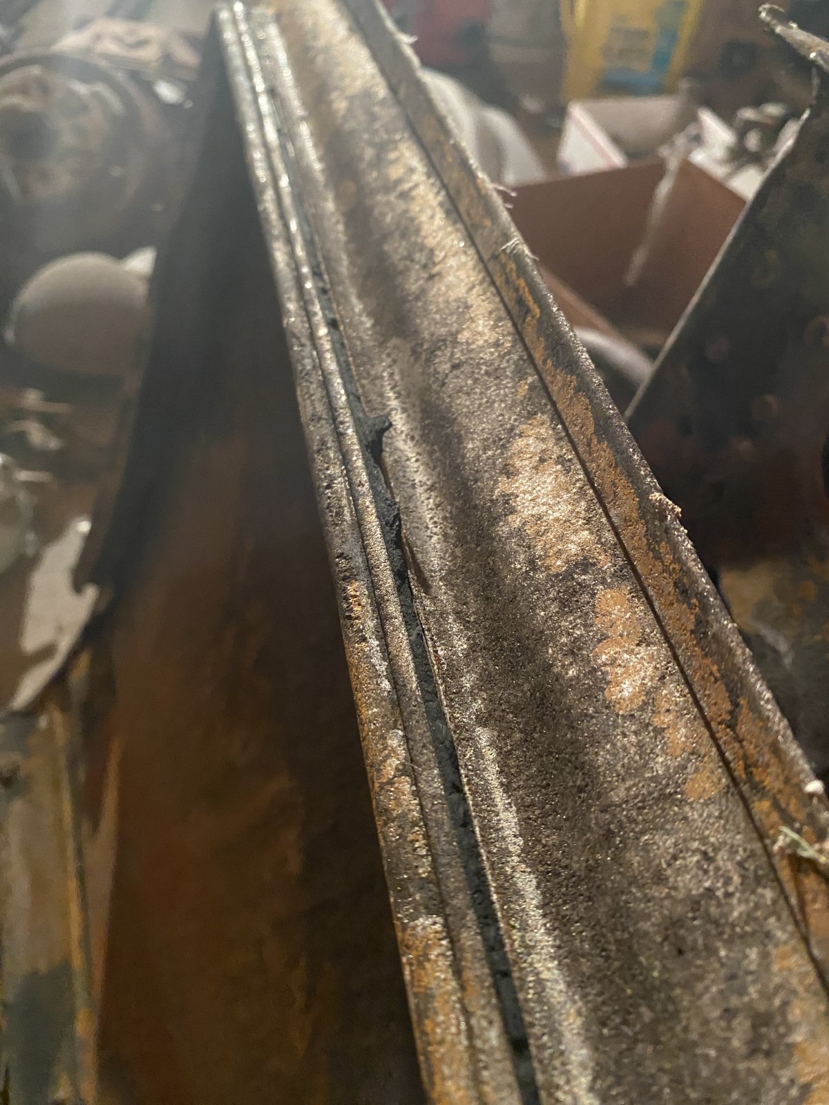

    Retainers are welded to the lower door inner, pointing down, and the rubber slides in. The sill plates are rather self explanatory (or are they?).
    Anderson, X38 and Tman like this.
  29. alchemy
    Joined: Sep 27, 2002
    Posts: 22,672
    alchemy
    Here’s a rusty one but should give you the idea.
