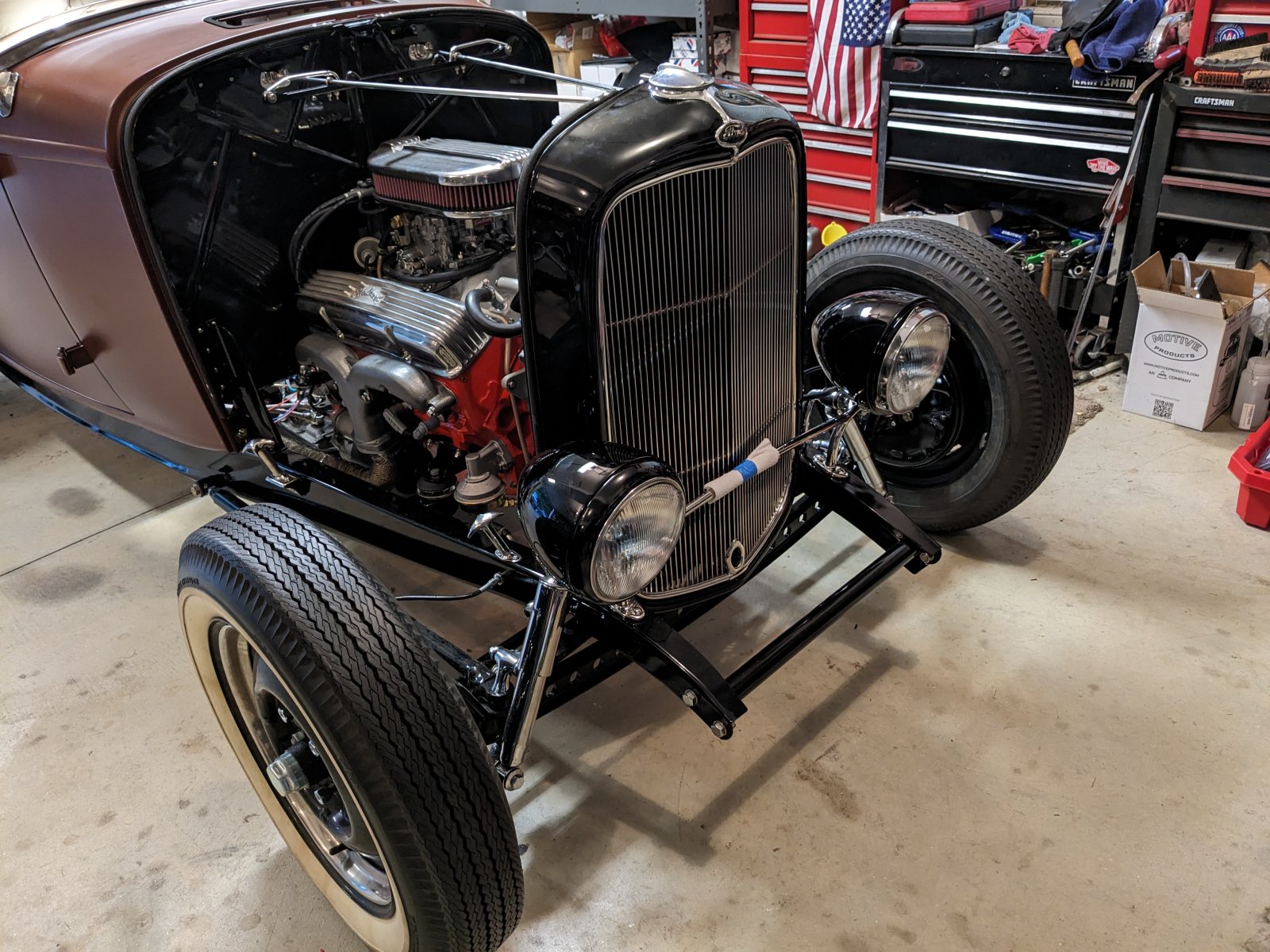

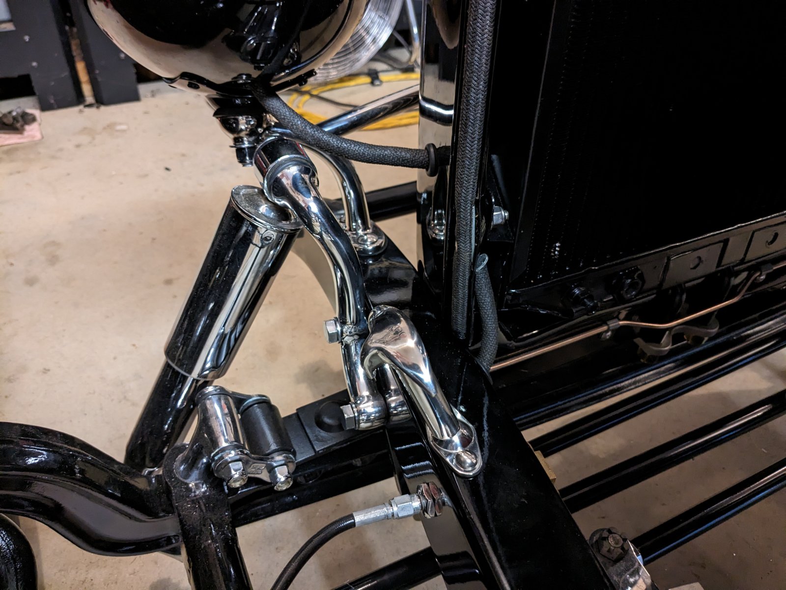

    All good on the byp*** line
    Got a fitting on Amazon - Four Seasons 84505
    And used the Gates 18701 hose that Joe Blow suggested...

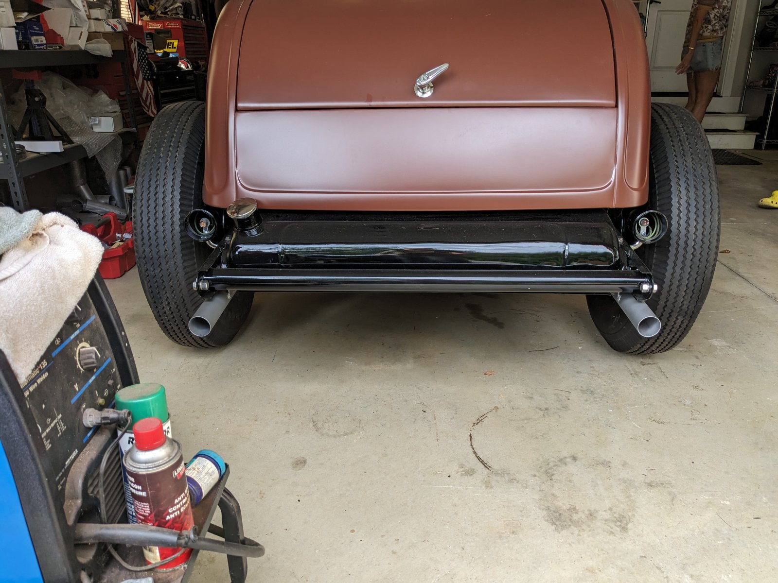

    Tail lights came out tucked in like I hoped
    PXL_20230803_185824963.jpg PXL_20230803_185838784.jpg PXL_20230803_212014960.jpg
    Just Gary, brEad and 57tailgater like this.

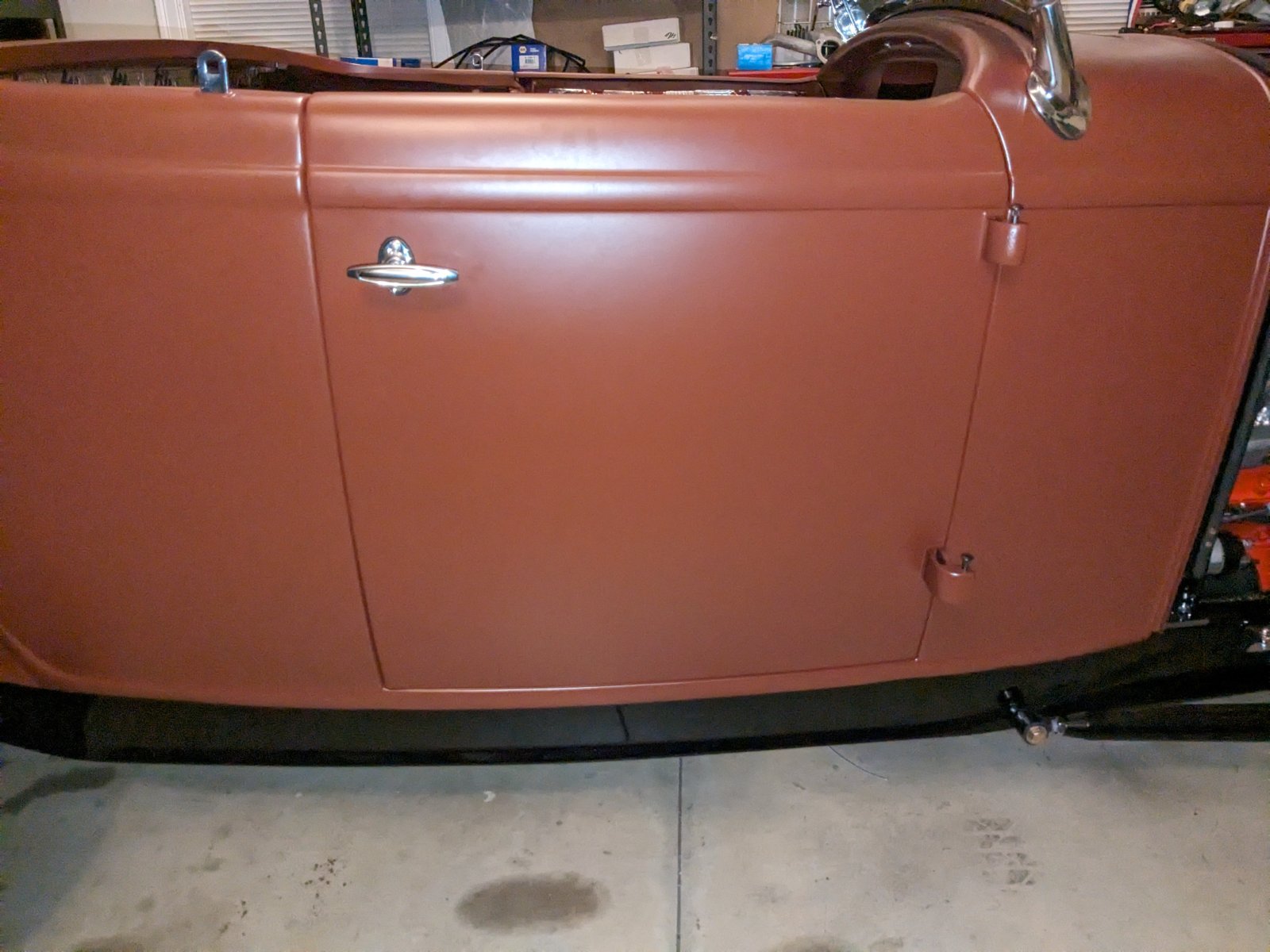

    My driver's door latch sticks when I close the door and it is a ***** to get the door open again (basically have to flex things and beat on the inside of the latch with my fist).
    Wondering if I should take a little material off the pointy tip of the striker? OR try something else?

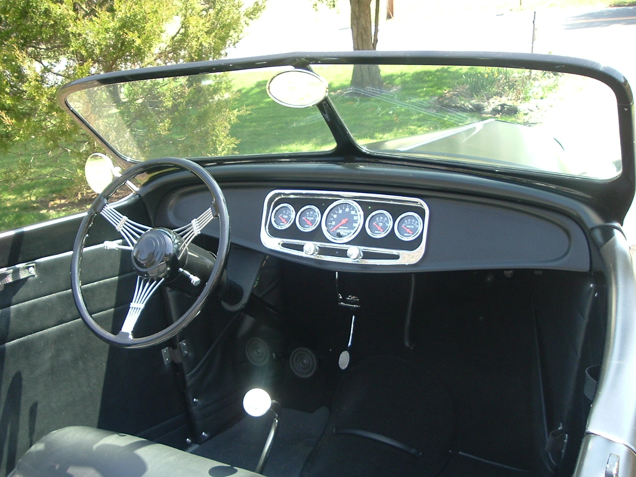

    I taught my 12 year old son how to solder and he's been a huge help!
    PXL_20230819_183731421.jpg PXL_20230821_110201379.jpg PXL_20230819_225246411.jpg PXL_20230819_225306427.jpg
    pbr40, Bcap55, patman and 1 other person like this.
  15. NJ Don
    Joined: Dec 25, 2019
    Posts: 261
    NJ Don
    Nice dash insert! Looks familiar?

    When I put the 3/8" shim under the body at the bolt next to the door jamb (to get the driver side rear door gap right), it seems to have made the bottom corner of the p***enger door go inward (top is great).
    The bottom of the p***enger side door is now sub-flush to the quarter panel.
    Where do I shim to remedy this?
  18. alchemy
    Joined: Sep 27, 2002
    Posts: 22,672
    alchemy
    If all the gaps are good, maybe it’s time to twist the door.
    Anderson and 19Eddy30 like this.
  19. SDS
    Joined: Apr 28, 2011
    Posts: 1,056
    SDS
    Stick a rolled-up towel between the bottom of the door and the sill at the rear corner of the door and push the top in to twist it?

    Before doing anything too drastic I think I'd be removing that last shim and starting over. 3/8 is a pretty big one! Depending on the movement required you can affect the rear of the door by making the cowl tilt forwards by shimming the mount just ahead of the front of the door then pulling the front of the floor down at the front floor bolt. The door movement is magnified by the length of the door, so a lesser shim might be required and this might not put other things out of whack. Whack a mole indeed

    So I tried your suggestion- the result was that the door went way higher than the top edge of the quarter panel to get the door gap right... Not even close to getting the dovetail in the slot.
    The amount of shim it took was actually .350" under the rearmost door post. I put that amount in there and tightened all the body bolts down.
    To fix the door on the p***enger side, I wrapped a 2x4 with a towel and put it in the bottom of the door, back corner- - I then leaned my hip into the top of the door a few times and twisted it- it's perfect now.
