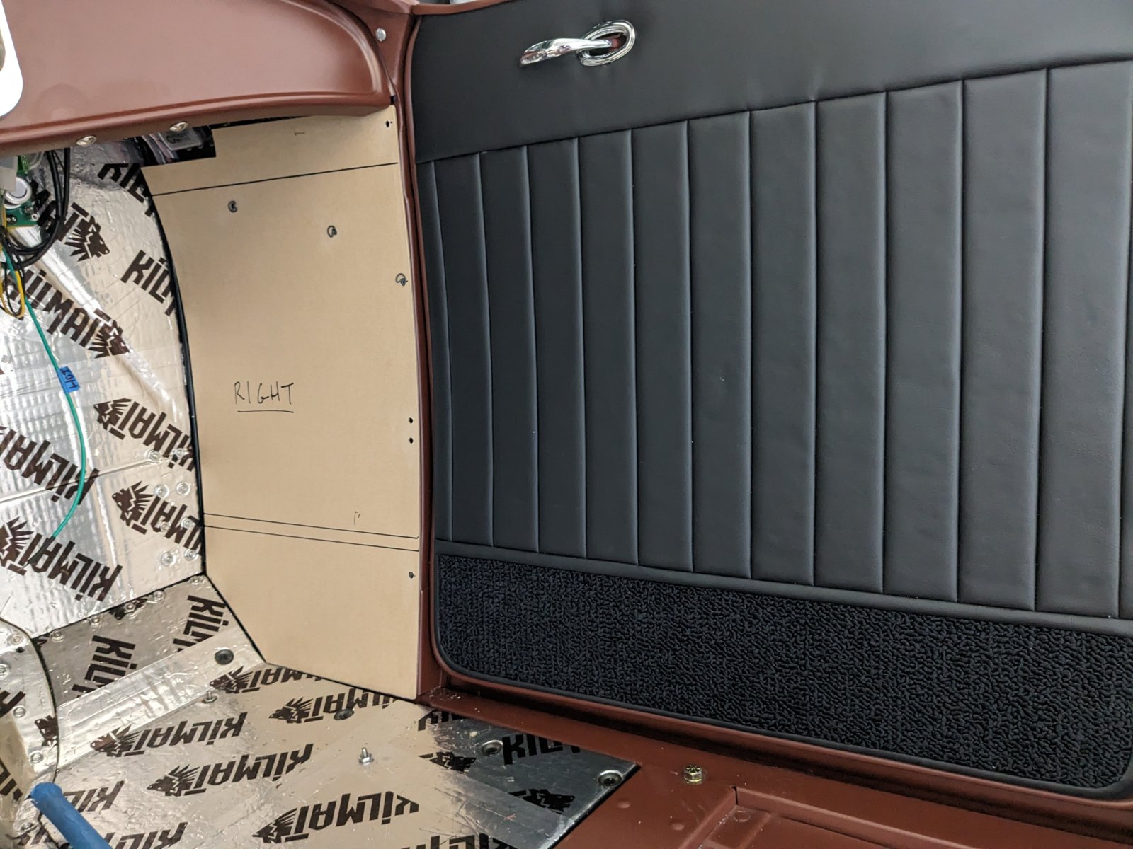

    I took the day off from work and got door panel number two done as well as cutting out the waterproof cowlboard for the kick panels.

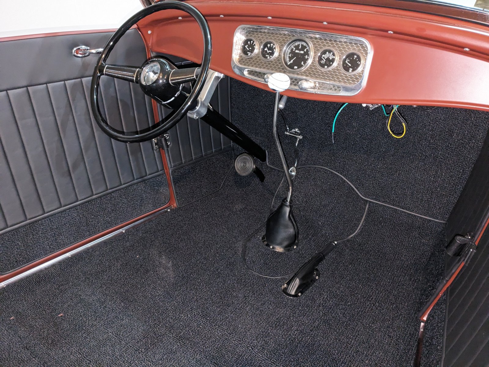

    I learned a few things today while working on my interior.
    1. As someone mentioned in the upholstery thread, don't drill the holes to mount your trim or anything else through loop carpet because it will wind up the carpet threads like no one's business and rip off in rows. Having read this, I even melted out the holes with a soldering iron before drilling and it's still wound up the carpet threads on one of the holes .Luckily, I was able to stop quick enough to have only a small 3/8 in square spot sticking out from underneath the shifter boot trim. Using my experience from the movie industry in fixing screw-ups, I was able to super glue some carpet "fuzz" on to the bare spot. When I put the shifter boot with the trim ring on, it's not really noticeable unless someone points it out.
    2. When you're planning out where to drill the holes to mount your shifter boot trim ring, make sure to consider if there's any welds in your transmission cover/tunnel right underneath where you plan to drill the holes and put sheet metal screws in to hold the trim ring. The moral of the story is self-explanatory. Looking back, although it would have been much harder to bend, I should have put the four screw holes in an X pattern versus a plus sign pattern.

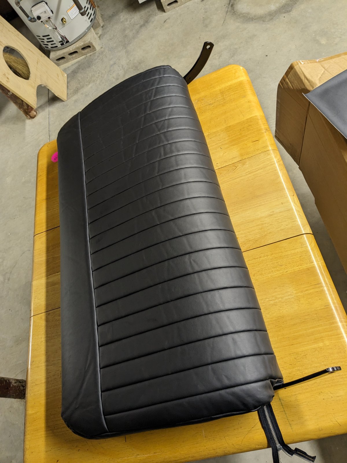

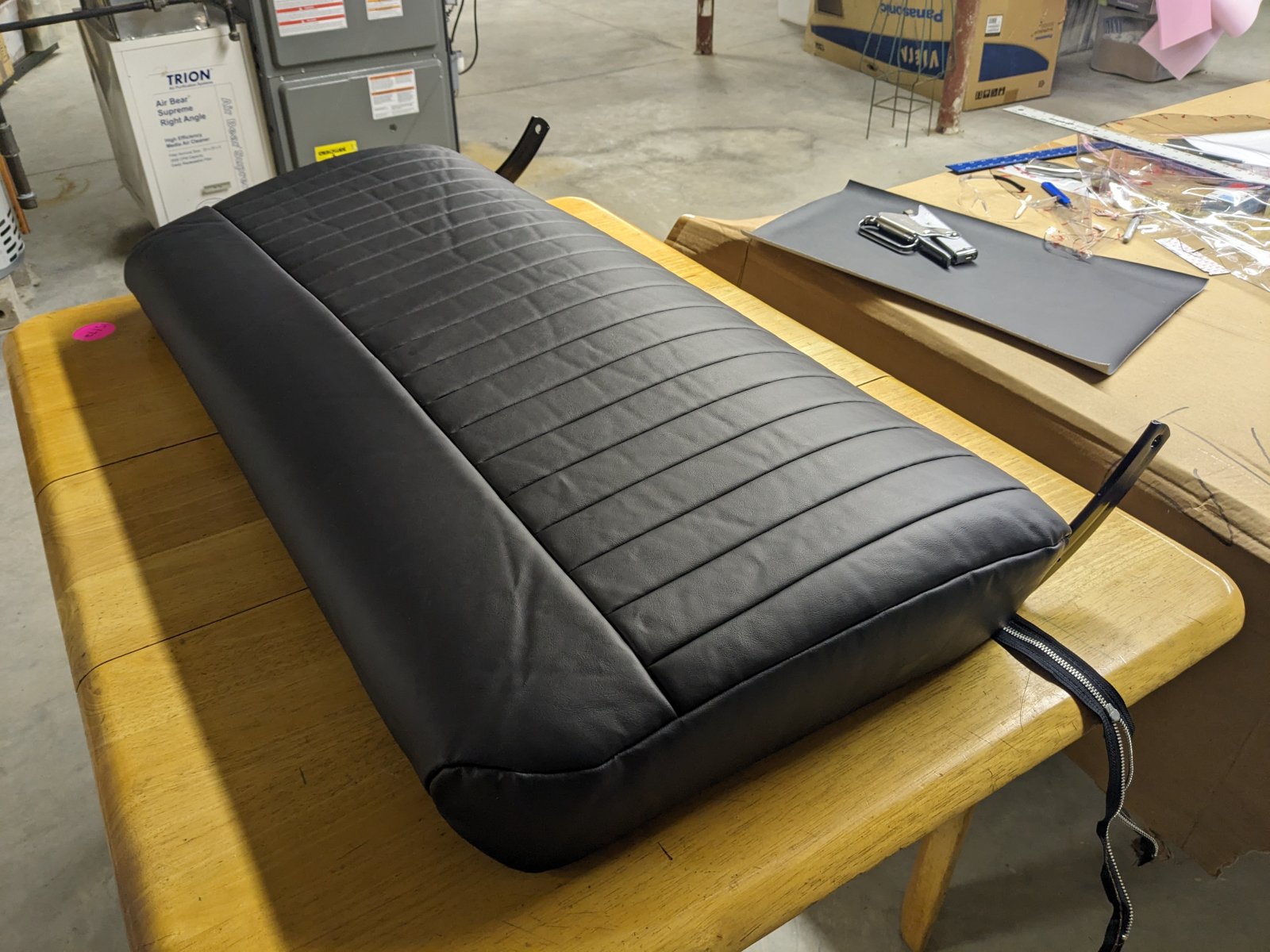

    Made patterns and have all the seat back panels cut out and ready to sew.

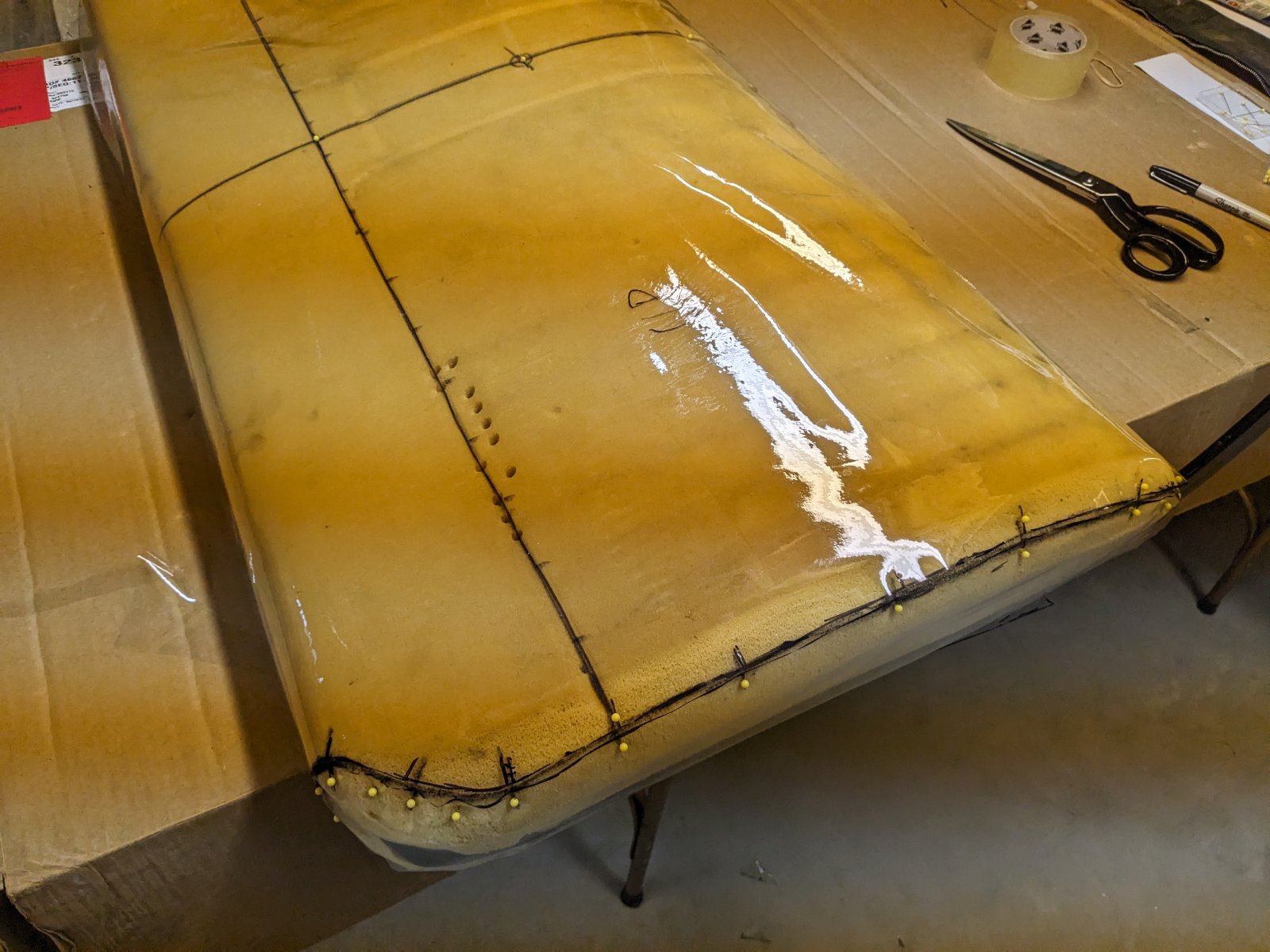

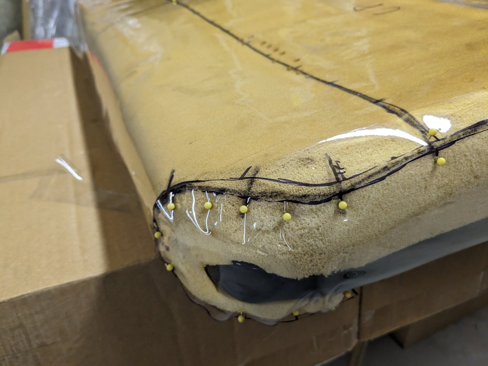

  26. SDS
    Joined: Apr 28, 2011
    Posts: 1,058
    SDS
    No, but it'd have come in handy today...
  27. SDS
    Posts: 1,058
    SDS
    I need to stuff-in a lot of batting to fill out the seams and wrinkles

  28. GordonC
    Joined: Mar 6, 2006
    Posts: 3,473
    GordonC
    Great idea using clear vinyl as your patterns! Nice job!

    SDS
    The good thing about it...if the clear vinyl won't conform, the Naugahyde definitely won't.
    brEad and GordonC like this.
  30. GordonC
    Joined: Mar 6, 2006
    Posts: 3,473
    GordonC
    I used some old plastic shower curtains. They worked pretty good too.
